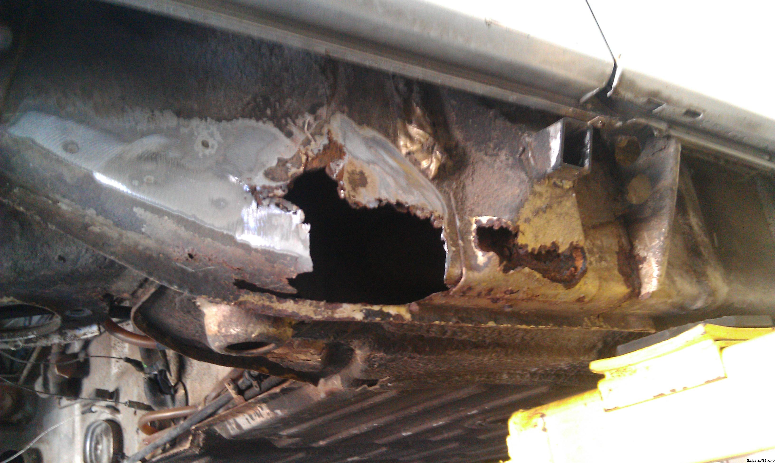

Not another rust bucket - No thanks! My faith in gvr4's have been shaken as of this moment to be honest. If I ever dump this thing, I am quite nervous to step into another. I will be looking for rust like crazy, thats for sure!

I understand, G. /ubbthreads/images/graemlins/crazy.gif but, this was well-hidden. I think we should make it mandatory to take the dog legs off and post pics of cars for sale threads. /ubbthreads/images/graemlins/idea.gif

No, you can tell it's got issues by how rusty all the brackets and bolts are, that's a dead giveaway it's been driven in salt. Without even removing the dog legs. Everyone learns the hard way. Everyone has a different interpretation of "rust free". Some are referring to the body panels, while experienced restoration aficionados refer to the underbody. Wopper have you seen rdomecks underbody? Just sayin.

I do agree with G on the underbody, there are certain things that give away the cancer. and again I feel your pain. My VR-4 is in worse shape.
As for panels, a stock base shell is a good start. No holes to make water traps and the stampings are the same. The only difference is the centre part of the floorpan up front on the panels you'll be wanting to cut off.

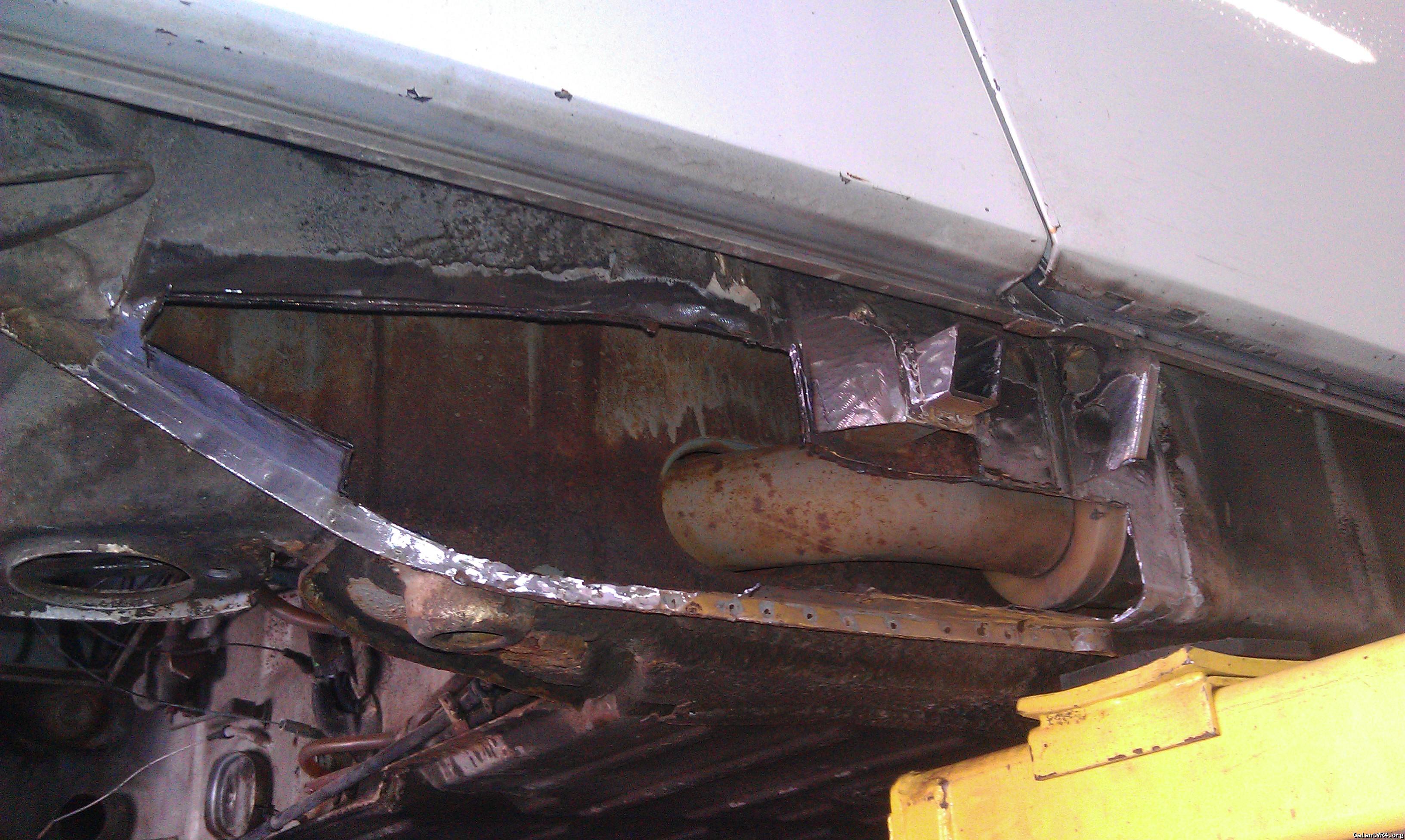

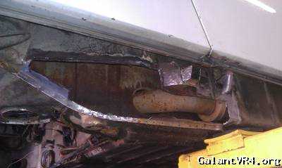

Not wanting to make your day worse, it would be good to tear off All of the sideskirts. Look at the sill (rocker) the whole way along. You may find it better to do the whole lot in one hit.
Please don't bodge it. I had that done on mine. but now I have to replace the whole inner and outer and other panels too.

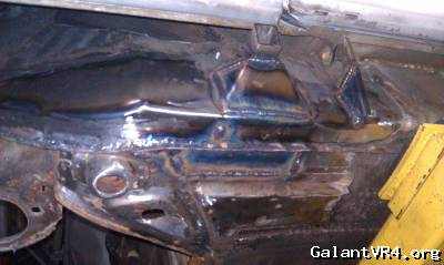

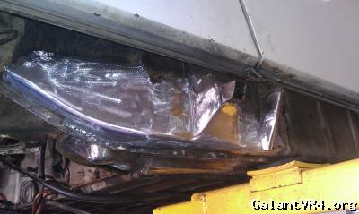

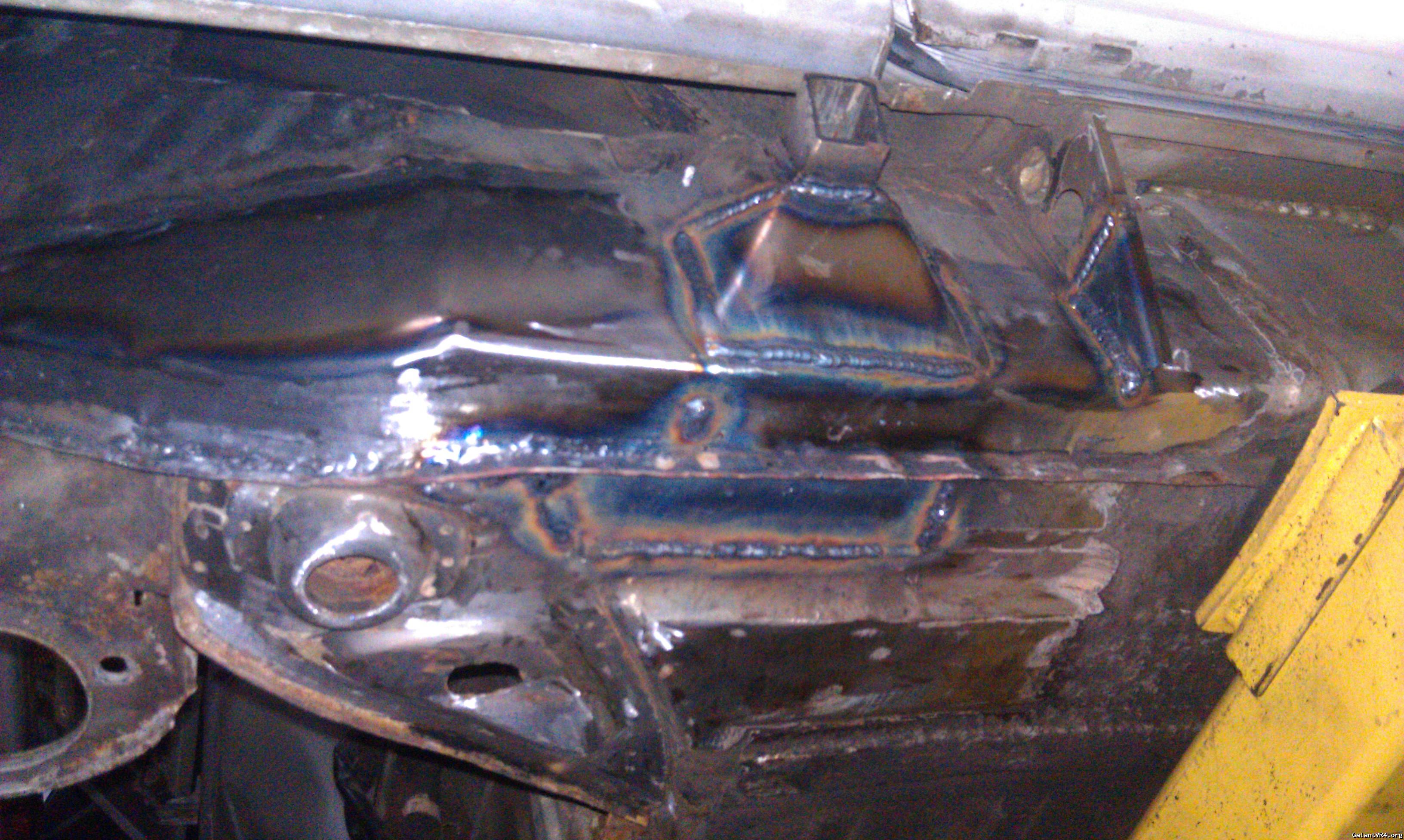

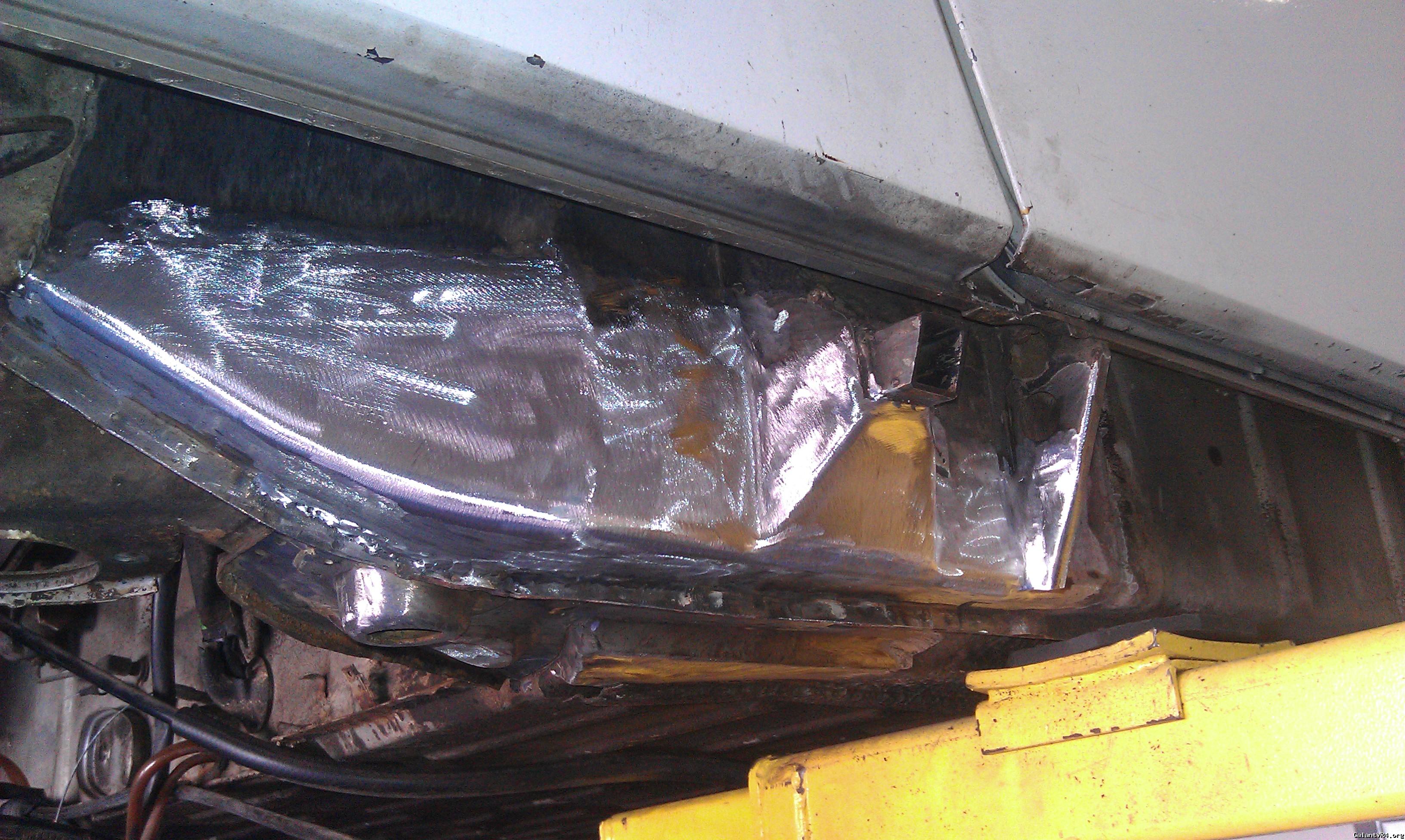

I'll attest to the amount of work rust repair can be. If you are going to have it fixed just make sure it is done correctly. Saving this shell won't be cheap but it could be worth it if you are in it for the long haul.
We have a 914 in the shop getting a Suby transplant but before we could do that we had to address rust issues. I had 30 hours into this car in rust repair alone. The section shown below was a good 20 hours, the other 10 were on the inside of the "engine bay".
blacksheep
May 1, 2002
15,485
Urbandale, Iowa 50323
Wow - great work. Wish you guys were local to me. I would trust a shop like that in a heartbeat! Looks like I will be selling her allright /ubbthreads/images/graemlins/frown.gif
