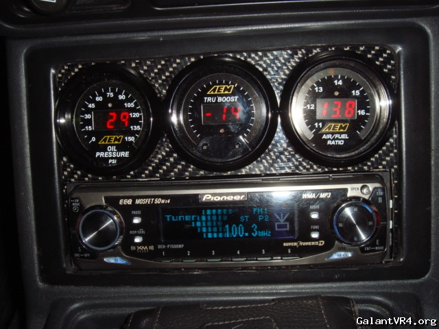

AEM’s TRU-BOOST Gauge-Type Controller I love mine. I use to have the Greddy profec B one which worked great came with the car. I just like the simpicty in haveing all in one. It is a Digital gauge it has 2 boost settings and can add or decrease boost on the fly and being able to data log it is quiet nice /ubbthreads/images/graemlins/wink.gif
Quoting THEKID:
all i need is a boost controller i am running aem ems. i know i can controll boost from the aem but my tuner says to use an external controller.
Why don't you just use the AEM to control the boost?? That's what I did. Pulled out my high $$ HK$ boost controller and took advantage of the AEM.
