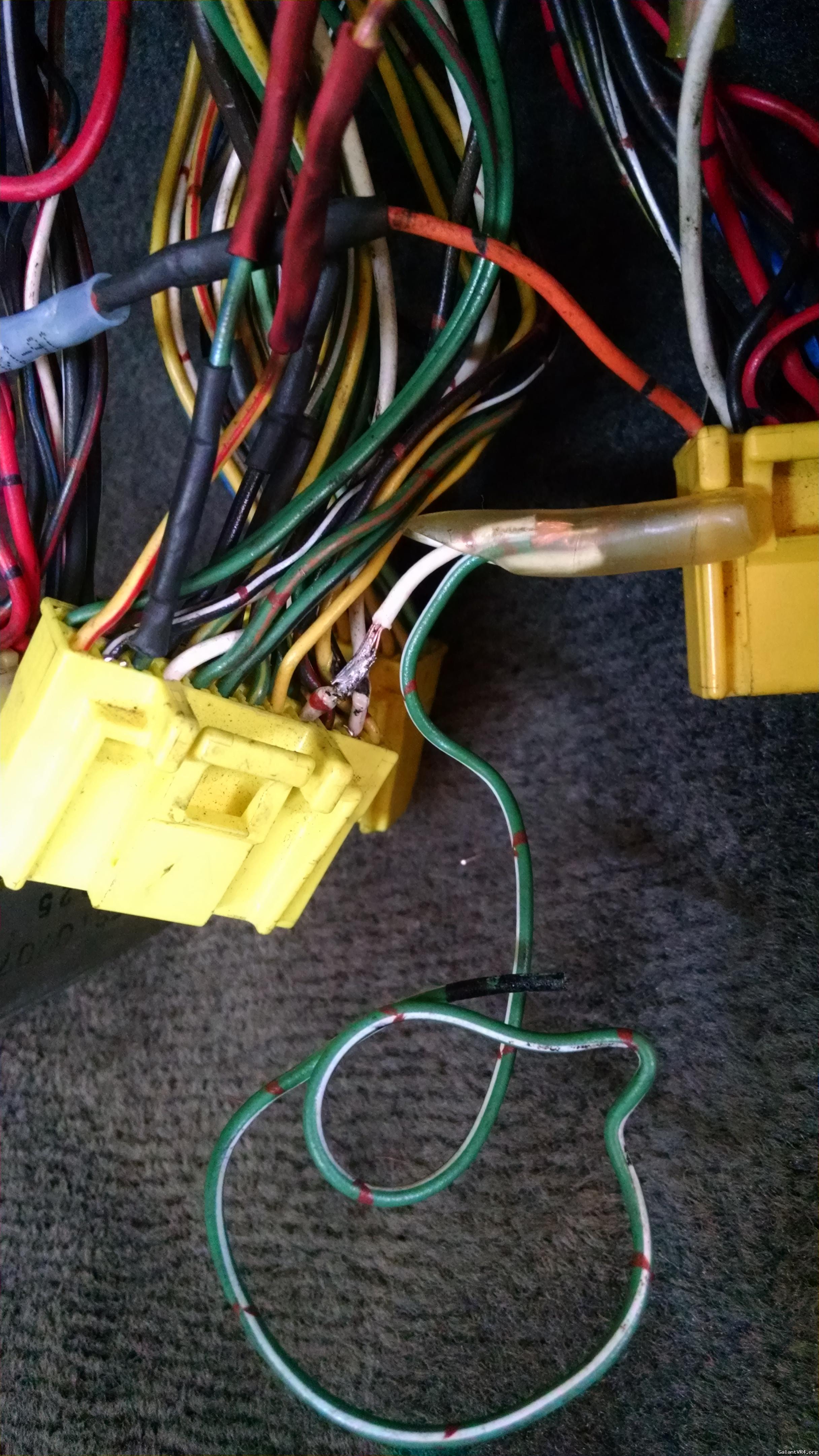

Started fixing the wiring that was cut up by the ecu. Can anybody tell me where this wire pictured goes? I can seem to find a mate for it. This is tied into the wire that goes to pin 4 which is listed as the o2 sensor. Thanks in advance for any help.

I believe that wire goes O2 test connector. You can leave it as is not hooked to anything.
