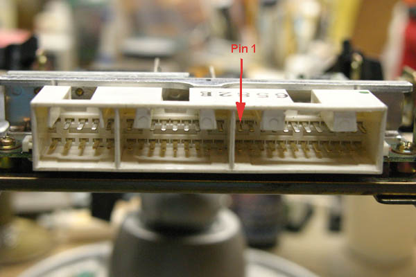

People seem to have a hard time understanding that the pins are referenced looking at the ECU connector and which pins is which.

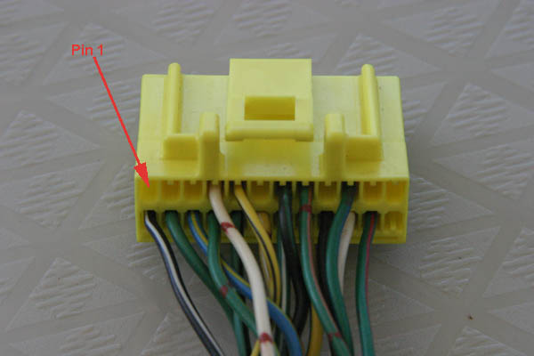

The mating connector from the harness is then numbered looking at the back of the connector where the wires come out. Ignore the missing wires I've stolen from this connector.
