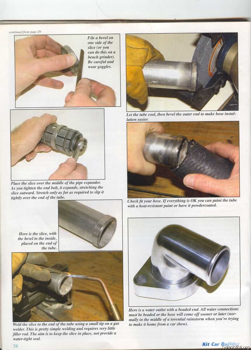

Why not just weld a bend around the tube expander and file it, clean it up nice and sweet and then insert it in the tube and make a bead.
