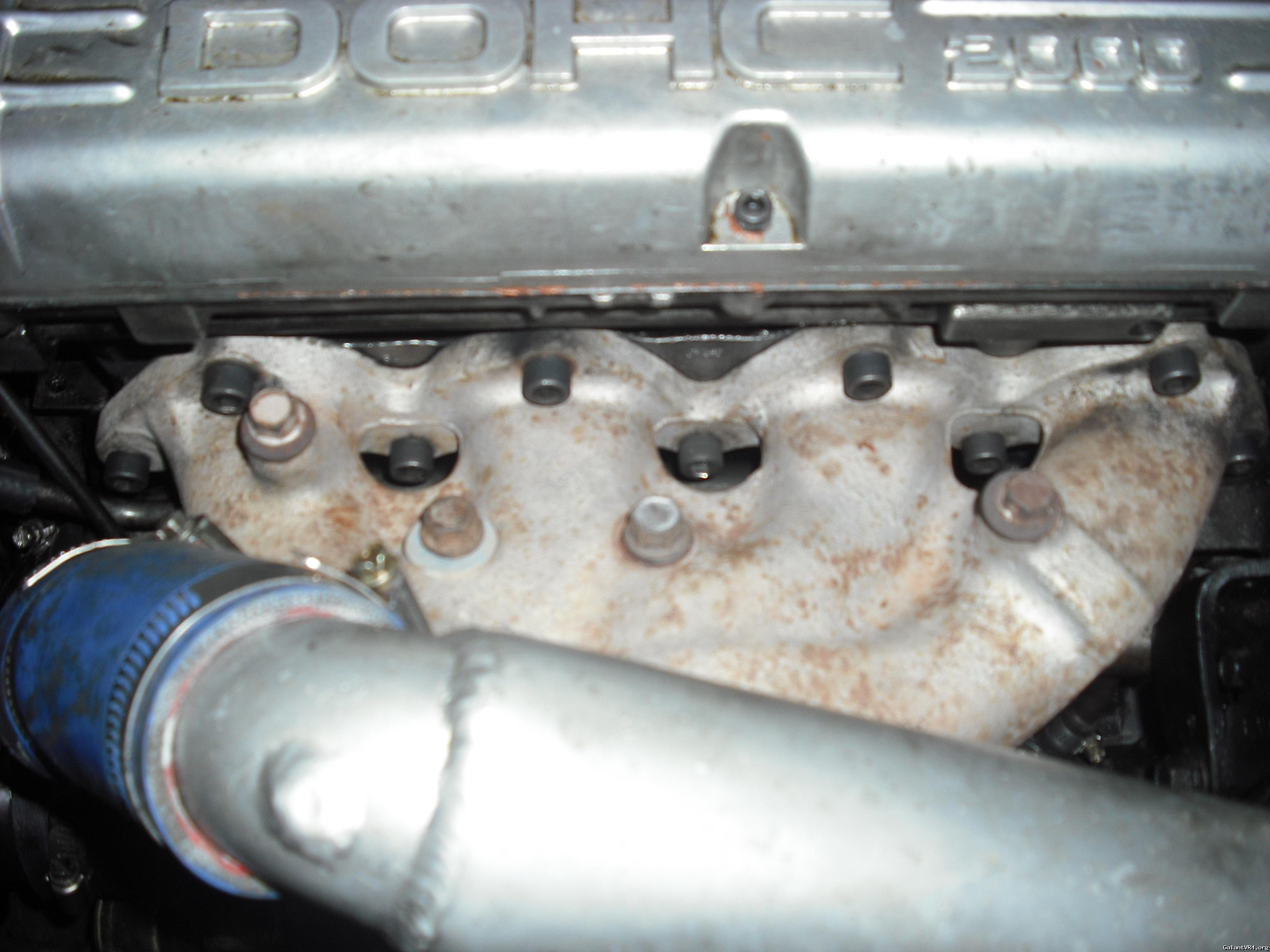

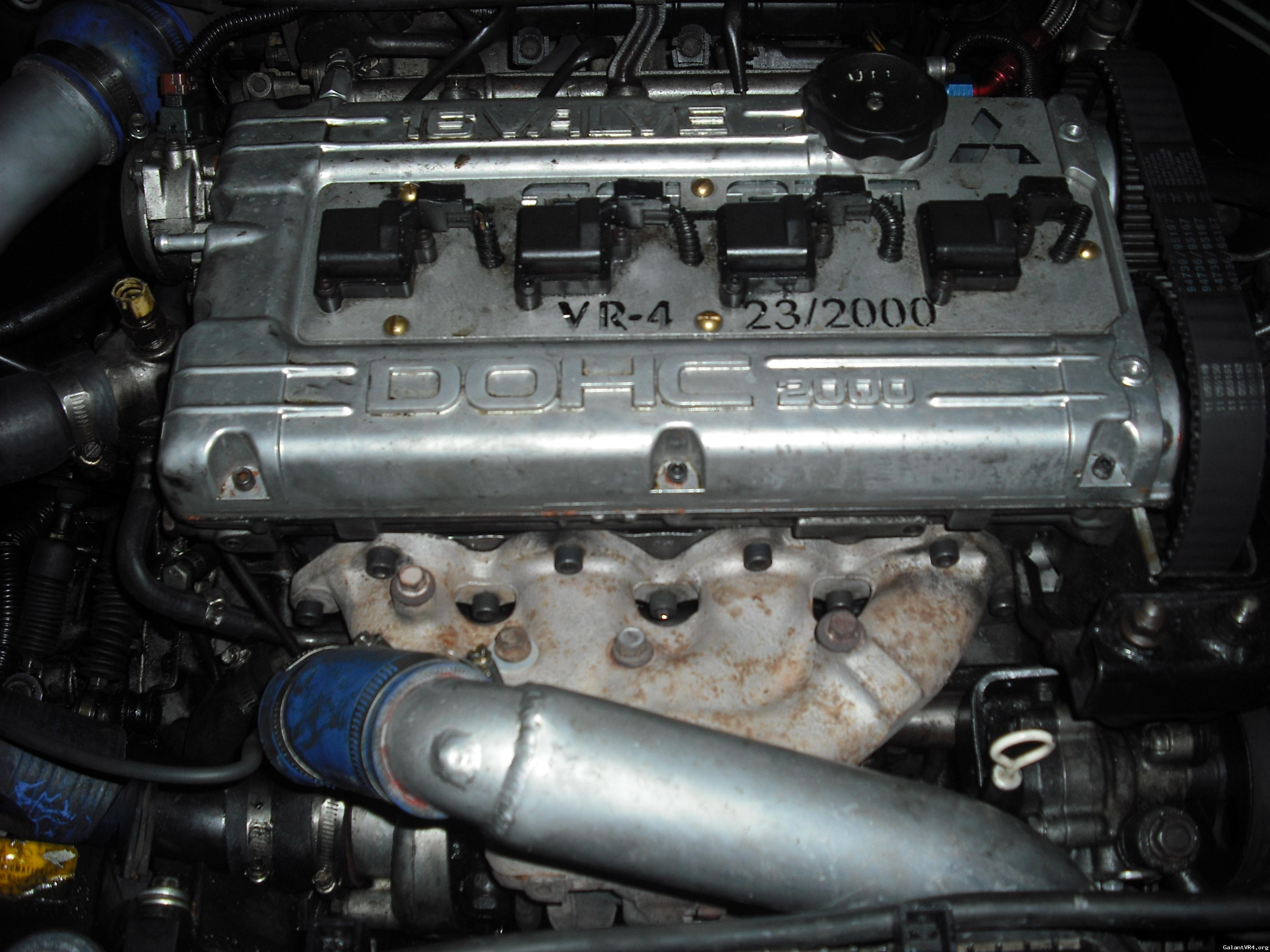

easy exhaust mani mod
this is a simple mod i did because i was tired of suds stripping out. all it is is a harded 1" allen head 3/8 bolt and hold up better than the studs in my opinion

Personally I'm mixed about this because you are asking a lot more of the aluminum in the head than a stud is.

While it may be easier, it for sure has less holding strength. The shoulder on the stud forms a seal against the beveled part on the hole. It is this seal that give a lot of the stud its strength. Under any circumstance, an equal diameter stud will be stronger than a bolt of the same size and material. with your solution, you are much more likely to strip a hole than with the stud. The real solution for the stud issue on the manifold is drill the holes on the manifold to accommodate larger studs, the size of the end studs on the intake would be good, then drill and tap the head for the new larger studs, and loctite the studs in.
/brox
i understand what your saying but i have had no problems with it at an average of 18lbs of boost and has help up to 25 lbs
its been a couple of weeks so far and good ile update in a couple more weeks and there is no going back for me unless i get a new head because of them being 3/8 bolts

I used stainless studs & bronze self locking nuts. I have never had any issues running them or when I've had to disassemble. You will find studs hold better, bolts are gonna back out with heat cycling.
Locktight isn't likely to help given the amount of heat those fasteners are subject to, I would think /ubbthreads/images/graemlins/dunno.gif
11,982
It'll hold up fine under running conditions. It's when you have to pull those bolts back out that you will have issues. They will probably pull aluminum out with the threads. The aluminum threads in the head aren't meant to have bolts put in and then the twisting force of torque put on them to fasten the weight of the manifold and turbo. With a stud and nut, the nut just pulls on the aluminum threads as it tightens down on the stud. The twisting action adds a force that will strip them bitches out. Good luck. /ubbthreads/images/graemlins/uhh.gif
i am not to worried about that because i ever have to remove them i am buting a new head anyways and porting and pollishing it and aftermarket valves and spring, ECT
