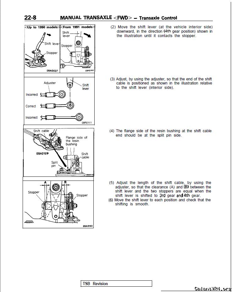

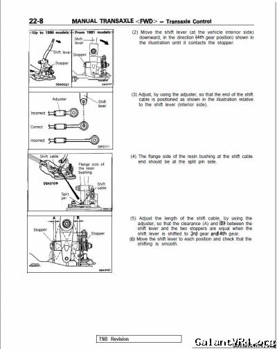

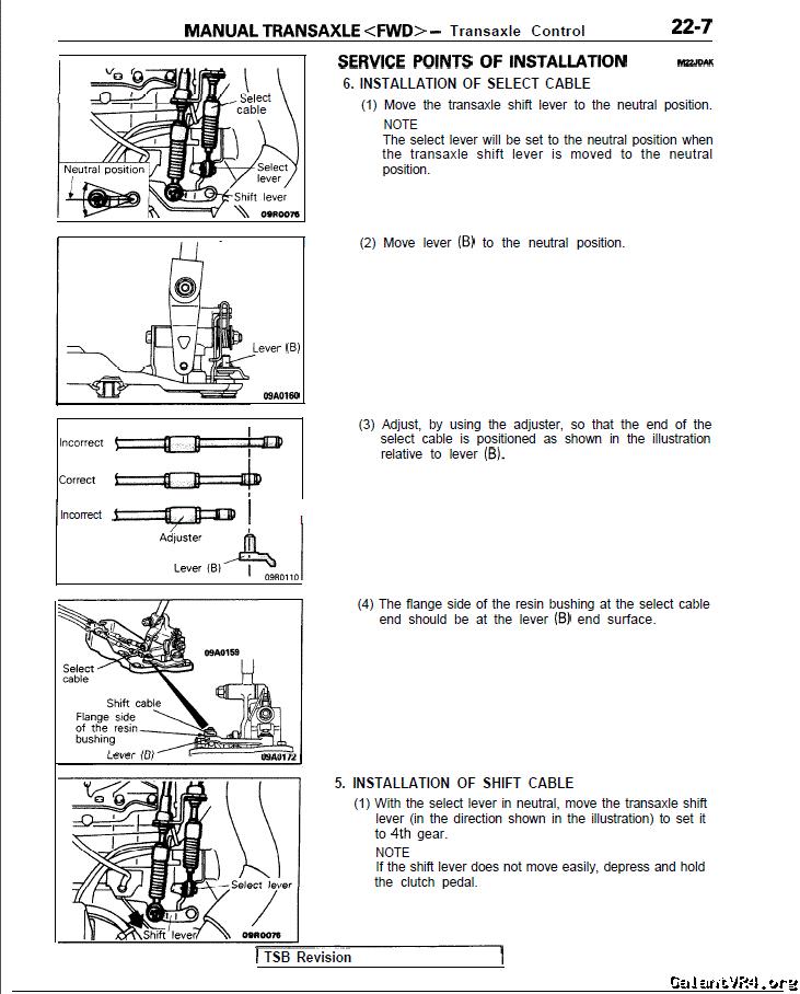

so all back together now i started it but as i thought shifters are off i have 1st 3rd and 5th but it just grinds in 2nd 4th and reverse, can i adjust what i have, if its grinding it means it aint far from getting in gear right so are there small adjustments i used the bracket for the cables from my old gearbox so, and everything is basically the same except the box im a bit stumped here?
EHmotorsports
Sep 25, 2012
1,282
Beaverton
Yes there's adjustments at the shifter base. Should be 10mm and be for the side to side action. Try adjusting it longer first. If it feels worse then go the opposite way.

going good, it goes in all gears i can drive it now took alot of adjusting up at the gearstick end, still needs more adjusting i will go for a small drive and feel it out, def working though appreciate it.

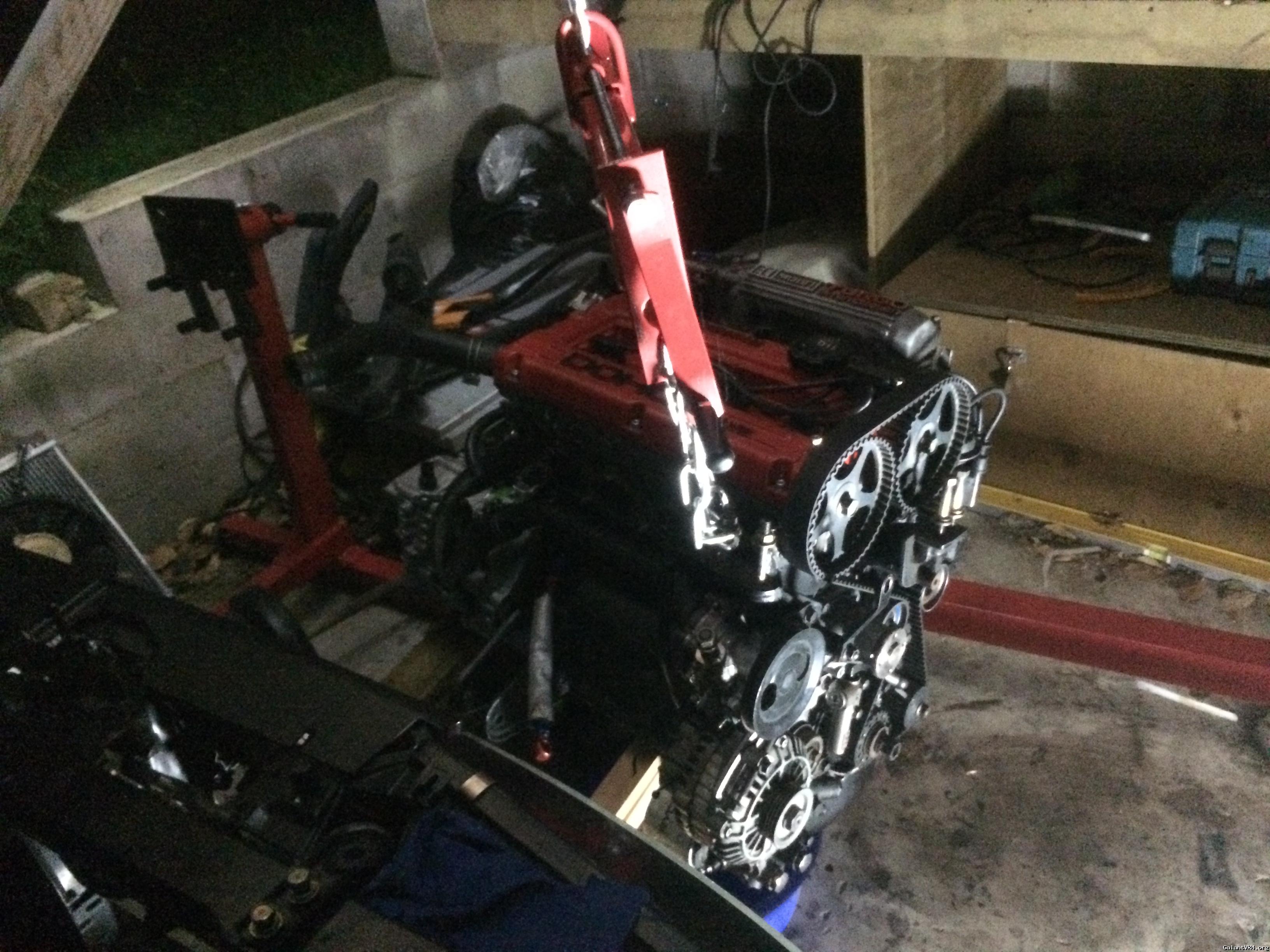

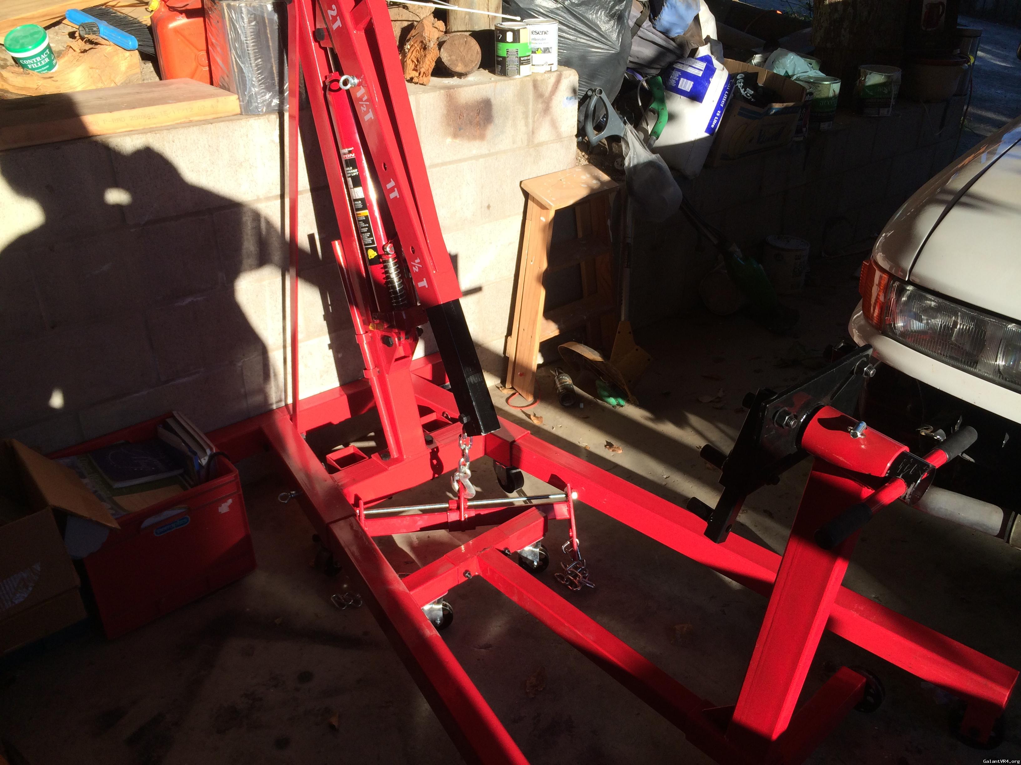

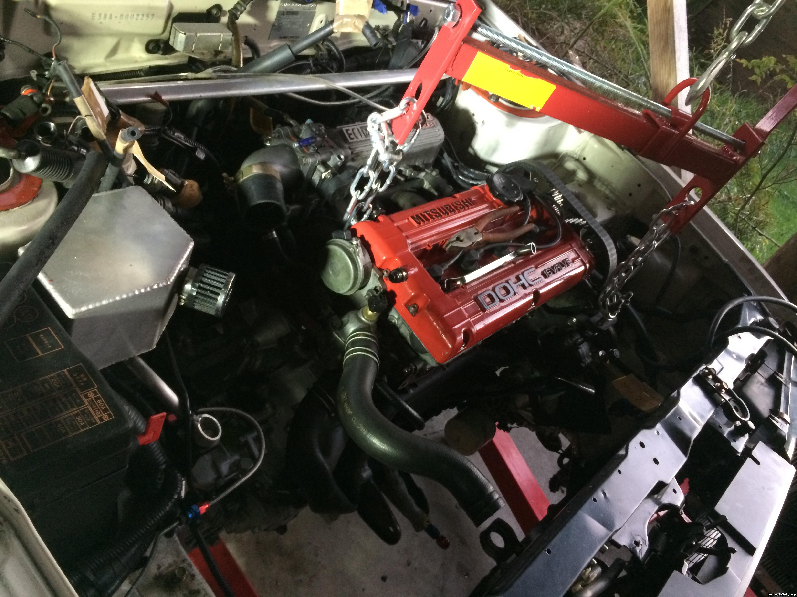

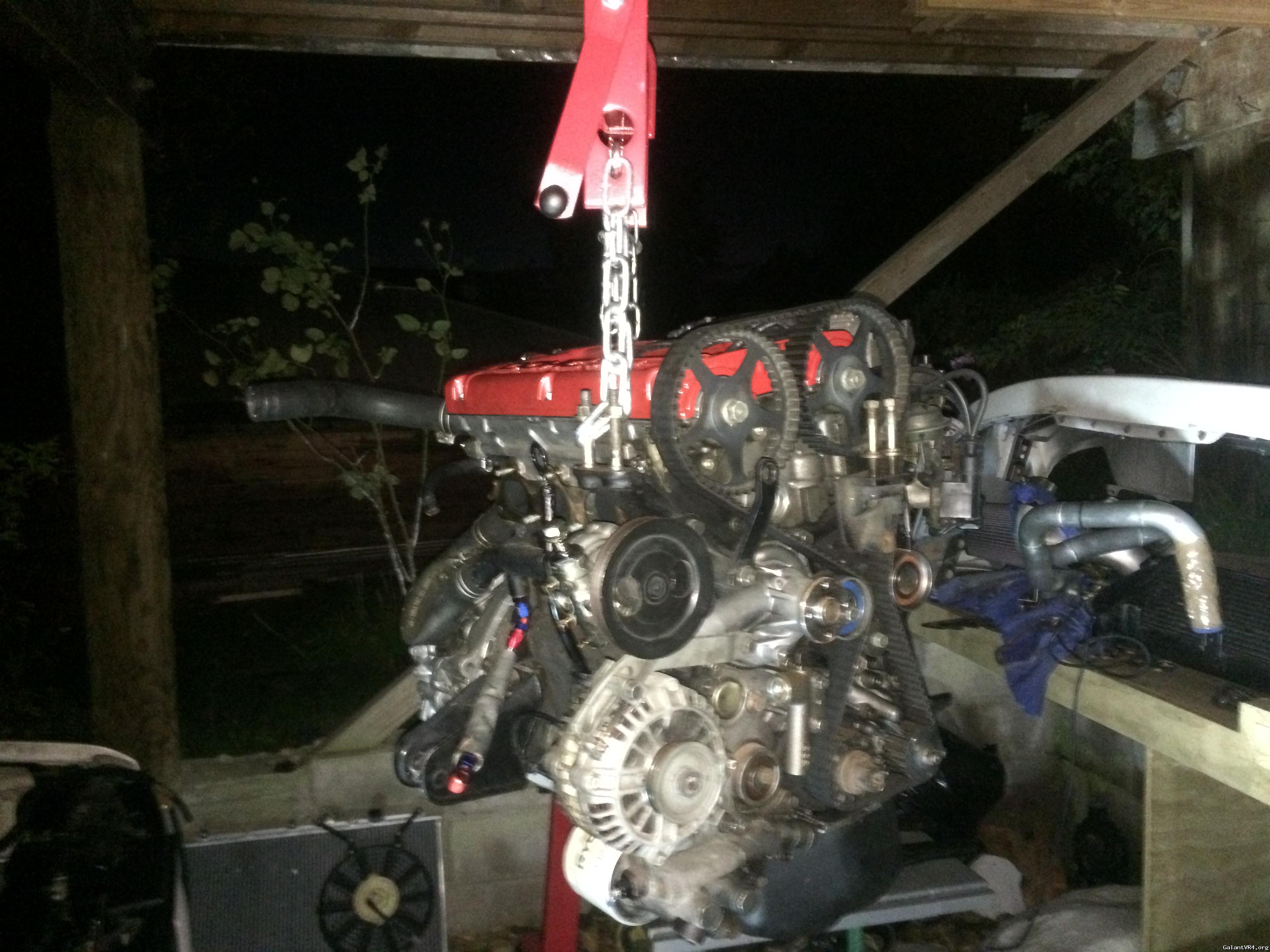

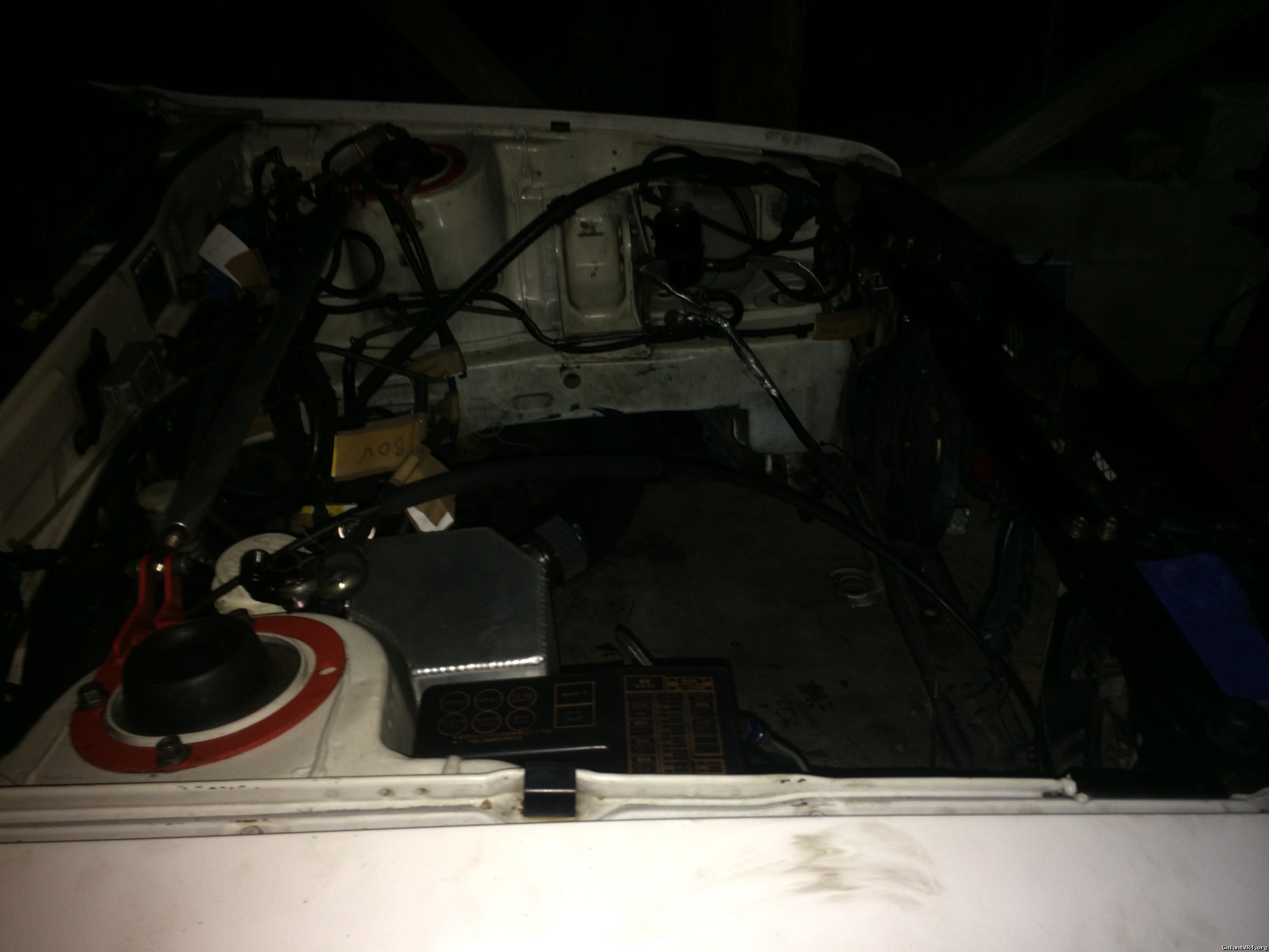

So I got back into it this weekend, now that I have finished my apprenticeship i can put more time and now money (yeah!!!) into the build. This time around I am going to fix a series of leaks, clean up the engine, paint the block, clean up the engine bay (repaint and mild wire tuck), rebuild the front subframe and replace the worn out steering rack. Also by the looks of it one of them crappy ebay BSE kits was used, without the oil groove and that big puk you goop in the front case that leaks, so i ordered the oem parts for a BSE and maybe a new front case. I have seen the results of a stub shaft without the groove and it seized in there and wrecked an oil pump so i could still be up for worse yet. took me six hours (casual with beers in between) to pull the motor. First time without my good mate giving me a hand but it was sweet, labelled most things because I wasn't sure how long it would be out for. This engine hoist was a great purchase just need a bigger shed.
