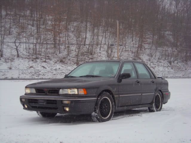

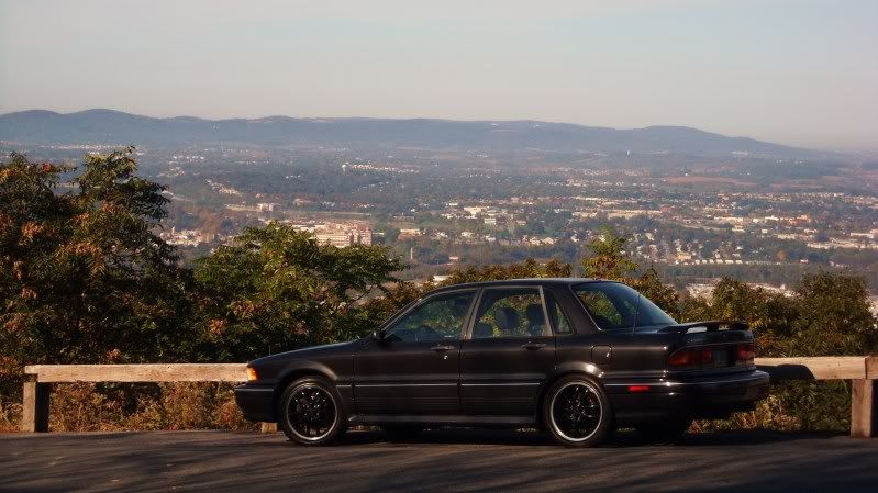

I just auto-crossed my car with totally stock, uncut dsm suspension. I totally did beter than I thought I would.
The back does sit low, but it's not enough to bother me.
This picture over-exaggerates the effect.
But in this picture, the car looks proportioned front to rear.
The car does sit lower than with the stock suspension. What do you guys think, 1" to 1.5" drop?
It's still worth doing though, as a cheap "upgrade"
The hunker is definitely less noticable with the summer rims on , sitting on that hill. Are those evo rims, painted black?
They are 17" 2gb GSX wheels, powder coated black with a chrome lip. I think they look super on the car!
