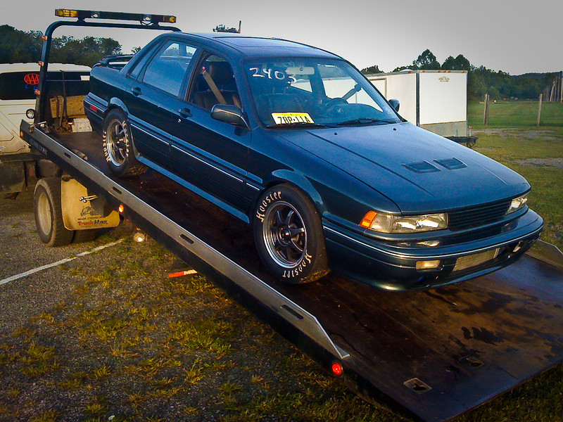

So I'm pretty happy with an 11.4 @ 121 on pumpgas, park the car and load up my tools, reinstall the headlight. Go to leave and the car wont start. after some investigating: no fuel pressure on gauge.
Check the pump, I have power at the plug. Pull out the sending unit and jumper the pump to the battery: it only turns on after getting whacked with a ratchet and was intermittent.
So supra pump died and left me stranded in the pits waiting for a tow truck. /ubbthreads/images/graemlins/rofl.gif
