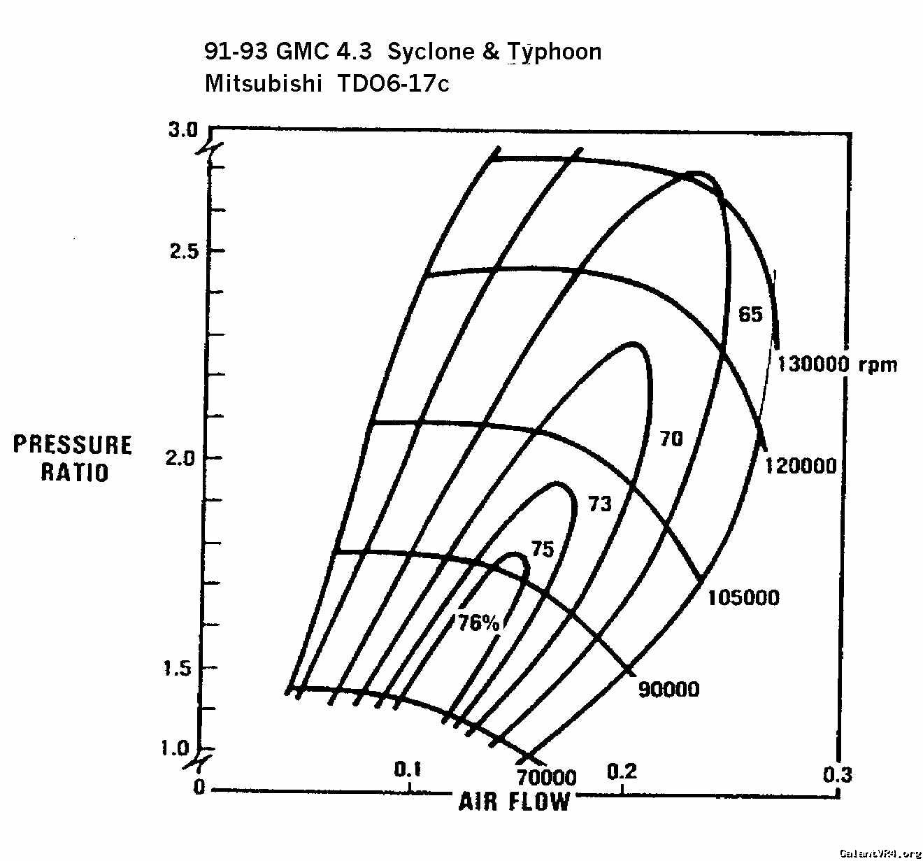

Evidently the 17c/7cm "just works" with blue top injectors and 1g maf. I was going to leave it alone until I got a Evo 8 ecu swap collected. Reading about the compressor map for "c" wheels makes me not want to put it back on that engine.

The 17C wheel? Maybe 10-15 years ago someone fell for marketing hype for a frankenturbo? Here is a compressor map for a Syclone. Mind you MINE is crammed into a tdo5h housing.
That map is for this compressor housing I ASSUME.

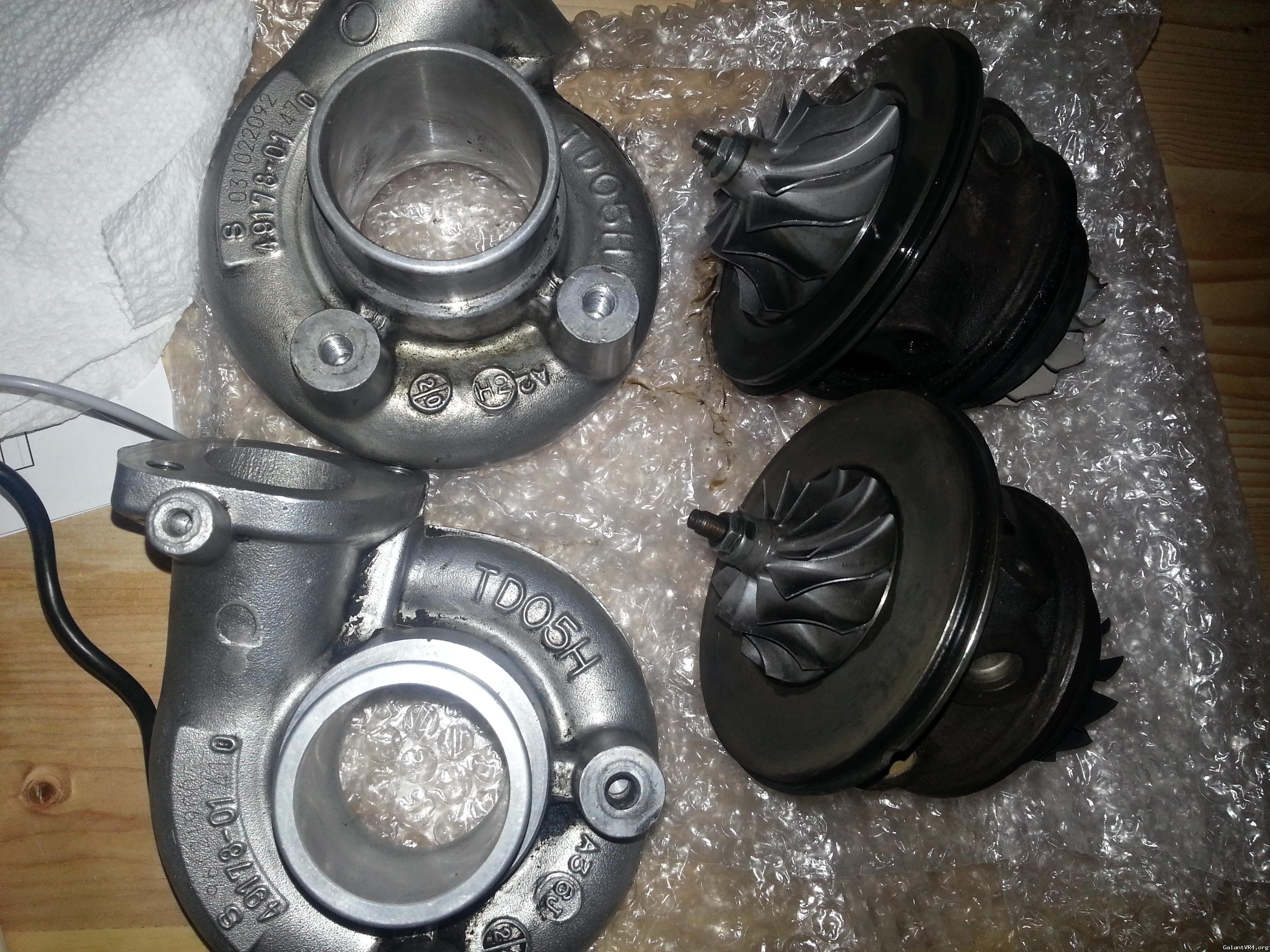

Here's another comparison of the 14B to 17C for posterity. The beastly 14B in it's new forever home. Intercooler saved a half-pint of oil.

The compressor housing for the "17c" bears part numbers for the Evo III big 16G and it looks to be a genuine MHI housing too. But I suppose it could have been machined. I forgot the G wheels have staggered blades so I guess it counts out the 16G.
I would look at rebuilding that turbo with new seals and bearings and see how it goes. What does the hot side look like?
