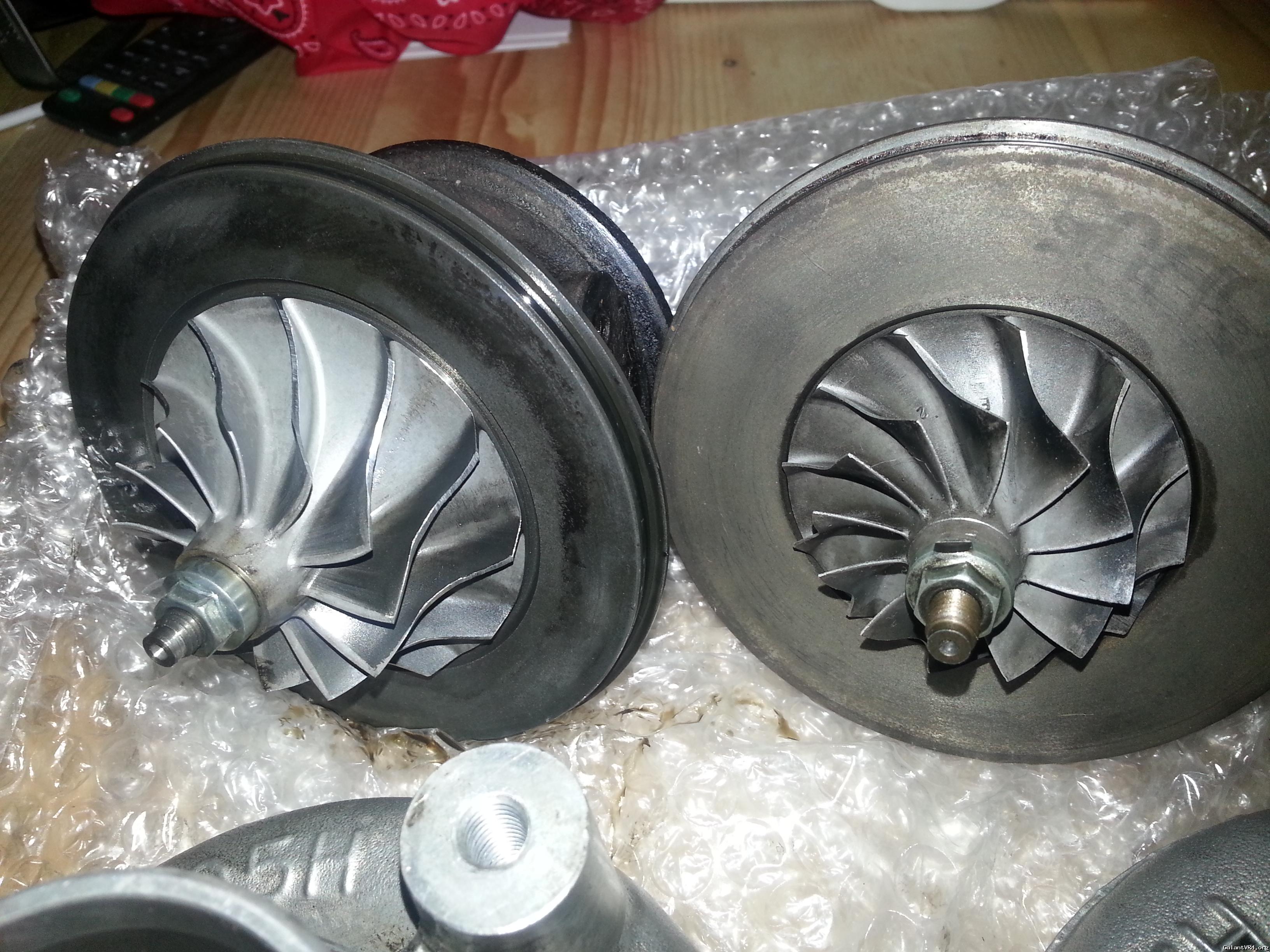

My thanks to transparentdsm for the huge favor at his own expense.
I am sure Tucson despises following my car in traffic. Drive too slow they tailgate and get frustrated. Maintain flow of traffic and they get the smokescreen. Just helping to build the status of our brand.
jrtech
Feb 18, 2012
80
Mexico Toucher
Looks like someone swapped the turbine housing at some point with a MHI 7cm. Makes sense. The P.O. was a huge DSM guy. Less is more when you sell a car I guess.
Edit: Looks like I did not have a 14b. This compressor wheel is bigger. Car feels exactly the same as my previous 91 that was showroom stock.
jrtech
Feb 18, 2012
80
Mexico Toucher
Looks like a 17c wheel based on precise measurement with a carpenter's square. Too bad the car has none of the supporting mods except for fuel pump.

Quoting jrtech:
I run a 20G on a stock JDM Evolution with no real 'supporting mods', which I guess would be the stock 510cc injectors, larger FMIC/piping and different MAF/ECU combination. Seems to run fine.
