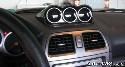

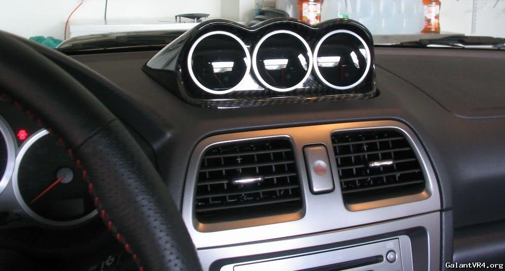

Does anyone know where I can find one like this one that they make for the subie's. I would like to add some more gauges to 261/1000 but I dont like them down below next to the radio.

^ Just to expand on this: It's from the GS with electronic controlled suspension (ECS), and is for the suspension controls. It goes in the pocket where the badges are, and requires cutting the dash mat to fit iirc.

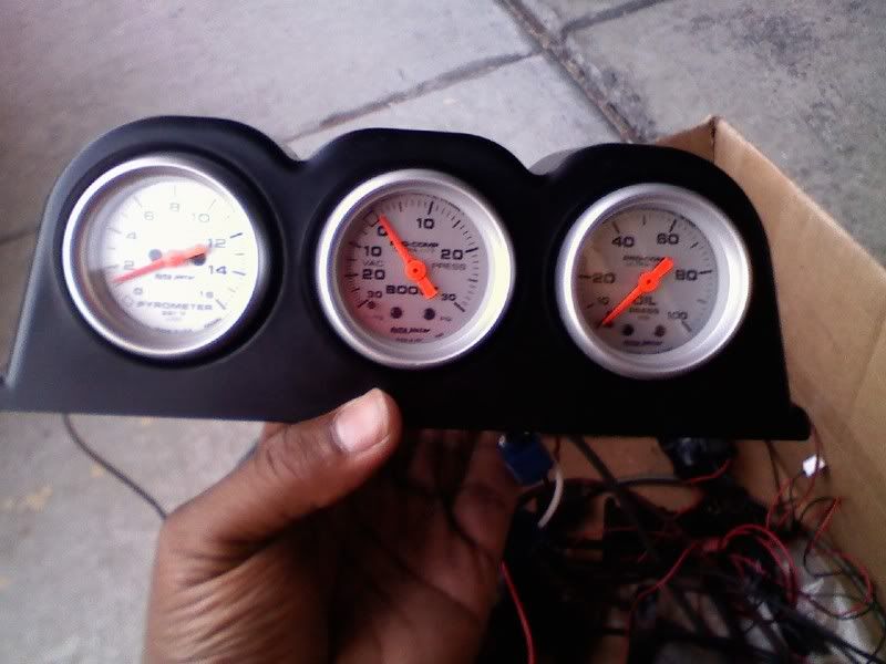

This is the only thing that I can think of.
Click
When going this route, make note that you have to grind quite a bit of material out of the actual pod to get a gauge to sit flush. I never quite got mine to sit right so I cut the plastic on my gauges to fit. I was a bit disappointed in the piece as far as fitment, but after grinding and trimming of the pod and gauges I got them to sit how I expected.

Yea I saw that I was looking for a 3 gauge pod though I emailed paulo iirc the same link above about making ones like the subie's said it was too limited of a car for resources. I may have to design and fab something up for myself and terror dont want to be looking down at gauges while driving thats why I wanted them top mounted...

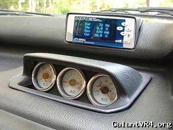

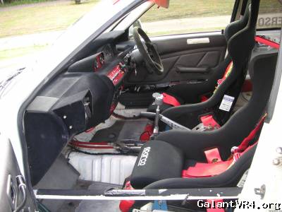

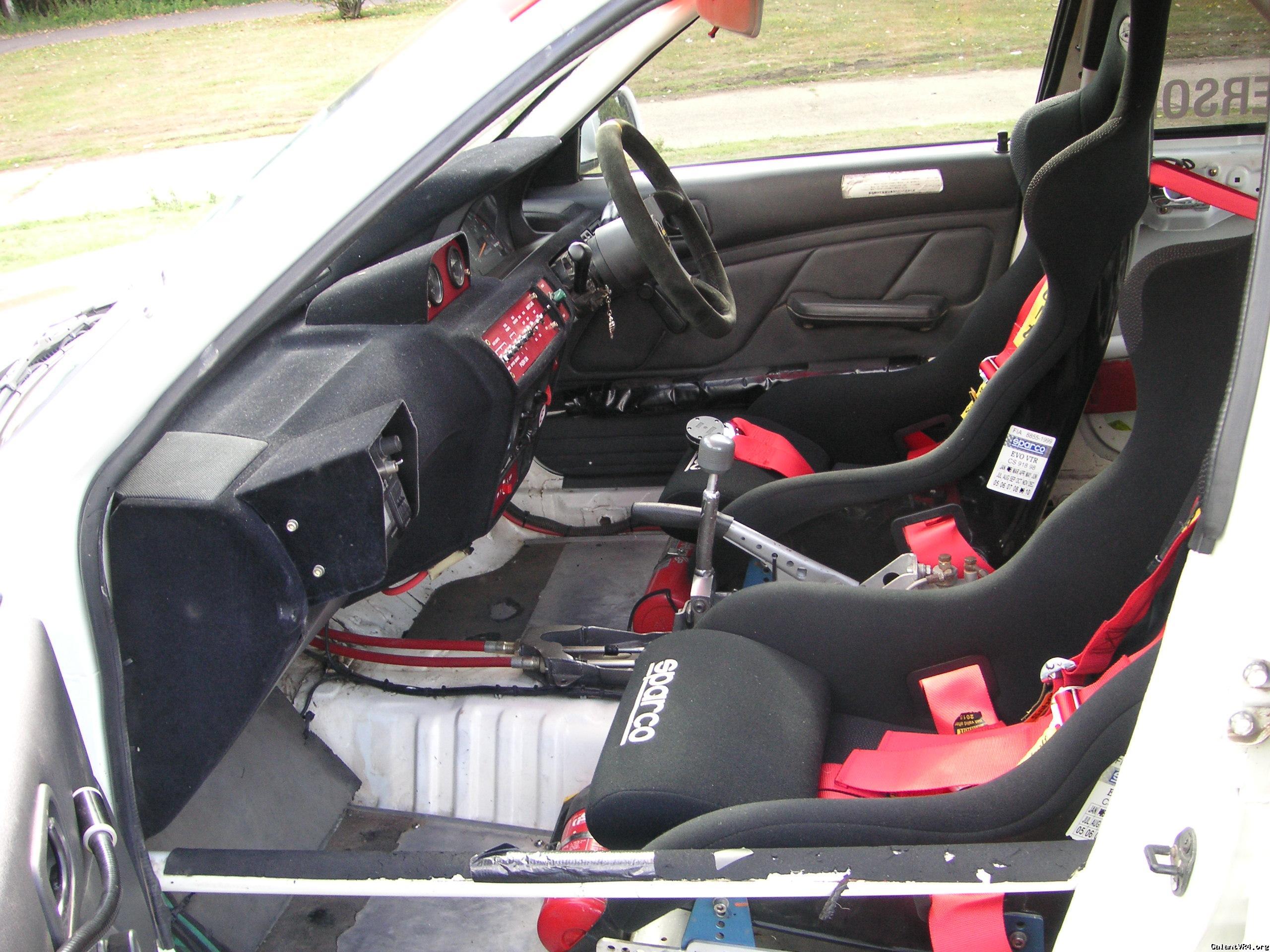

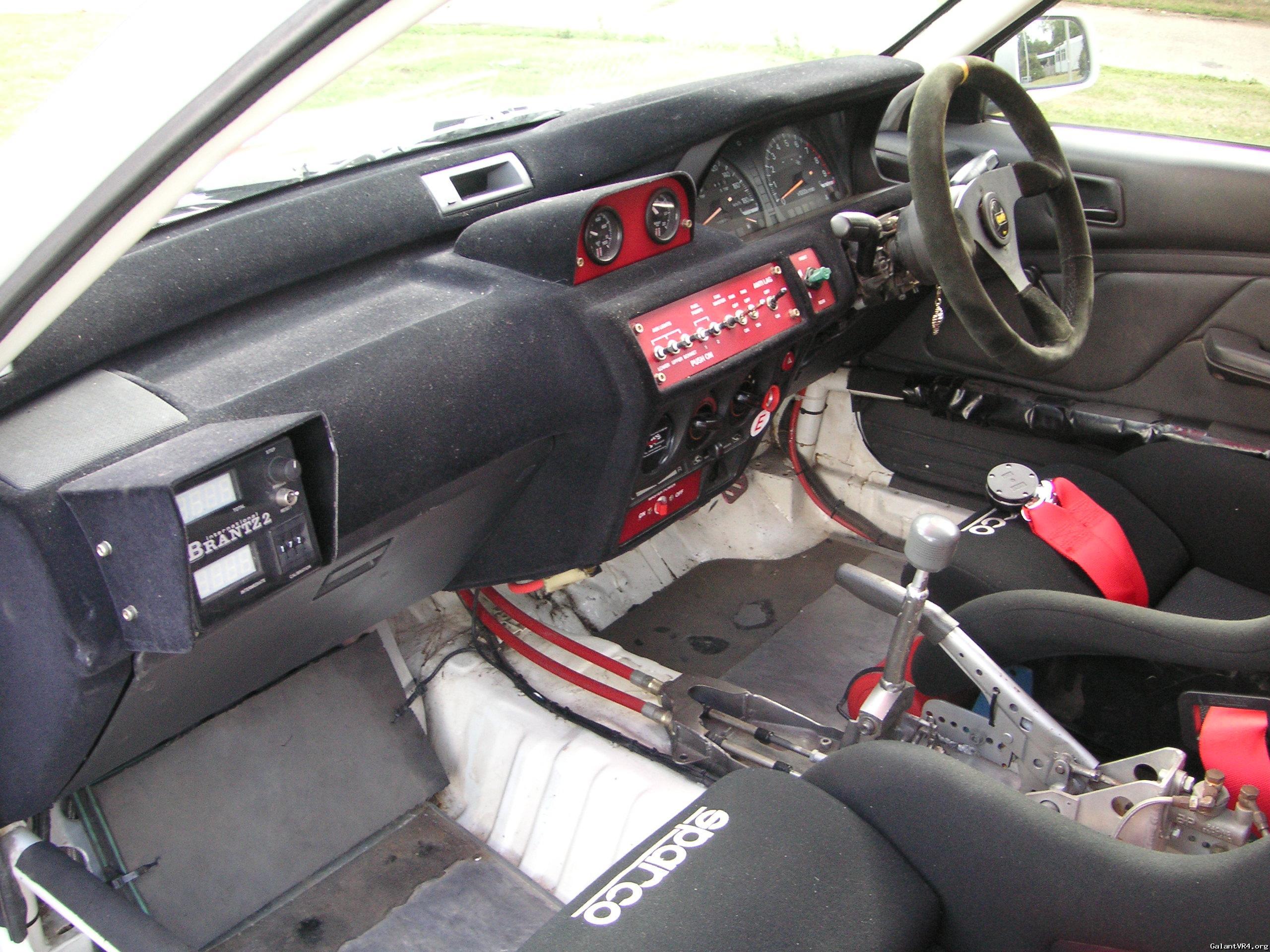

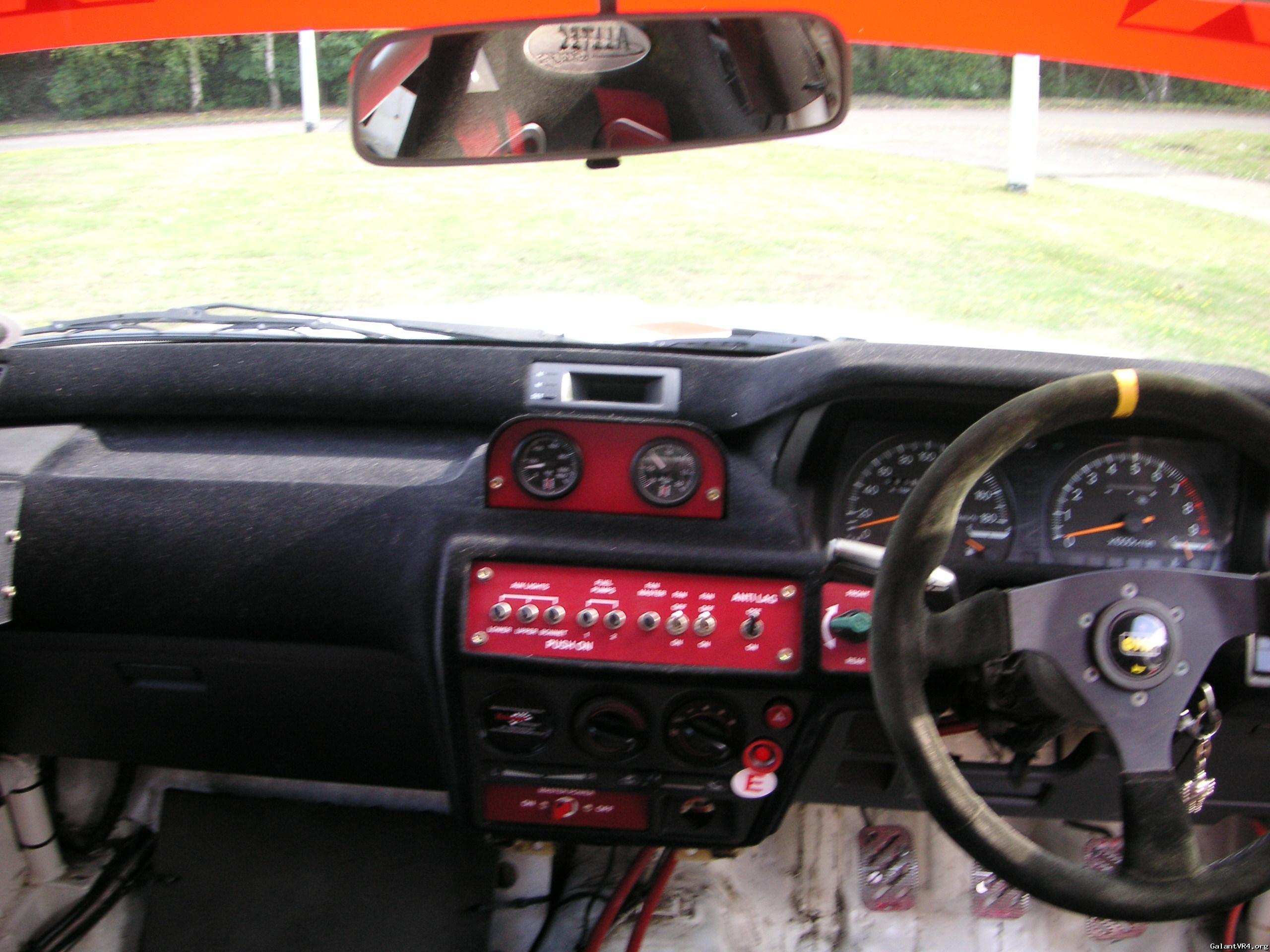

If you use small gauges you can fit three in the dash pod like this;

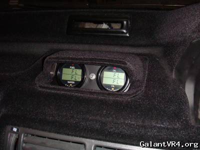

52mm gauges do fit if you fabricate your own mounting plate behind the gauges but if you use analog ones the top and bottom of the display can get cut off. I used dual digital gauges from SPA. This actually gives you four readouts;

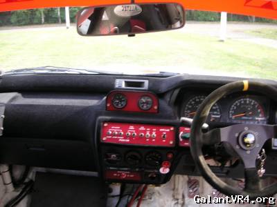

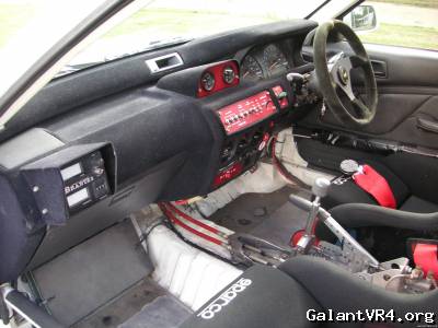

Edit: Or you could fabricate something like this;
As Mr. Gravel did !!!
