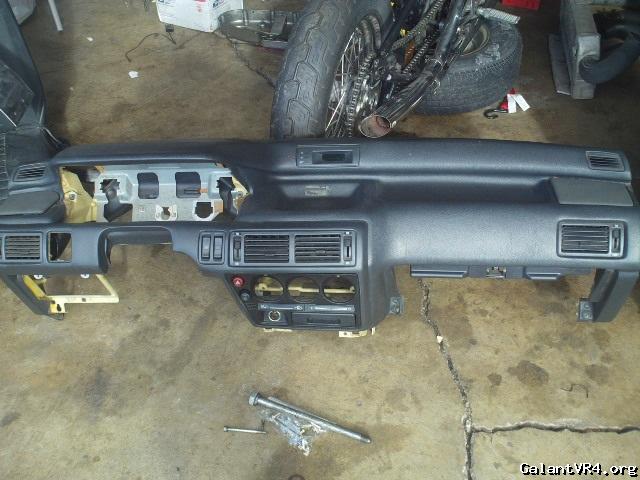

Centre dash A/C vent.. No probs as the dash will be coming out, need it out to get the a pillar off intact

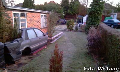

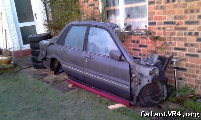

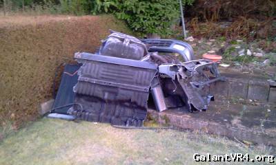

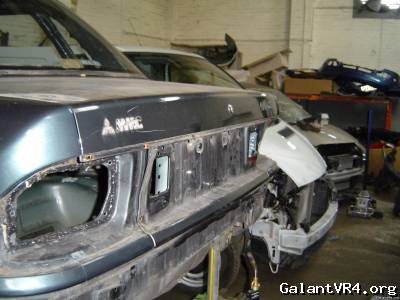

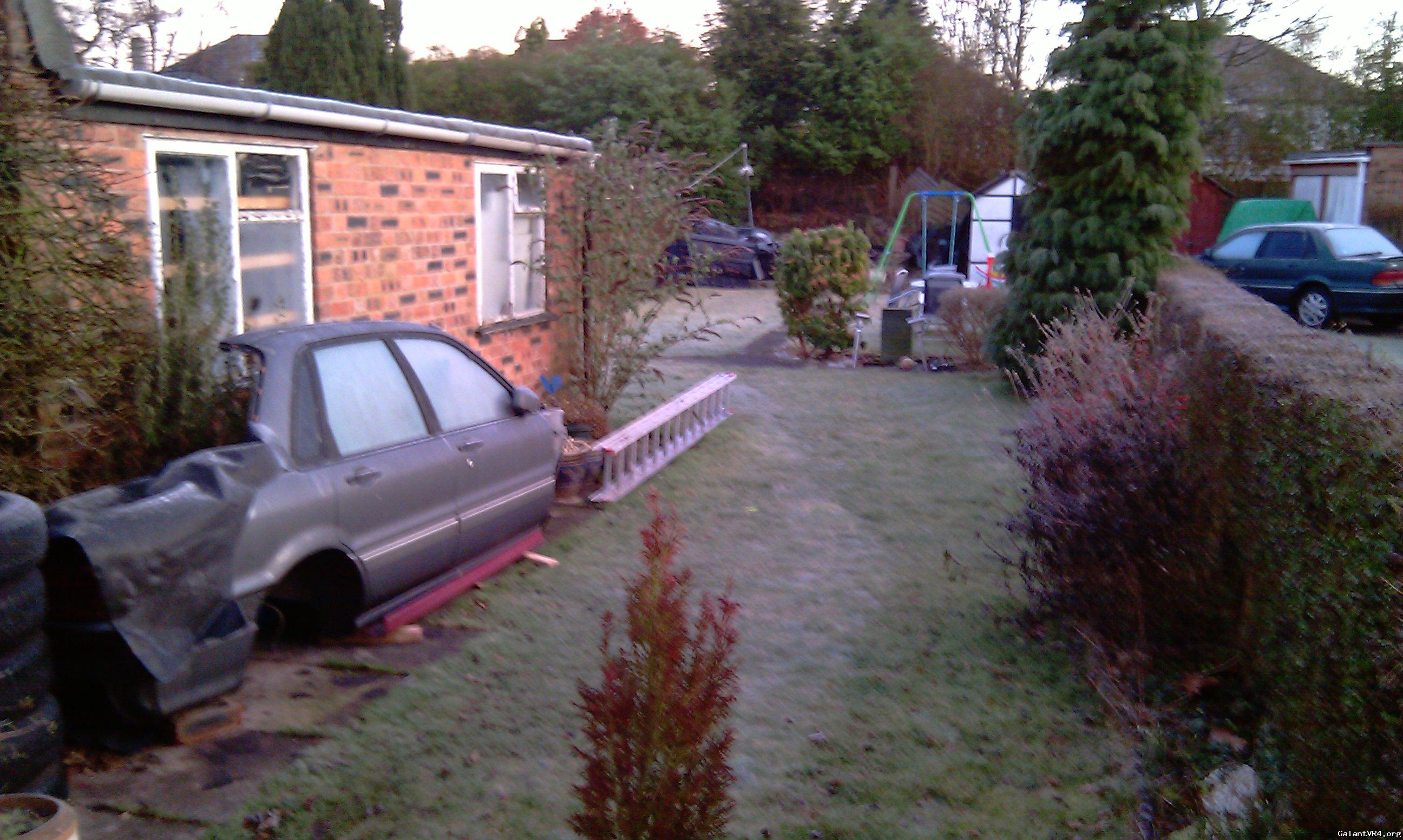

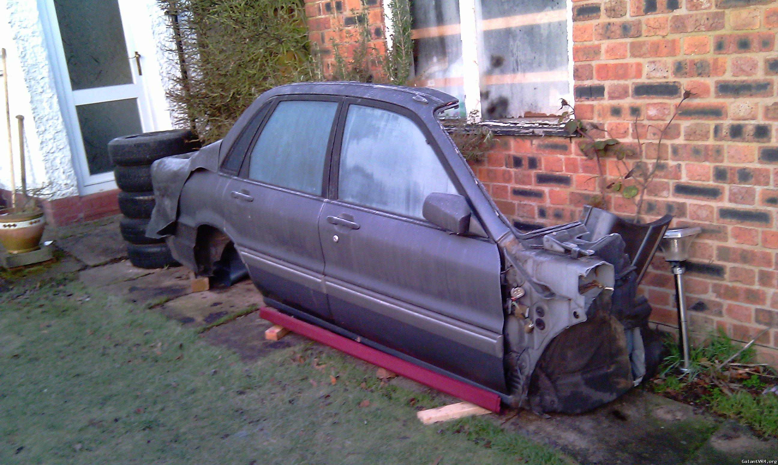

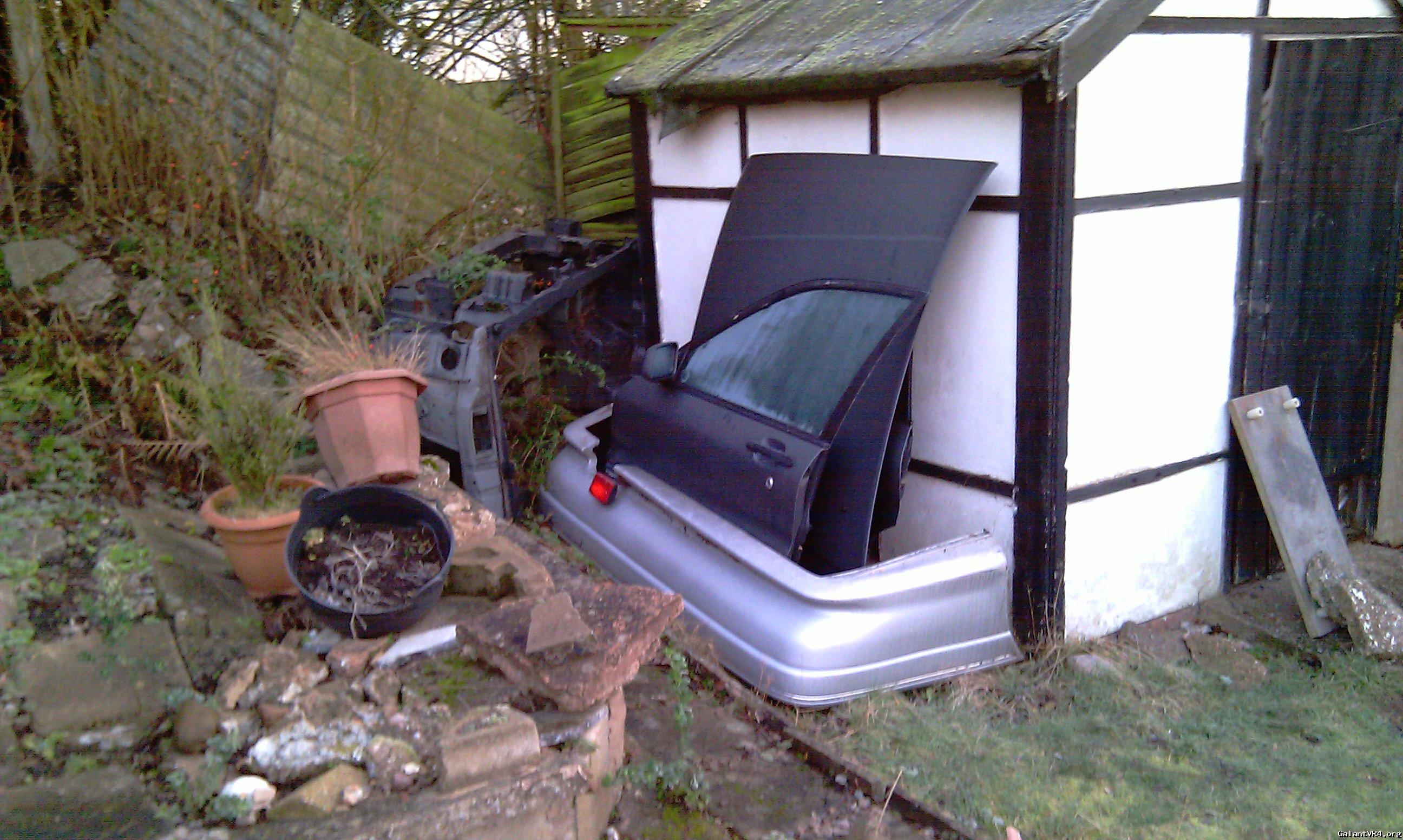

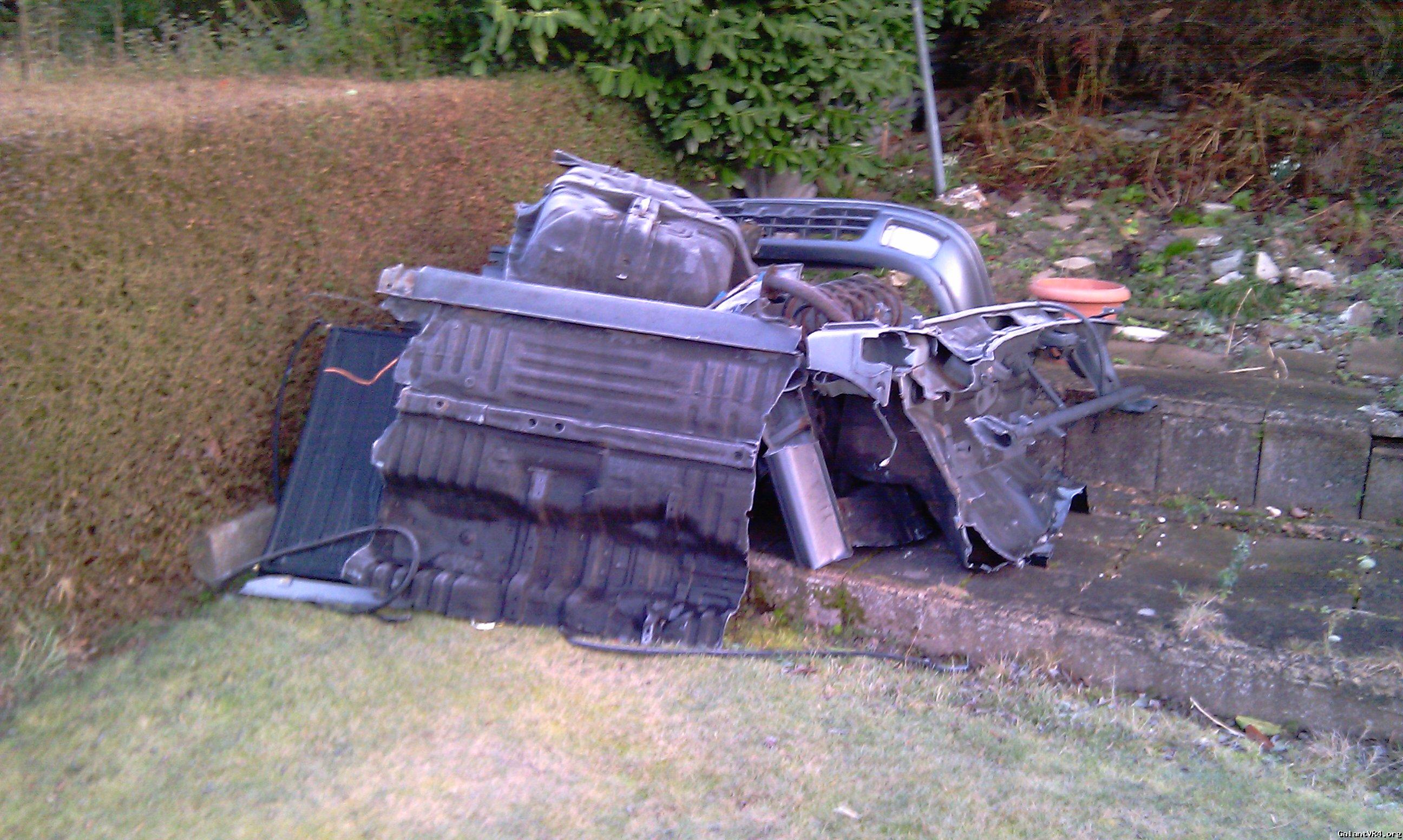

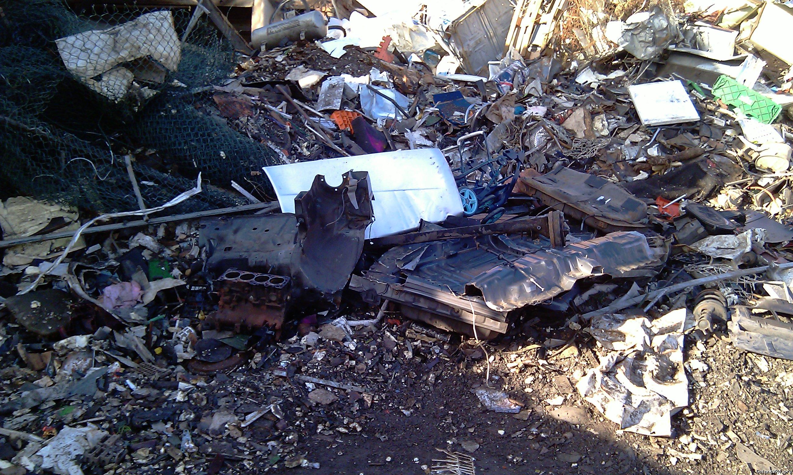

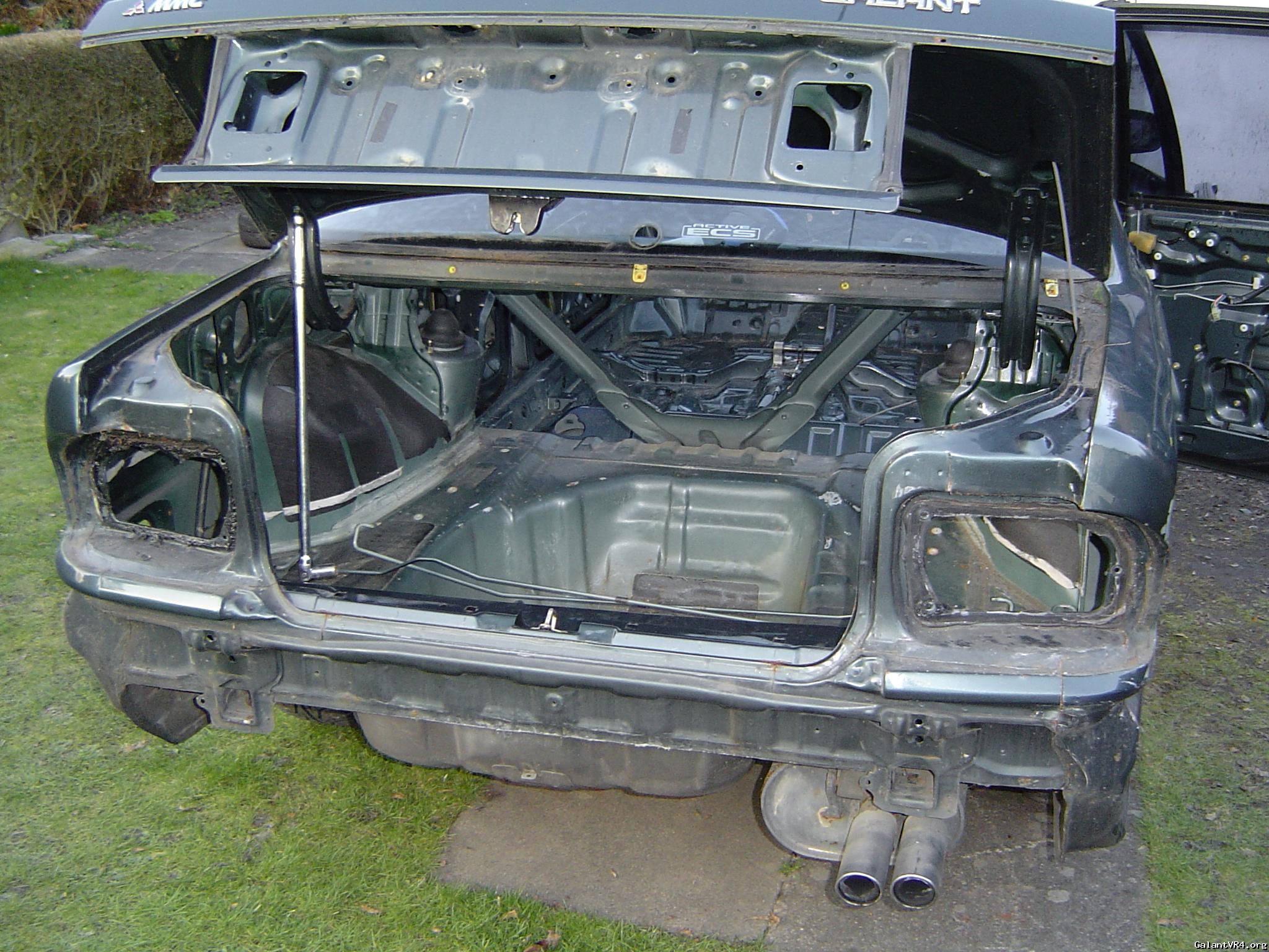

Inspection lapsed on the grey car 20 something of january and then its illigal to drive without. So its been broken up:

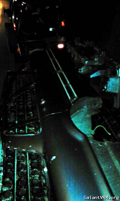

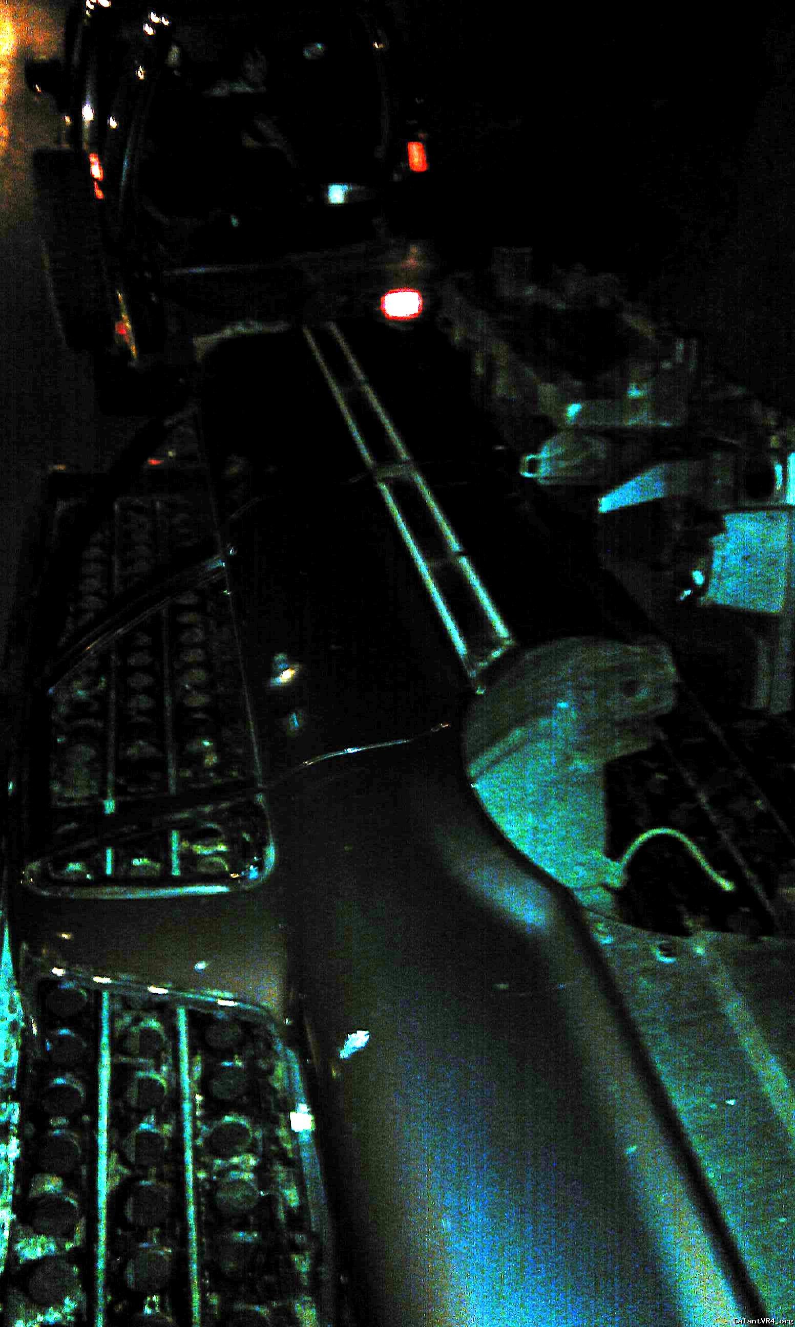

So heres the repair kit <img src="/ubbthreads/images/graemlins/smile.gif" alt="" />. Jig man said he wanted the side of the donor +1' of floor and roof. All the panels to go to the bodyshop are neatly arranged next to the Garage. Mate said when he saw "someone appears to have parked a garage in your car"
This lot then was kept to one side to weigh in and reclaim some value.
Aluminium went first got £32 then this lot went off and netted £70 <img src="/ubbthreads/images/graemlins/smile.gif" alt="" />. Also the paperwork was filled out to officially scrap the car!
kept everything else, other quarter, a and b pillar, sunroof mech, front crossmembers, full interior.
now starts the clearup in preparation of stripping the green car prior to its rejuvination.

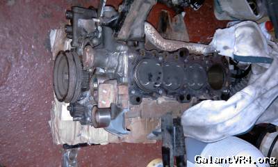

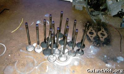

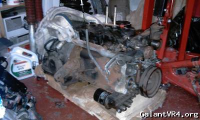

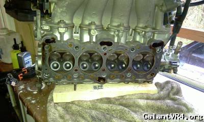

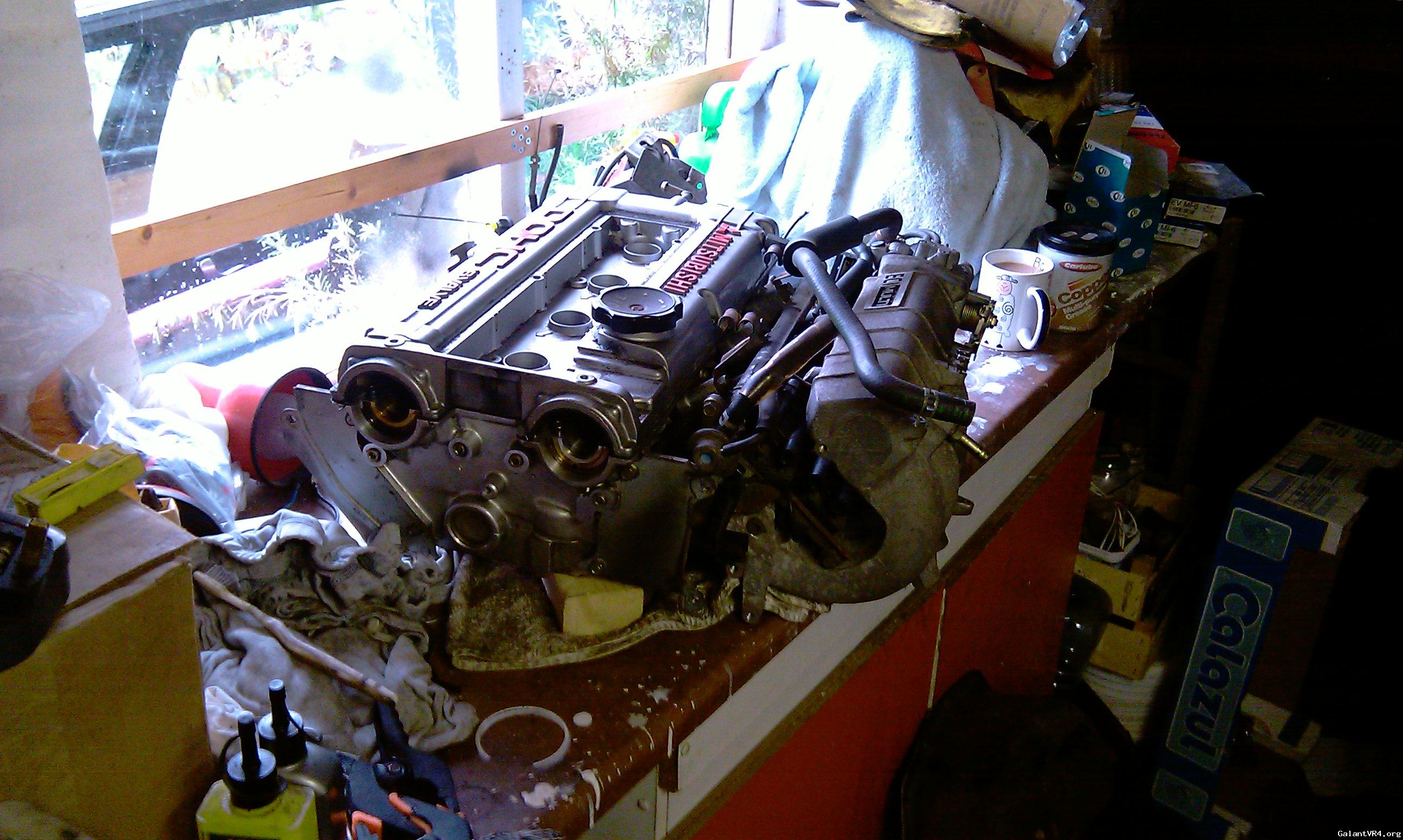

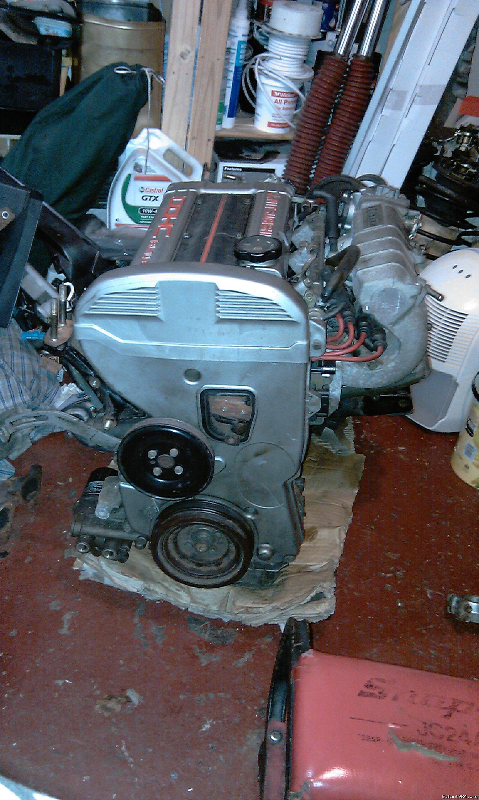

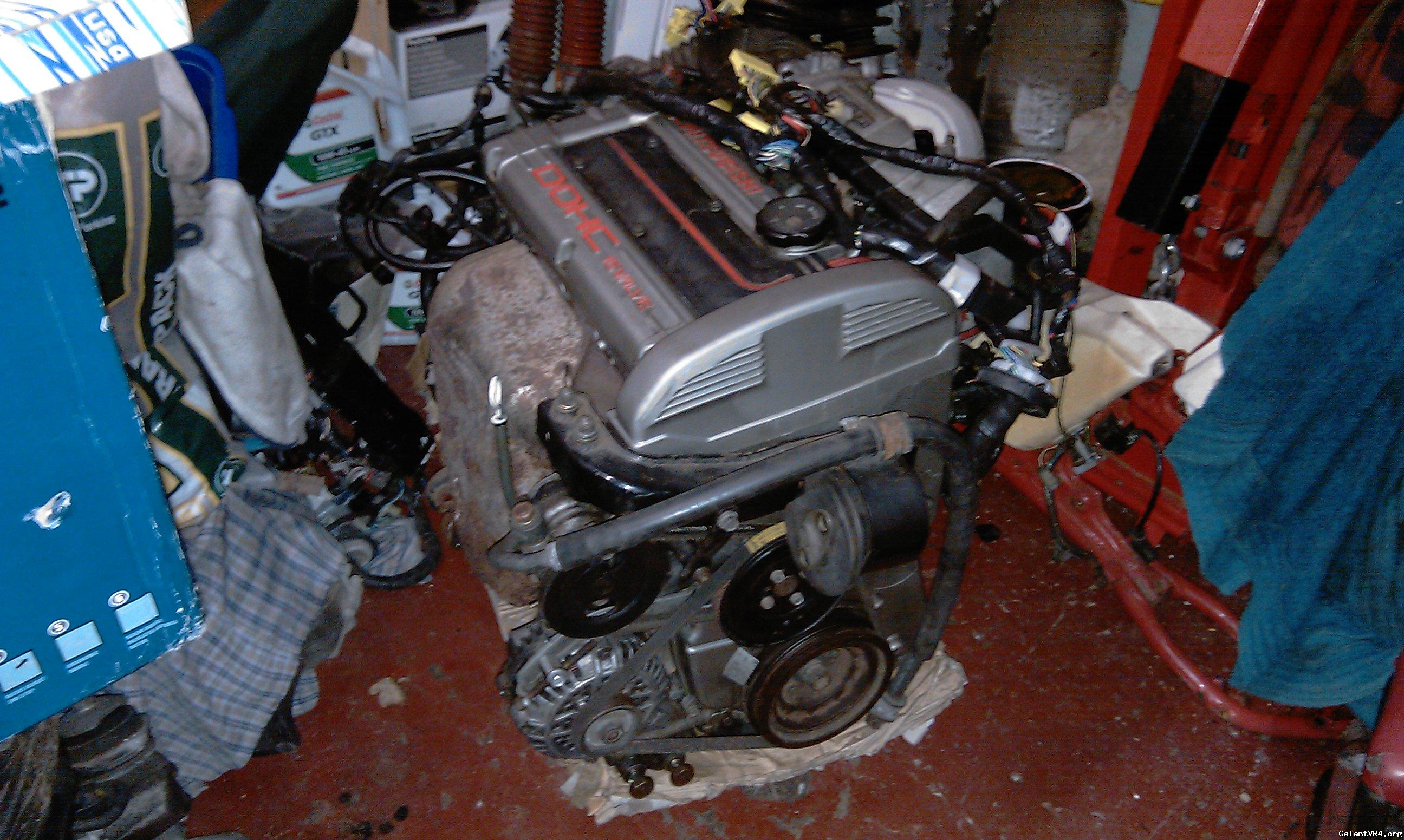

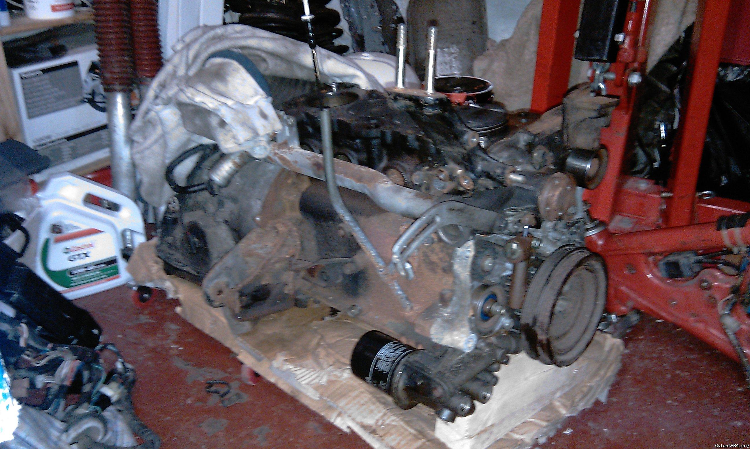

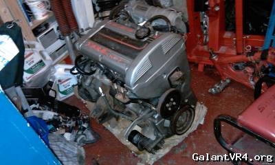

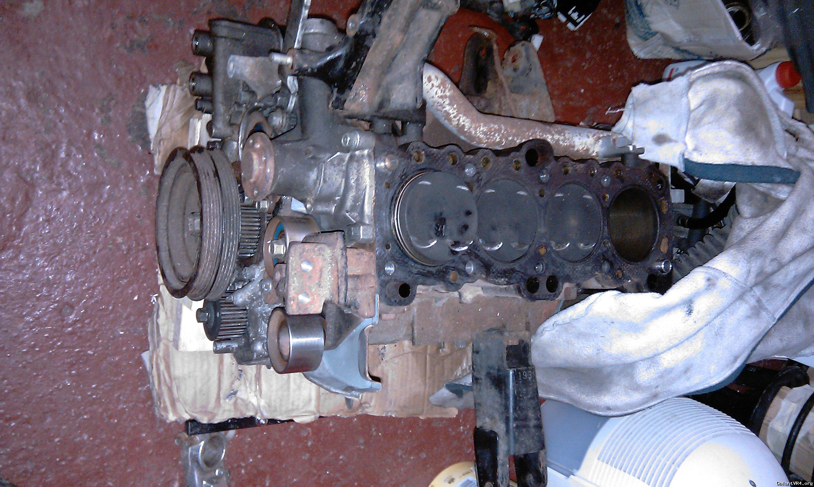

heres the cars orig 16v conversion motor that came out in 08 with 16 bent valves.
lots of shiny smiles on the piston which need to be lifted out, dressed and reassembled.

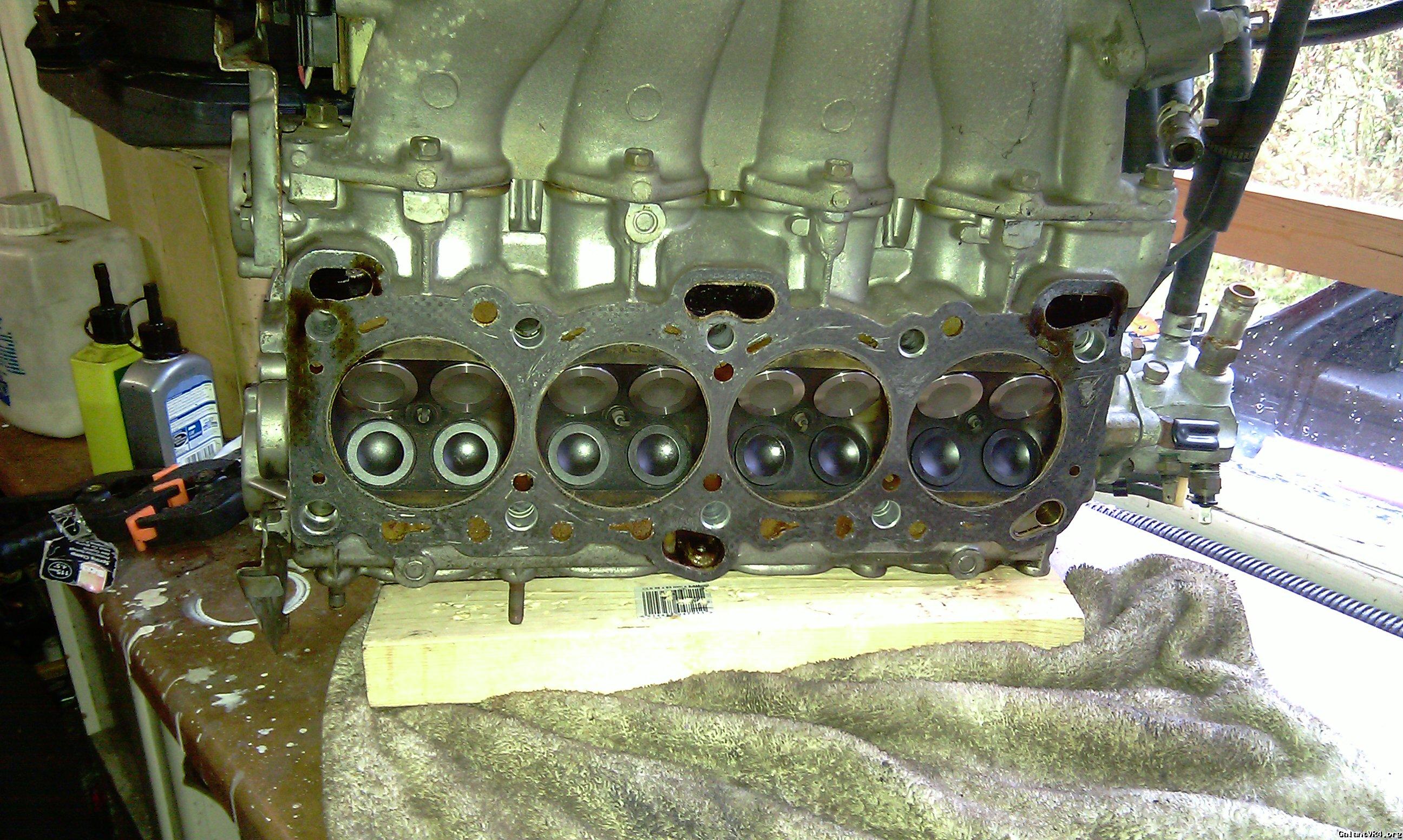

Heres the head done and ready to go back on (that was the evenings this week and lapping valves and removing old gaskets works wonders when your brain needs to be diverted to clear your mind.
looky 16 shiny newly lapped valves <img src="/ubbthreads/images/graemlins/smile.gif" alt="" />
Apologies for the cell phone pics... hope you enjoy them ;0

Thats not somthing you see every day. Half a car leaning against a house haha.
Btw let me know if you decide to part with that rear bumper /ubbthreads/images/graemlins/wink.gif
Second in line for bumper. Need a front too /ubbthreads/images/graemlins/grin.gif

Rears i'll be keeping. Front is looking for a home though. I think its going to be heading to brighton /ubbthreads/images/graemlins/wink.gif

Engine looks great btw, i can't wait to see this car being put back together.

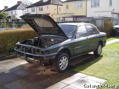

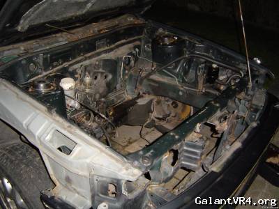

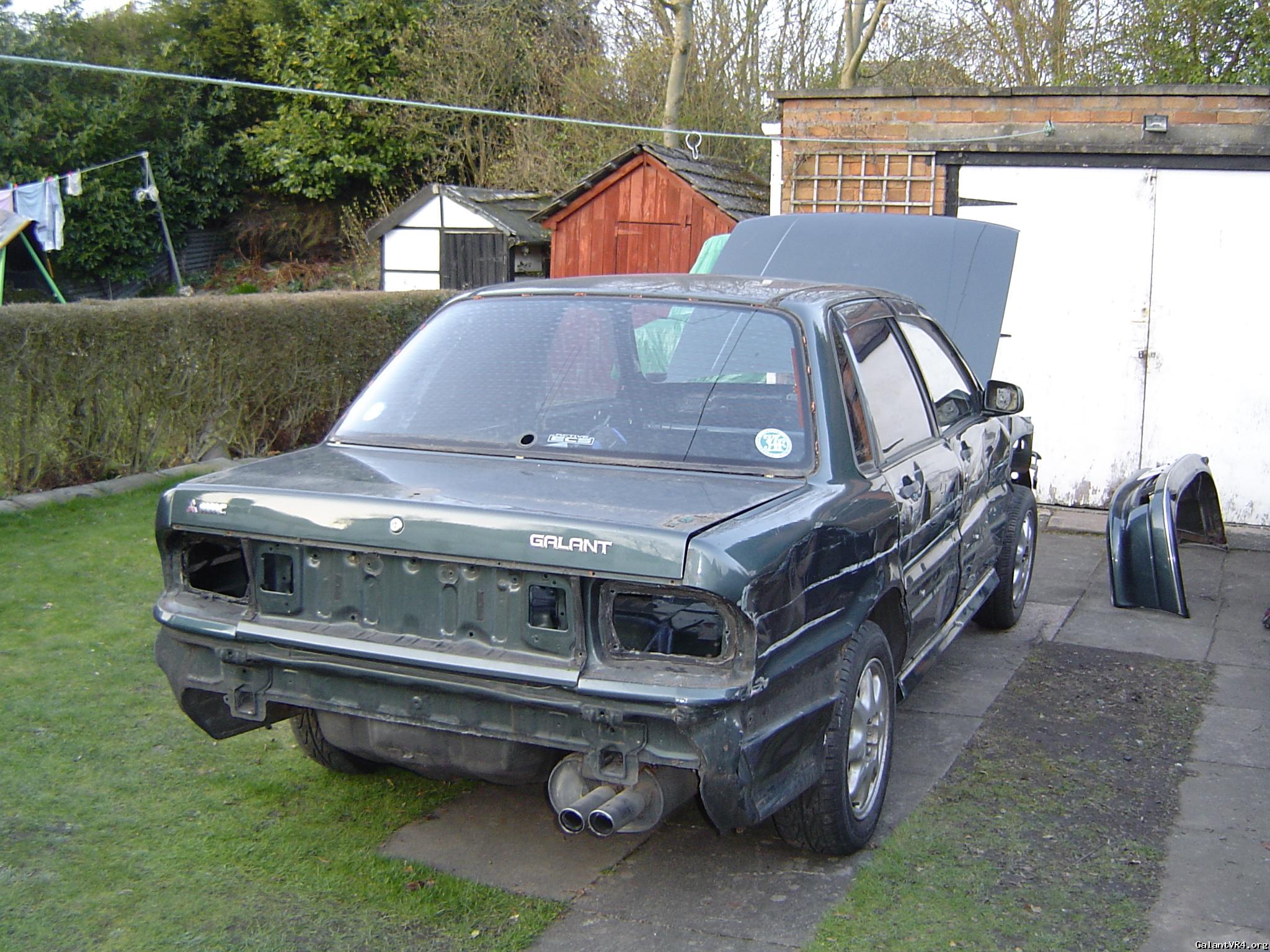

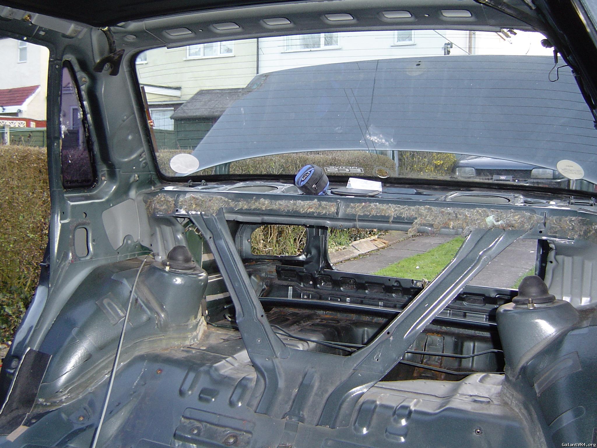

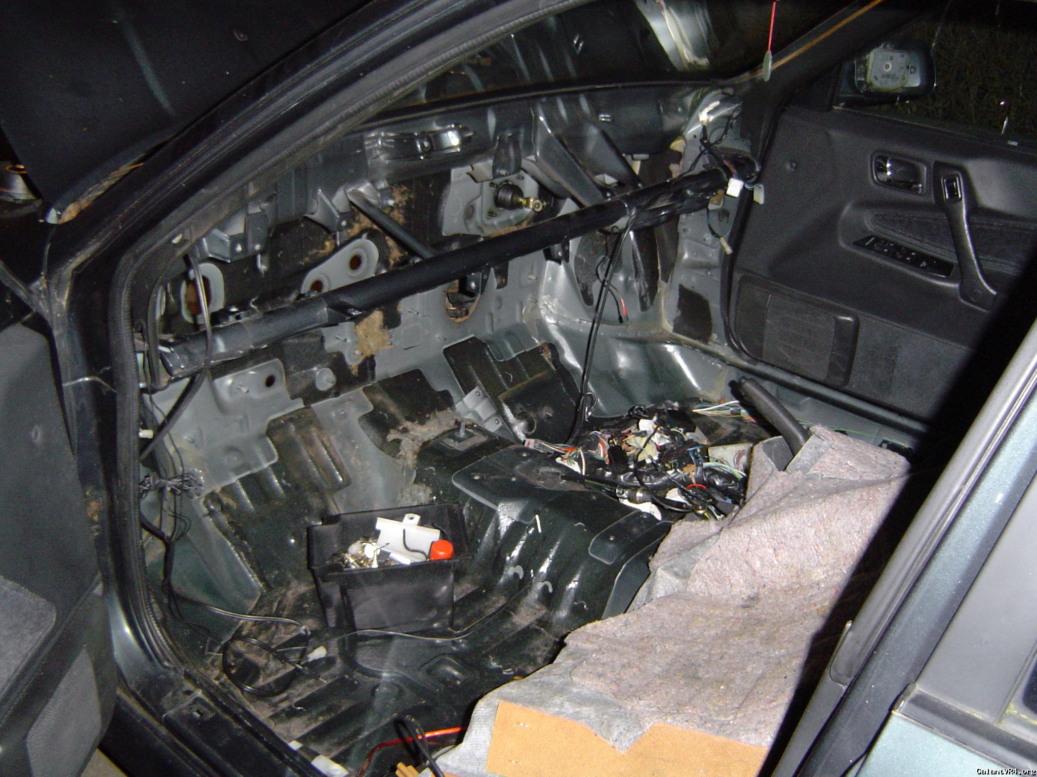

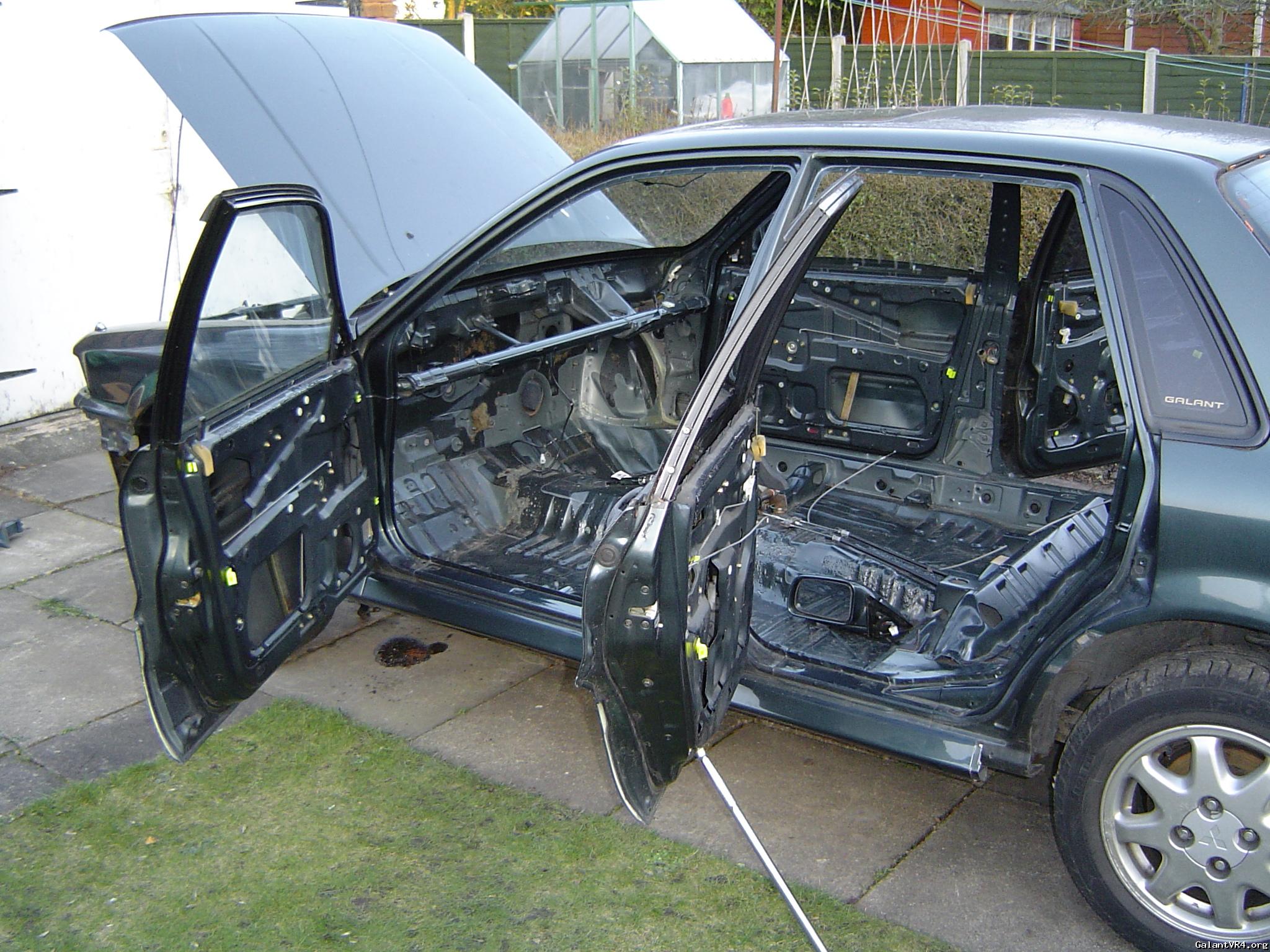

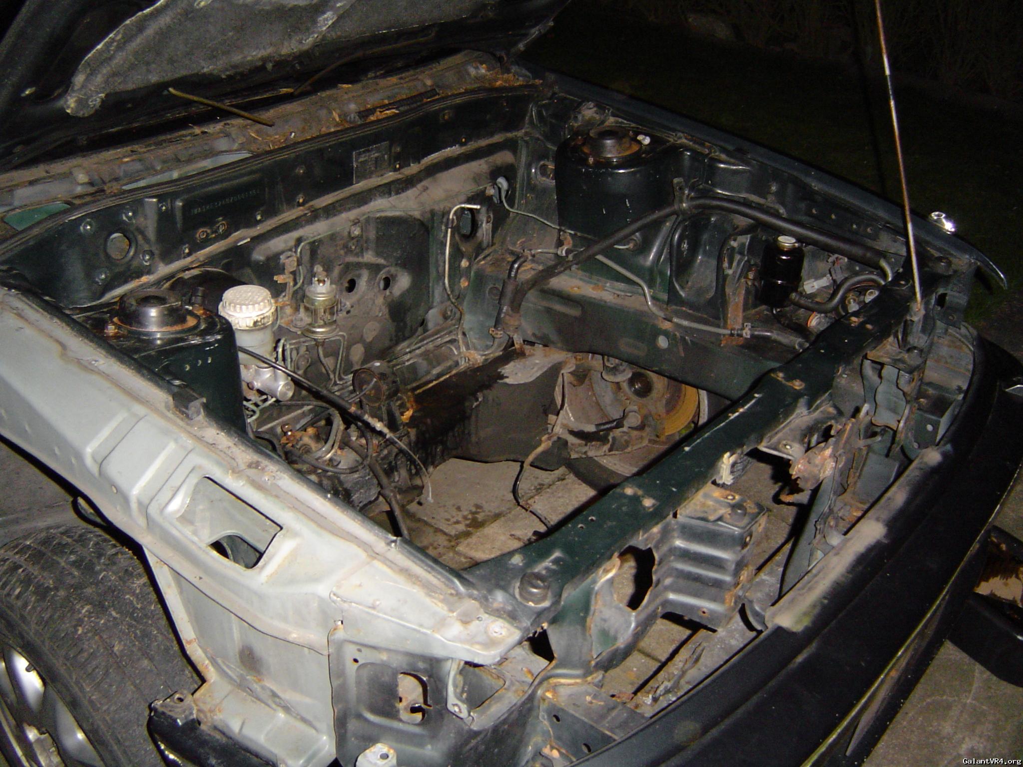

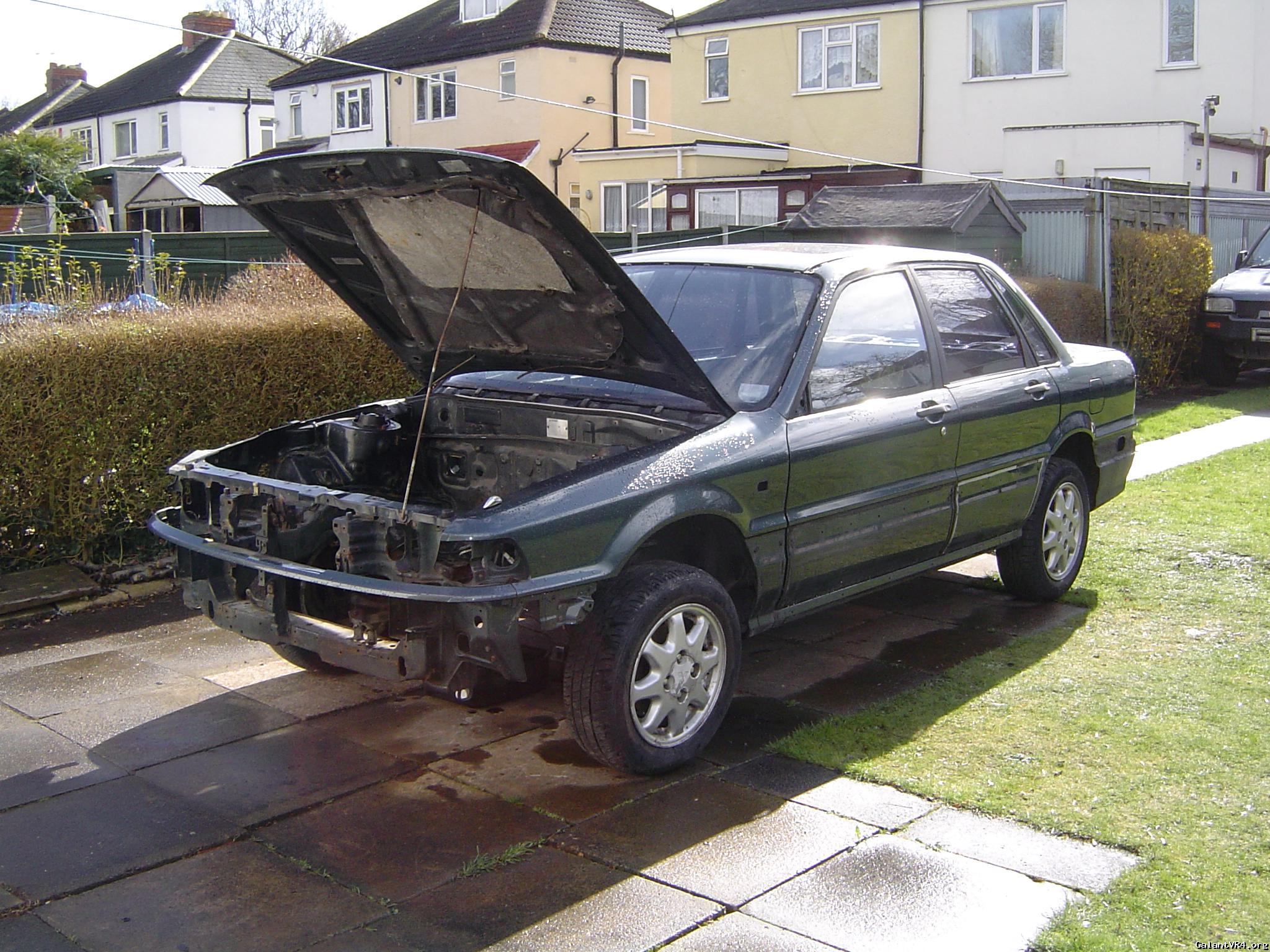

The teardown started today! took the camera out with the intention of taking lots of pics, but the front is stripped <img src="/ubbthreads/images/graemlins/smile.gif" alt="" /> bumper and suspension legs hung back on so it can go back on the ground.
Jig man has a recovery flat bed so he'll come and get it when it's ready (hoping it'll be ready on wednesday). Still one bonus now I can see it properly is the firewall is straight, the pillar has rolled behind it. I can't work out where or if the cross bar has moved, but later in the week i'll get measuring.
Amazed at the bolts at the bottom of the wings not breaking, there is alot of surface crustyness though (Standing 18 months while we fought out the money didn't do it any favours). Dipping and electroplating is too much $$$ (£2700), how do you use por15? theres a couple of different products they do and i want it done right.

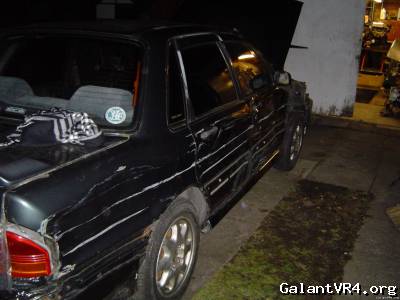

Bodyman is going to come and pick up the car tomorrow (/ubbthreads/images/graemlins/grin.gif)
Parcel shelf is tweaked... Wonder what'll happen on the jig. :)!)
Underside is very crusty, so sand-blasting or the like will be in store....

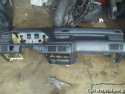

empty car

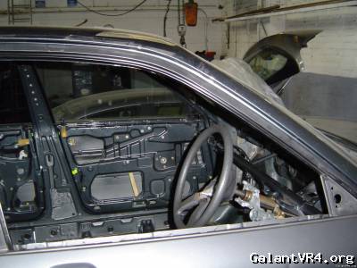

Here where the seatback hooks go there are two folds, looks like its been shoved forwards. Any one who could please can i get some good shots of the shelf area in a bare shell, 2wd or 4wd is no issue as the shelf is the same in both.
I tried fitting the straight doors but the front wouldn't go in and close. Bent doors the windows wouldn't go below 2" off closed. Getting the glass out of them will be a bloody pain. If its nice weather when the car is collected I'll keep the bent doors here so I can chop them up to hopefully rescue the glass.

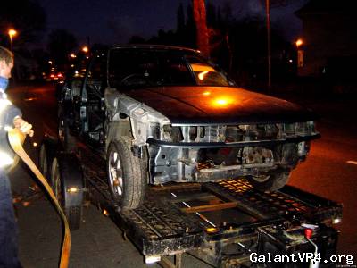

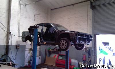

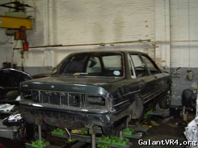

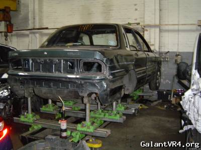

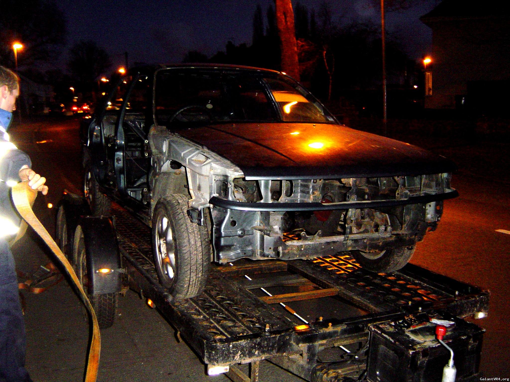

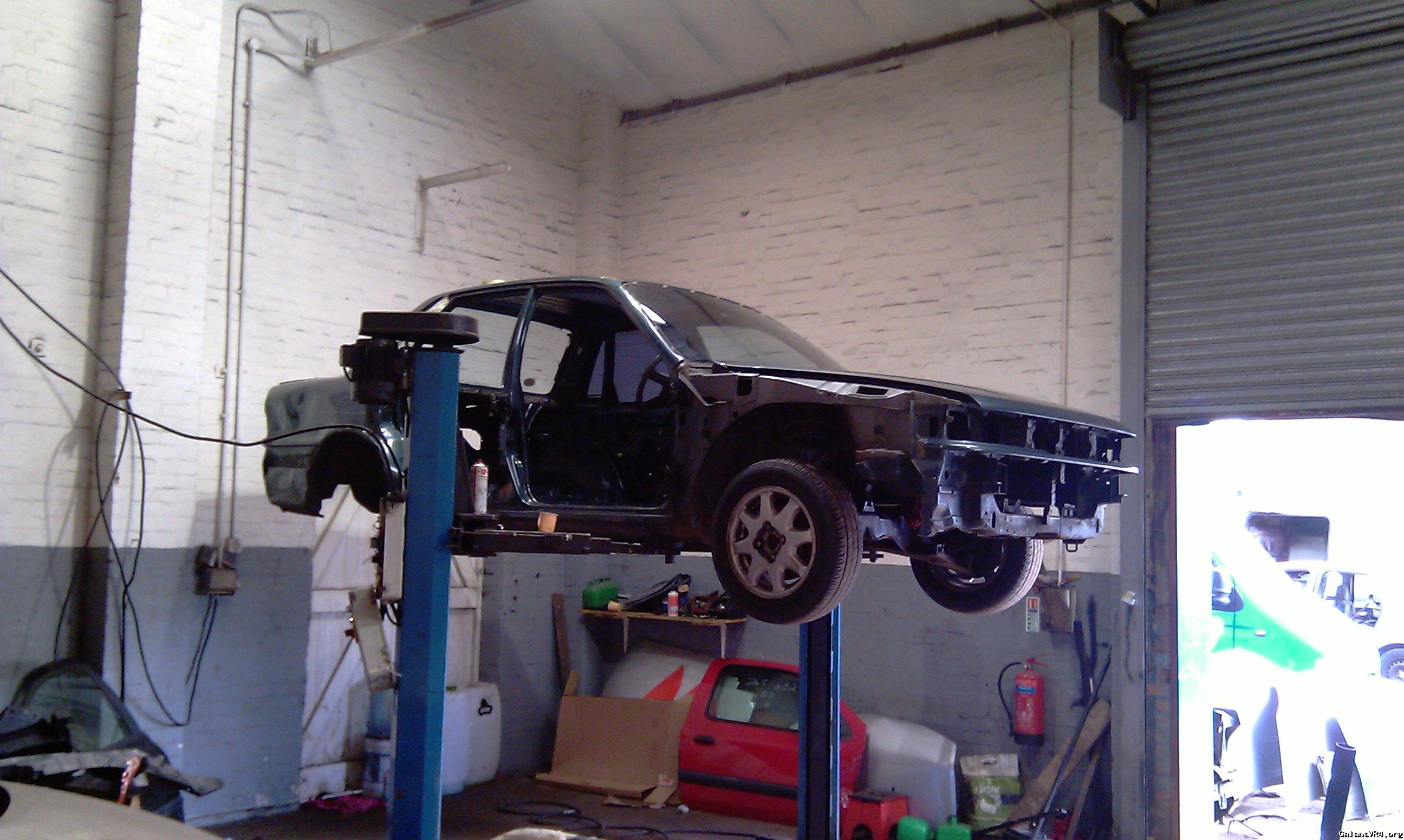

Update. (Apologies for the cell phone pics it's been a bit rushed the last two days!)
After 2 days of fegging around with the bodyshop guys recovery truck being off in oxford or someplace else a very good freind came to the rescue on Thursday evening, here it is loaded up and ready to rock:
Dropped it off about 7pm and then came back to get the side cut and other parts:

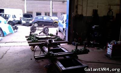

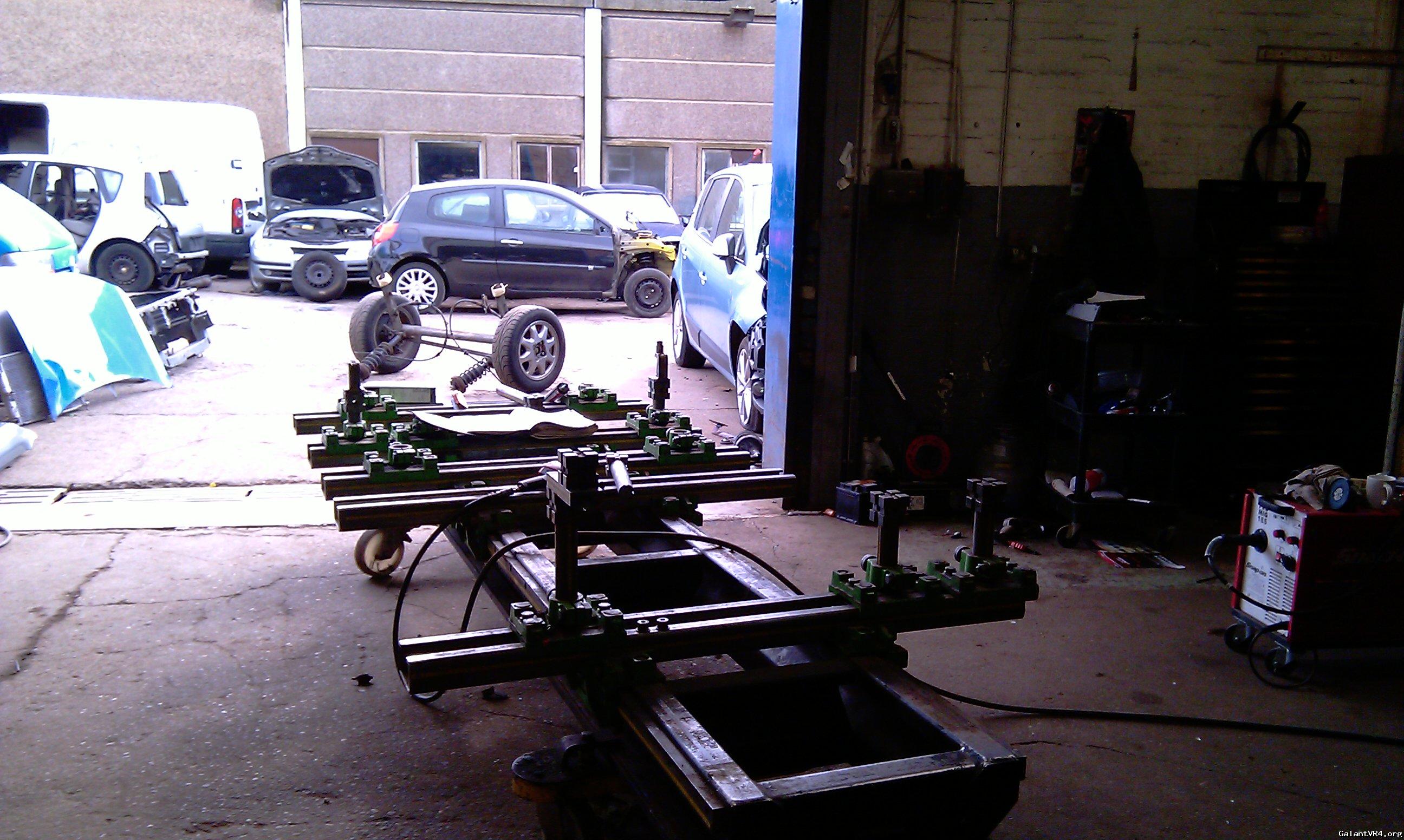

Bodyshop man was a little surprised to see how stripped it was, and I was expecting to be waiting a good while before it found it's way onto the jig so todays trip to drop off the body manuals and some other stuff I got a nice surprise to find this!
and the Jig being prepared:
So its jumped the que of quite a few newer cars and has the full attention of the crew there! How cool is that? The Guy who runs the place is a bit of a car guy and has some interesting (but modern /ubbthreads/images/graemlins/frown.gif ) Renaults and a Impreza STI there so we'll see how this turns out.
At least he'll enjoy working on this as he'll be able to see all aspects of it on the jig, also means we have been able to keep tabs on any secondary damage. Has to be right as this is our family car, and after this process will hopefully be so for many many years to come.

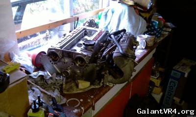

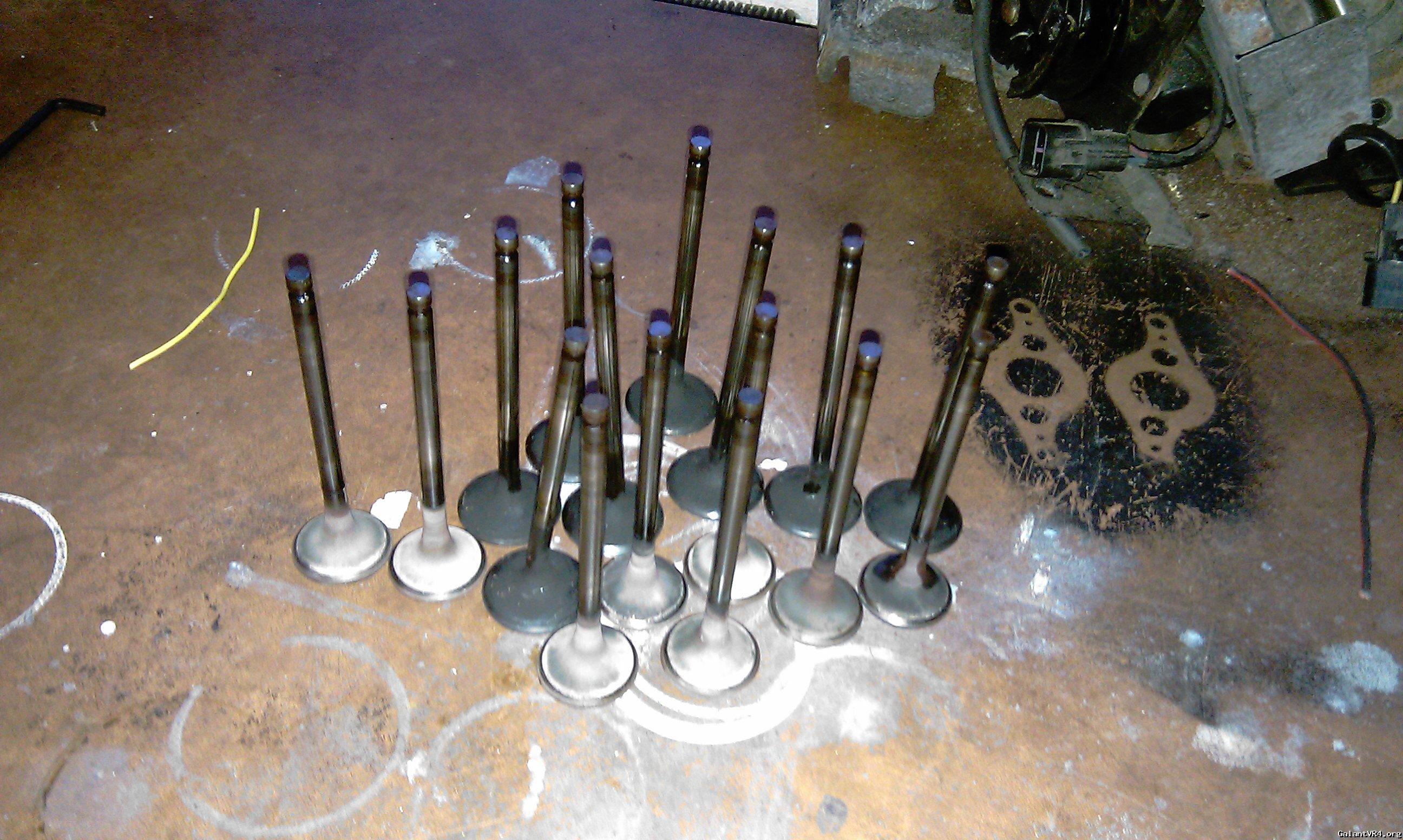

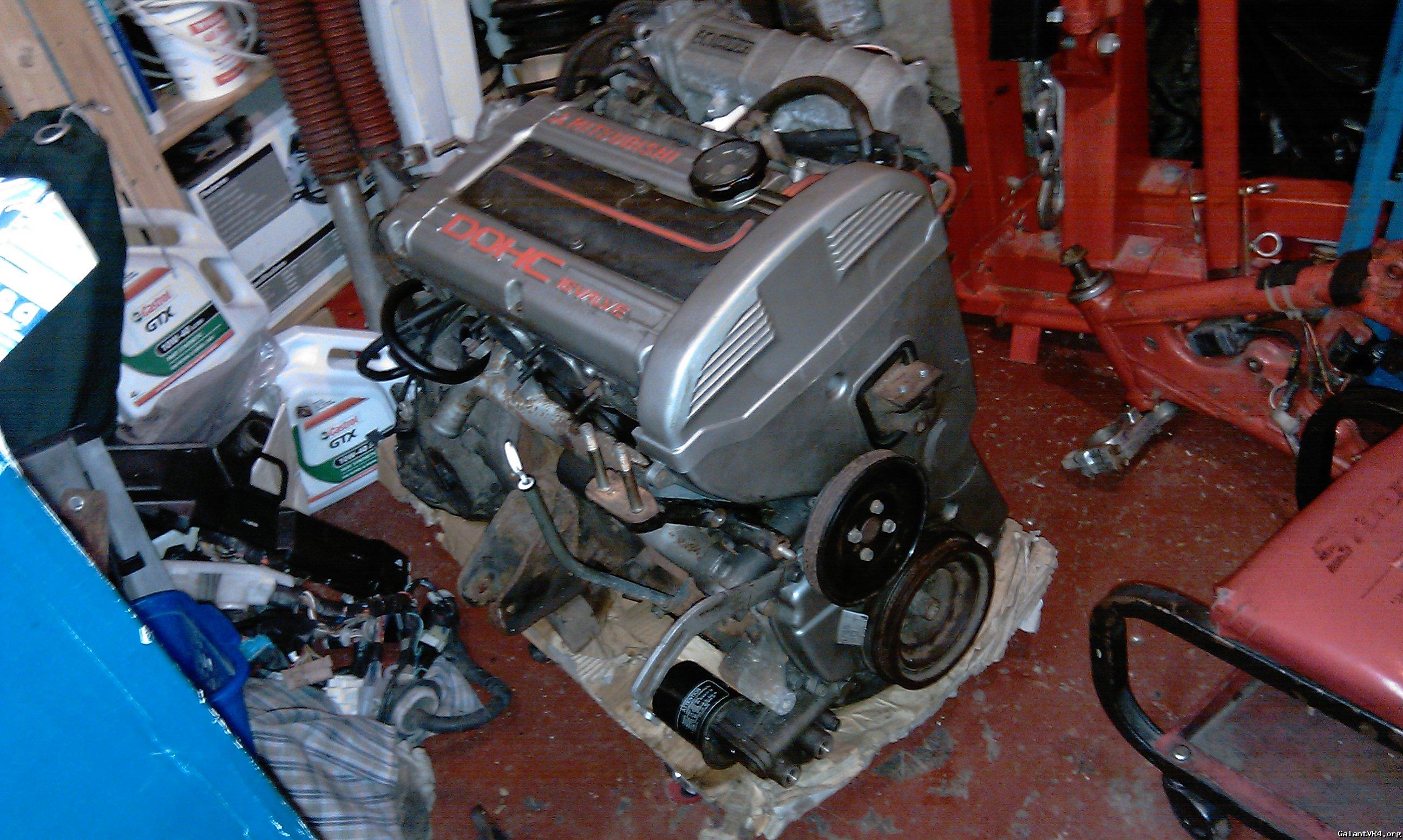

As an aside here are the valves fished out of the lump further up the page (they're in the trash now!)

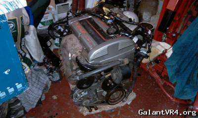

And the lump now assembled with wiring looms etc (still waiting a parcel or two for this though, but nearly there!)

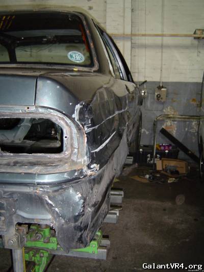

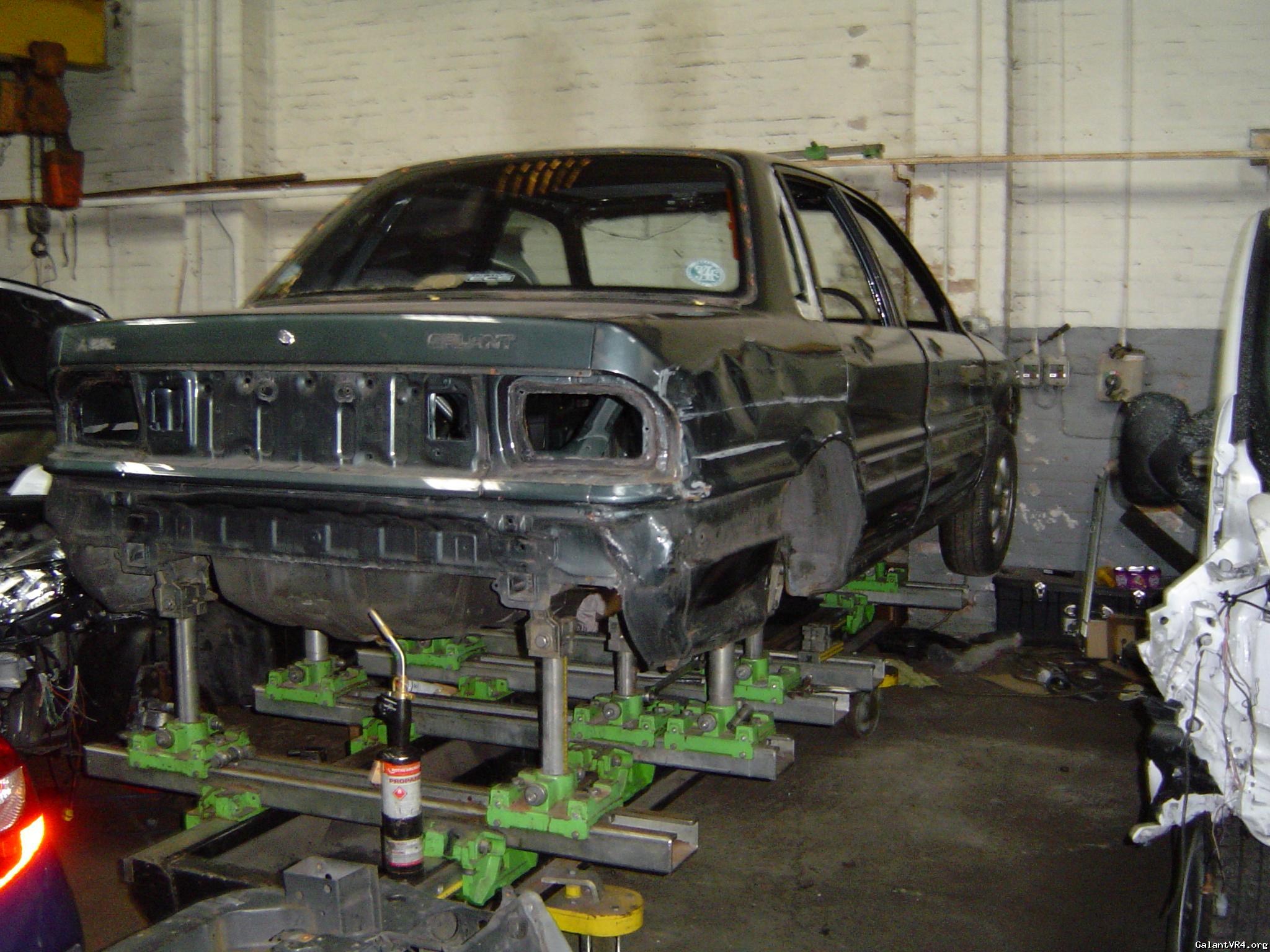

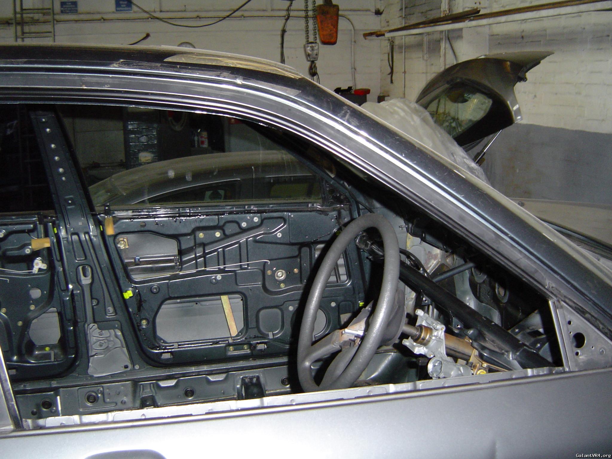

Todays update.

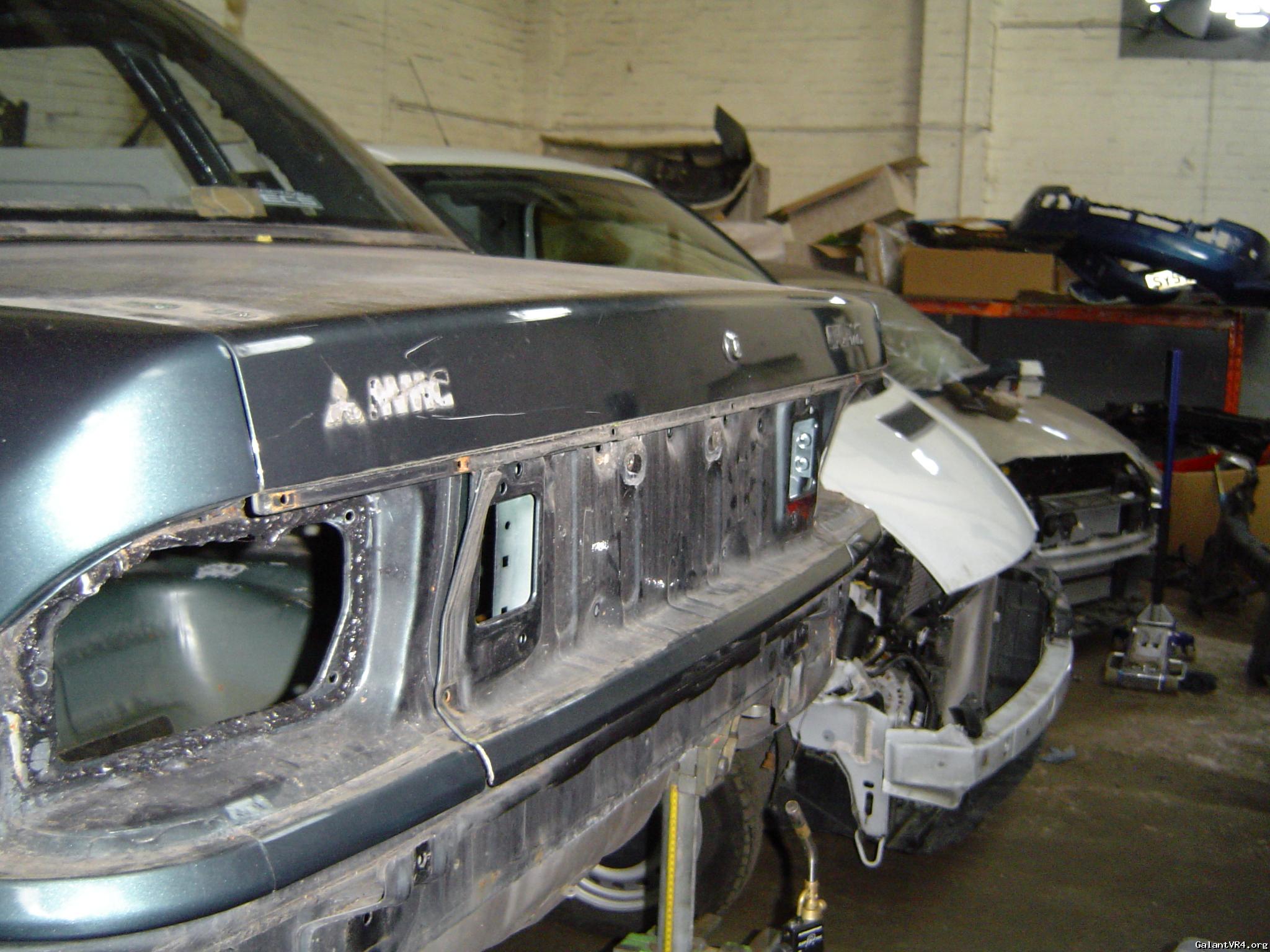

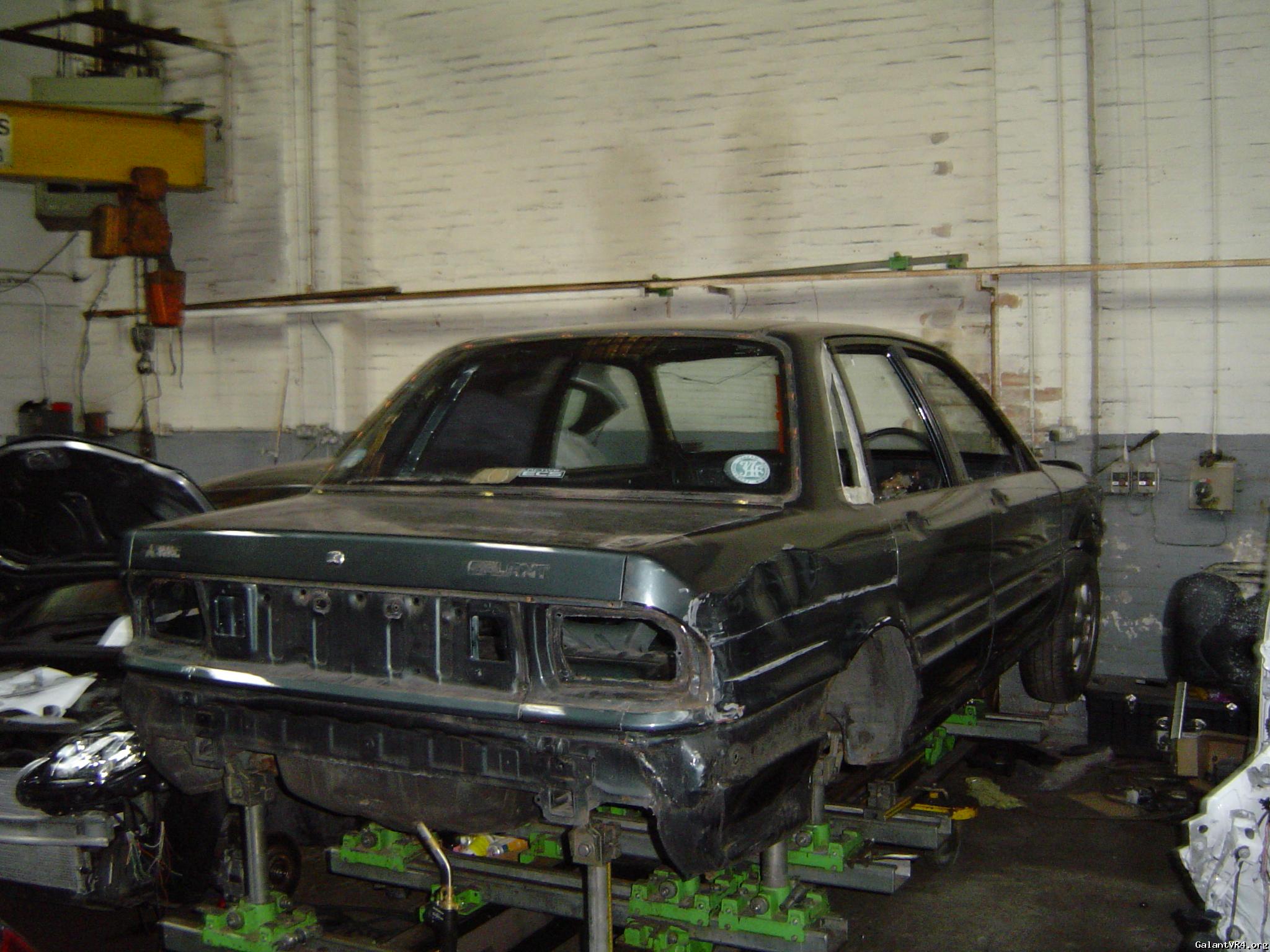

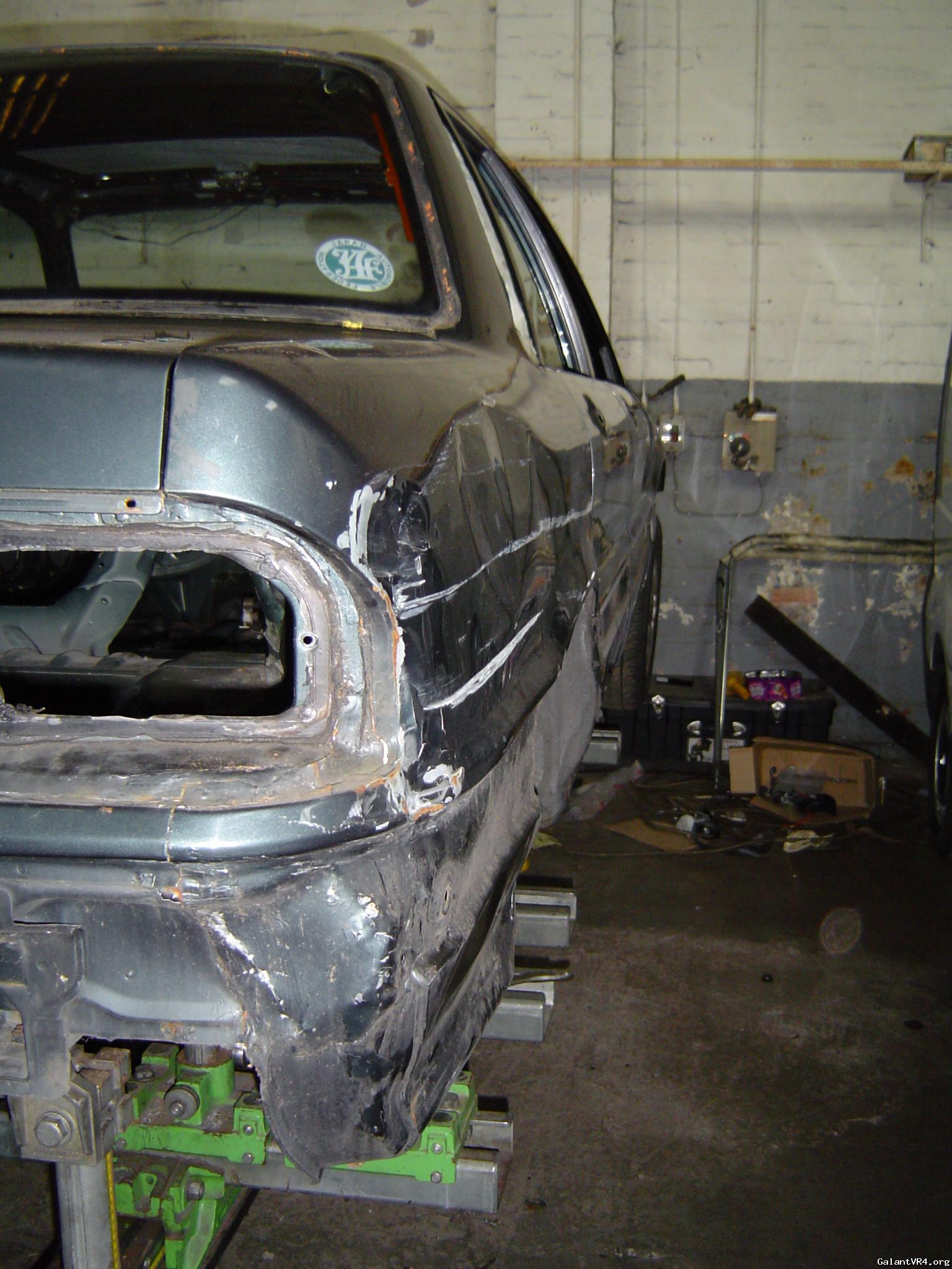

Popped in on the way home from work but the bodyshop guys had knocked off early (a lovely evening for it if I do say so myself). It was pushed into a corner, but I was stunned to see how much it had come on in only a day.
Shutlines at the back reappear:
Look how much the quarter has come back:
Rear profile around the lights:
The front door aperture is next on their hit list you can see here the gap at the crown of the 'a' pillar bigger than at the back or the base of the window channel
A good rear overall shot (looks much healthier)
Tomorrow we'll see where they get too, still a fair bit of cutting and welding to do but the body is becoming the right shape again!! YAY /ubbthreads/images/graemlins/smile.gif /ubbthreads/images/graemlins/wink.gif
