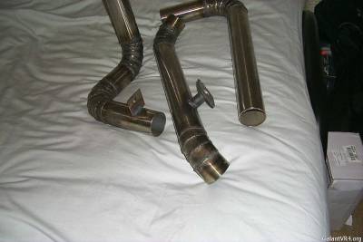

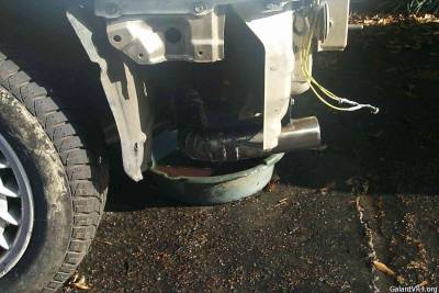

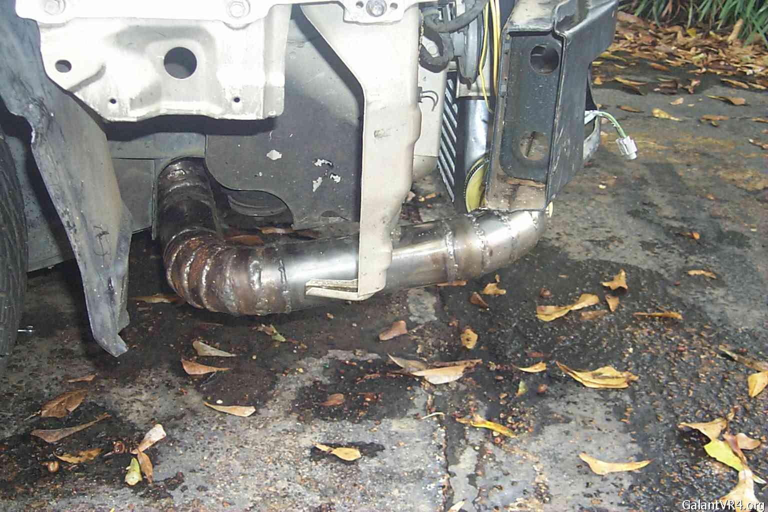

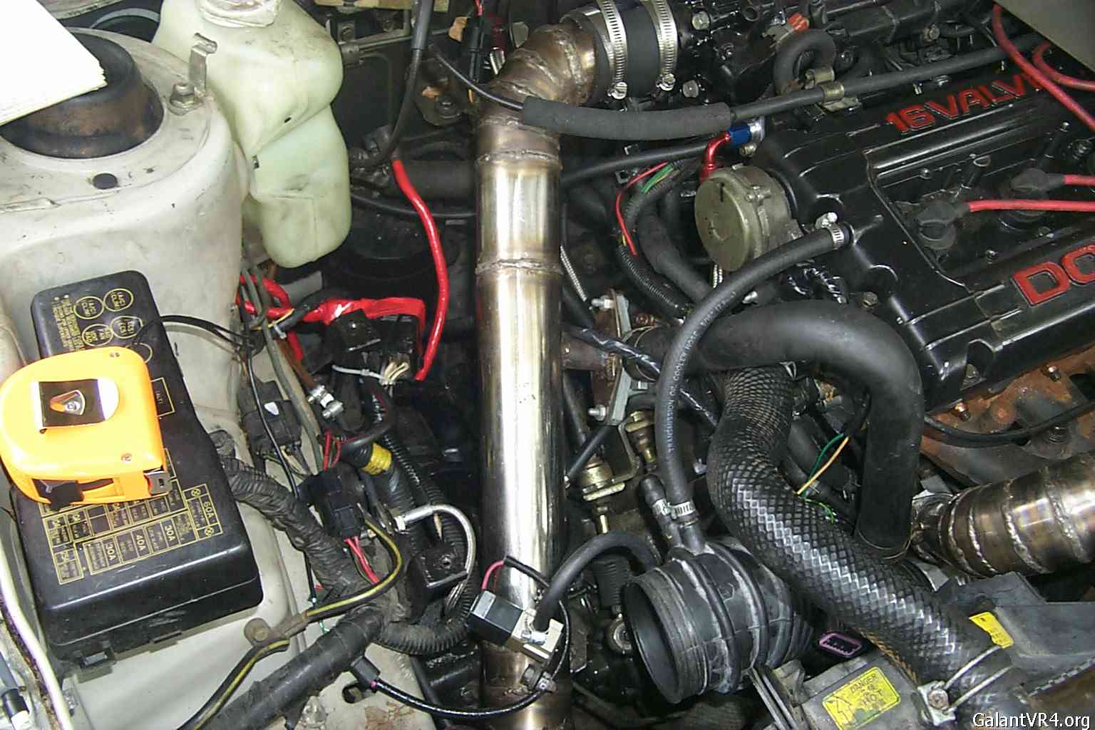

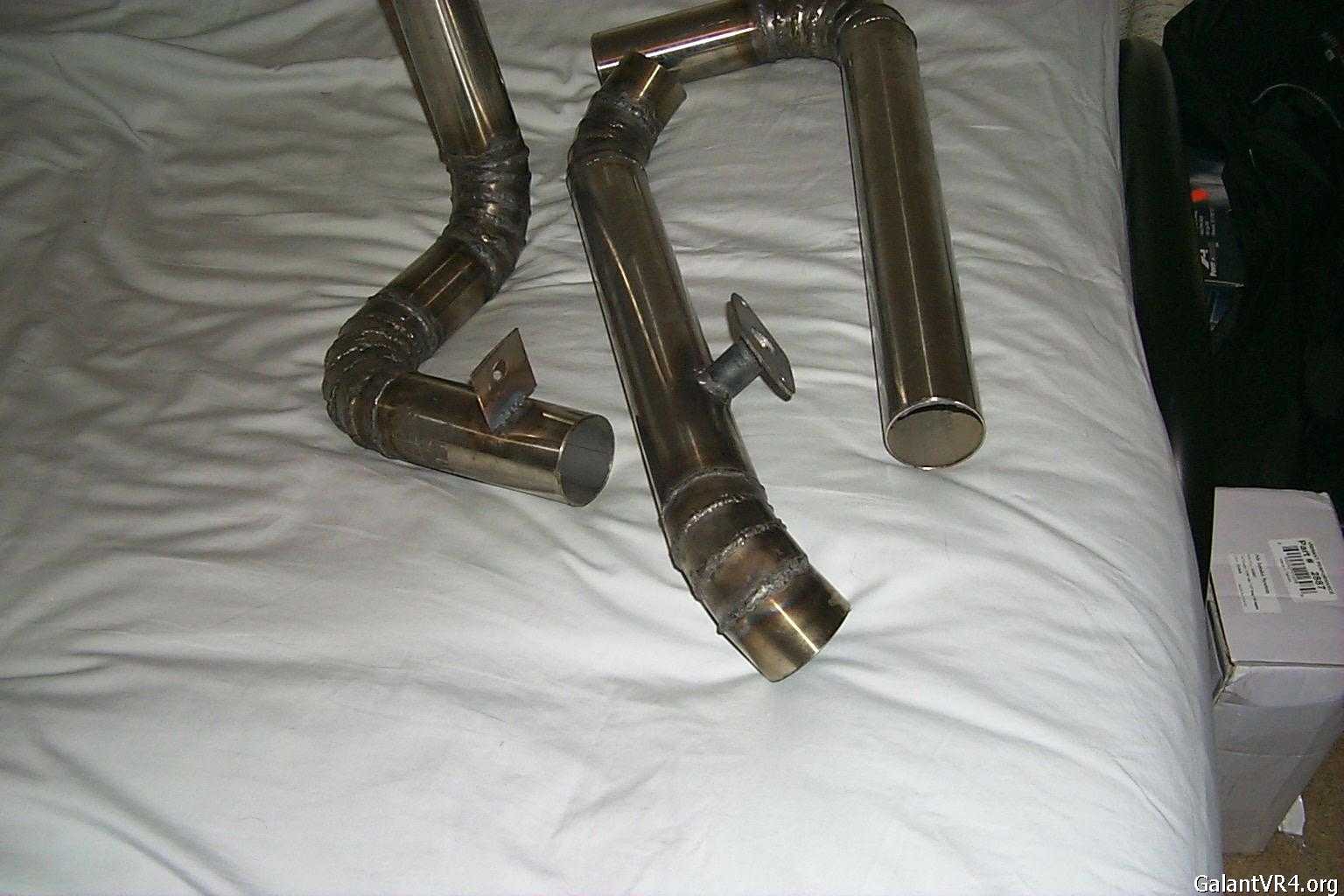

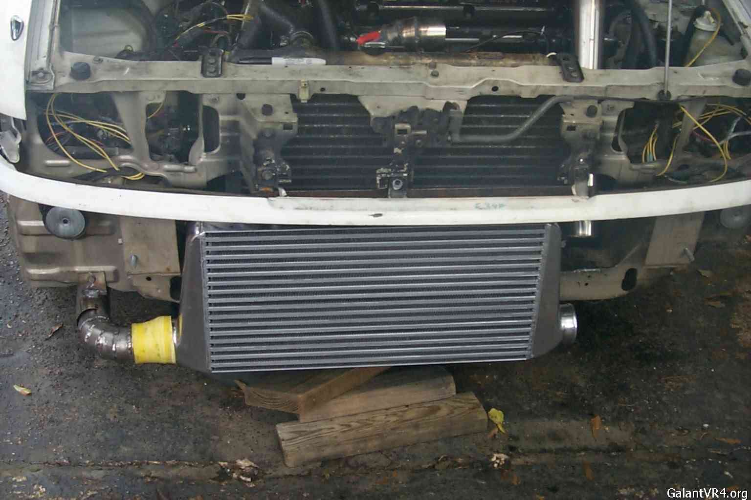

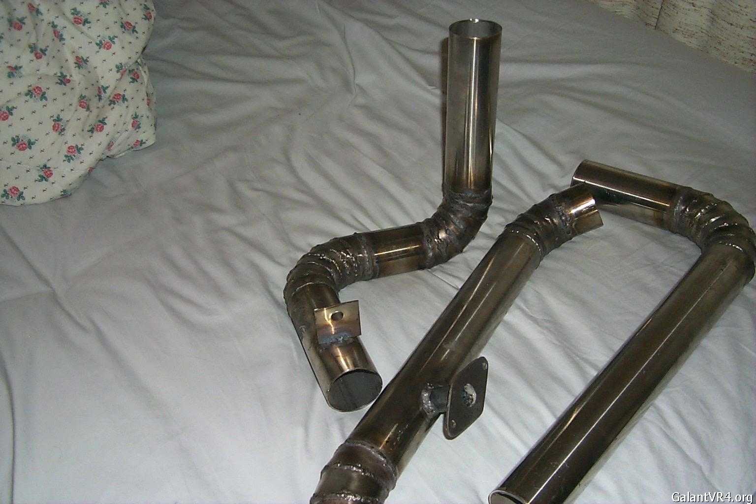

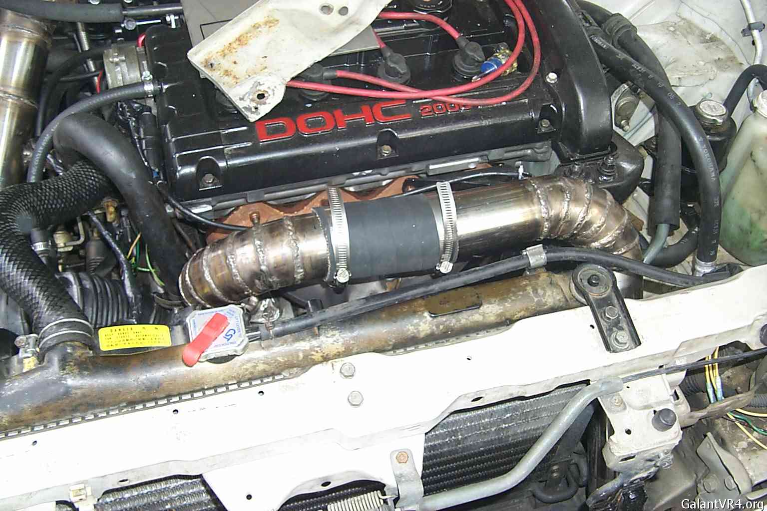

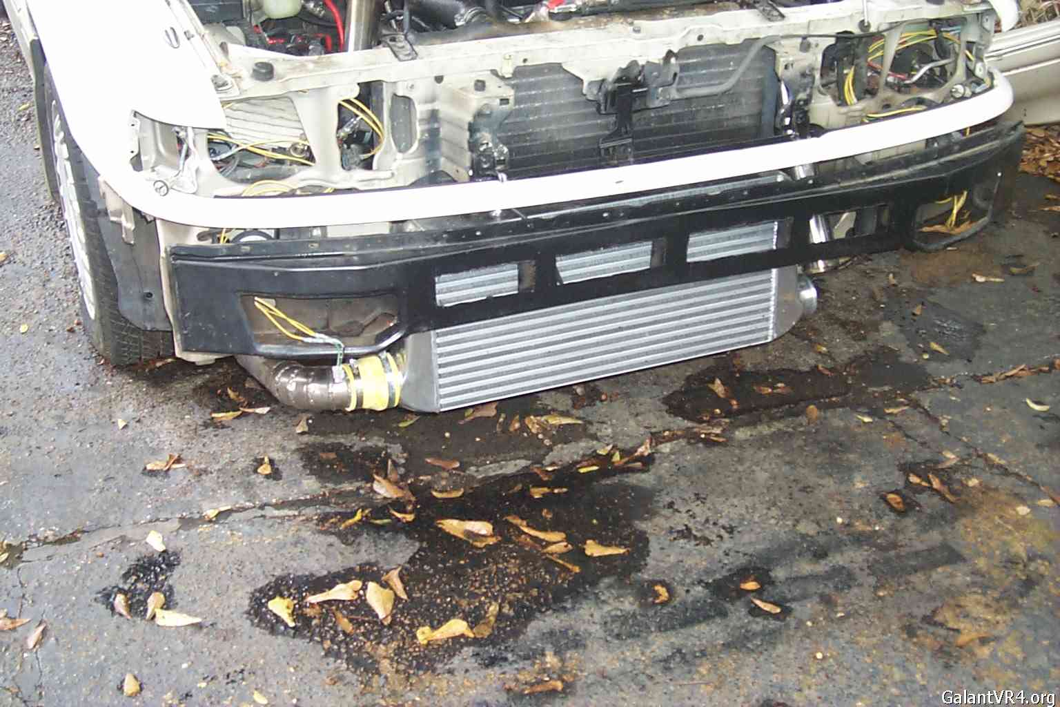

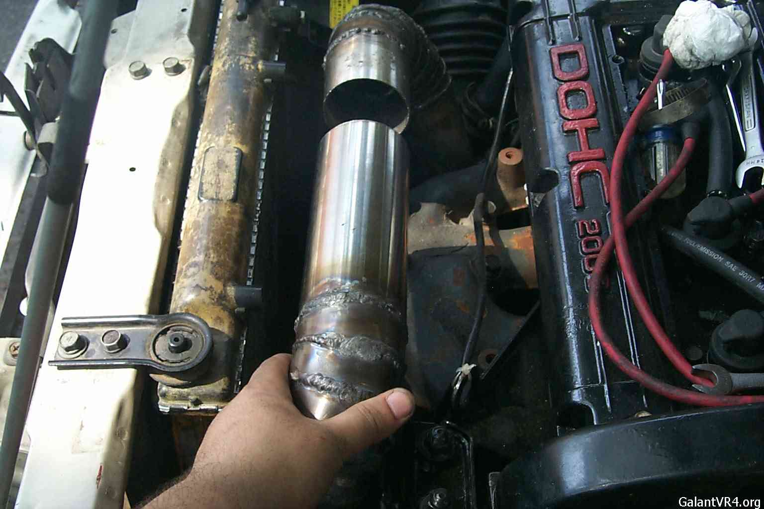

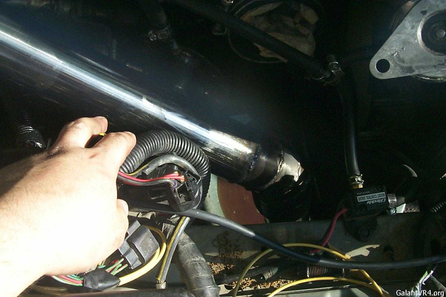

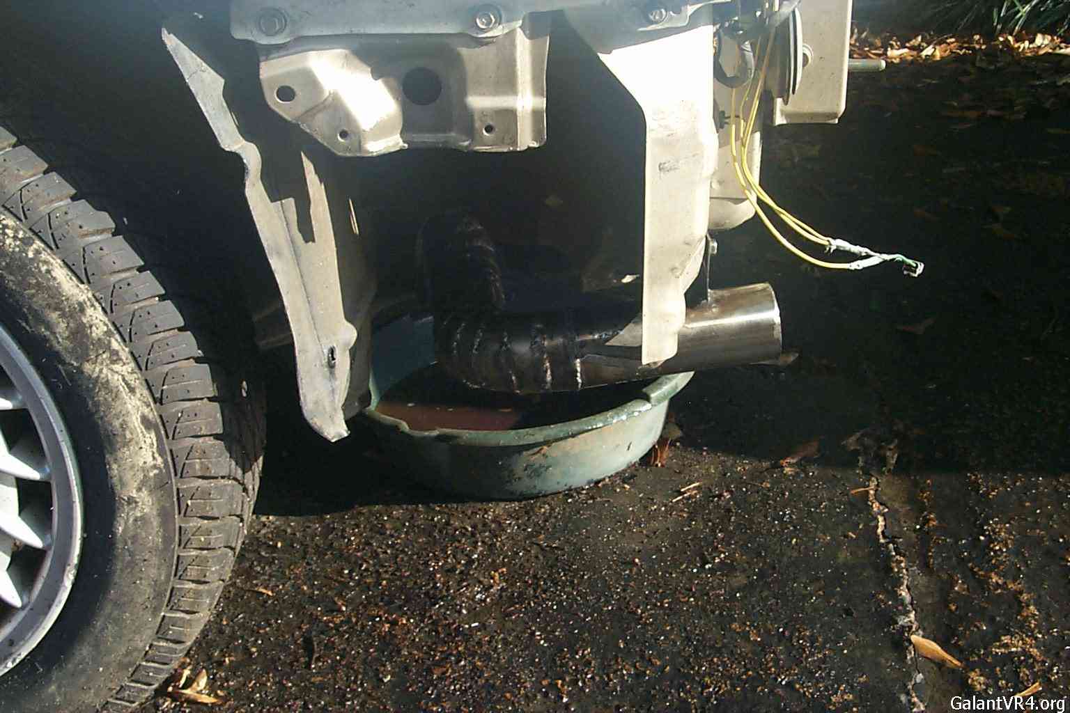

i did my pipes for about a $110 of course i did all the welding but thats 2.5in stainless piping and an ebay fmic total under $300 everythimg came from ebay on the cheap

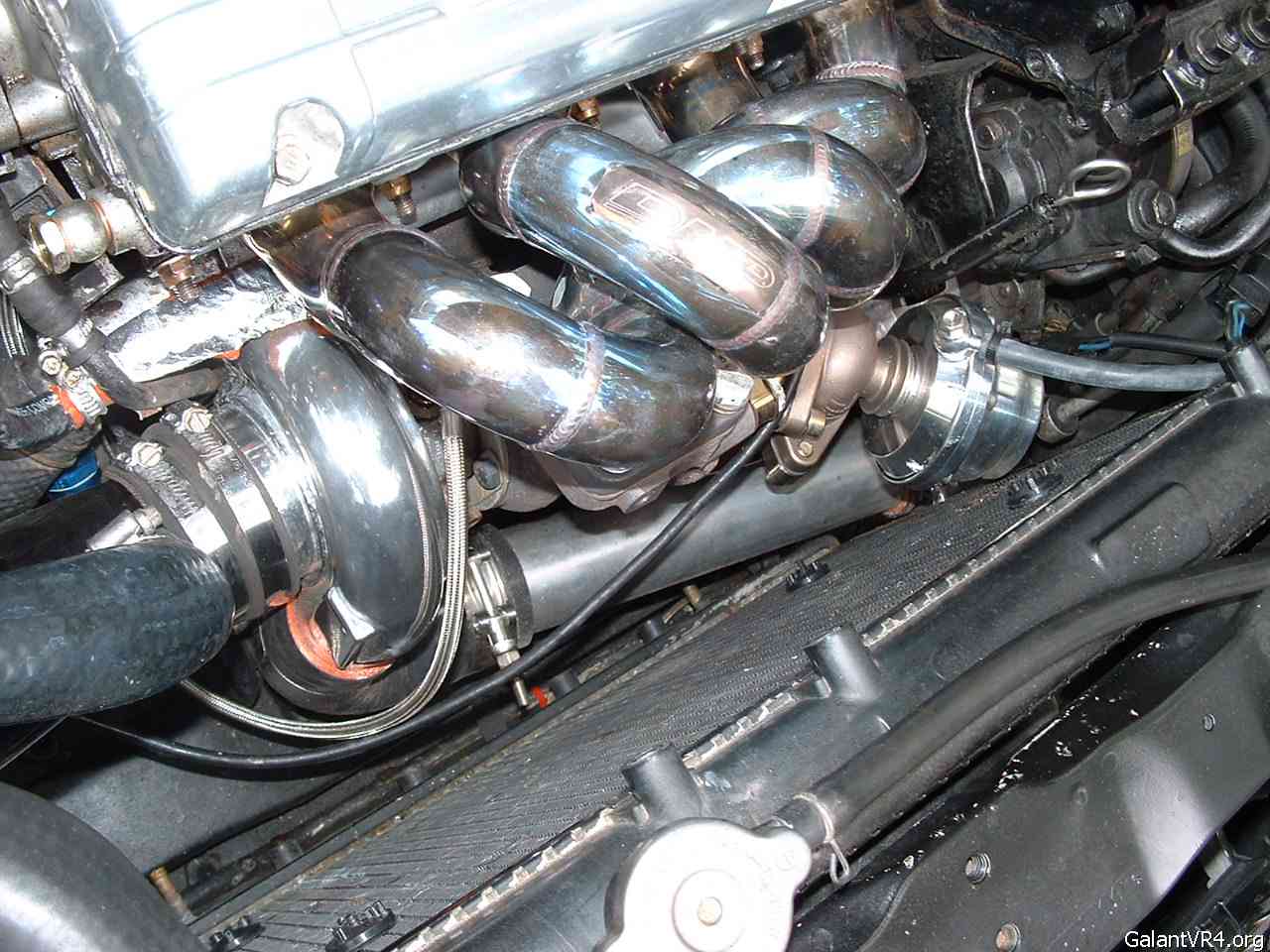

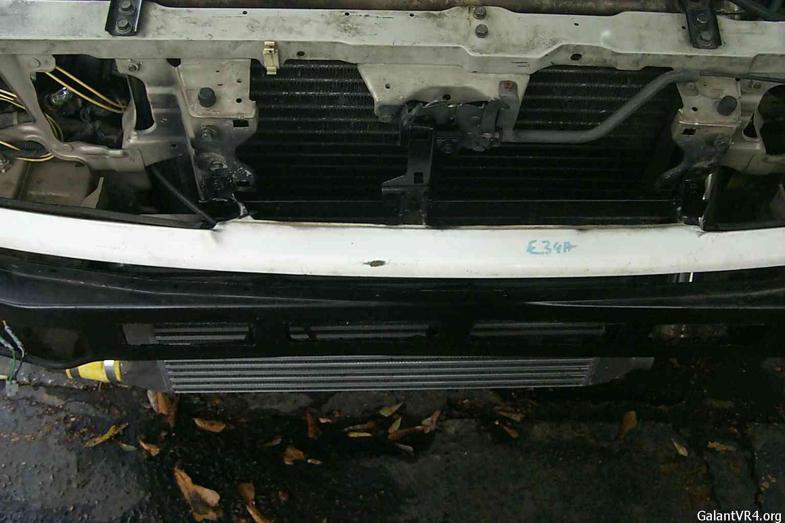

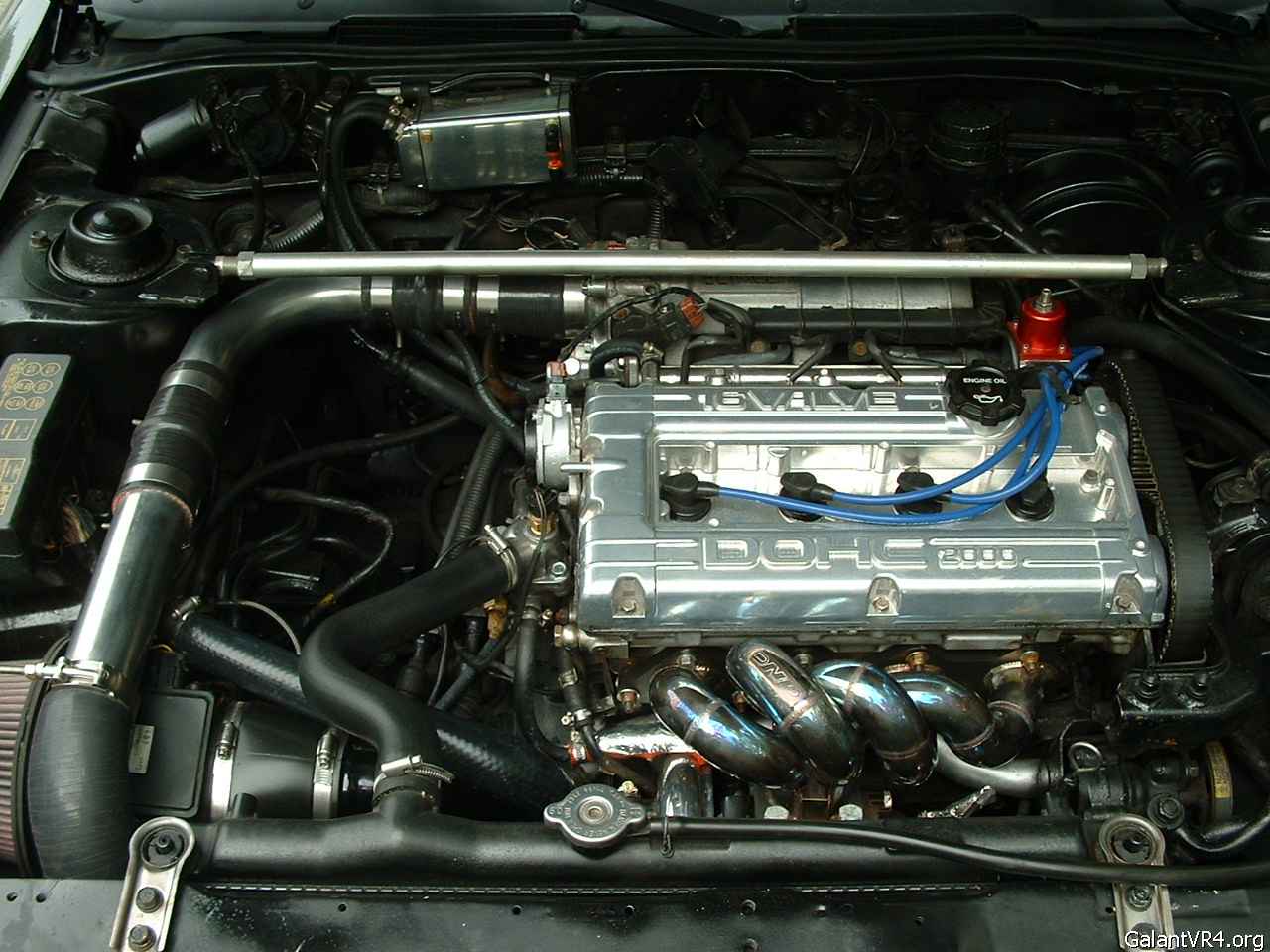

I went ebay for fmic and mild steel mandrel bends, forced performance for couplers, hunters truck sales for t-bolt clamps, dave brode for turbo outlet, hks tb elbow from overboost.com, and I needed 2 welds.
here's pics of my old setup:
clicky

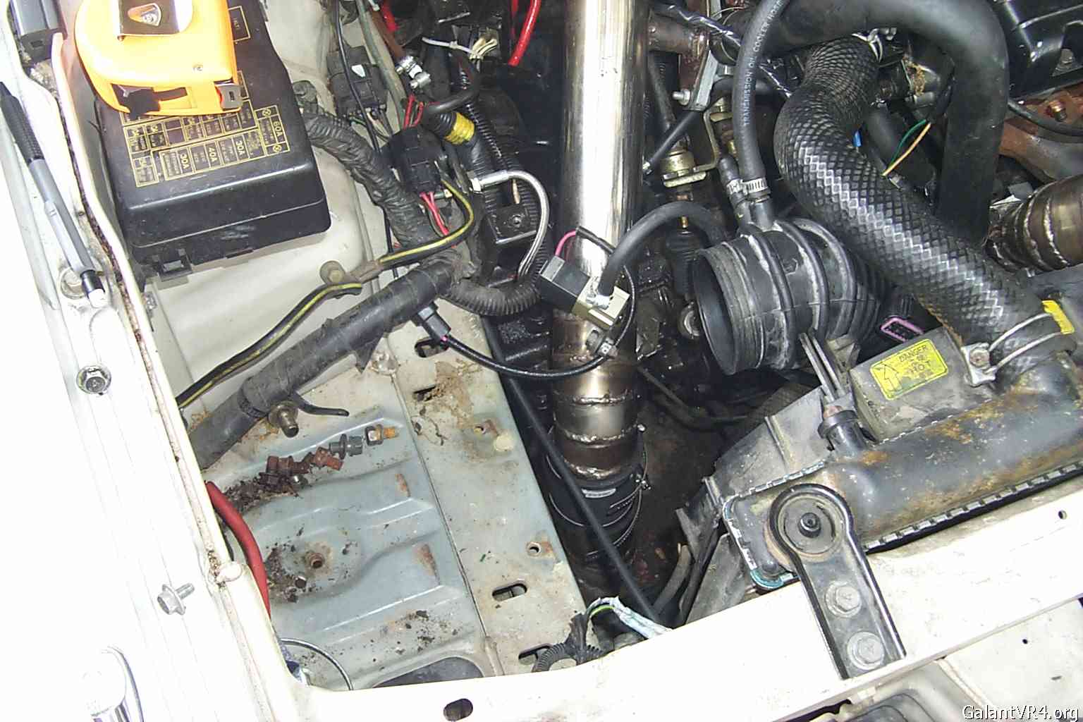

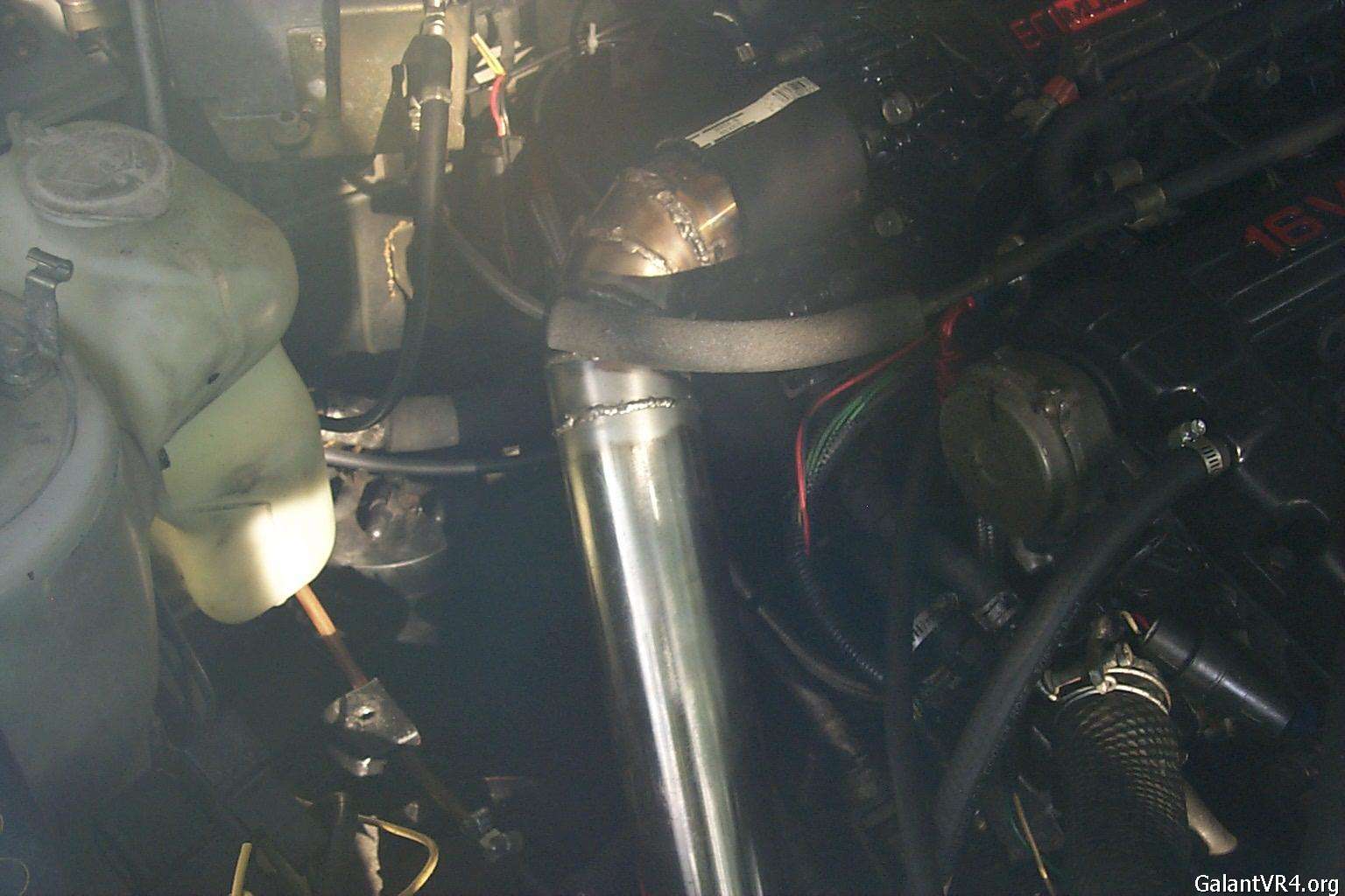

I have had a few different home made setups in my car.
See them here...
The First page under "more pictures here" link shows the really old setup we made with exhaust piping, a tig welder, jb weld and some spray paint.
dime2nr, I noticed no rolled edges on the pipe ends. Do you have any trouble with them blowing off?
dime2nr
Sep 1, 2004
647
Portland OR
not all of those pics were finished i ran a bead around the pipes about a half inch from the ends

Apparently you can do your own welding. What made you decide to go long route rather than change the end tanks and go short route with the piping?

no real reason for not going short route at the moment but if i decide to change its not like its a big headache just some time
