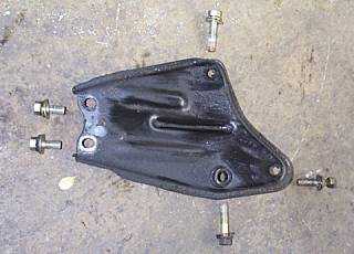

Just make sure you dont forget the right-member and gusset (same on both dsm awd and gvr4).
I ignored this step (coming from FWD DSM's) and it is impossible /ubbthreads/images/graemlins/banghead.gif to get the transmission down with the guesset in place.

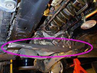

Almost have the tranny out...I removed the right member but couldn't find the gusset. Any idea where I am supposed to look? The VFAQ only shows the location of the right member. I am guessing that someone removed it, but I want to be sure before I find out the hard way when I am trying to remove the tranny.
Thanks
