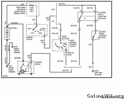

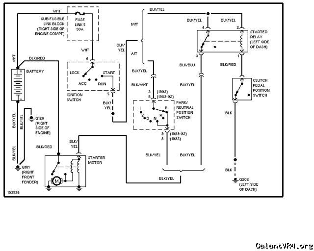

Whenever I turn the key everything comes on but it won't turn over, but when I hook a wire to the starter to the battery it turns over. Where do I start?
chach161
Active member
Jun 15, 2010
39
Moses Lake, WA
Well there is three things I can think of. Clutch switch, Starter relay(left side of dash, fusible link (right side of Engine Compartment)and of course the ignition switch its self. Here is a diagram.
Hope this helps.
