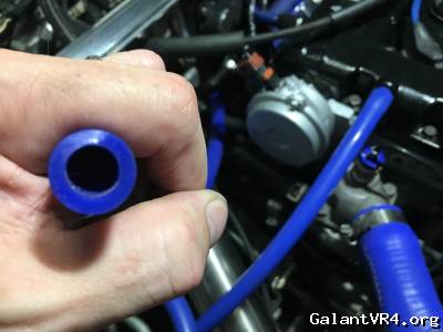

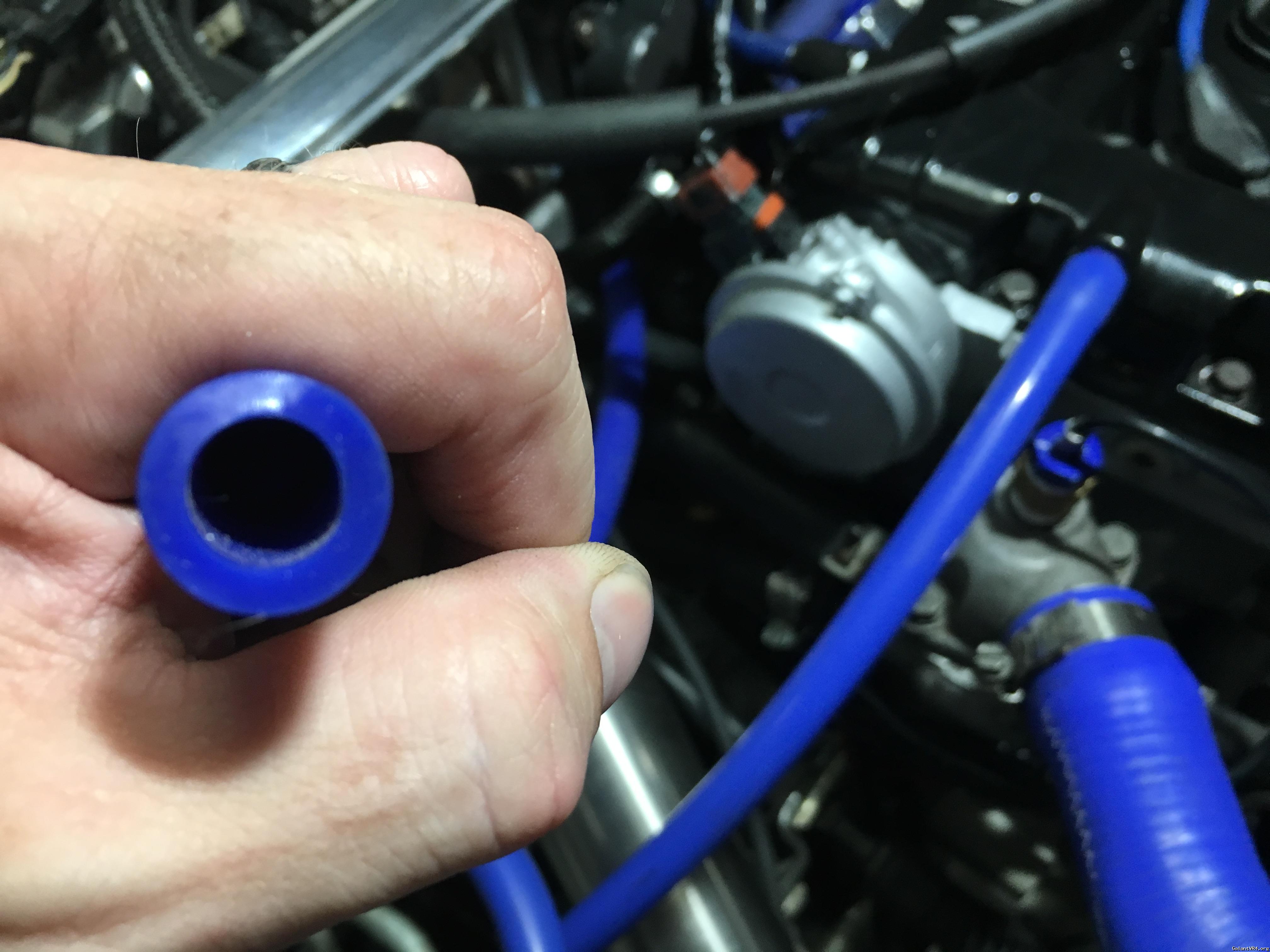

I love you guys. Did a boost leak test and found a massive leak...more whoosh than hiss. Used a length of silicon hose to pinpoint the location to right underneath the throttle body. System wouldn’t even hold any pressure. Pulling TB next for inspection. Thanks for everyone’s advice so far.

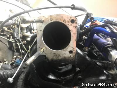

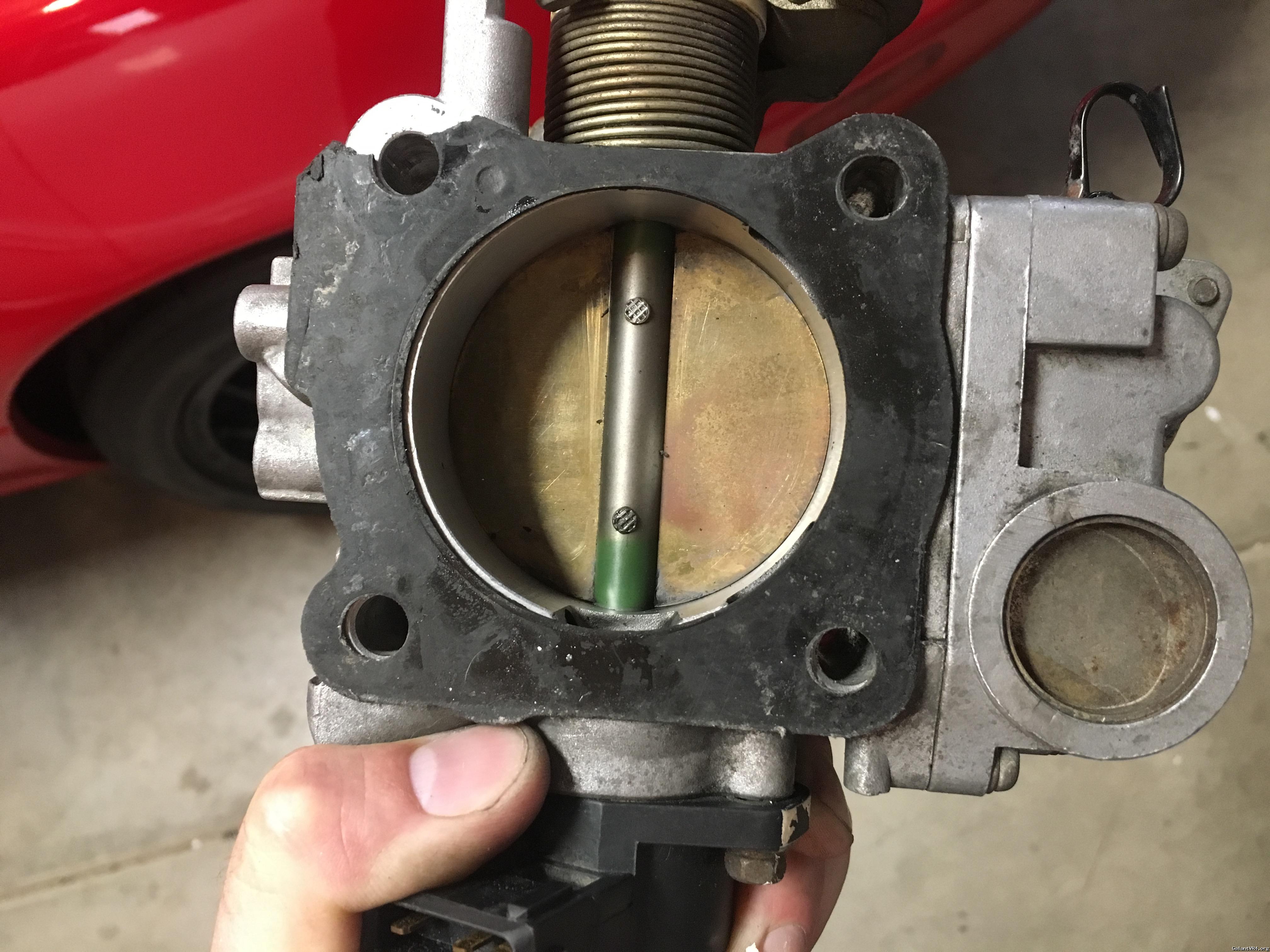

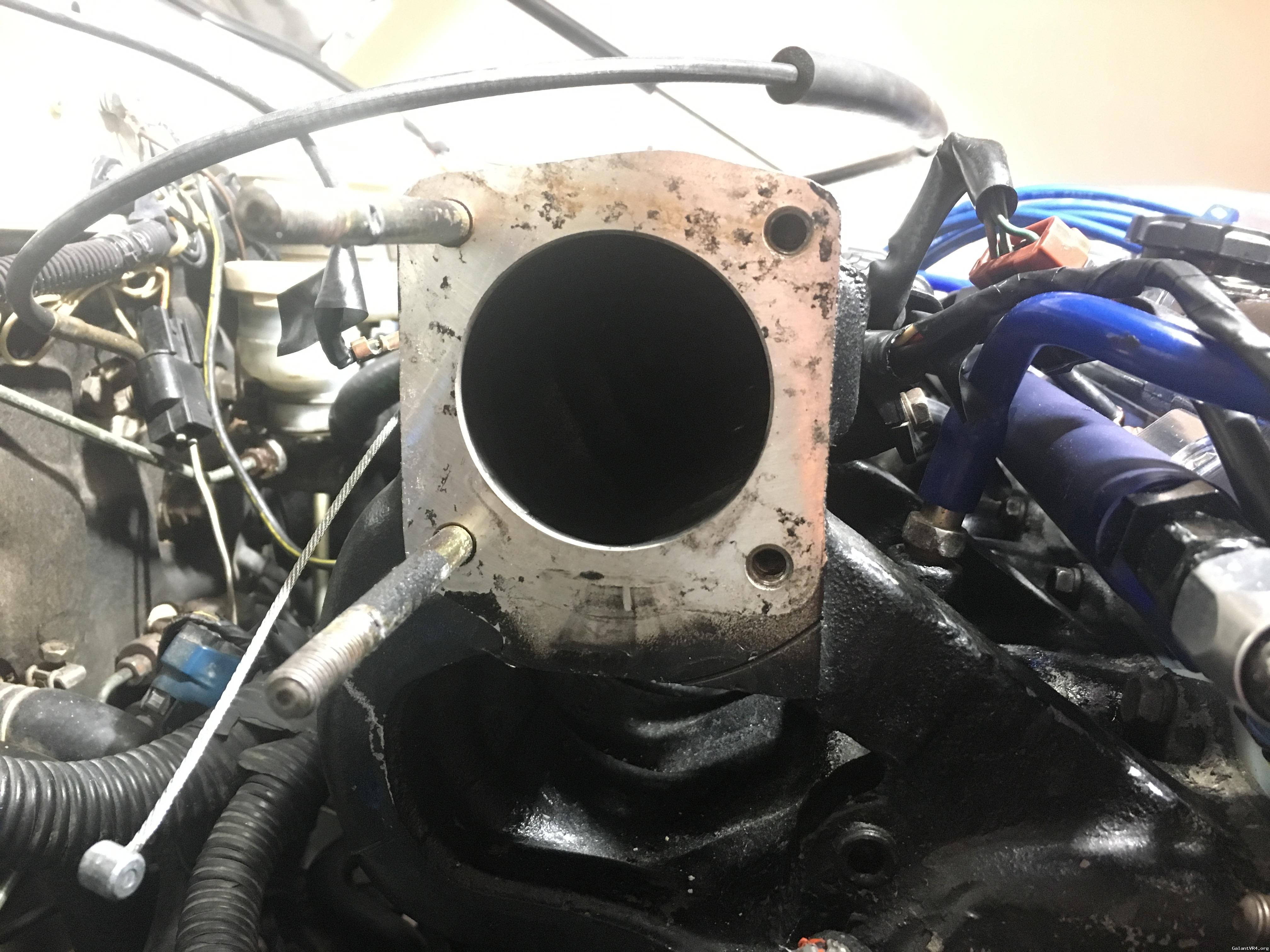

Took the throttle body off and really can’t see a source of the large leak. The gasket from TB to IM seemed solid and only tore a little on removal. There was some discoloration on the lower IM opening. At a loss here. I could very much feel a considerable amount of air rushing out under the TB near where it connects to the IM while boost leak testing.
Any thoughts/suggestions guys?

When you are ready to install the new gasket I would def make sure that both surfaces are nice, clean and flat. Looks like dirt or pitting on the IM side. Maybe one of your bolts wasnt all the way tight or something? Just guessing how you could have had such a big leak.

It could be the BISS screw O-ring or the Shaft Seals causing the leak as well to include the intake manifold gasket. Just something to consider........

On my car, I forgot to install something under the throttle body or intake manifold. I don't remember exactly, it was a few years ago.
I had the exact same problem and I found it with a boost leak test.
I'll see if I can find it and take a picture. It was easy to miss. It was hard to see too.

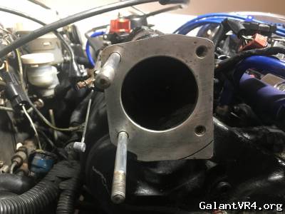

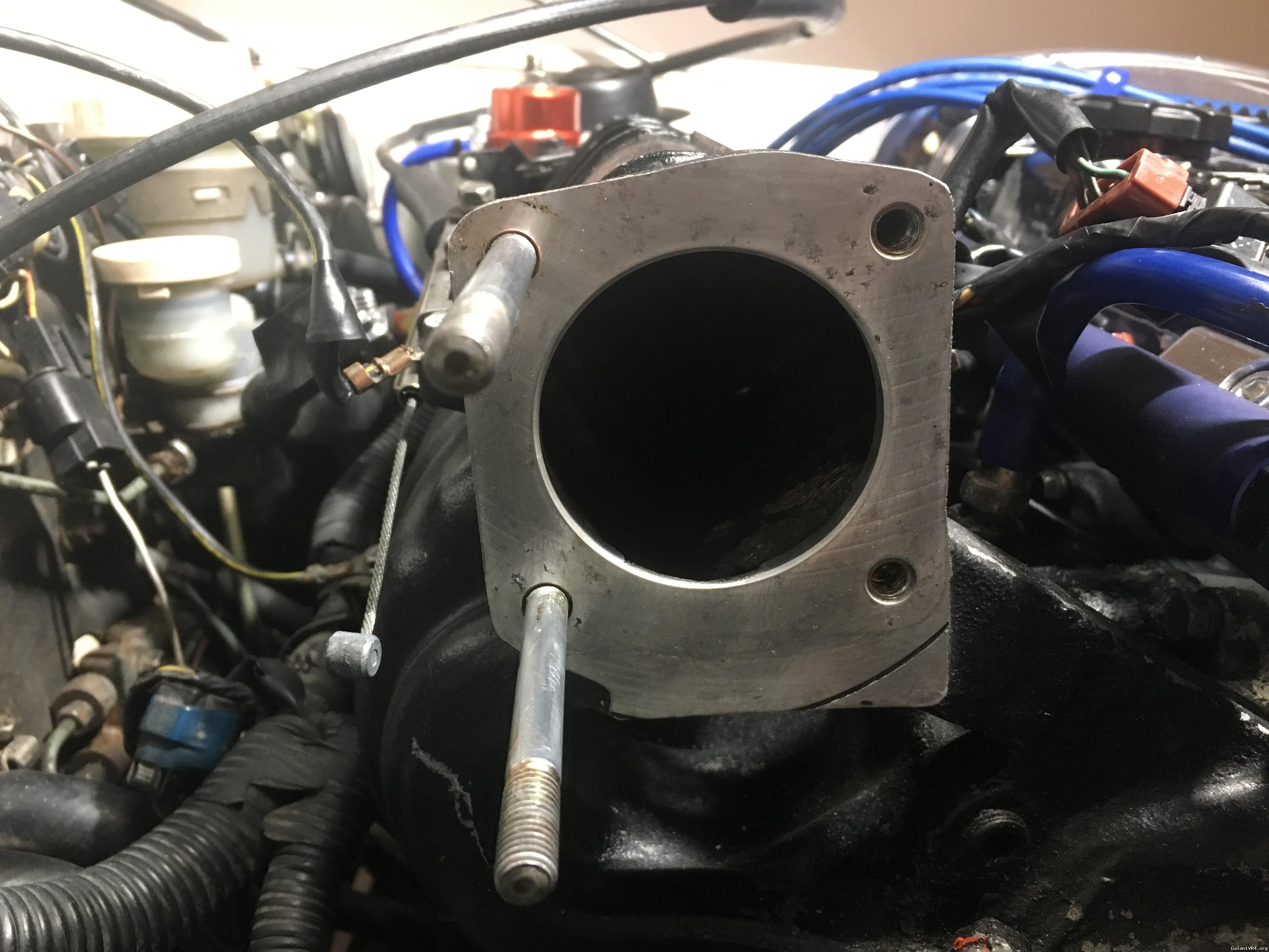

Done and done. Sanded it all down nice and flat.

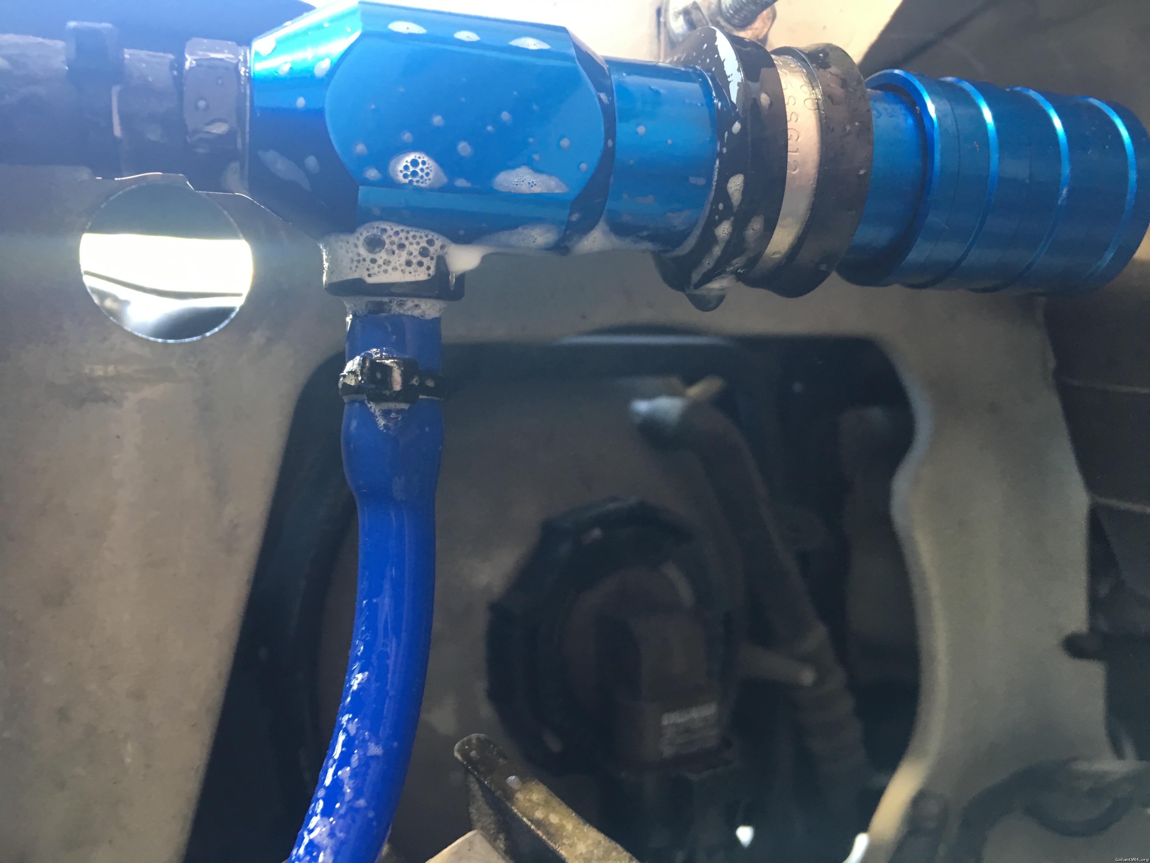

Replaced TB to IM and TB to elbow gaskets with Mitsu OEM and boost leak is gone...that boost leak anyhow. I now have air escaping my Hallman MBC at the little hole where the vac line attaches. Is this normal?

Never mind...did some research and apparently that is there by design (which was what I was hoping for). Time to double check all fluids, button everything up, and attempt to fire her up.

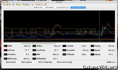

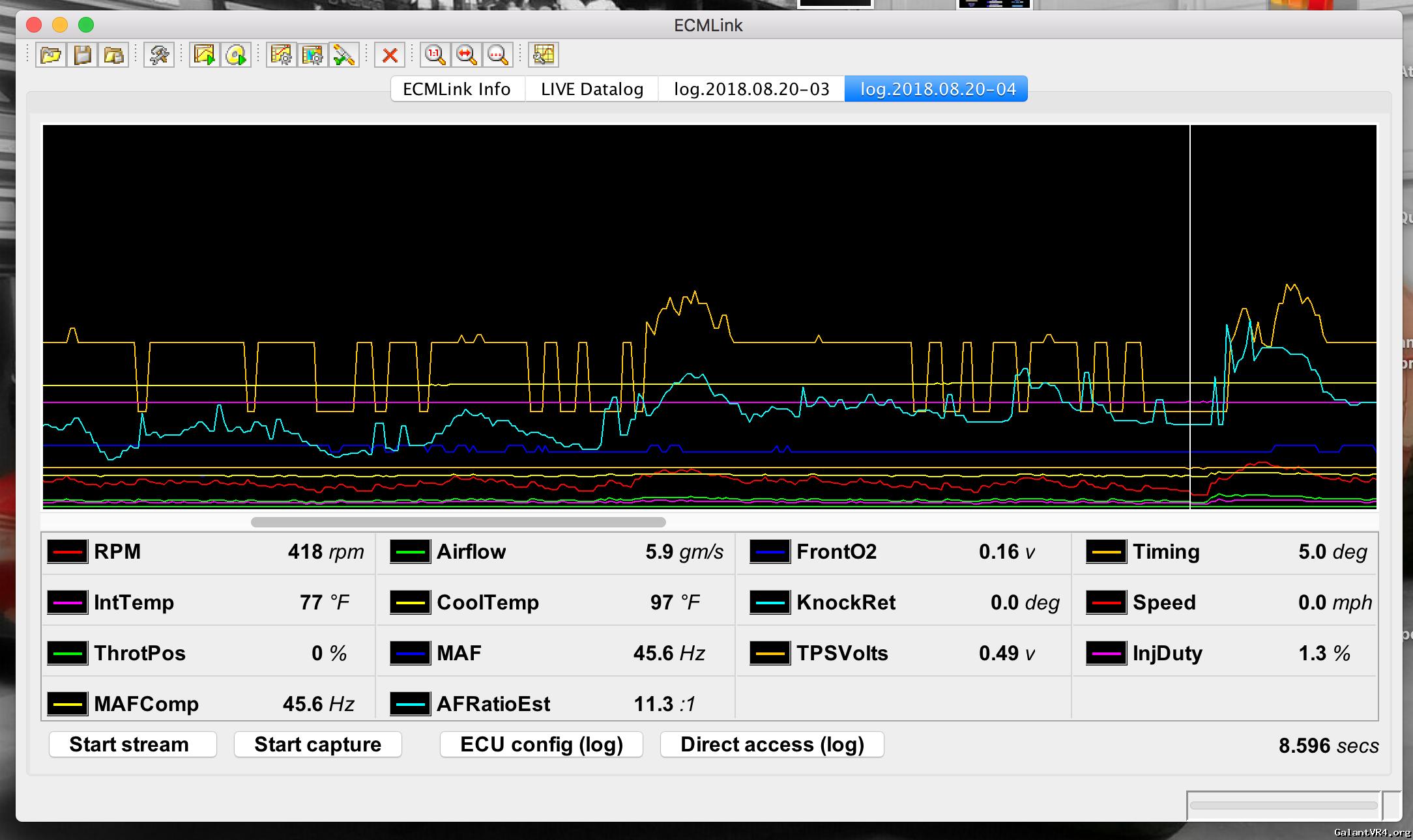

Thanks for the reply. That screen grab is at idle (at least until it dies) with no throttle input. Is there a better way to post the log on here?

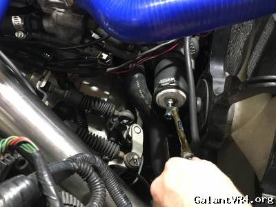

No boost leaks...still not able to hold an idle. I'm going to test the Cam Angle Sensor next. Timing marks are all lined up. I'm really grasping at straws at this point.
-No Leaks (vac or fluids)
-Spark, air, and fuel are all getting there
-timing looks good
Going to test the Camshaft Angle Sensor.
Car starts easier than before, revs to 2.7k RPM, idles rough and then drops, and then stalls out.
