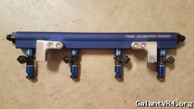

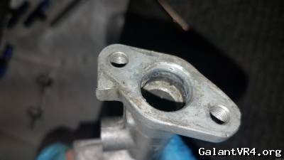

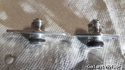

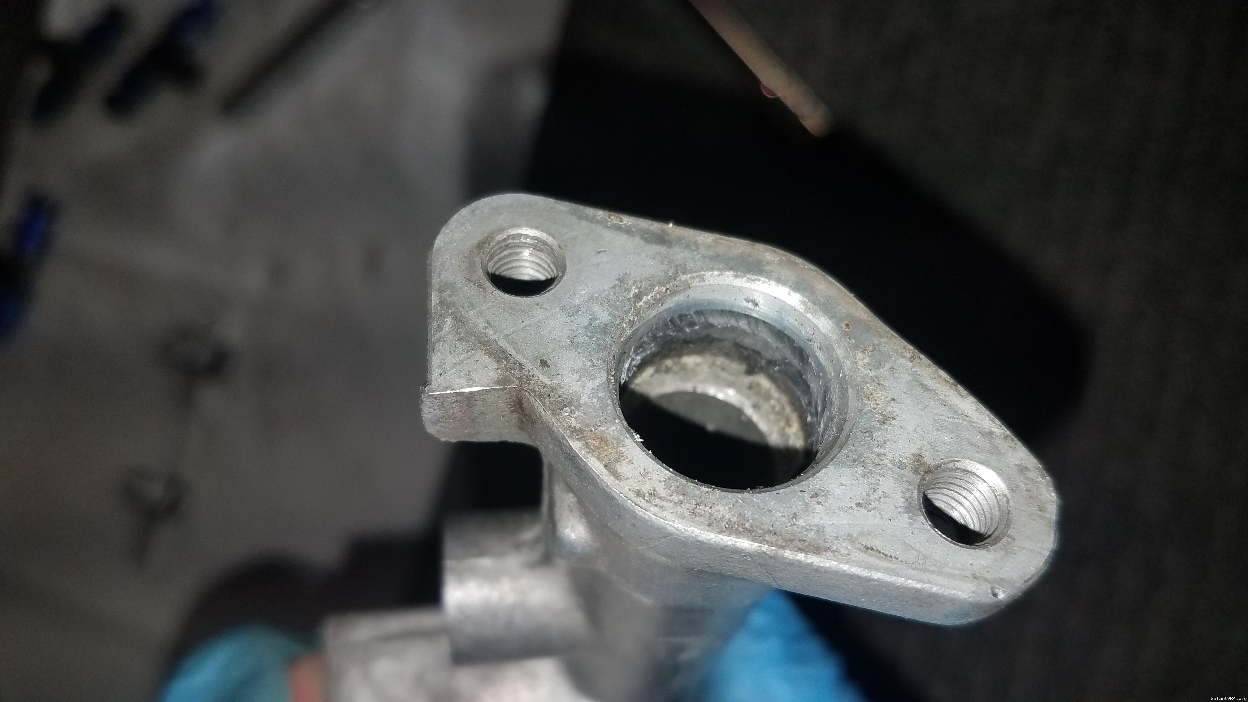

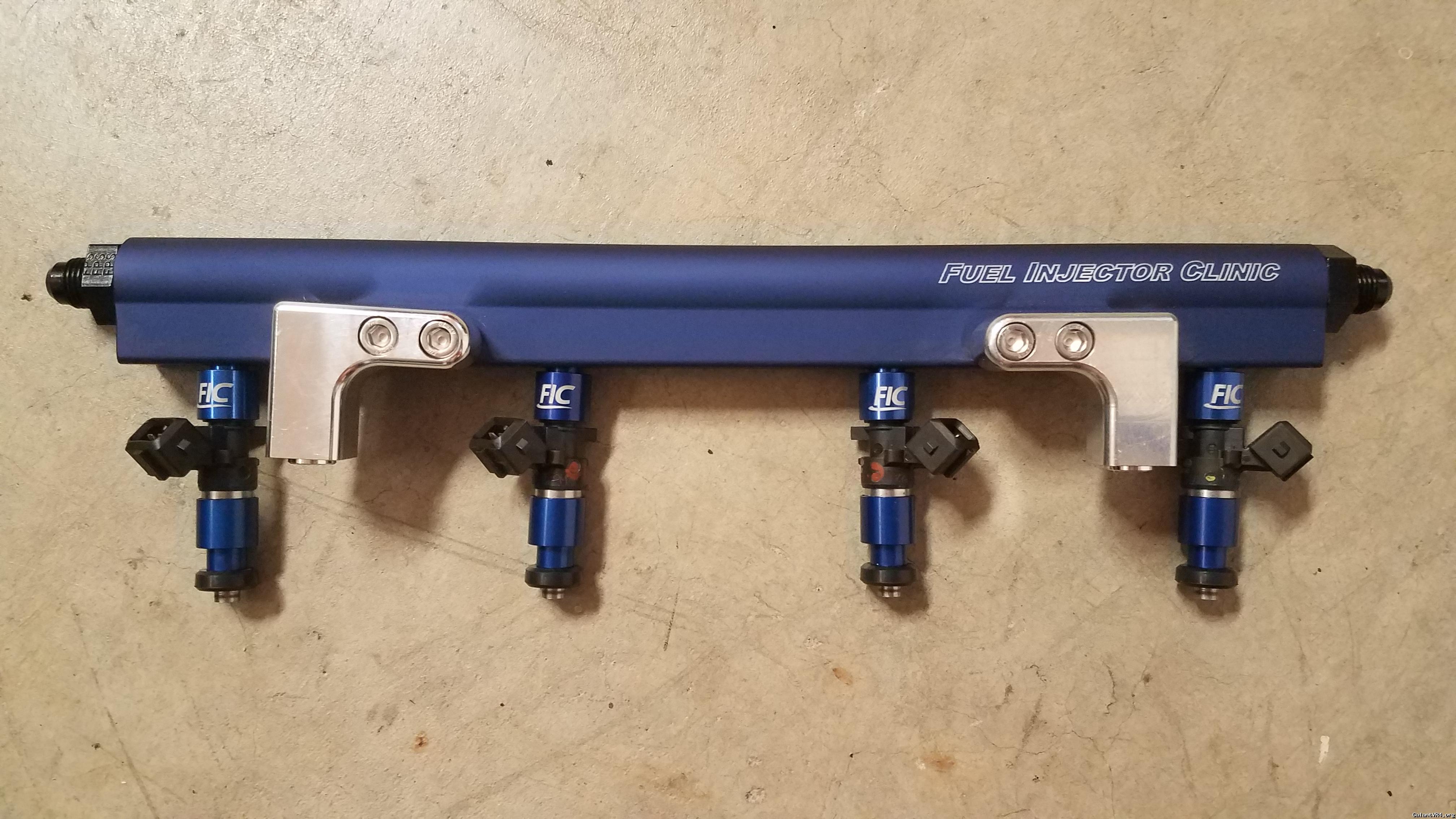

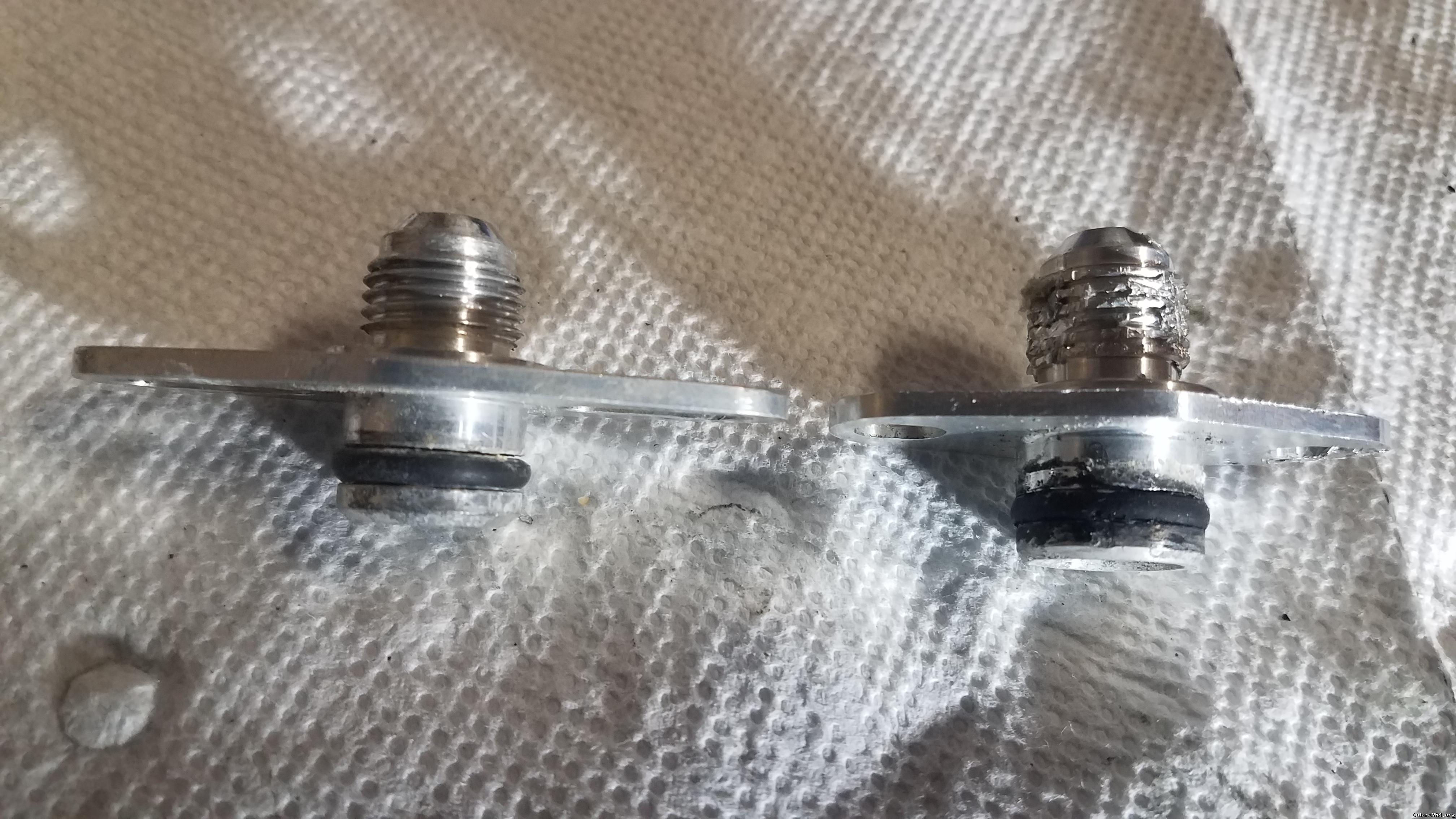

Had to mangle to fittings to get them off the rail. Both rubber o-rings were in rough shape, especially the inlet side (looks almost melted). I was going to just order new -6an fittings and call it a day, but I said screw it and opted for the FIC fuel rail. Reviews look good, and my stock rail has been through hell. Fun.
Chad989of2000
Jan 13, 2005
1,791
Livermore, CA
Installed new FIC fuel rail and that stopped the fuel leaks. Car still takes forever to turn over and won't idle on its own. Maybe a MAF failure. I don't have an extra to swap and test. Anyone know a way to test the MAF?

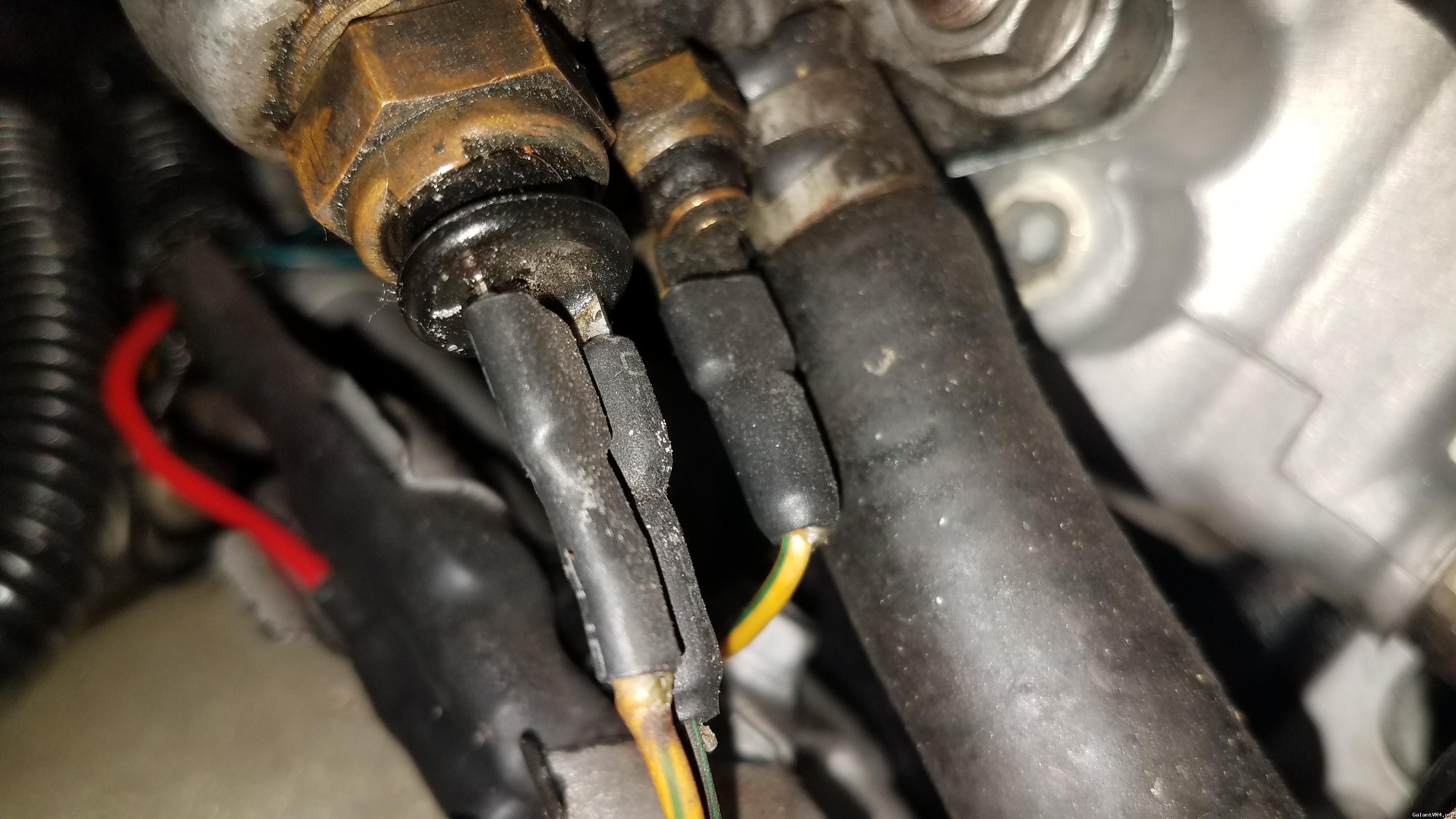

Did you ever log the Coolant Temp? That will cause a long crank and hard to no idle issue now that the fuel system is sorted.
Chad989of2000
Jan 13, 2005
1,791
Livermore, CA

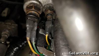

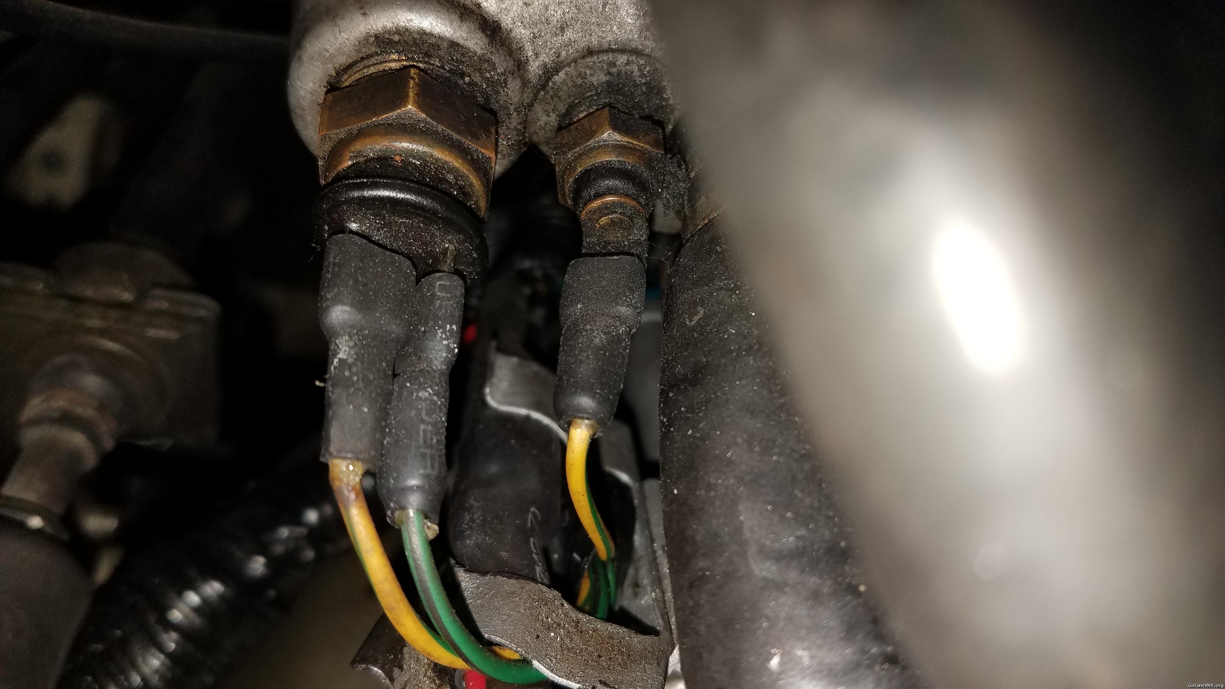

That totally skipped my mind. The wiring looks solid, but the sensor may be original. Will test when I can carve out some garage time.
thomcasey
Sep 24, 2014
907
Indianapolis, IN
Most of the time the sensor is good. The 26 yr old wiring is the issue. Predominately, the sensor ground (green w/black line) is the culprit.

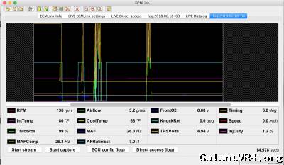

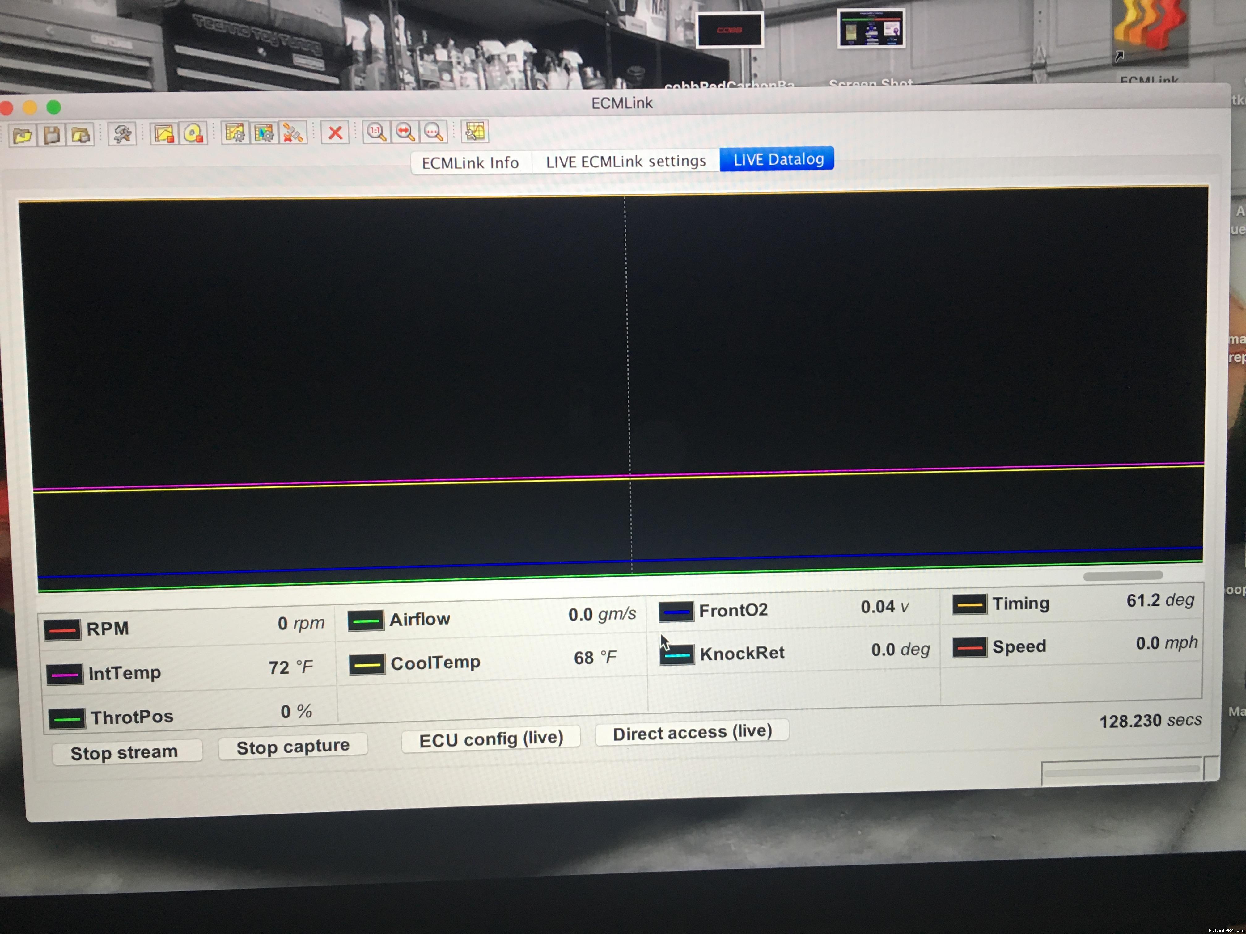

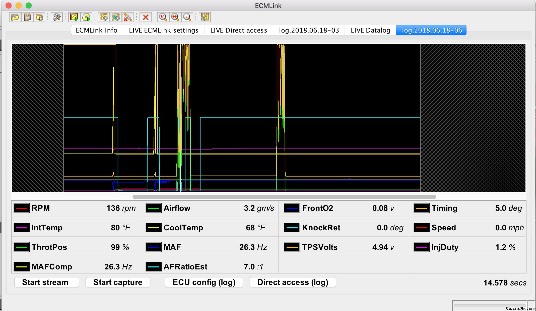

Disregard the timing number...it displayed 5 degrees once the car was cranked.
I'm thinking TPS and Coolant Temp Sensor are good. I'm going to look to test the MAF next. Everything else is checking out fine.

-Fuel pressure is good, spark is good, freshly cleaned injectors (FIC)
-Car starts hard (really long and multiple cranks to get going)
-ECMLink shows coolant temp sensor reading normal (wiring looks good)

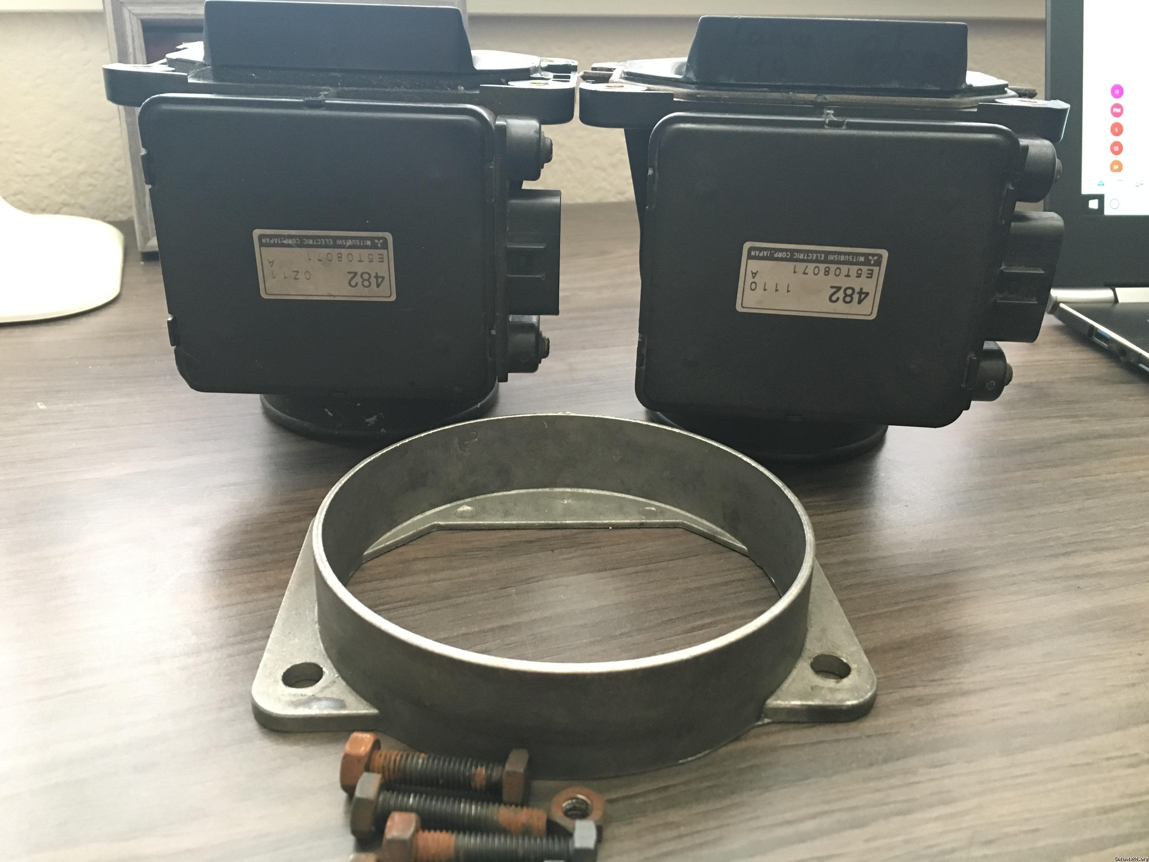

Next check will be replacing MAF and checking the ISC again. Anyone every try the unbranded 482 MAFs on eBay...I'm a little skeptical...probably just gonna scoop a used Mitsu unit just to be safe.

Quoting Chad989of2000:
so you see how there are two wires that are the same color and tracer.... try switching them around. i have had this happen.

Quoting transparentdsm:
That seems easy enough. Link showed the correct coolant temp so I assumed it was functioning/set up correctly. I will give it a shot, thanks.

I tried swapping the coolant temp sensor wires, and nothing changed. Put them back to the way I had them as that must have been correct. On to boost leak testing...
