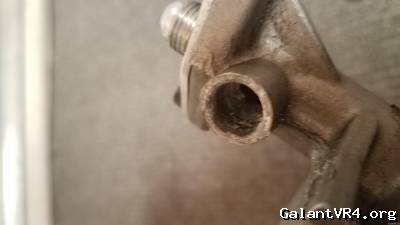

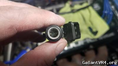

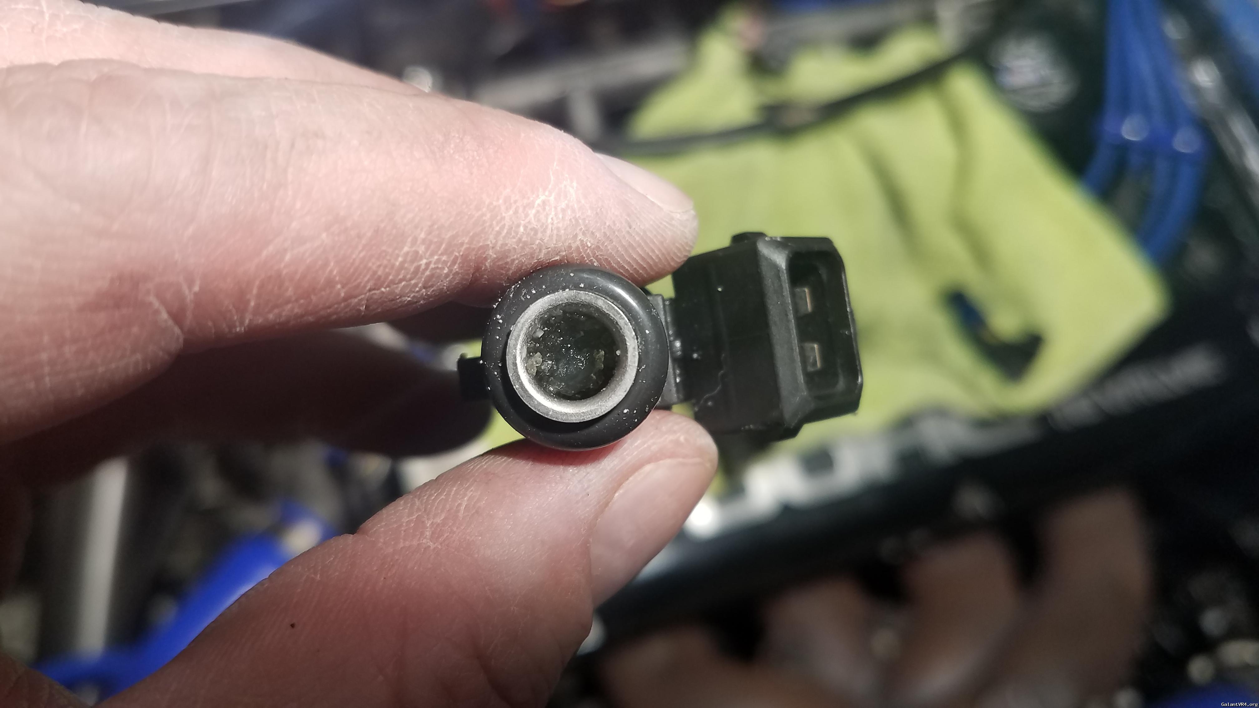

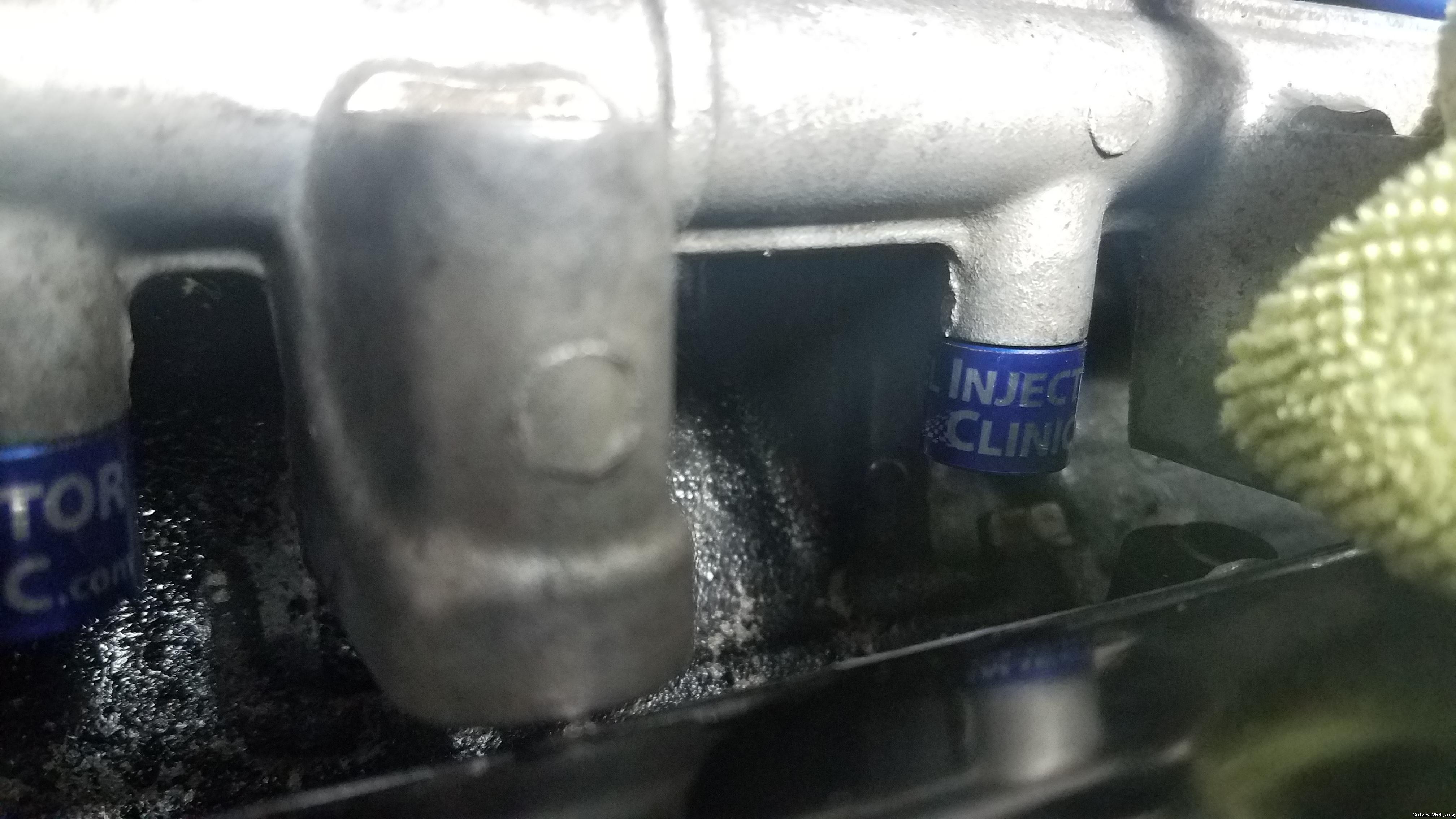

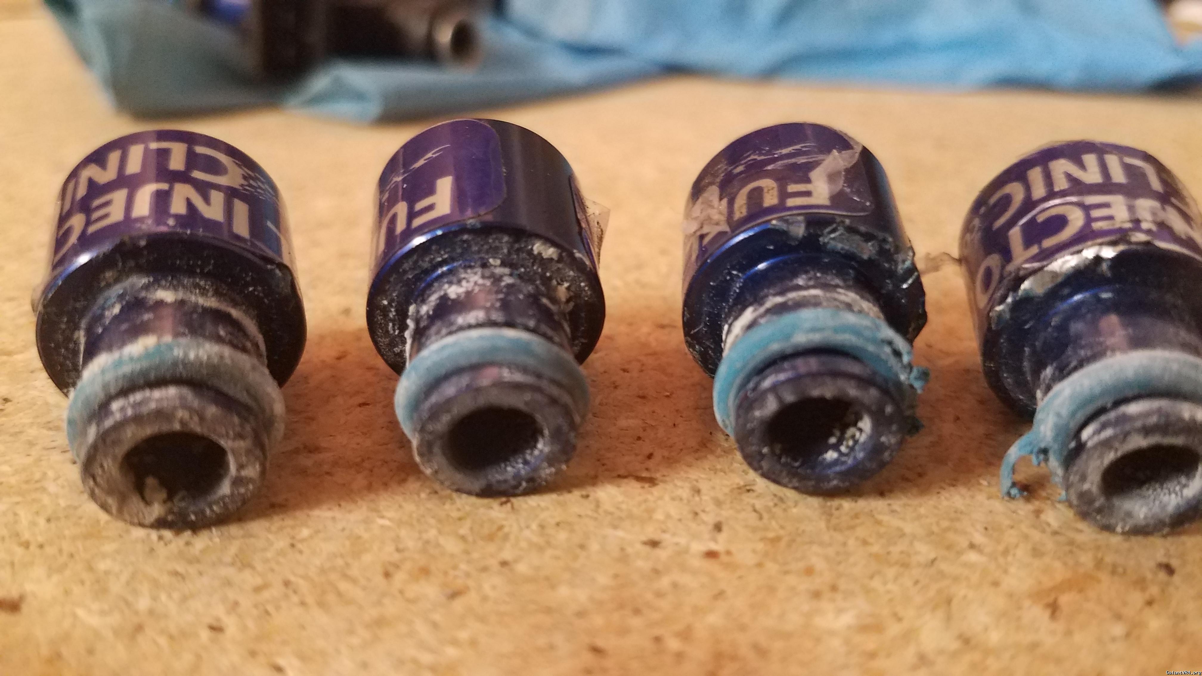

Also when I pulled the rail up, the tops of the injectors stayed attached. Is this okay? They seem to be stuck to the rail really well.
strokin4dr
Aug 30, 2005
2,773
Savannah, GA
I called that one /ubbthreads/images/graemlins/grin.gif
As far as sticking in the rail, I've had lots of injectors do that. Some to the point where the oring is destroyed removing them.
I would send those back to FIC for cleaning. Hopefully they can be saved. Ethanol can potentially do some damage.
It sucks, but glad it was something simple. You should be up and running in no time. Since you see the condition of the injectors and rail, I would open up the rest of the fuel system and clean everything thoroughly before trying to start it again. Inside of tank condition and fuel pump would be my biggest concern.

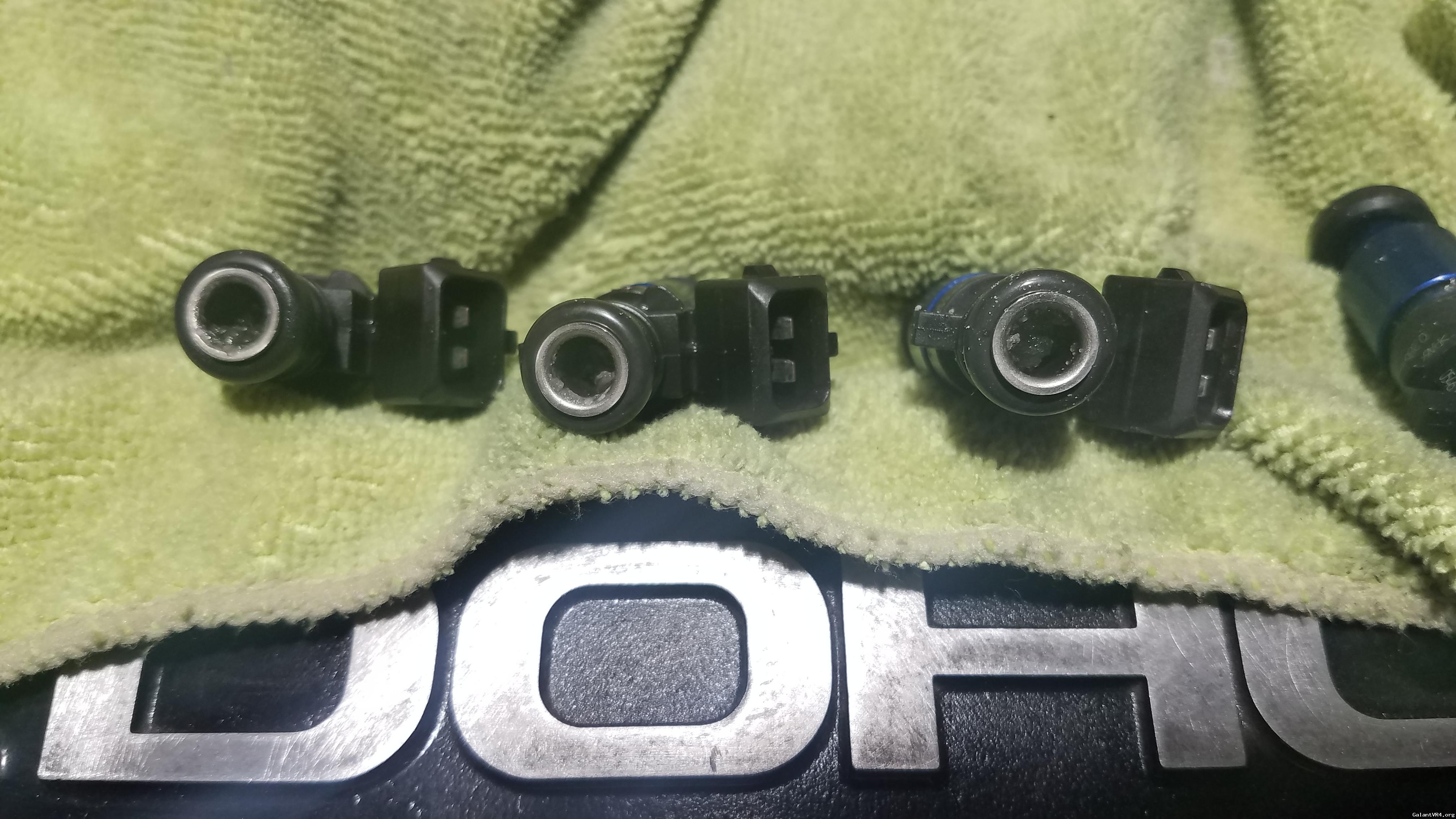

Haha for sure. I will also be replacing the fuel filter (FuelLab unit) to be safe. Pulling pump and rail for inspection too. I drained the tank completely and re-filled with clean gas. Off to FIC to clean and will report their findings. Thanks again all.

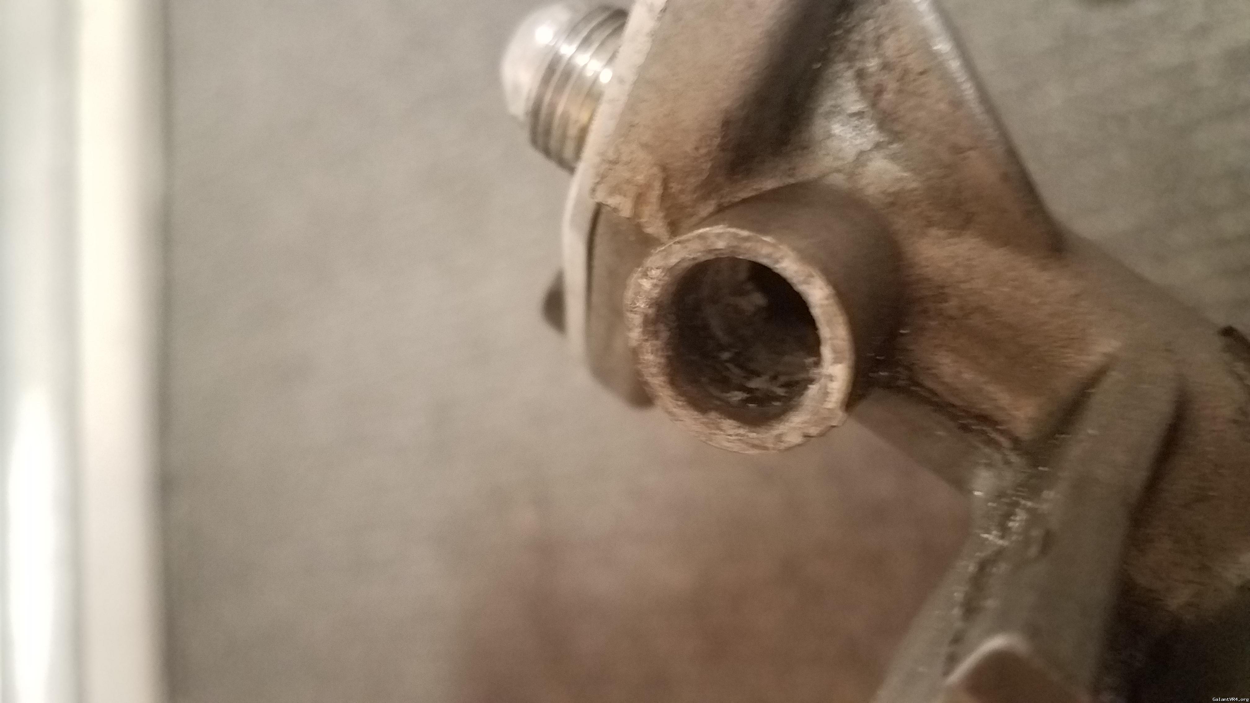

I would not use that rail. Hell, I wouldn't run bare aluminum fuel components with E85, period. After noticing my factory rail starting to have flakes inside after running E85 for just months I swapped to a FIC rail, new soft lines, inline filter setup and E85 safe fuel pump.
I'd check out all of those things and consider replacement is any piece is suspect and especially if you plan to keep running ethanol.

Replaced fuel filter, cleaned fuel rail with rifle cleaning kit, cleaned out Aeromotive AFPR, pulled pump it looked good, had all injectors cleaned and flow tested by FIC. Car fires up and will run if I give some throttle...it surges and then stalls if I don't.
Unfortunately it is now leaking from both ends of the fuel rail. Everything is tightened to spec and it never leaked before. What could be causing this?
