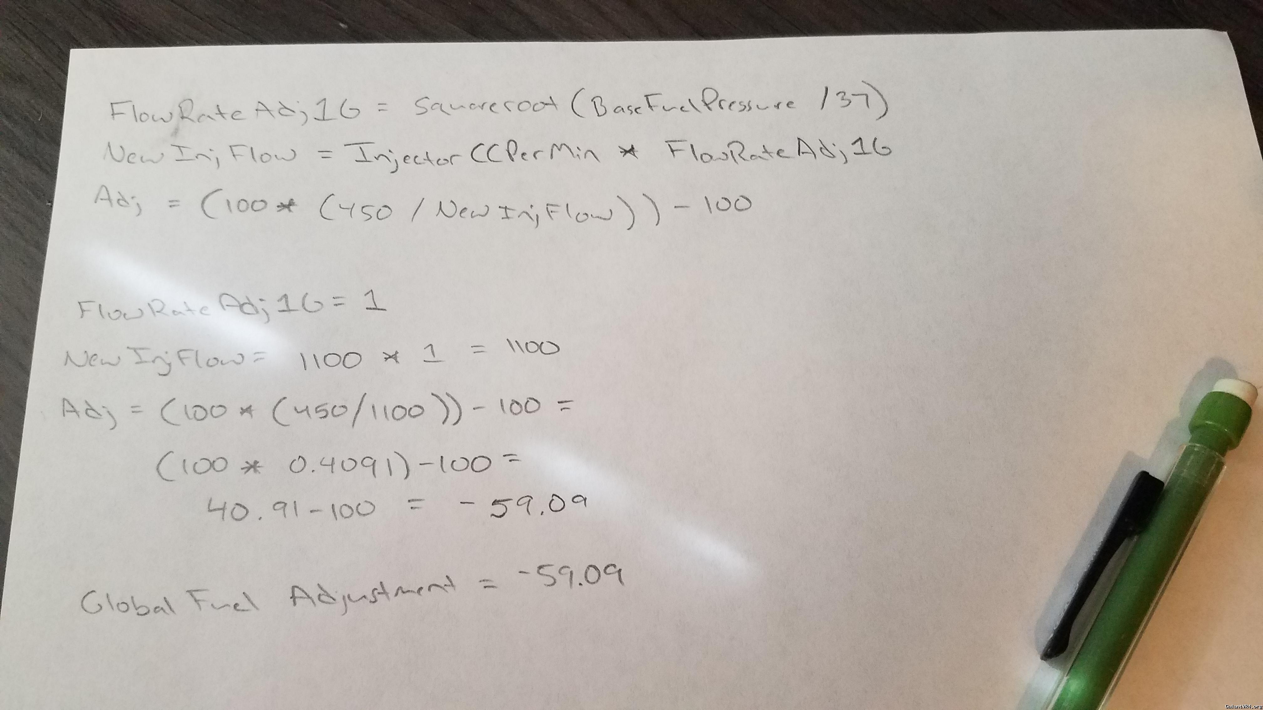

Bringing this thread back from the dead....a couple years have passed and I haven't had time to get to the car...until now.
First thing I did was drain the old E85 that was in there. Filled the tank with some fresh 91 octane. I then set about using ECMLink to change my global settings to accommodate the 91 instead of the E85. Tested battery (had it on a tender) and it tested fine. Tested fuel pump with Link and whirs just like it should. The engine turns over but doesn't start. Before I could get it to run with throttle application, now it won't start no matter what I do. Gonna start by checking for spark. Not really thinking the MAF is bad (it's a 482) and has always functioned perfectly. Any other things to check out?
