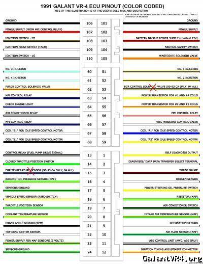

alansupra94
Mar 3, 2010
1,909
Wayne,NJ
Thanks, it does look like that is what I am dealing with for the most part. I will be out there soon with a full pin out soldering and shrink wrapping everything like it should have been done.

My car had a dozen or so random wires attached to various ECU wires which I discovered upon installing my Evo ECU. I know some of them went to a turbo timer and it appeared some went to what probably was a previously installed AFC. Since I had the pinout, I didn't care. If I thought it was useless, I cut it out. Several of the wires have multiple wires connected under an insulated section as you pointed out. I can send you a pinout PDF but I don't think it has wire color. For the most part, if a wire was cut, I just removed the offending additional wire and resoldered it.

This might help if you didn't already have it:

I just noticed that /ubbthreads/images/graemlins/rofl.gif
Thanks guys!
