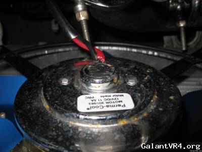

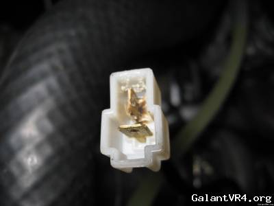

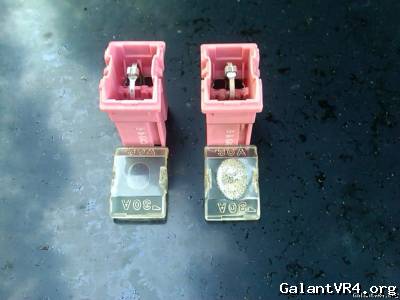

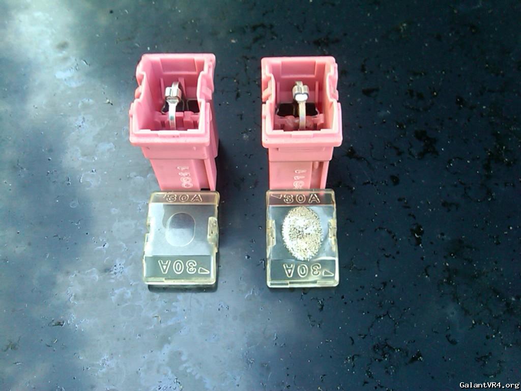

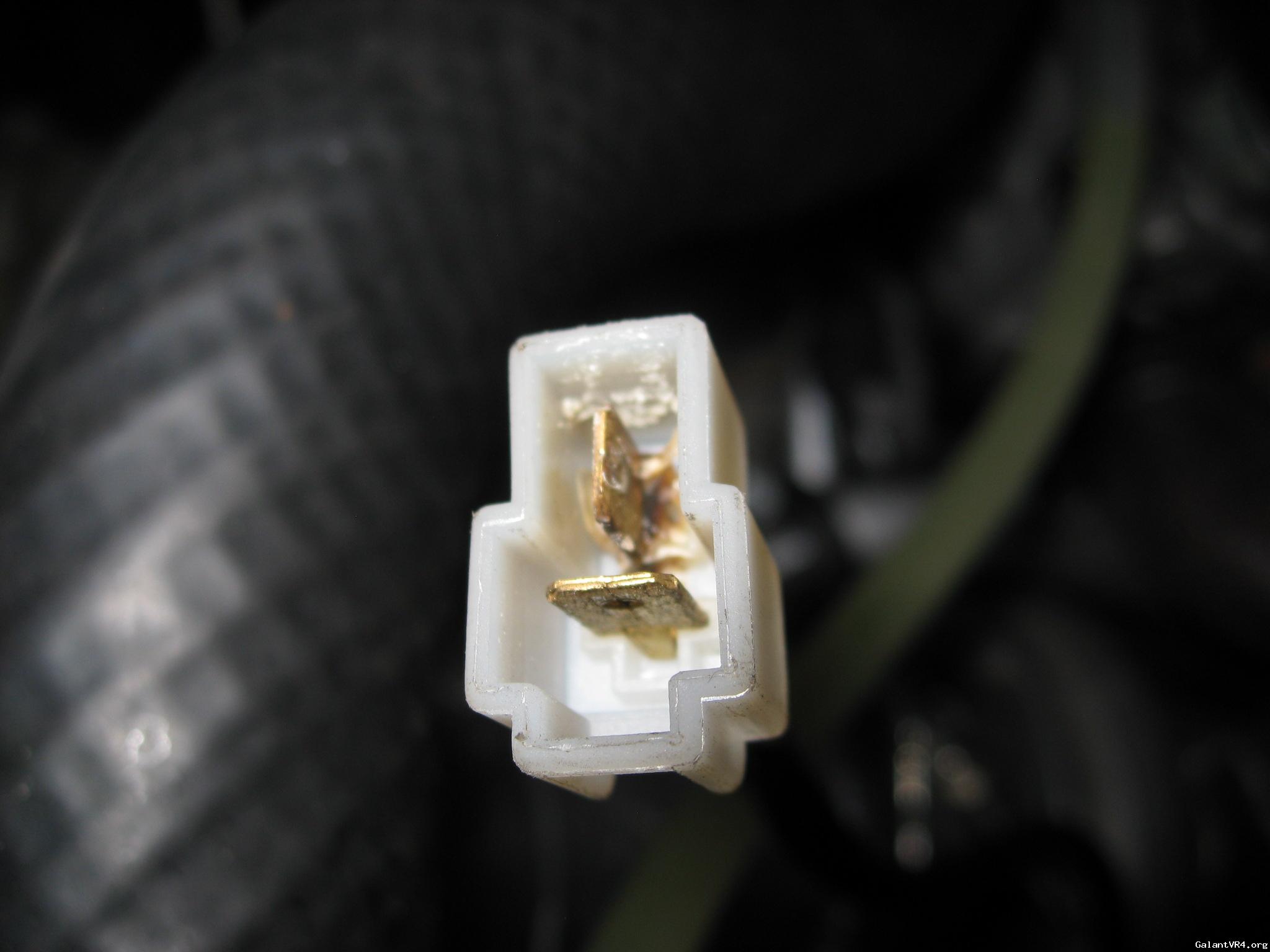

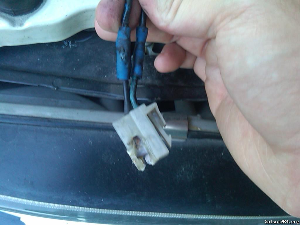

Inspect the damage. The relay is very hot. 30 AMP fuse under fuse box for radiator fan's clear cover is a little bubbly. Pull it out and open the cover. The connection looks to have expanded but didn't pop.

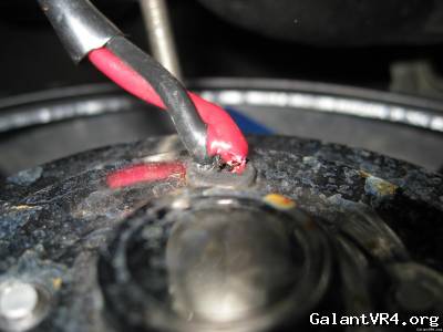

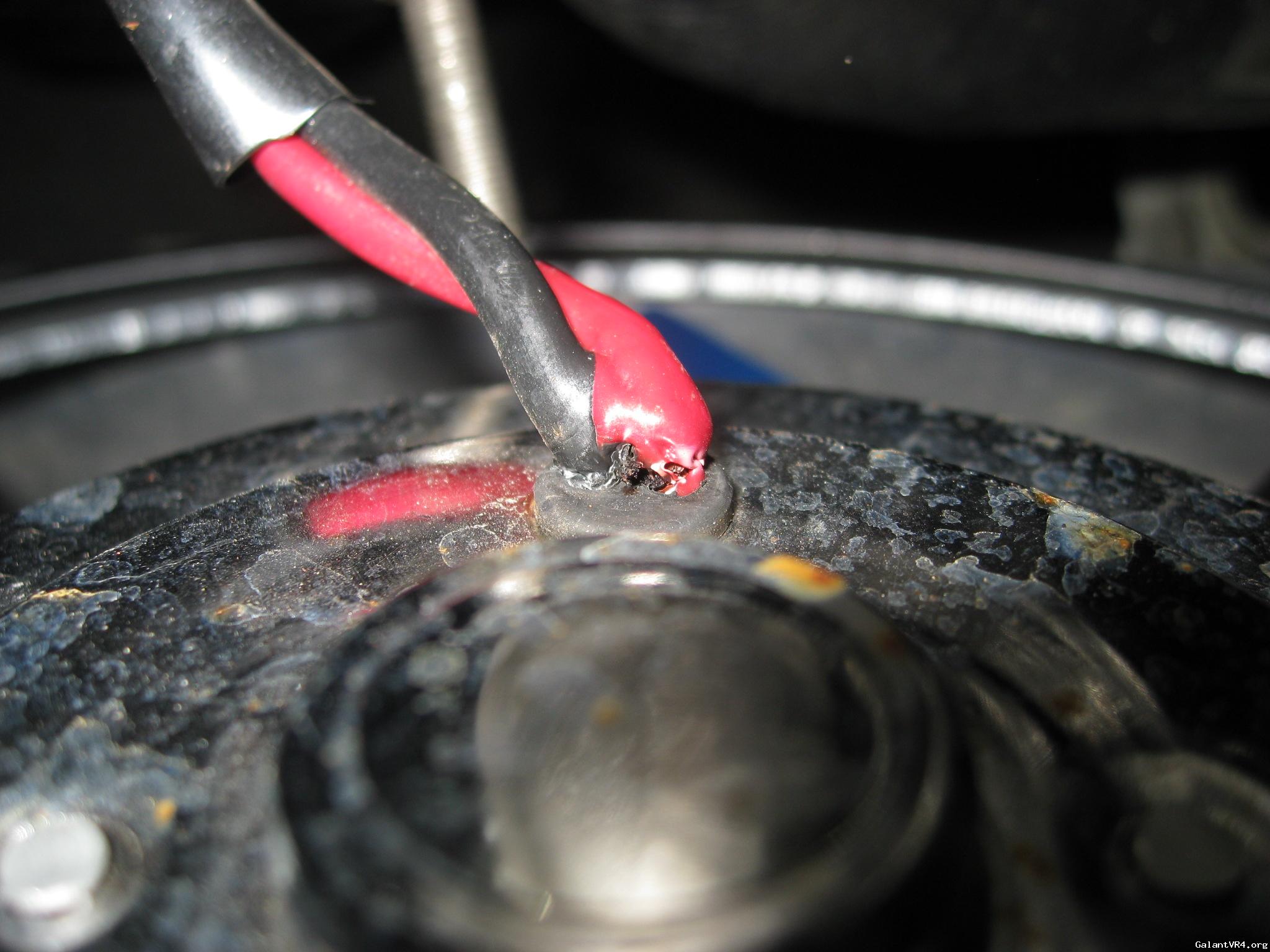

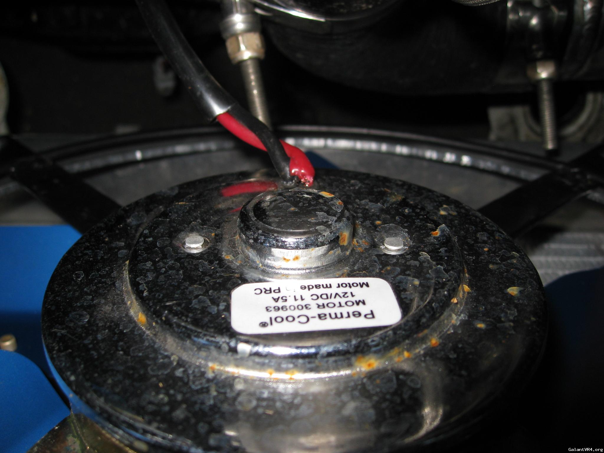

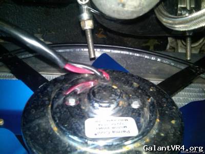

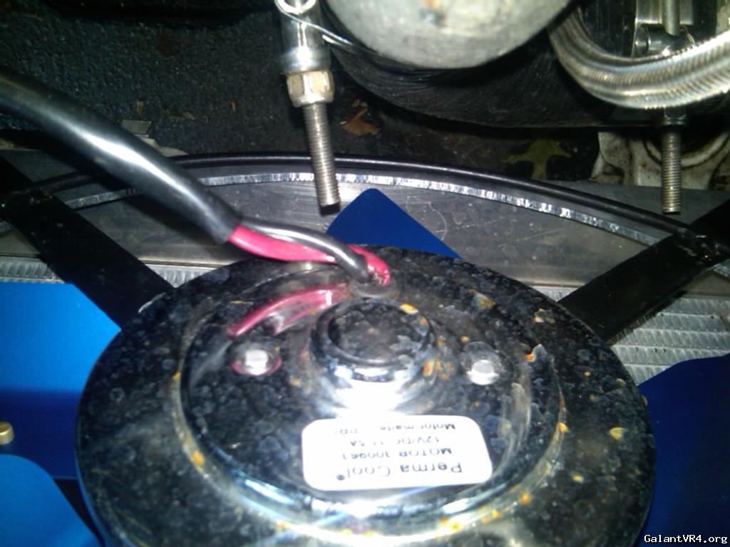

Wires directly connected by the base of the radiator fan motor are a little melted. Also, the pigtail connection (positive side) is melted. Was there maybe a short or too much current?

I ran it off the stock wiring using the stock relay for the when temperature switch engages. This setup was working fine for over a month. The reason I used butt connectors was because the wires wouldn't solder for sh*t. This time around I'll try my best to get them to solder.

In your second picture it looks almost like your wires may be melted together at the fan motor where they are twisted together. I had that happen on my o2 sensor wiring. untwist the wires and see what it looks like. that's a real quick way to burn up your harness I ended up having to replace that whole section of my harness. it sucked.

I went outside and looked more closely and I think you are right. I think that may have been the source of my problem. Called Perma-Cool and they won't even discount me. But I mean I bought the fan 2 years ago and it had a one year warranty. Just sucks. I've only had it installed and running for over a month. They wanted $250 for a new motor! But have none in stock. So I have to settle for a used one for $100.

Looks like the hot lead grounded out to the body of the motor.
And this is why I was probably sparking when where the radiator was touching the radiator support. The fan is connected to the aluminum shroud which is connected to the radiator...all acting like part of the circuit. Damn.

It looks to me like you can take that cover off and there solder in some new wires. Give it a try, it's worth you time to have a go at it. shouldn't be that hard.

The problem must be within the motor since the wires coming directly out of it are fried. I guarantee its cheaper to buy new. Just make sure you replace all of the factory wiring that is supect too or you will just keep burning up.
Since you saw arching I'm guessing the windings of the motor got shorted out to the case of the motor.
