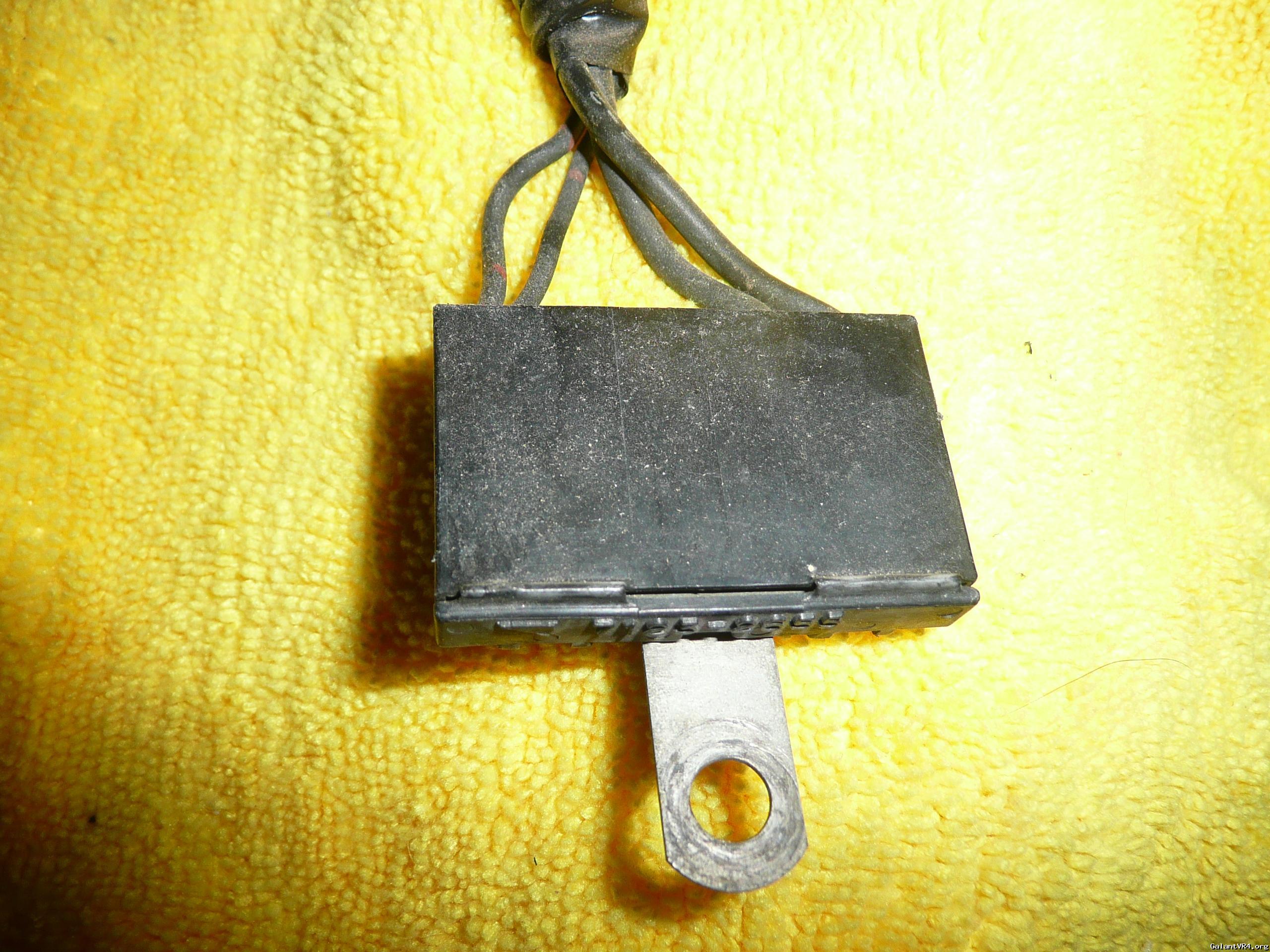

Those systems share a pair of common grounding points in the the engine compartment.
It's *possible* if they are not connected (or corrosion is present) that you could get these symptoms.
[edit] this is the connector
They are located on the inner fenderwells up towards the top on either side of the engine bay, toward the front.
Scrape any paint off the body around the screw hole, hit the terminal with a wire brush, and good luck,

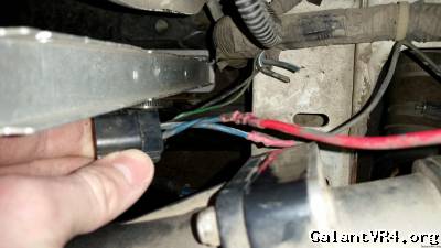

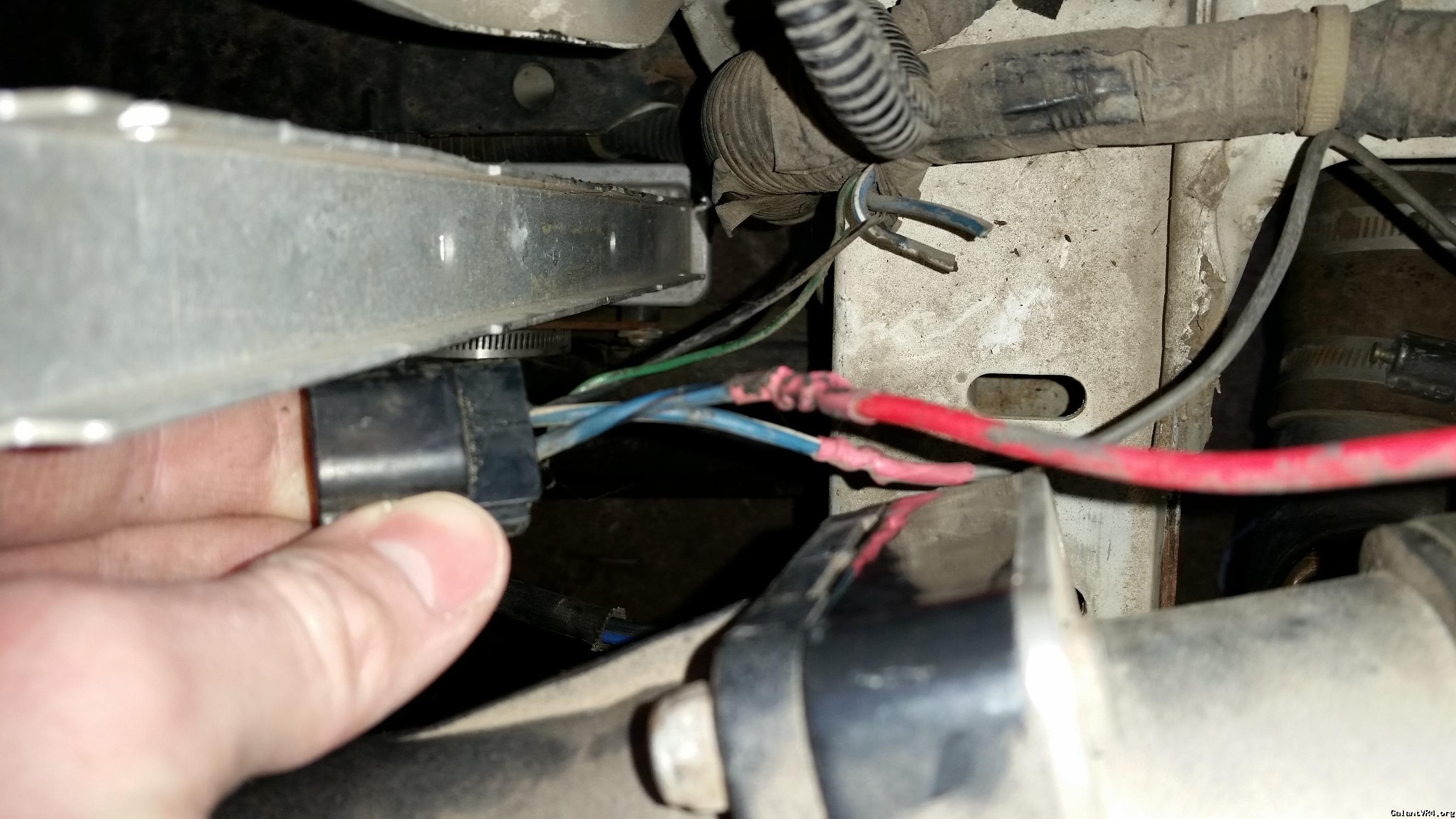

Thank you for the schematics. Unfortunately. the fan wiring has been the same since i brought the car, i have no idea how the previous owner wired it up. I took a picture of the connector with the splices, maybe it will require me removing it all and rewiring it from scratch. i dont know. But i went to check the car and the battery was almost completely dead aswell, in about 2 days which is unusual. so it seems there are some weird electrical issues going on. for example. key out of the ignition, door open, i can roll the window down. I dont believe that is normal?
