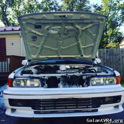

Just got word that the motor should be done this week so that is a win.
Today it rained it ass off here in MD but i got done what i could under my pop up tent.

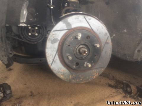

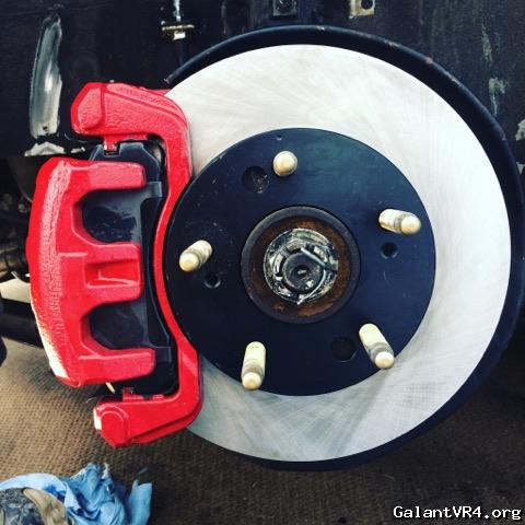

My goal was to get the ABS Delete done and get ready to do the 5 Lug swap and install new brake parts.
Was going through my parts and "test" fit the BLOX extended studs that i ordered from JNZ.
they didn't fit at all, after looking on the website and emailing them, "some products may need to be spot welded" applied to me
which i found a little misleading because most of the stuff that they have on their site is pretty specific fitment for our cars.
Didn't sweat it, got the RMA and ordered ARP ones from extreme PSI, lesson learns.
I used the How to for ABS Removal on here link and skipped the stainless steel line brake line install because i had done that previously. After about ten minutes of messing around with all the 10mm wrenches I had, I went to lowes and bought a set of line wrenches

Ok so it has been a busy week with work for me but i have been trying to do a little bit everyday.
The 2 front hubs are swapped out with all new brake parts and extended studs on
I have the next two days off so getting the rears done should be no problem
The LMs got through customs and are finally in the states and motor is just about done =)
Goal by tuesday is to be able to drive the car again with the new brakes and 5 lug swap

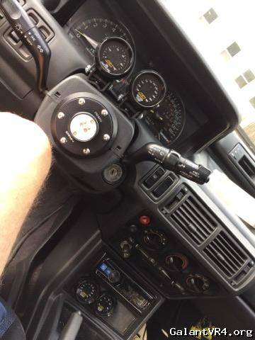

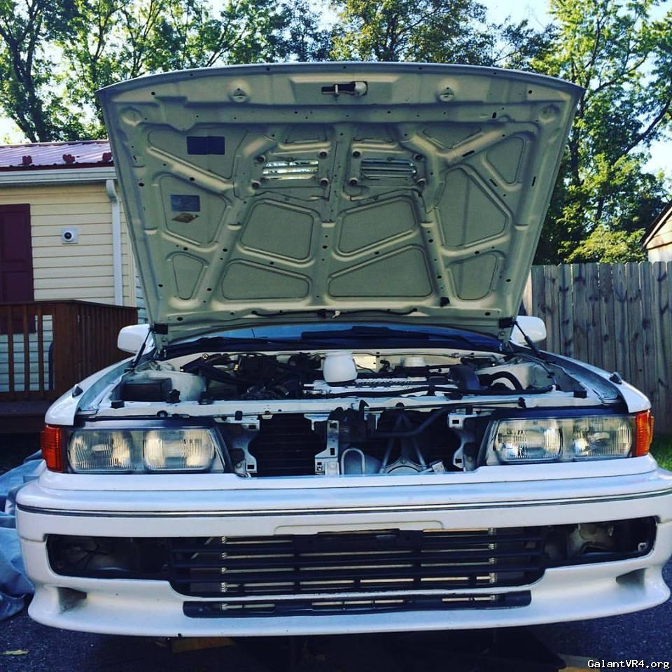

Just a quick update:
got all of the gauges mounted where i want them and wires ran and connected, getting ready to pull the motor hopefully early next week (weather dependent)

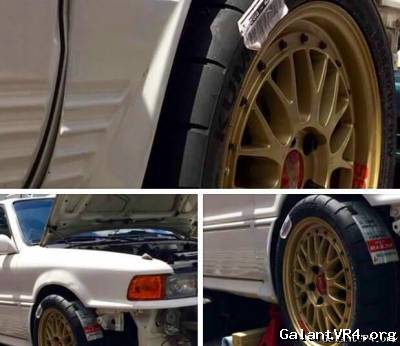

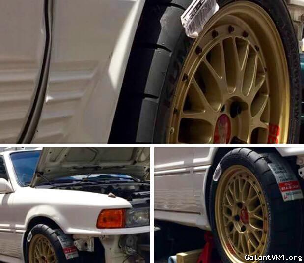

had to throw the bbs on just to take a peak and see how it would look /ubbthreads/images/graemlins/jawdrop.gif /ubbthreads/images/graemlins/jawdrop.gif
Let me know what you guys think! hopefully get some more stuff cleaned up/done this weekend

Looking NICE!!!
Love the build and the gold-BBS wheels are gorgeous /ubbthreads/images/graemlins/smile.gif
What are the specs on your tire + wheel setup?

thanks man
the wheels are 17x8 +35 in the front and 17x9 +35 in the back
all the same tires to keep the rolling diameter the same (so i could run stagger, wheels are hard to find, not patient enough to wait for a squared set in this good of shape)
tires are Kuhmo Ecsta v720 245/40/17

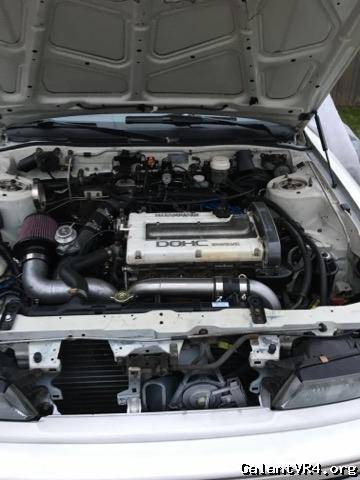

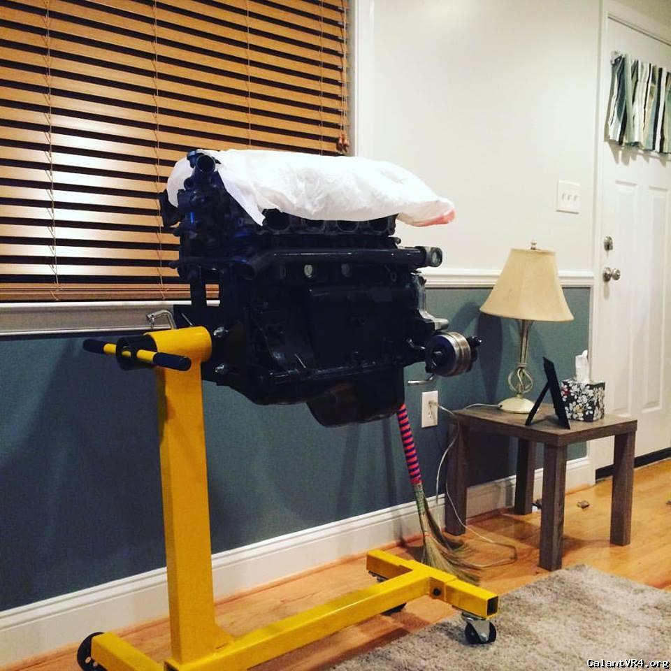

Motor is bolted in (well almost)
/ubbthreads/images/graemlins/banghead.gif
the rear mount that rock auto sent me was wayy to tall and after looking at a couple threads, i didnt even attempt to try to make it fit.
It really gets ridiculous because like a complete idiot, the night before I had tossed the old ones in a trashcan, that had mistakenly got taken out,
and the trash got collected that day. lol if you couldnt follow that, im an idiot and my stock mount is gone forever. /ubbthreads/images/graemlins/bawling.gif
That being said, the other three mounts are in and tight and the motor is no longer is my living room.

ALAS! yesterday in between the raindrops i chunked the galant onto a trailer and dropped it off at the shop.
Need to adjust the clutch pedal and go over the car on the lift one more time and then throw here on the rollers.
Hoping to make similar power to my Evo x, 350+ is the goal.
Will post video =)
