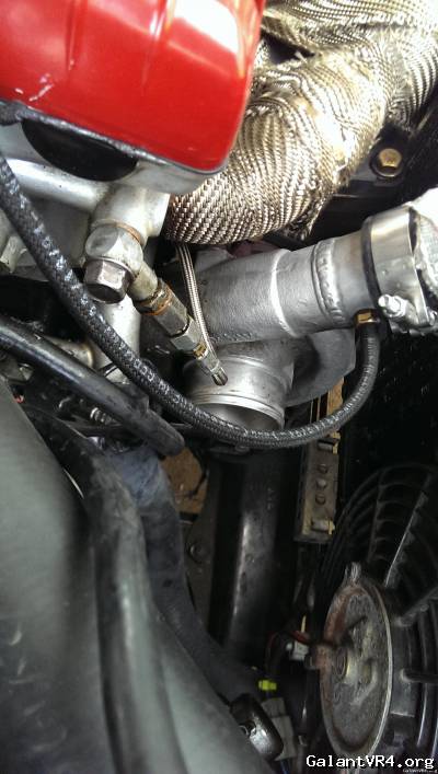

Follow-up.
A few weeks in and no flutter + I'm holding boost through quick shifts. A+ mod/would recommend!

I'm using a dodge garage modded Nov a d have a bit if a kink in the recirculation hose. At part throttle with anything over na vacuum it can start fluttering unless I'm in full boost or accelerating. It makes it very diffacult to keep a constant speed. Fluttering and bucks. Don't know what I can do to resolve this.
EfiniX
Oct 18, 2012
647
portland, or
wow, back from the dead! Old post.
Well your situation isn't my situation as I've got my BoV vented to atmosphere (SD conversion). I doubt the kink in your hose is an issue if it's behaving at high-boost, but fluttering at medium to low.
Is your BoV crushed? Most DSM stock BoV's that I've seen are. Considering how the Dodge-Mod BoV operates, this could certainly cause some issues. Also, did you confirm that all of your airflow points are clear and flowing properly? I know if your external boost reference port is tapped to far in, it will obstruct the airflow, which could potentially cause the issue you are describing. Finally, where is your external boost pressure line connected to? I've got mine tapped right into the turbo outlet for quick release.

currently it is run directly to the vacuum port on the intake. My waste gate is connected to my turbo with a mbc in between.
The valve is not crushed. I'm fairly certain I performed the mod correctly. I will however take a look at the external port for signs of obstruction.
It does seem to be open during idle thought. I don't really know what that's telling me.

There's your problem. The hose needs to be connected up somewhere between the BoV and the turbo outlet. The closer to the turbo outlet the better. Best option is to do what I did and drill a hole in your turbo outlet, tap it, and install a nipple to hook the hose to.
EfiniX
Oct 18, 2012
647
portland, or
T'ed right off the new port. I actually used this mod as an excuse to move my wastegate line off the intake manifold.

So, just so I get this right in my head... The original port on the bov goes to the t connected to the nipple I taped into the compressor cover. And the tapped nipple in the bov stays open to air.
What signal boost or vacuum opens the valve? How does it know the throttle plate is closed if it can't see the pressure in the intake manifold?
EHmotorsports
Sep 25, 2012
1,283
Beaverton
His BOV is plumed to the port behind the throttle plate. The tapped nipple is vented to atmosphere.
If it is not that way any longer I will be having some questions for him tomorrow when I see the car.
