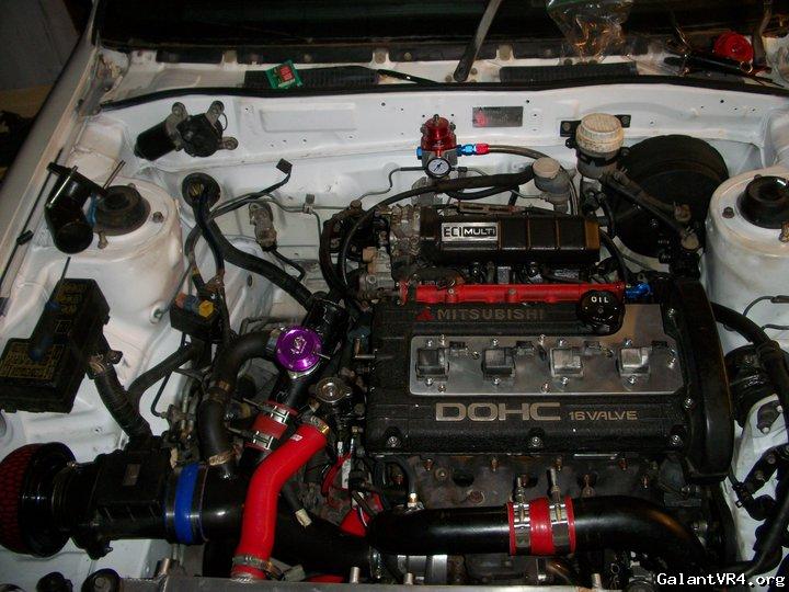

Why are you switching BOV's? Is it because the flange/pipe is rusted? New IC pipes? you're turning the boost up alot? The reason I ask is because the 1g BOV are built quite nicely and can handle a decent amount of boost pressure. Regardless, Removal is simple. Disconnect vaccume and recerc tube and unbolt the 2 bolts on the flange. Use some PB blaster or another penatrant if they're rusted on. Instalation will depend on which valve you decide to go with. Greddy can retain the stock flange IIRC you just need to drill and tap for the bolts. Any others and you'll need that specific flange and possably someone to weld it to the pipe.

I bet when you ordered your BOV, you chose the dsm flange..... well that's cool and all but, you ordered the dsm flange for a reason.... to have it welded onto new shiny IC piping....

Indeed. That guy must have been influanced greatly by the minimalistic approach and shiney COP setup that Broxma has. Hmmm. /ubbthreads/images/graemlins/rofl.gif
