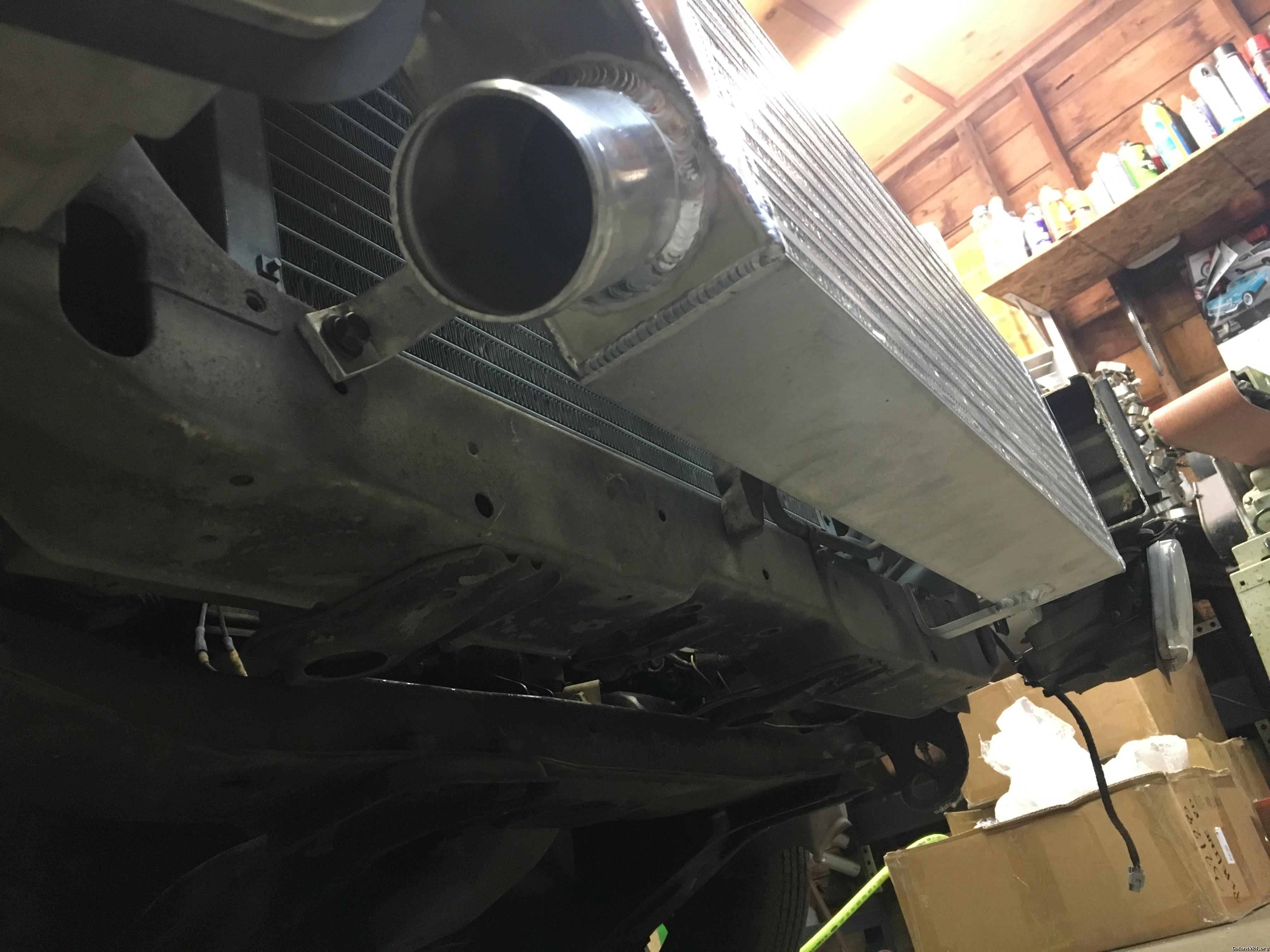

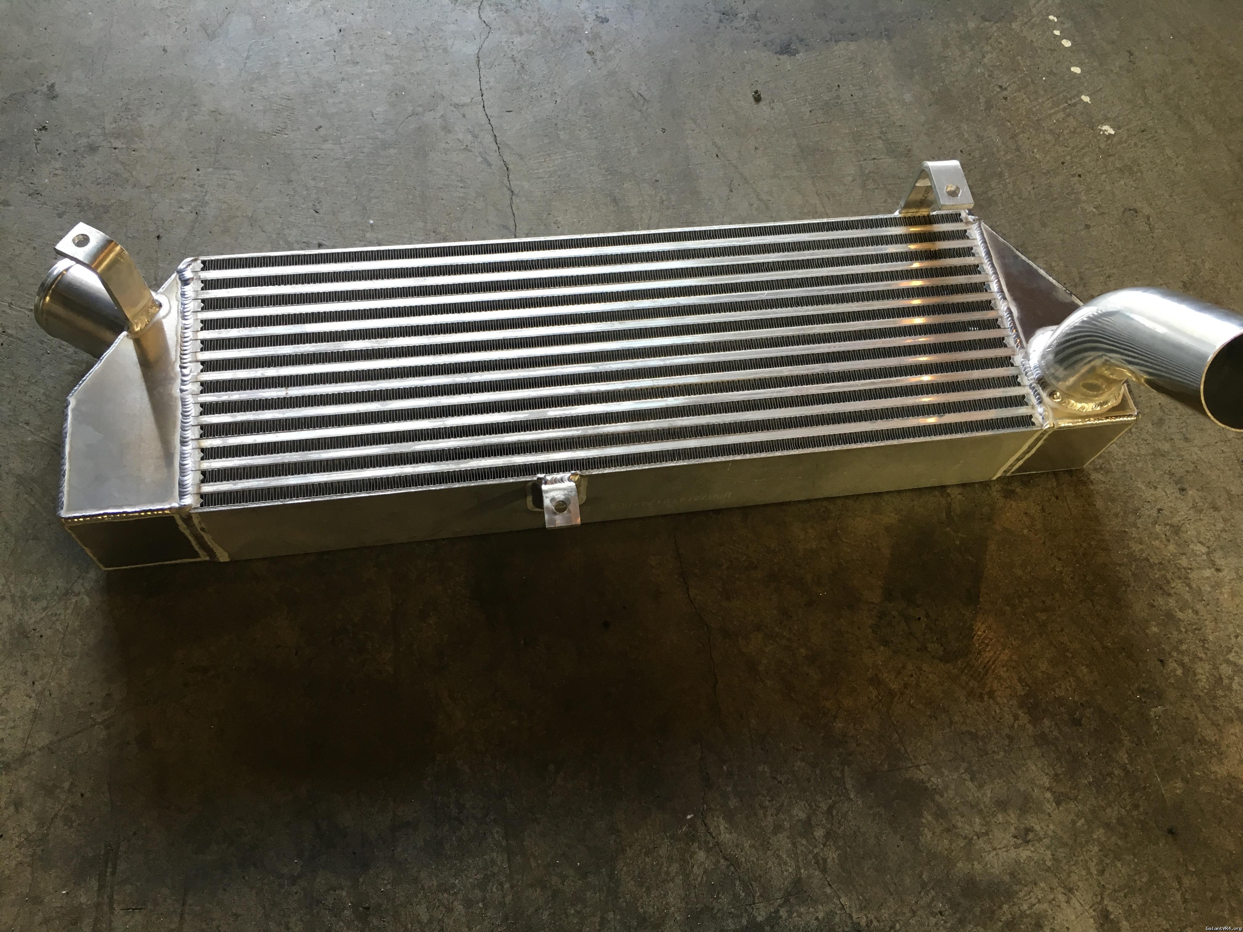

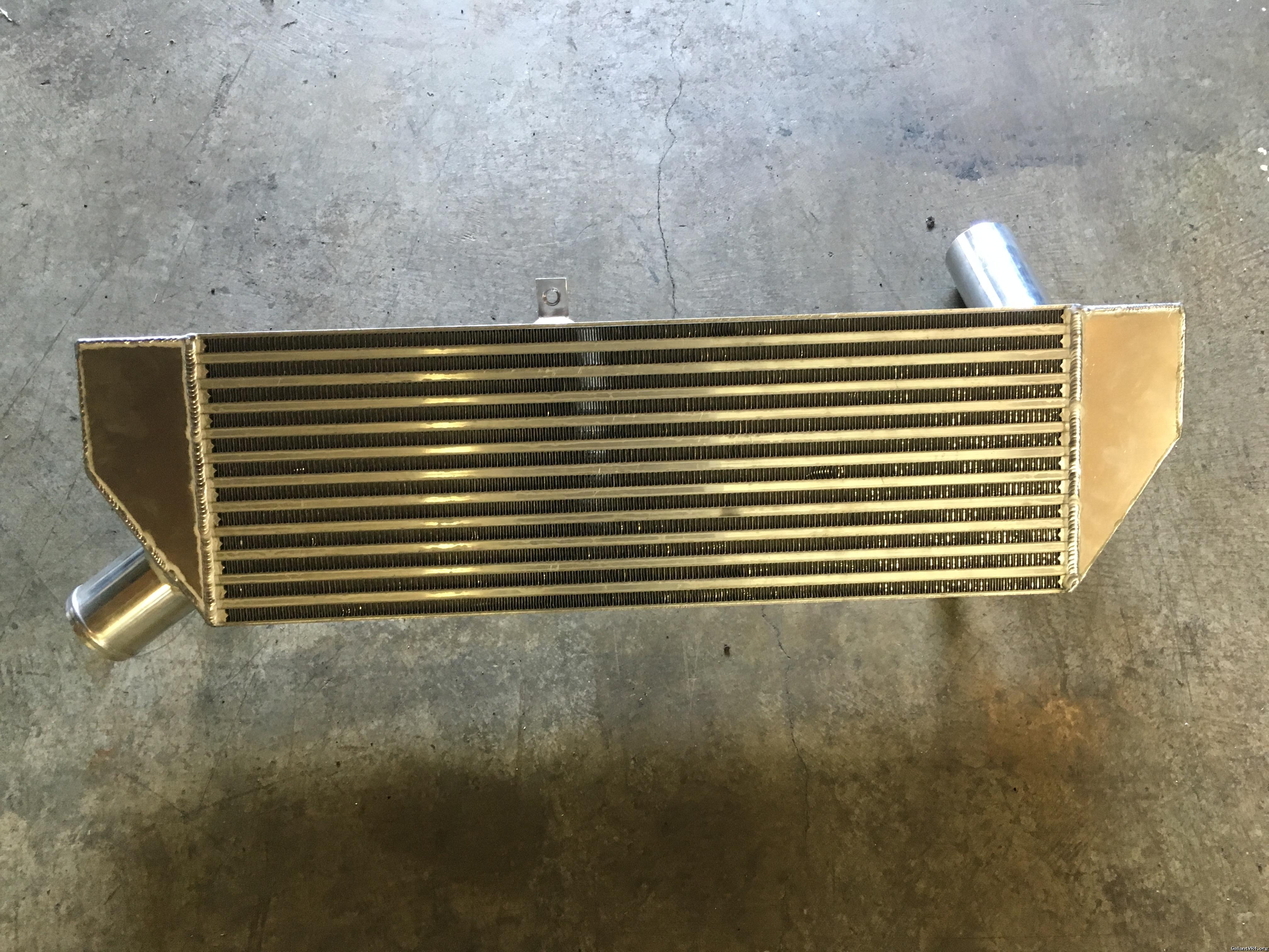

Still plugging away. Intercooler is done. Hot side piping is just about done. Just realized I need flanges for the throttle body, will draw it up and have them water jet cut. Thanks for being patient guys, I have been extremely busy, and only getting more busy everyday!

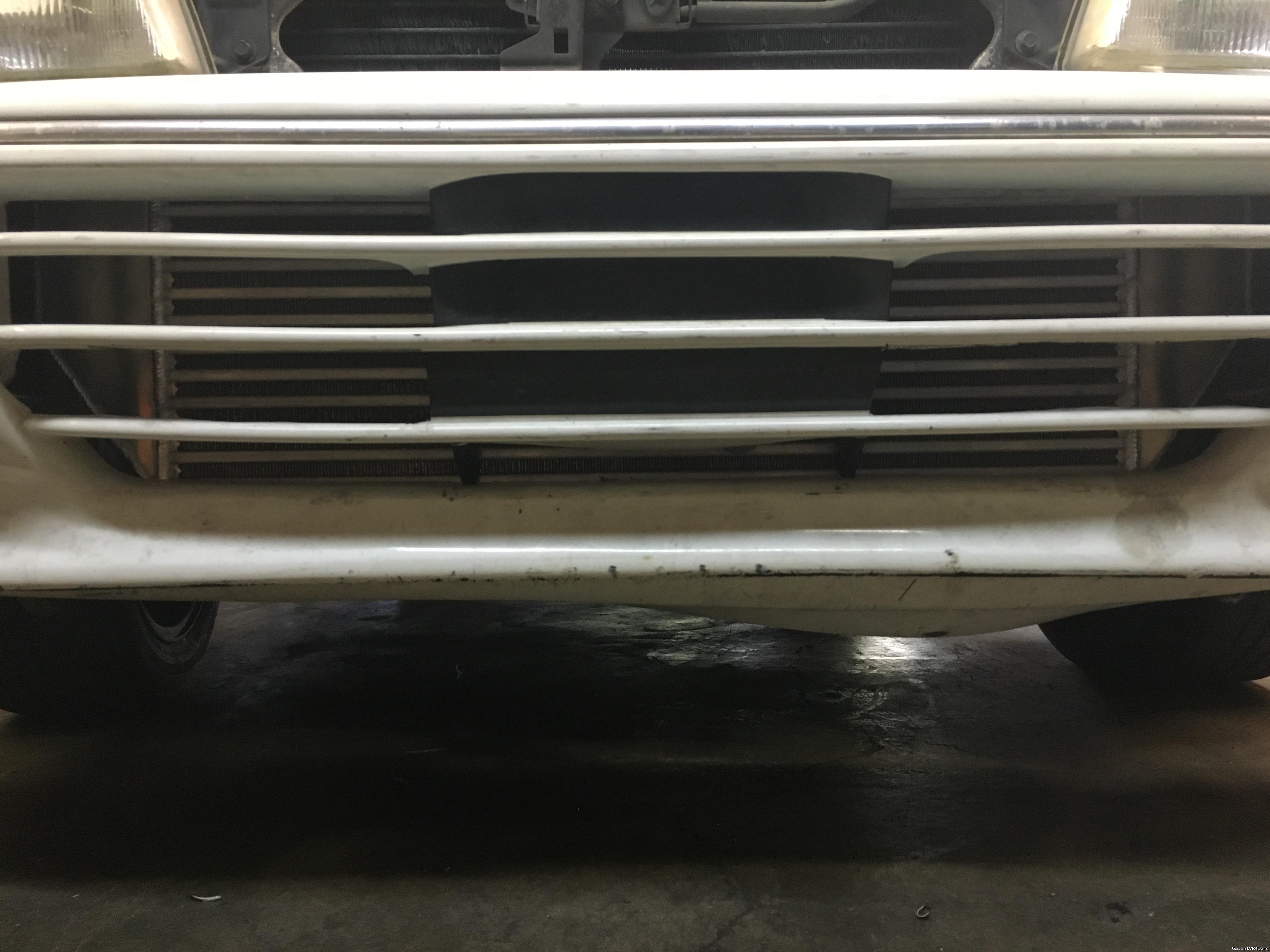

No you don't need to cut the bumper support in half, just remove enough to fit the intercooler. I couldn't be bothered, so I cut it in half with the chop saw /ubbthreads/images/graemlins/rofl.gif
This kit will clear fogs, I have no way of telling weather it will clear jdm bumpers, can any one think of an easy way to tell rather than mocking up a jdm bumper?

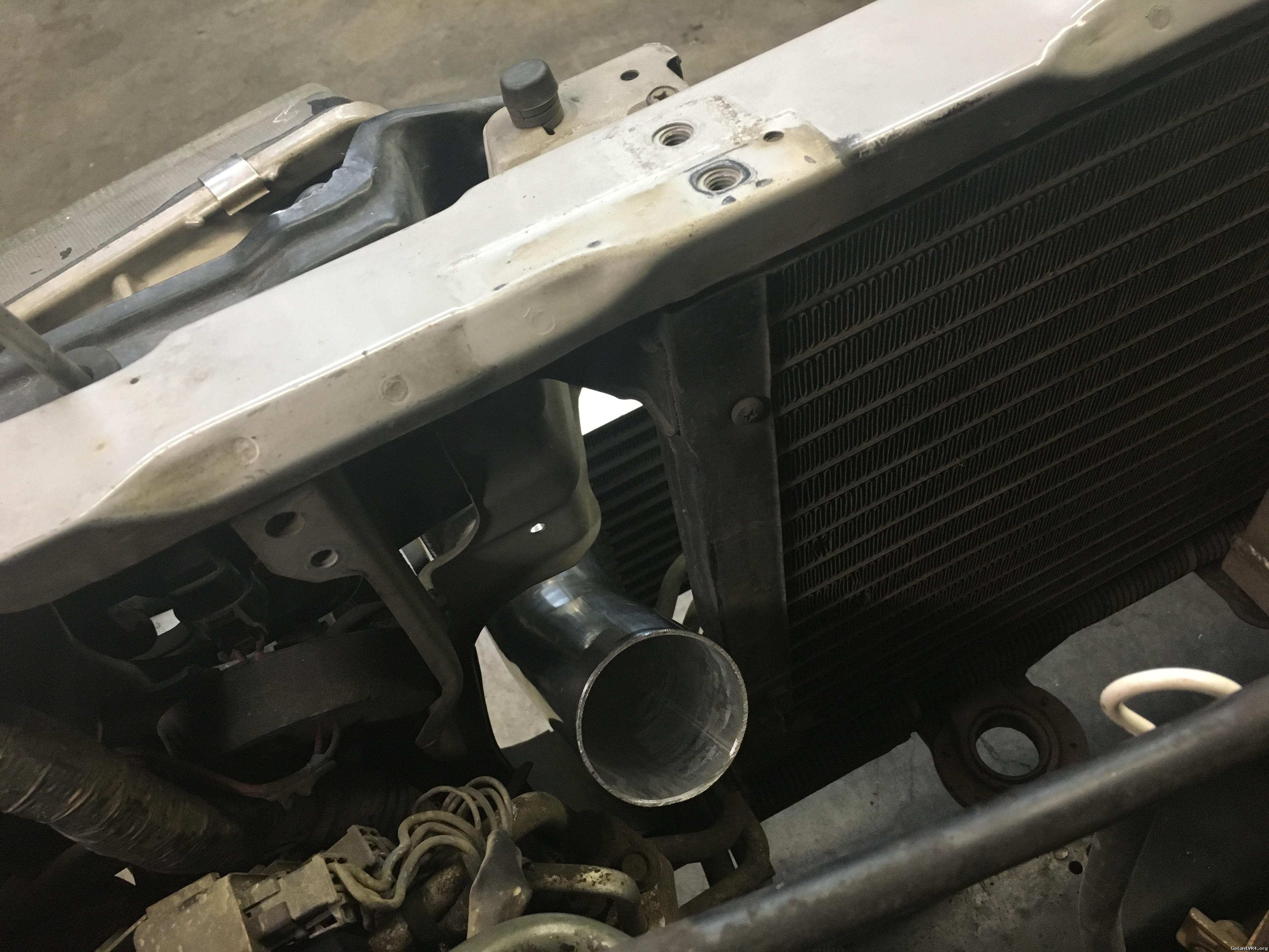

I'm interested in the intercooler and 16g outlet to intercooler parts. Previous owner welded a battery tray back near the firewall that will probably interfere with your piping on that side.
Send me a picture and I can tell you if it will be an issue, the elbow coming off the throttle body will be very similar to the ETS elbow.

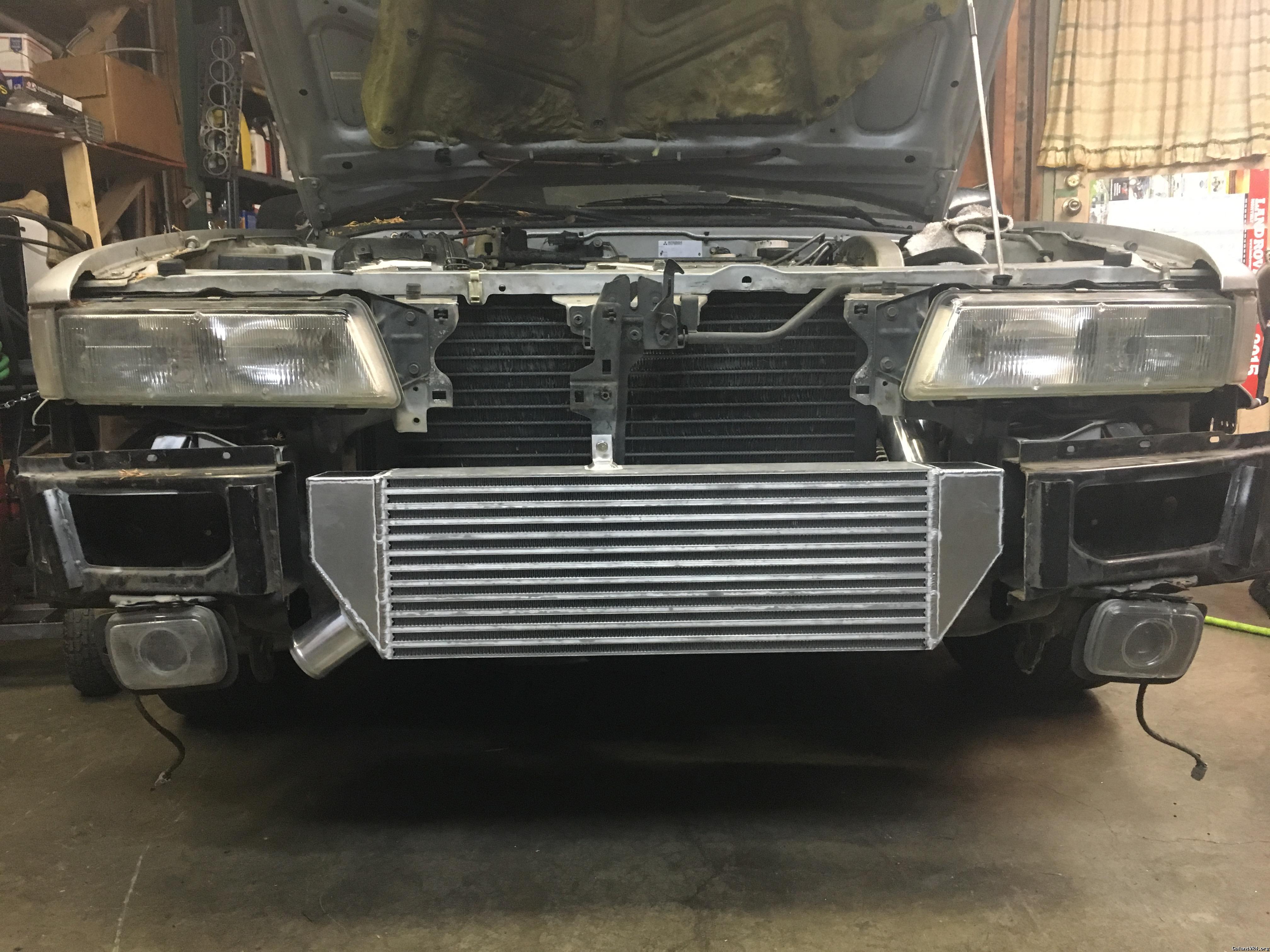

Just chiming in with some info:
I built my own IC with a welder friend back in 2000. Wish I had taken more pictures, but back in 2000, I had to borrow a shitty digital camera. Now I need find them!!!
Bought parts from RRE - Used a Griffin side-side flow core (it fits in the same place you put it and it was a little bit taller than yours) and HKS endtanks. I think the core/endtanks are still listed here: click
We welded the tab exactly where you have it, off that hood release latch (I had to trim a little bit of it off). The bottom bracket was bolted somewhere on the bottom of the frame.
The in/out piping was exactly as you have it. I only had a 16G, so just used a 2.5" to 2" reducer for the stock little pipe section to compressor housing. I think you might be able to use a 2G J-pipe, chop it and re-weld it for a slightly better flow.
I had battery relocated to rear and 2G maf/intake so the upper IC pipe was routed under the intake pipe, and took the stock routing to the IC. I was able to retain stock fogs and A/C.
