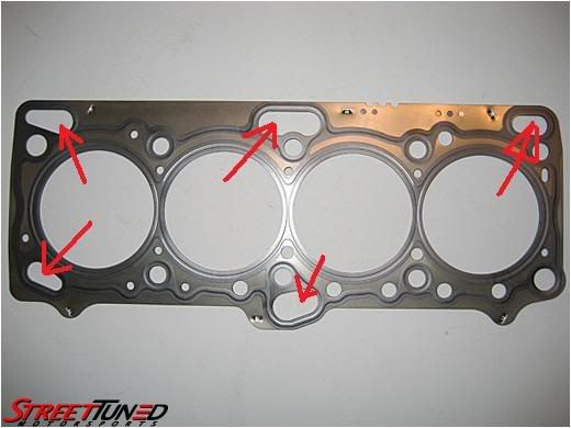

Milky white in the oil, or top of the VC and coming out of the vent tube is ALWAYS water in the oil.
Now, here is the bad news. Water in the oil, while running the motor can cause major bearing damage.
Do a pressure test and watch for air bubbles in the radiator.
I would bet that the head never got torqued down correctly. Maybe the correct lube was not used on the threads and BOTH sides of the washer causing a friction issue fooling the torque wrench. Or maybe the head studs were never re-torqued after a heat cycle.
Good luck.

You have a leak between these two cylinders. That part is guaranteed a head gasket breach. The question now becomes why. Machining? Assembly? Bad gasket? Other?
Most likely you sort that out and you'll see things start to improve. You very well may have another issue as a result, but That is issue #1, and should definitely clue you in to what else is happening. They PCV and vent running into each other with no actual outlet doesn't help either. You may find the head gasket open to an oil passage as well, but you need to pull that thing first to find out.
