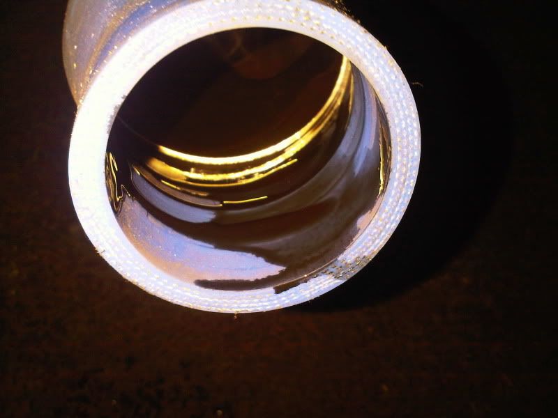

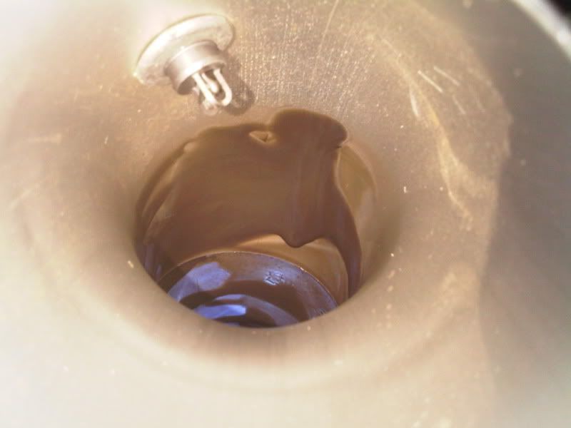

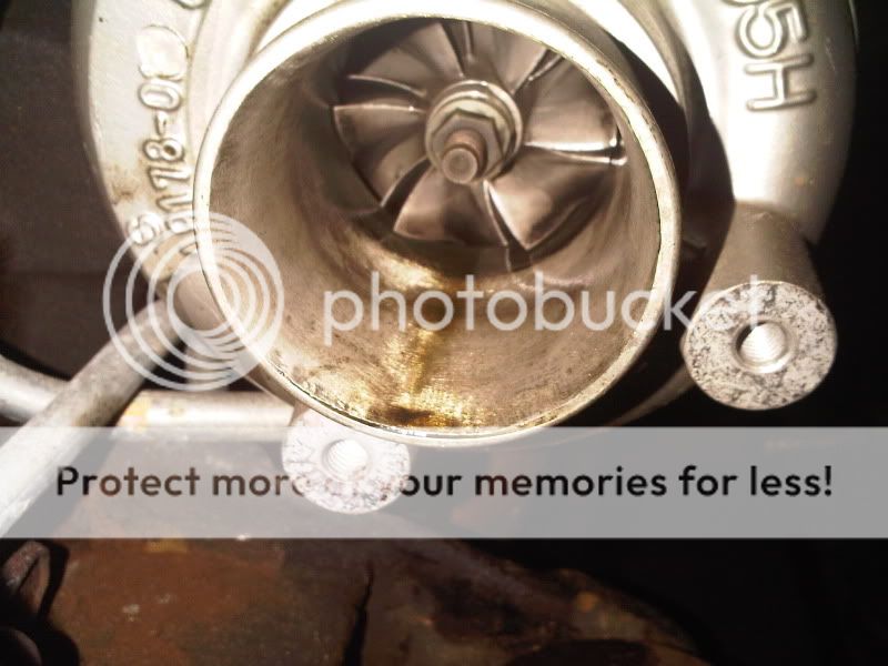

I just pulled of my intake. I found a crap load of oil in my intake. The turbo has no shaft play up and down or in and out. PERFECT!!!

Oil past the oil rings on the turbo. Caused by too much crank case pressure.
You will need to clean out all the intake piping and get the crank case pressures down.

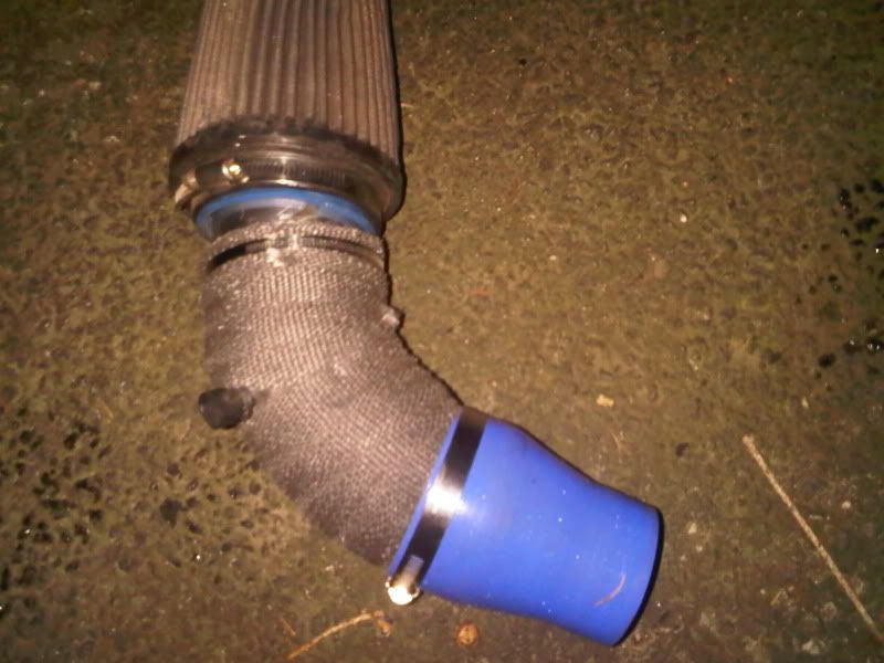

Here is my intake + my findings.

Is that a real MHI 16g or is it a china 16g. As for you miss. Clean the Maf that is now socked in oil.

I dont think the oil went that far to reach the MAF but I will check now.
And its a real MHI 16G turbo.

Oil never made it up to the MAF. I just pulled the piping off the turbo and not mouch oil. The pulled piping off the TB and MAF and dry as can be. No oil made it through the intercooler. This didnt happen at any high boost levels. This happened at idle...

My turbo was the same. Zero shaft play.

Unless the shaft play is abnormal, like wheels scraping housings, you don't need to replace seals. If it's that bad you have bigger things to worry about than just seals anyway. The seals are just metal rings that work off of pressure differential, like piston rings. By blocking the crankcase ventilation, you make it so they can't work correctly.

Well I have no shaft play at all. Spins freely. PERFECT!
