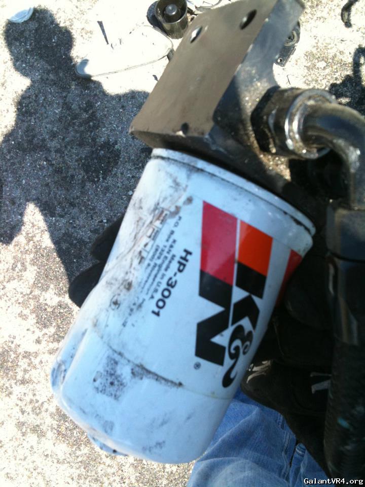

Guys, Thanks for all the stories, concern and options for a fix...The rubber piece/o-ring was hanging out the side of the filter. I had been told before, that I should put some sort of brace on it because this could happen at full boost. I was racing a sport bike and was to busy driving the the car. It was a dark night so I did not notice the oil leaking out. If I would have gotten some tire spin from the oil, I would have backed out of the throttle to save the motor. By the way I won the race but lost the war. I will invest in a warning light/sound oil pressure gauge. Im gonna also move my oil pressure gauge closer to my field of view. Currently its under my radio on the console, not much good down there. Im thinking about coming back with a 2.3 strokerrrrr. We are pulling the motor this weekend. 654 should be back on the road in a few weeks.

A long time ago there was a thread about this on one of the other DSM forums I frequent, most of these aftermarket filters have a "squared off" o-ring instead of a genuine o-ring as seen on the OEM and some other premium oil filters. It was the general consensus that over tightening the filter, excessive oil pressure, using solid or urethane mounts which increase vibration, or/and using filters with this "square" o-ring could be the cause of the filters backing off. This happened on both cars equipped with the cooler sandwich plate as well as a '90 OFH. Though I wouldn't say this is a COMMON phenomenon it DOES happen from time to time and the best way to protect yourself from having this happen is to spend four bucks on bar-stock and slip a 20 to ANY hack with a mig welder to make that bracket. That, or run filters with safety wire, either a K&N w/the nut, or put a worm gear clamp as seen here.
I love the people that are like "...this never happened to me or my friends, you must not know how to put an oil filter on!" lol. Anyway, the bracket will keep the filter from spinning off, but it won't prevent an o-ring or filter from bursting and to that end I'd recommend using either an OEM filter or a K&N. That's just me though, and for reference K&N's DO have the squared edge o-ring. I however had one get smashed in a head on collision and it neither burst, nor lost it's seal.

Your oil pressure must be too high at WOT or high RPMs. Back in winter '03 after I did a lot of work to my car, I put it all together in spring. I blew out two oil filters and spewed all the oil out of the motor right at startup. Turns out, the oil pressure relief spring/piston was stuck in the bore, so cold 15w50 oil at high warmup idle didn't mix with a stuck relief valve and blew out the filter seal...twice. Made a mess of the nice clean engine bay and powdercoated parts I had just installed too. /ubbthreads/images/graemlins/frown.gif
Anyway, I pulled the filter housing off and removed the piston/spring and cleaned it up. Reinstalled and haven't had an issue since.
Have you ported the relief valve? I assume you have removed the balance shafts, and possibly done other things that bump the oil pressure up.
