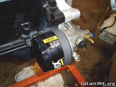

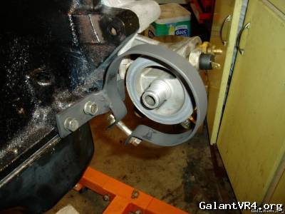

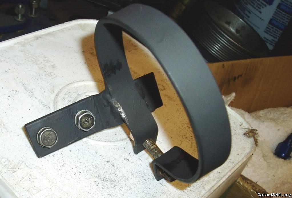

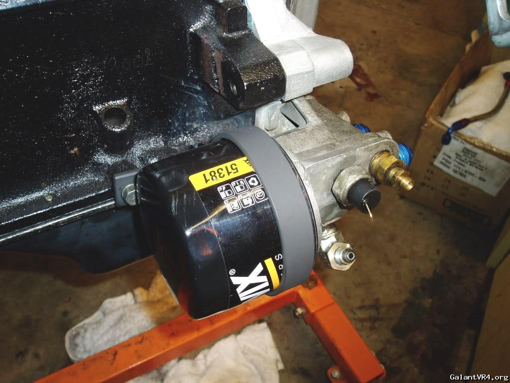

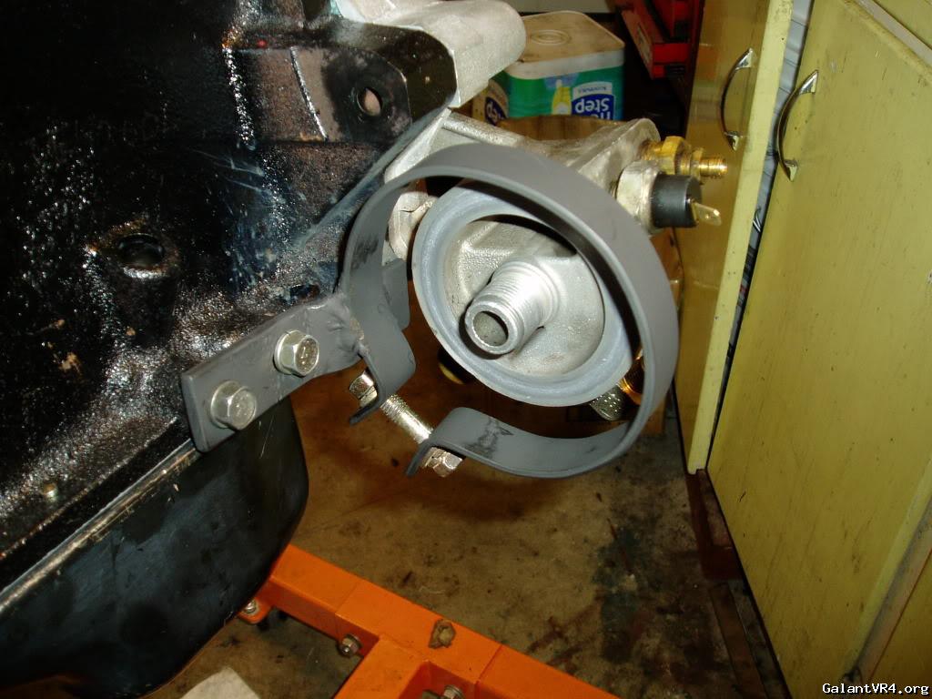

Quoting brunoboy:
...can you produce and sell these?
No sir, in fact this was just a picture of one that I saved when I saw it forever ago because I thought it was a good idea. AMS used to make something similar and ship it with their motors, and I have one that does the same thing but it's a different design. Essentially it's just the circular portion of the clamp with a peg that sticks out, you put it on the filter, tighten the clamp, and the peg rests on the block. That way if the filter tries to back off the peg stops the filter from rotating. Anyways, feel free to copy the idea, you could probably make one with a piece or two of bar stock and some JB weld if you wanted.
