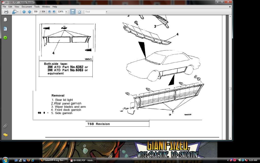

There is thin 3M tape across the top and down the sides. None on the bottom. There are clips, 10 on rear and 14 on front panels, that will pop off. Some will break. Don't worry, they are cheap.
The 3M tape is old and will seperate easily.

That shows you were the tape and clips are. Mine were on there really well, so I ended up putting a bent spackling knief between the plastic and door to cut the tape while I pulled.
