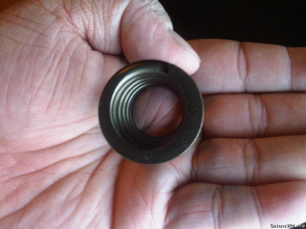

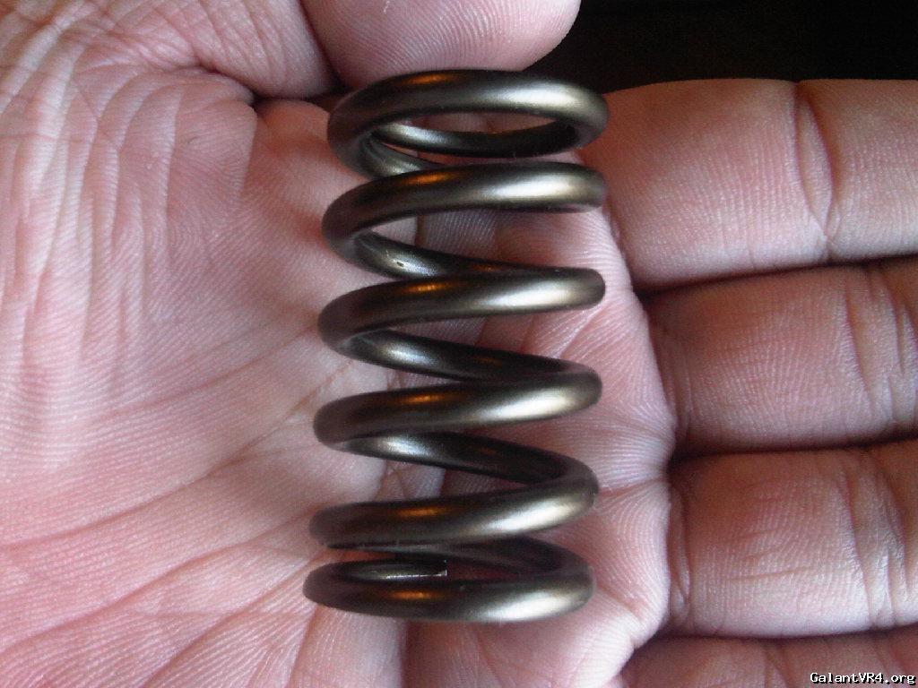

Evo retainers and OEM stockers are designed for different spring types. You ca not interchange one for the other. If the springs you bought are 'beehive' type then you will need Evo style retainers, if they are stock style, then you will need the stockers or ones made to replace the stockers.
Edit: Pic uploading is being uncooperative- I took a couple pics of the two next to each other. Will upload when it's working again.
