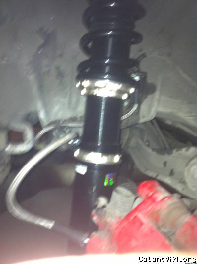

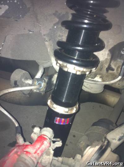

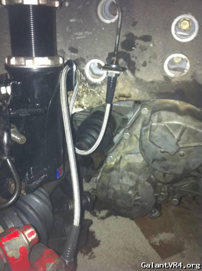

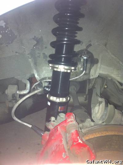

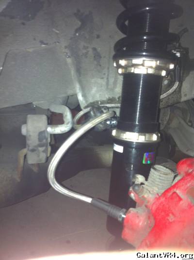

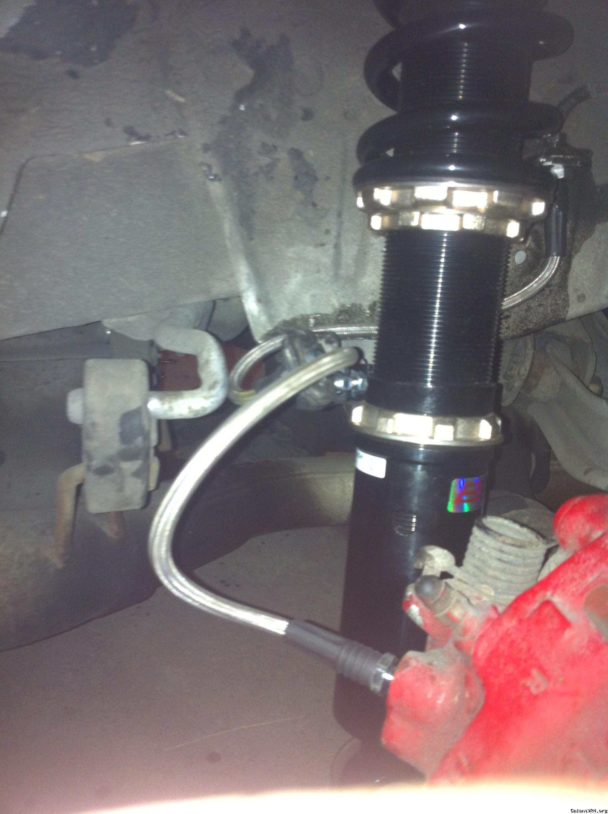

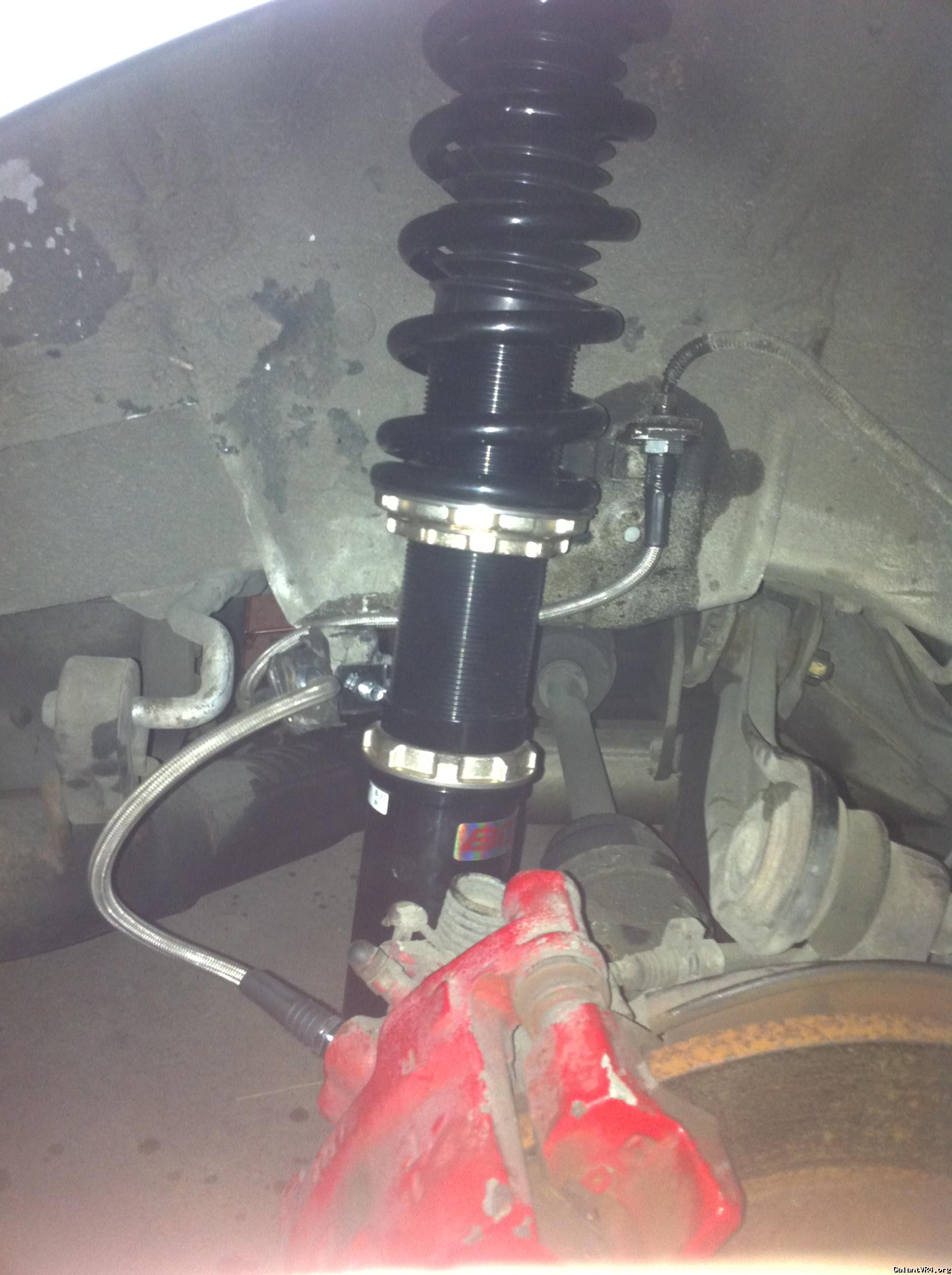

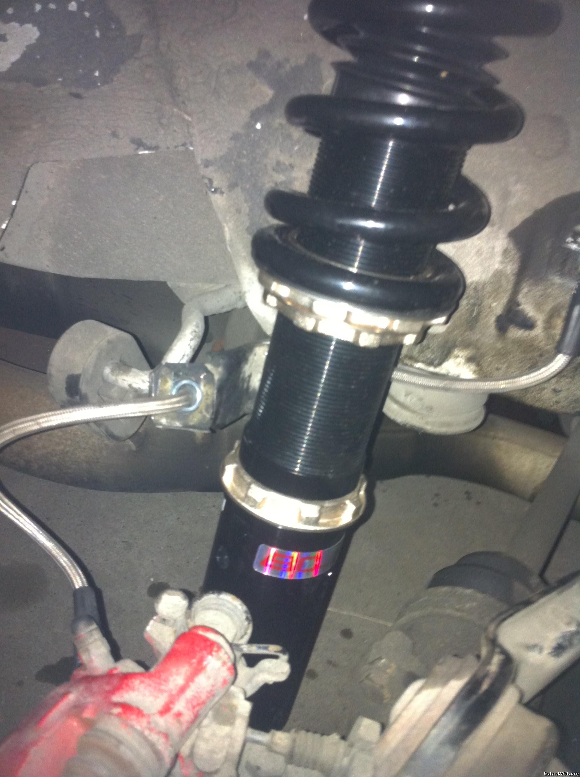

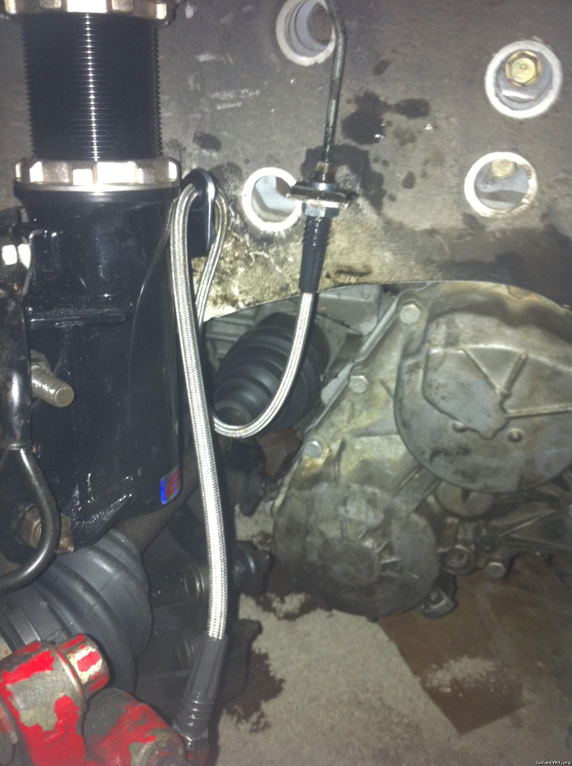

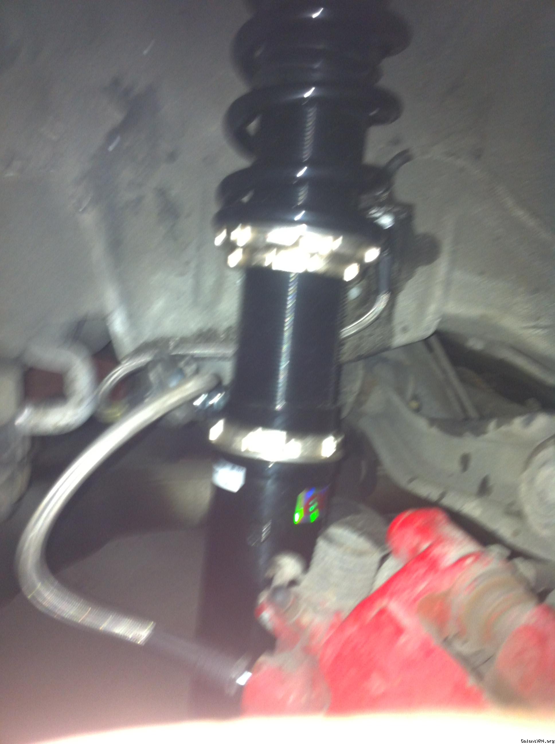

So for everyone wondering, The Coilovers were really straight forward. it took 2 weeks to get them and it was a bolt on affair. The Only thing I noticed about the rear bracket for the brakelines is that it needed to be flipped towards the back and installing my Evo Suspension SS Lines from Garfield made it easy to route and bolt on. I did have to bend the stock bracket slightly(when i say slightly, it was a very tiny bend on the stock bracket , not the coil).
unfortunately I cant take pics of the car on the ground since I have a Clutch Drag Issue thats keeping me from driving it. The car is still JSB so I have no idea how low it is aha. will report back as soon as it is on the floor.
-Shane

They are one piece and fully moveable. once the mounting holes on the brake lines are installed, i can pull the lines to the length i want wherever i need it. Also The fronts come with Camber Plates so no need for camber bolts.

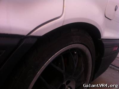

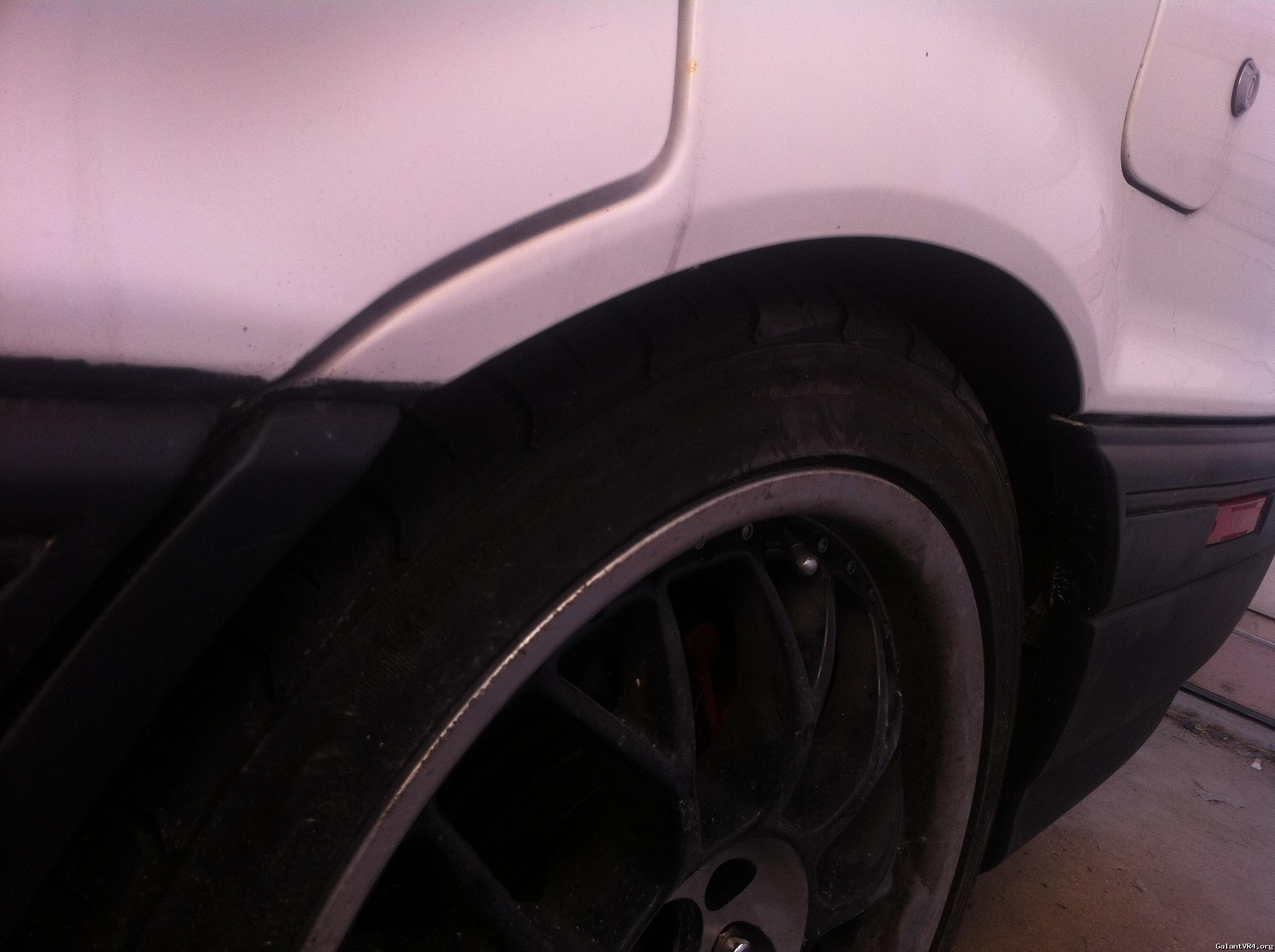

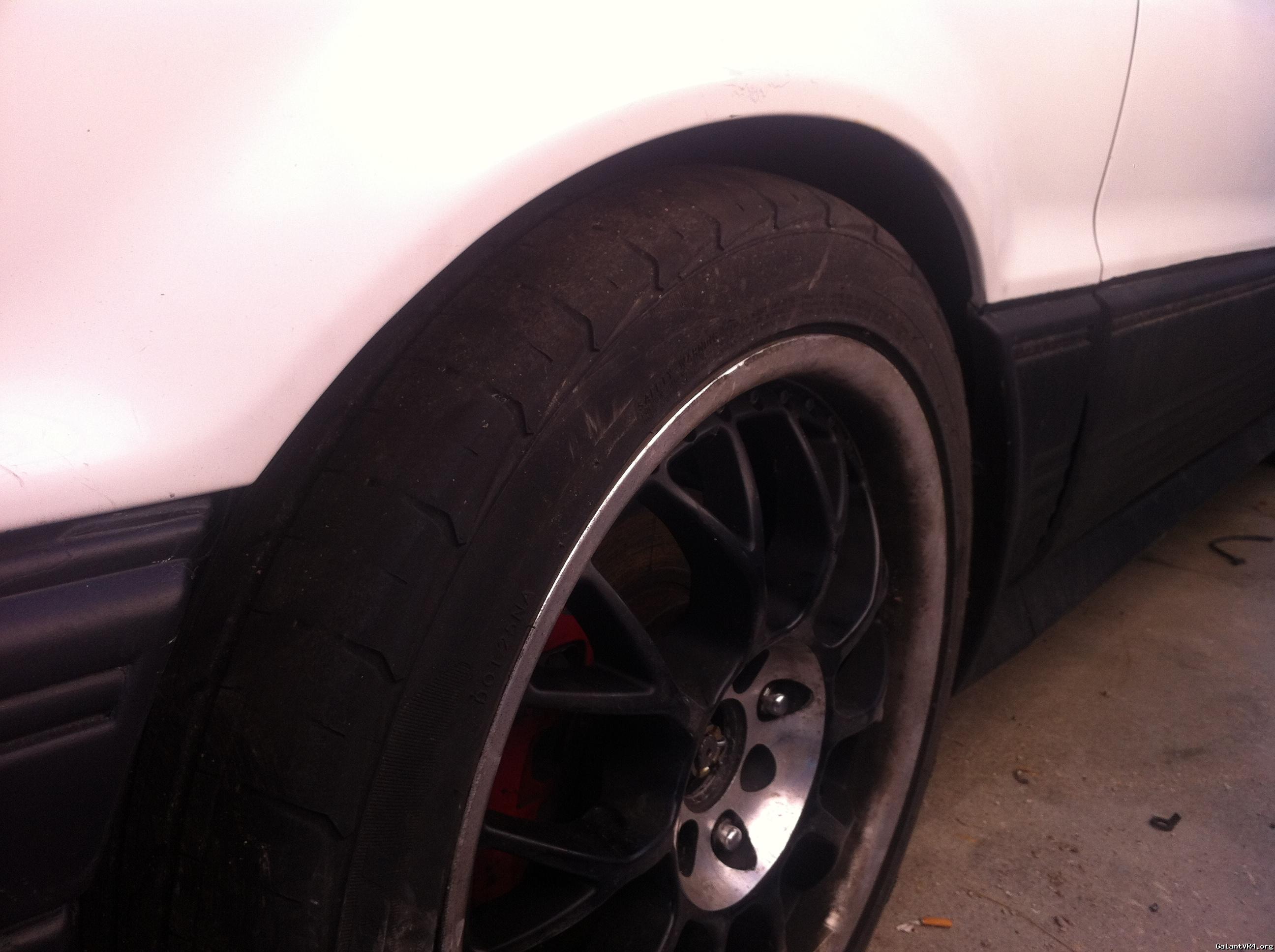

just got done installing mine yesterday and finish with alignment today... here is how she sits... had to mildly roll the front fenders... but im pretty happy with them... just gotta play with the stiffness now to my liking for daily use... btw dont mind the quarter panel it will be fixed soon...

Holy crap you car looks a lot like mine. (with a little more damage)
I have those turn signals and very dumped. I'm so jealous of your coilovers!
Nice ride!
