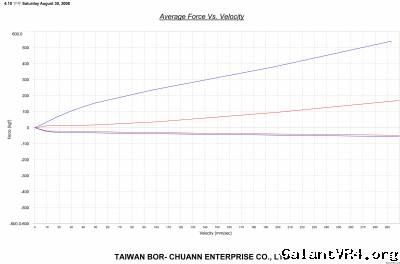

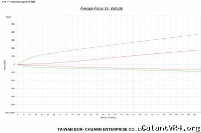

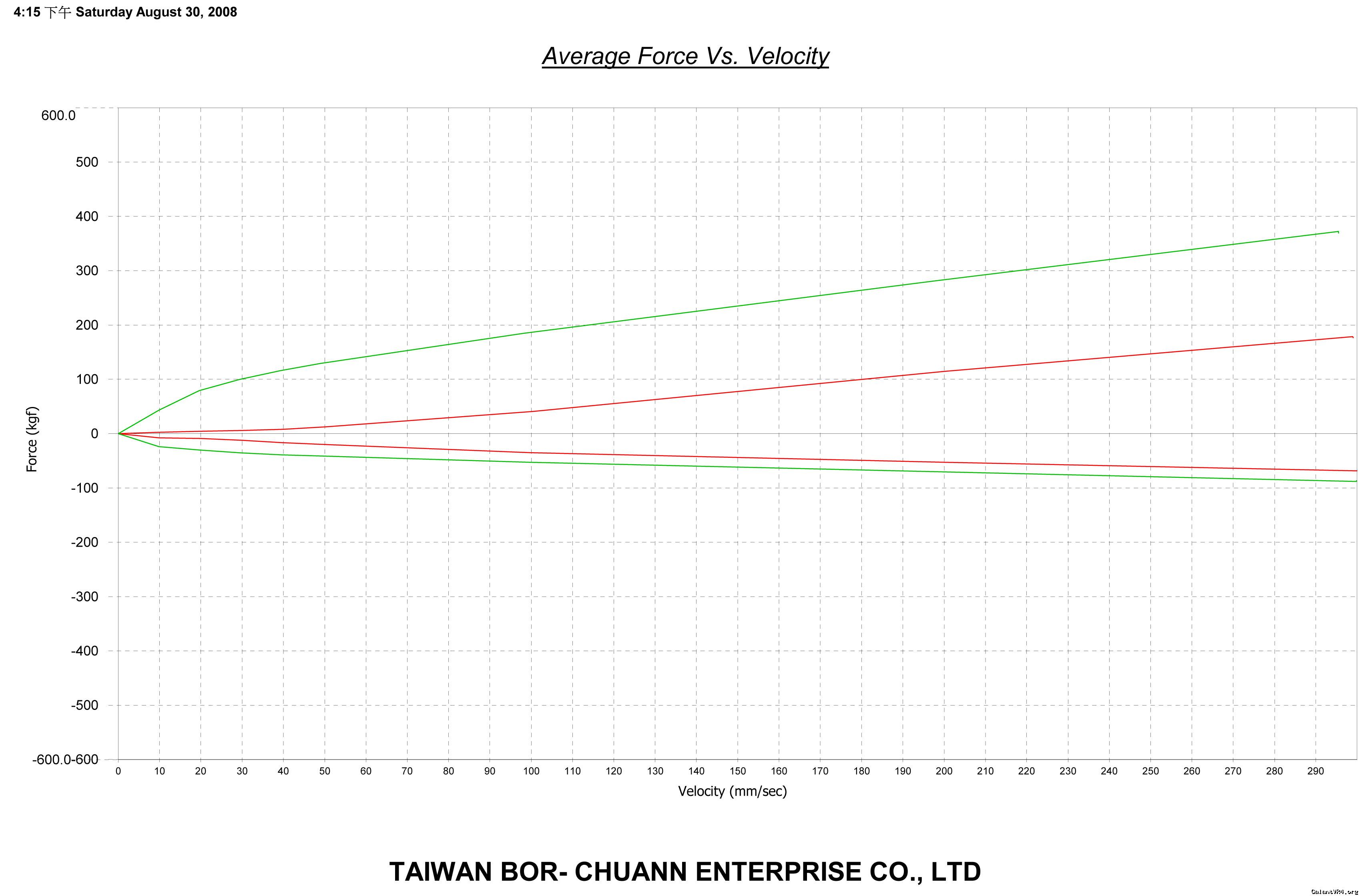

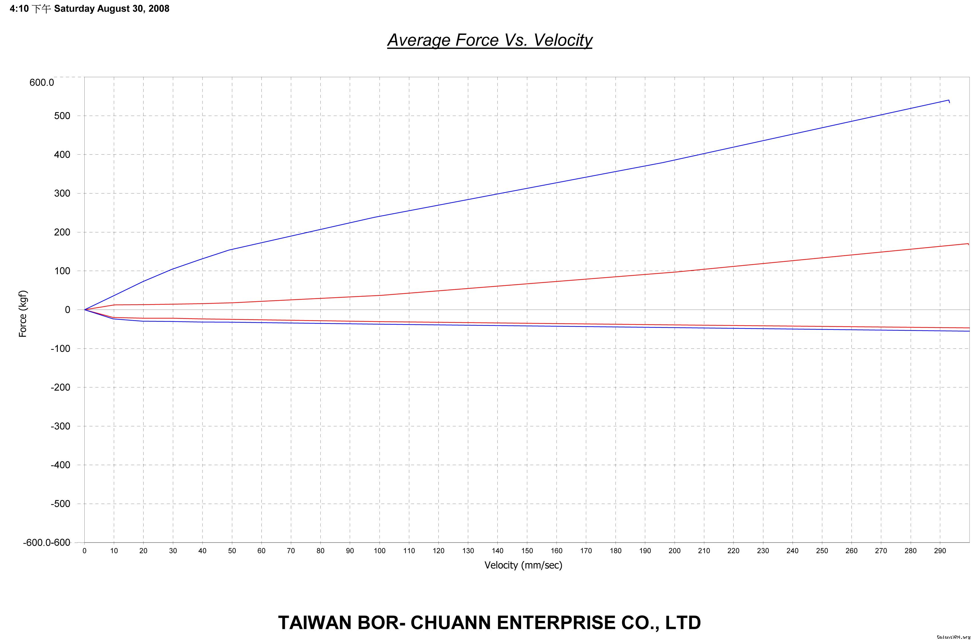

At this point instead of revalving they're just offering replacement shocks for like $75 or something. I tracked down a shock dyno of the more expensive ER series ( click ) and it was pretty impressive. That doesn't tell us about the BR but it does imply that the company at least knows how to make a good product.

Hm... am I seeing this correctly that these are only rebound adjustable? BC says on their website that it's rebound and damping together...
Alright, so... These look like crap to me. Though it's a bit hard to tell since half of a PVP plot isn't really telling me much. I'm no shock expert, far from it, but even I can see these are pretty cheap in the valving.
The adjustability is only in the positive range? So its only compression adjustable with a bit of cross talk in the rebound. Either the chart is wrong or that alone makes this thing worthless. Next, its almost purely a linear shock. That will lead to rough rides and is similar to almost everything else coming out of Japan. So either its going to be under damped at low speed or kidney jarring at high speed (were talking jounce here, not vehicle speed /ubbthreads/images/graemlins/wink.gif). Anyone else ridden on K-sports then jumped into an evo on Ohlins or similar with same wheel rates. The evo feels like a caddy in comparison. The "knee" on this is far to low and according to this graph only shows up at the end of the compression adjustment range.
Total rebound force is looking pretty soft, yet the max compression is huge. It's quite un-balanced IMO. I would want about double the rebound and half the compression (or just leave it on the low setting).
Not to be completely negative but I really cant see anything "quality" in those plots.
The adjustability is only in the positive range? So its only compression adjustable with a bit of cross talk in the rebound. Either the chart is wrong or that alone makes this thing worthless. Next, its almost purely a linear shock. That will lead to rough rides and is similar to almost everything else coming out of Japan. So either its going to be under damped at low speed or kidney jarring at high speed (were talking jounce here, not vehicle speed ). Anyone else ridden on K-sports then jumped into an evo on Ohlins or similar with same wheel rates. The evo feels like a caddy in comparison. The "knee" on this is far to low and according to this graph only shows up at the end of the compression adjustment range.
Thank you Dallas /ubbthreads/images/graemlins/wink.gif. Looks like its back to the AMR coilovers /ubbthreads/images/graemlins/smile.gif
