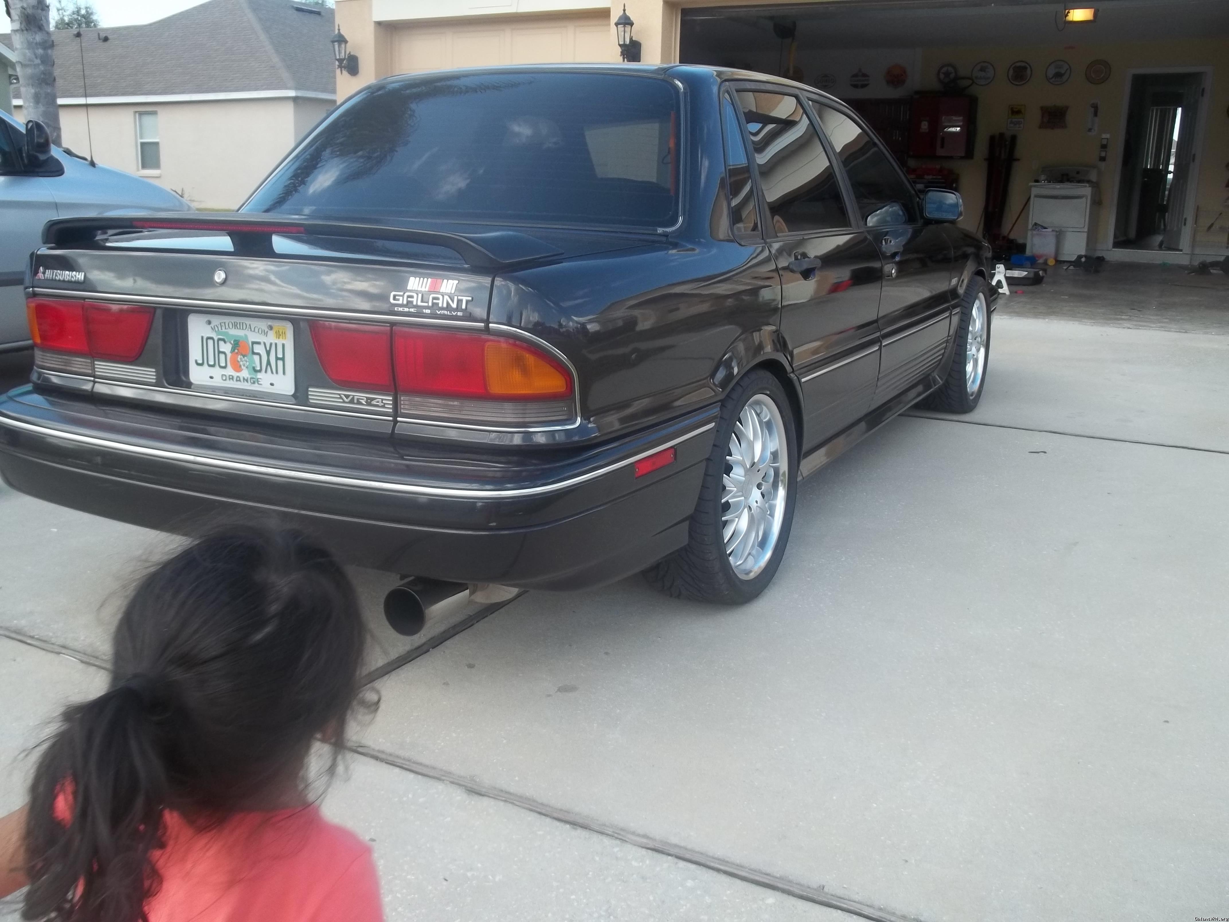

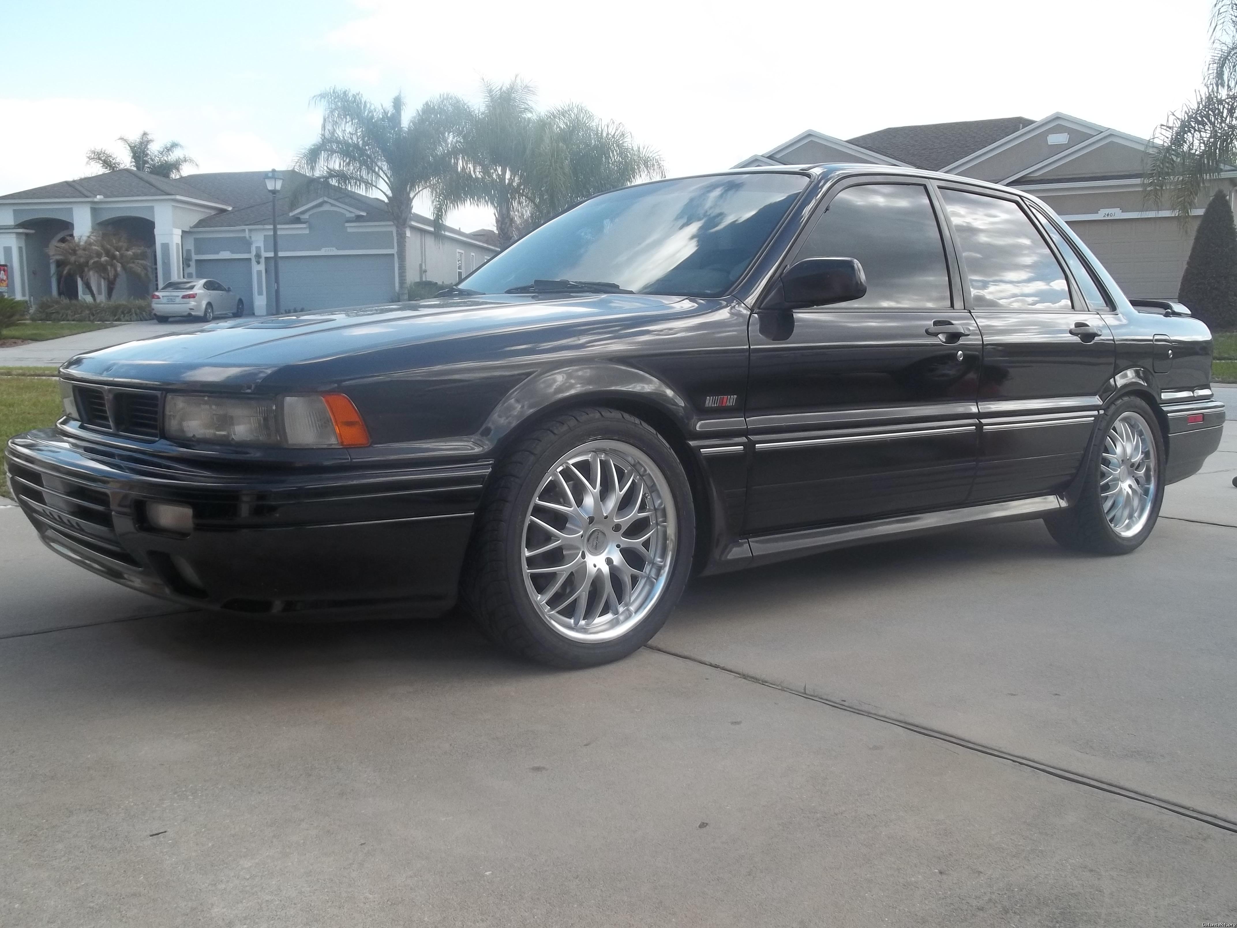

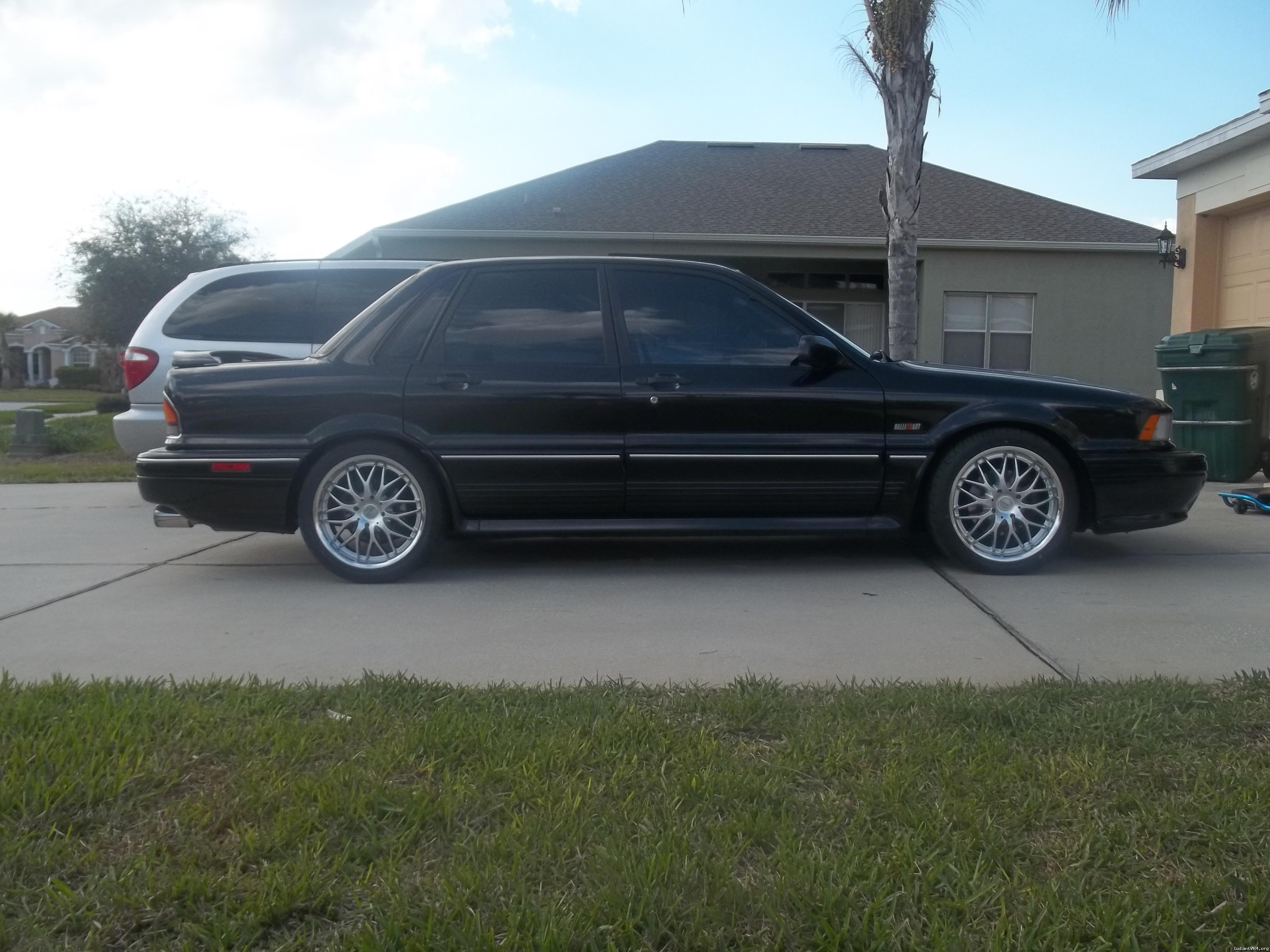

Installed coilovers and new wheels and tires today car now rides firm, not harsh at all . I will beat on it tomorrow and see how it performs
Hey DMJ, what size are your wheels and is that the 2" inch drop that comes with the coilovers or did you lower it more?
Also, do these come with rear camber plates?

Wheels are 17 x 7.5 35 mm offset. 67.1 centerbore with 235/40/ 17 tires. The drop is the standard with the coilovers except for the right rear which I had to lower about 1/4 in to even out the ride height. No adjustable camber plates for the rears.
