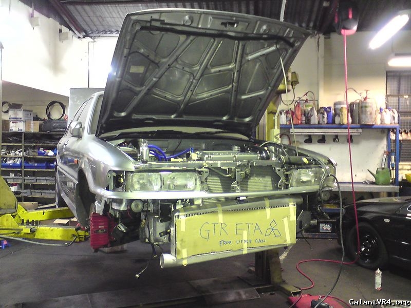

I've got a few new bits.
They include:

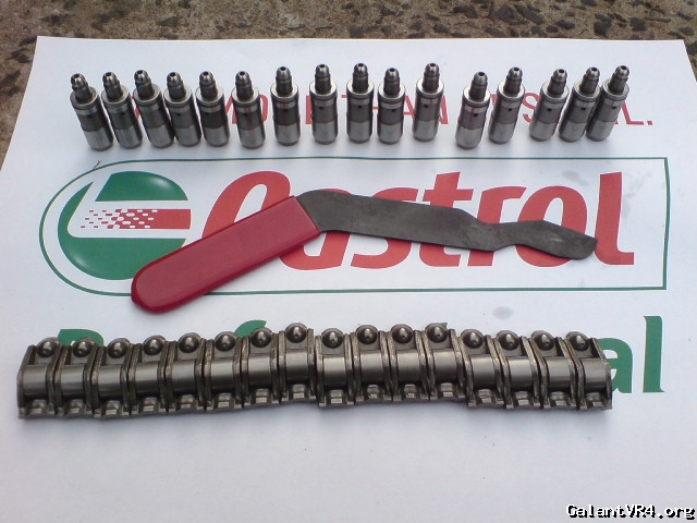

NEW mitsu rocker arms (not sure what specific year but they were from RALLIART)

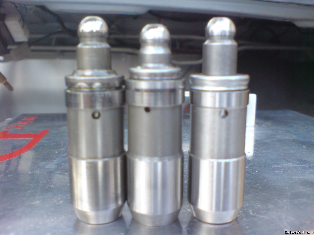

NEW lifters (precision branded ones, they have the same hole size as the 3G stuff but are slightly taller)
NEW ralliart badge
NEW supervr4 badges
NEW innovate LC-1 wideband o2 sensor which I have wired into the AUTRONIC (works perfectly)
NEW knock link knock sensor

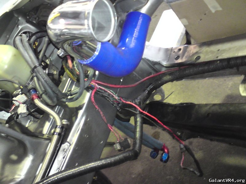

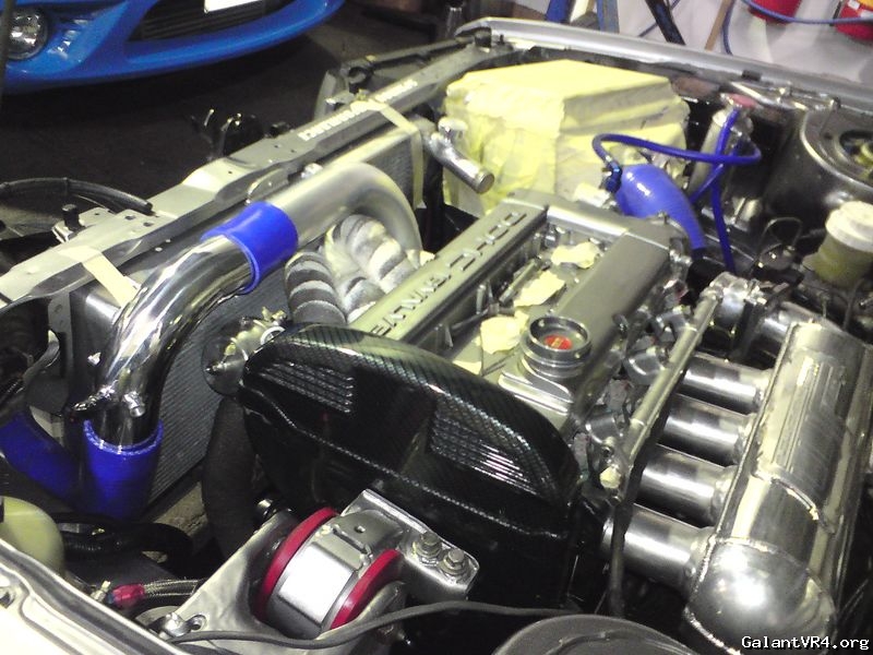

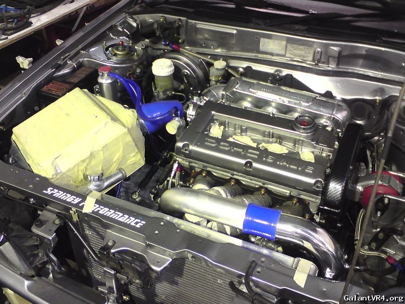

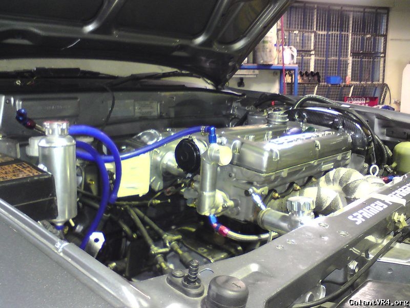

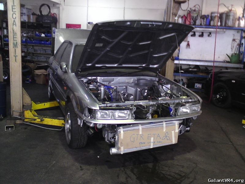

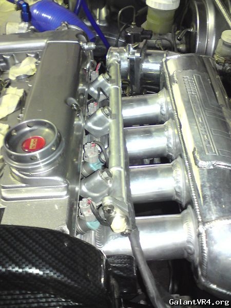

It's slowly getting there. Enjoy the pictures

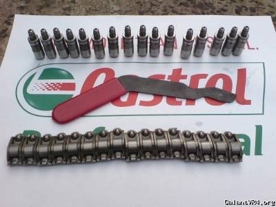

Lifters x16 / Rockers x16 / Lifter tool

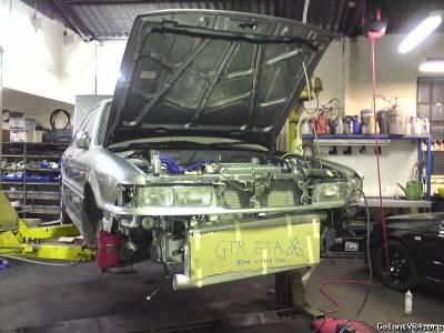

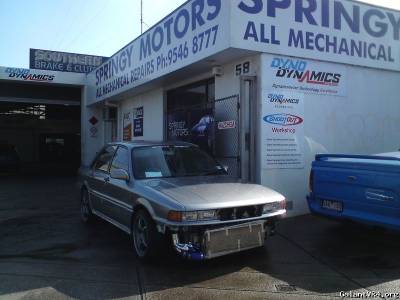

The VR4 and the AMG

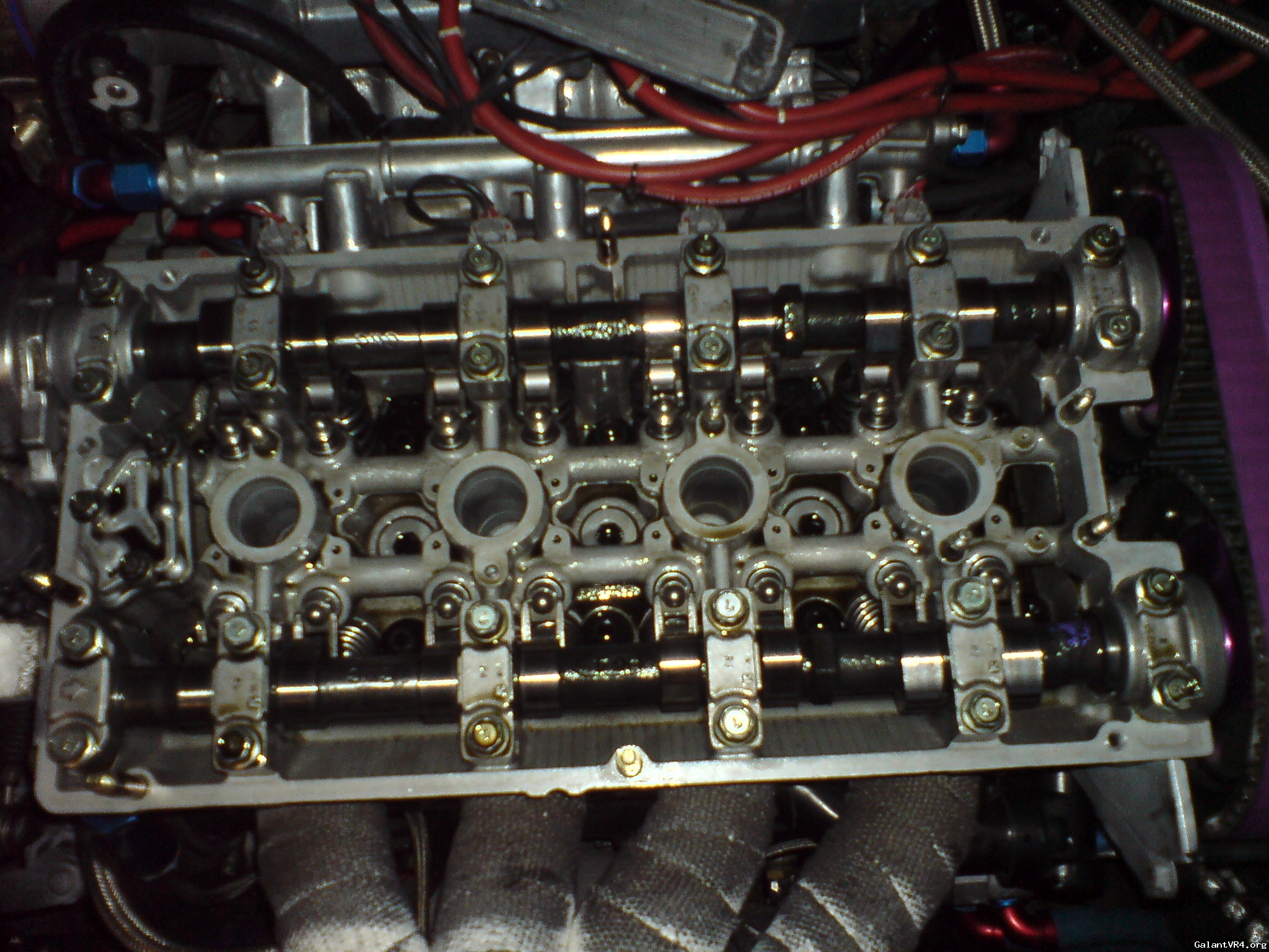

All the new bits in the head (30 mins to change with the new tool)

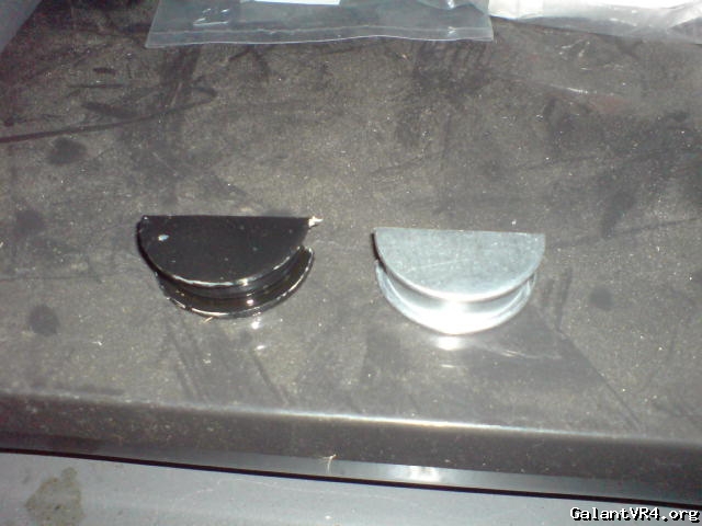

Alloy 1/2 moon seal

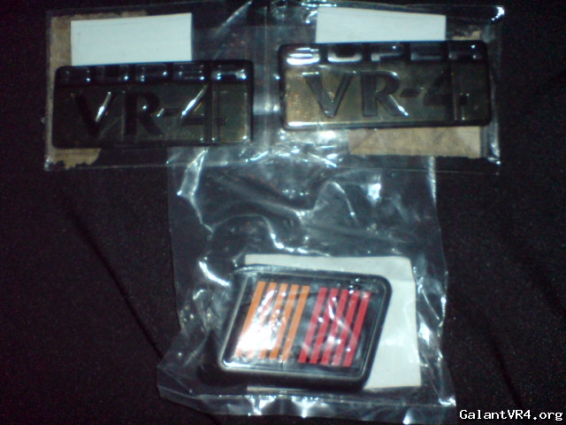

Super VR4 badge and ralliart badge

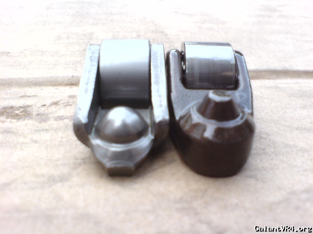

New ralliart supplied rocker arm vs Original rocker arm
1G lifters (small hole) VS topline 3G lifter VS precision replacement lifter

That's a nice build. Lots of nice parts and good fitment.
I have a few questions. How long have you had the exhaust wrap on there? How well does the metal underneath hold up? In my experience it has accelerated the rusting of the metal you cover.
Did you use steel or aluminum for the rear/boot firewall? Aluminum might be a bad idea, for worst case reasons. God forbid, but if you had a fire back there, the aluminum would give off some noxious fumes.
bazeng
Feb 6, 2003
2,520
Melbourne, Australia
Quoting CarRacer:
The exhaust wrap has been there for about 6 months now.
The metal below has been ceramic coated, so that rust look has not yet taken affect..
I know what you mean though, I've seen many cars with that wrap killing the finish of the manifolds.
The manifold I have has a lifetime warranty and is made in AUSTRALIA, so if I do have any problems I will send it back. The guy who made it informed me that if it is coated, it should be ok to wrap.
The black graphite (black colour in the wrap) has faded since running the car. It is now pretty much white!.
I used alloy for the boot firewall. Priority for that firewall was to keep the smell/fumes out of the cabin. The fuel setup I have tends to let the fuel smell out. I can tell you that it is doing its job!, not so much smell (about 90% has gone). My next step is to wire up an electric 12v fan to the boot and wire it up to some small solar panel just to constantly vent the fumes out of the car.

11,992
I'm confused. Are you going to run both an air/air and an air/water intercooler? Isn't that big box an air/water intercooler?
bazeng
Feb 6, 2003
2,520
Some testing has shown about -50 at idle and under zero by the end of the track...
Massive power adder, not peak power adder but in regards to spooling and low to mid range increase...
