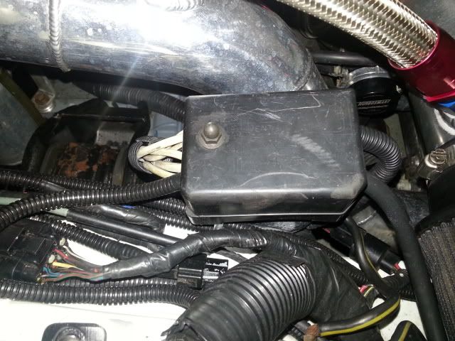

I'll put up a pic in here of the front half. I'm using a gold plated ( /ubbthreads/images/graemlins/ooo.gif ) distribution block. I'm also using a stock DSM A/C Fuse box lid to cover the whole thing. No one realizes it's there. lol

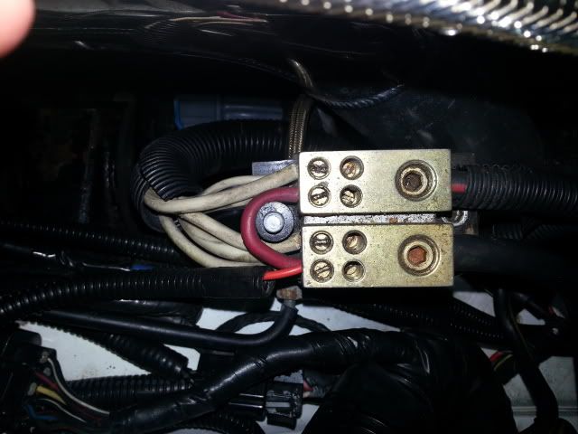

here you go shane
start at the far left, that is where the battery cable is and the started cable
then the lower two are positive and the upper two are negative.

Here's one with the cover on. The other 3 pics are being stupid in Photobucket. I'll add them when they work correctly.

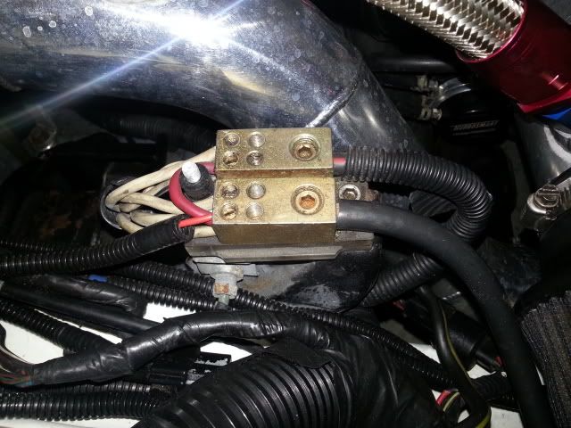

Finally! /ubbthreads/images/graemlins/banghead.gif Let me know if you need anything else. It's bolted down to the bracket where the hydraulic clutch line goes through. These are all hot wires. Large one goes from the battery. 1/0 gauge I think. Black/Red goes to the starter. Whites go to the fuse box. Small red goes to my Meth pump/solenoid.

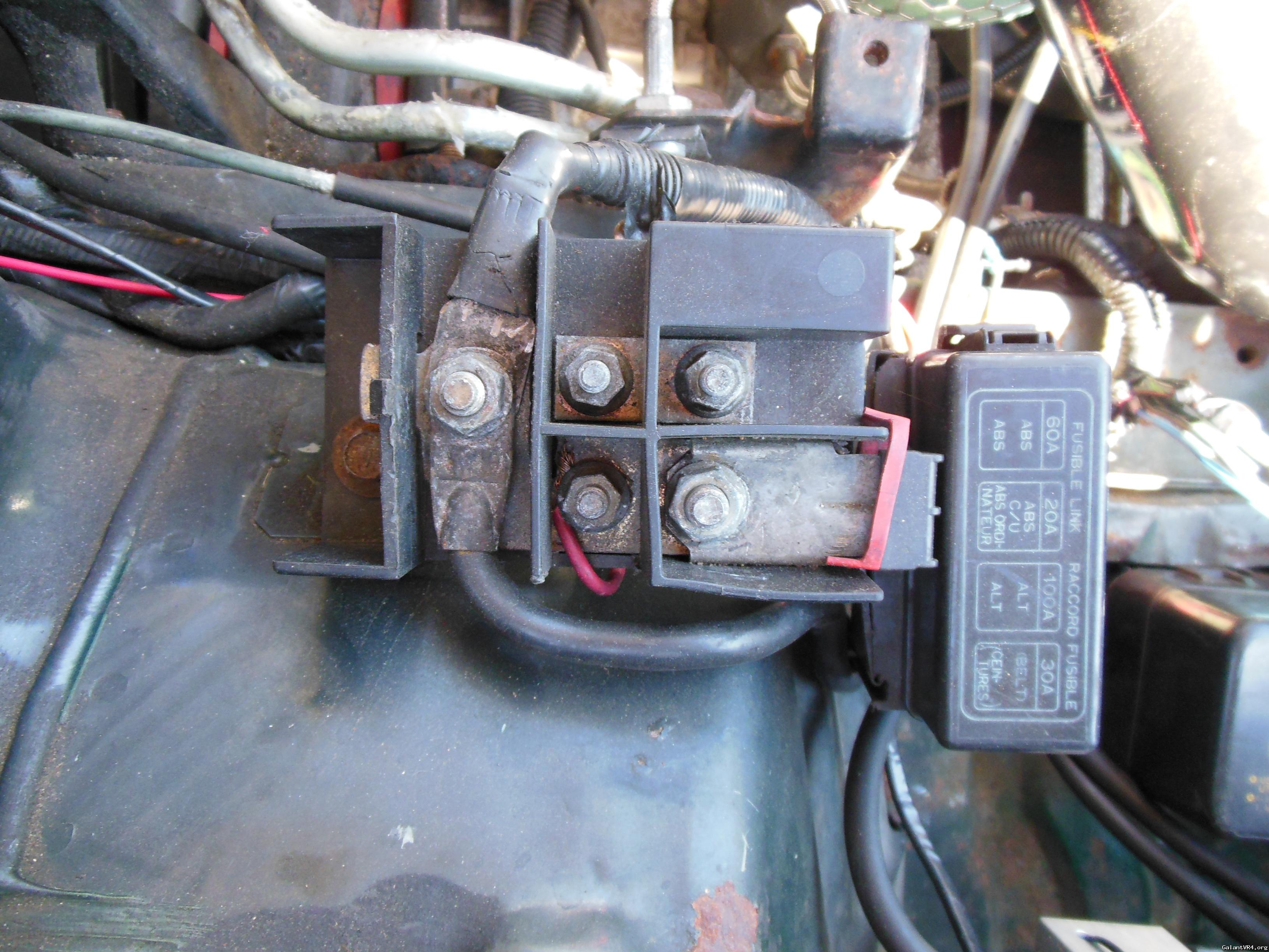

this is kinda what i have.
edit- with mine i broke the metal piece off the top, drilled a hole in the top for mounting and cut the tabs off, mounted it flat and it works great for me.
