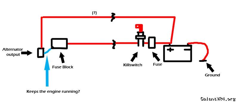

So I am trying to understand how to wire up my battery relocation so that the engine will cut properly when the killswitch is thrown. I have been reading, but I am confused on how to wire the alternator so that it won't allow the engine to keep running. I drew up an illustration to show what I am confused about. Basically if I connect the alternator output (or what I think is the output I guess) (blue wire) Won't this allow the engine to continue running off of the alternator? If I run a seperate alternator wire to the battery, won't this cut all power to the engine when the switch is thrown? Maybe I am completely going the wrong direction, but that is why I am asking this question. Thanks for the help.
Why is it that you NEED an electrical shutdown on your ride?
to answer some of your question...yes you would need to cut power coming from both the battery AND from the Alternator to fully/electrically shutdown your engine
are you not worried about headlights or anything else loosing power? or is this a drag vehicle?

Disconnect that blue line from the alternator output and loop it over to the positive starter wire in the fuse block to complete the circuit. Problem solved. That's how mine has been since '03.

Okay, so I need to cut the 2 white alternator wires from this connection and connect it to a new line and run it back to the killswitch?

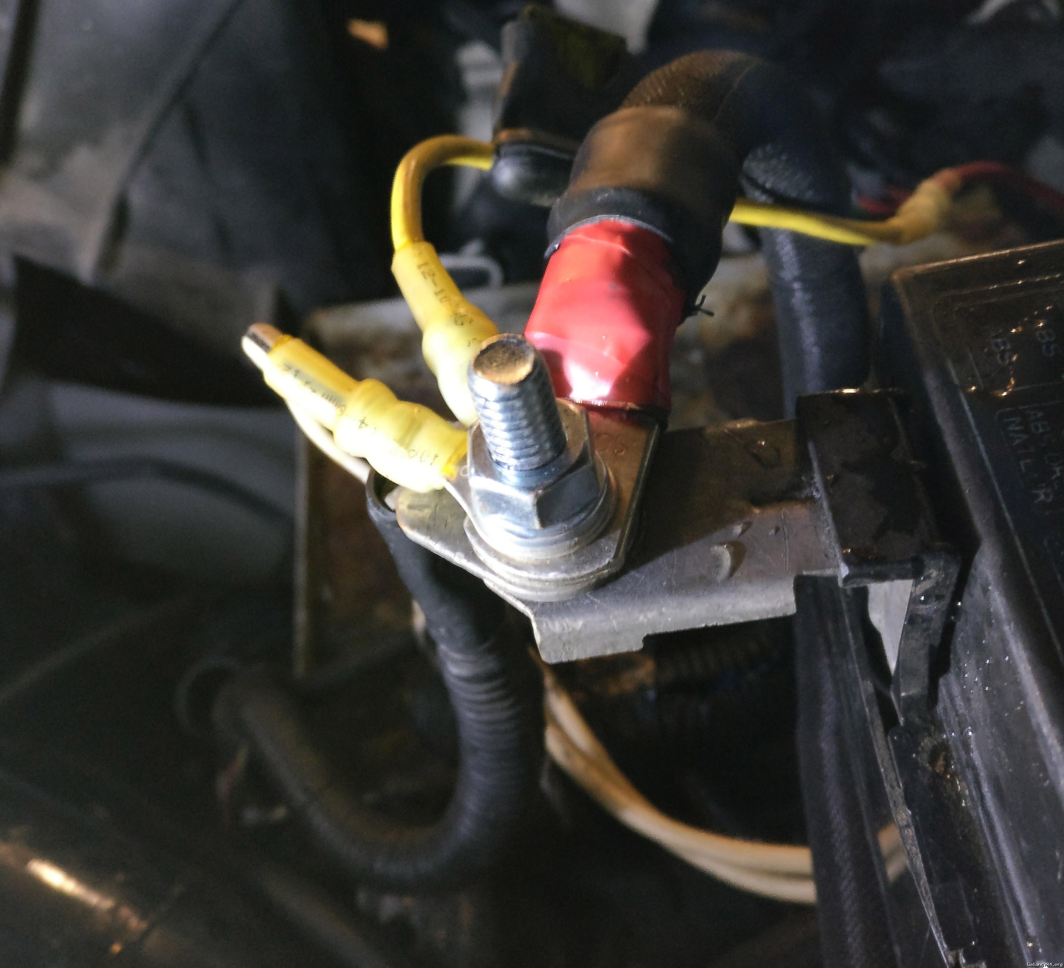

Raising this gem from the dead, because in my searching I found it and used it now that I was finally getting around to this.
Just wanted to get a sanity check:
Below I have my + Battery Feed (large gauge wire), Starter Wire (Black), a yellow accessory wire, and the single white/black alternator wire (removed from the old alternator fuse holder) connected. Below this, you can just make out the 2 alternator output wires that go to a fuse and then back to the + battery terminal. For those with this setup, does this seem correct?
