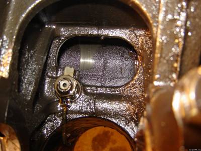

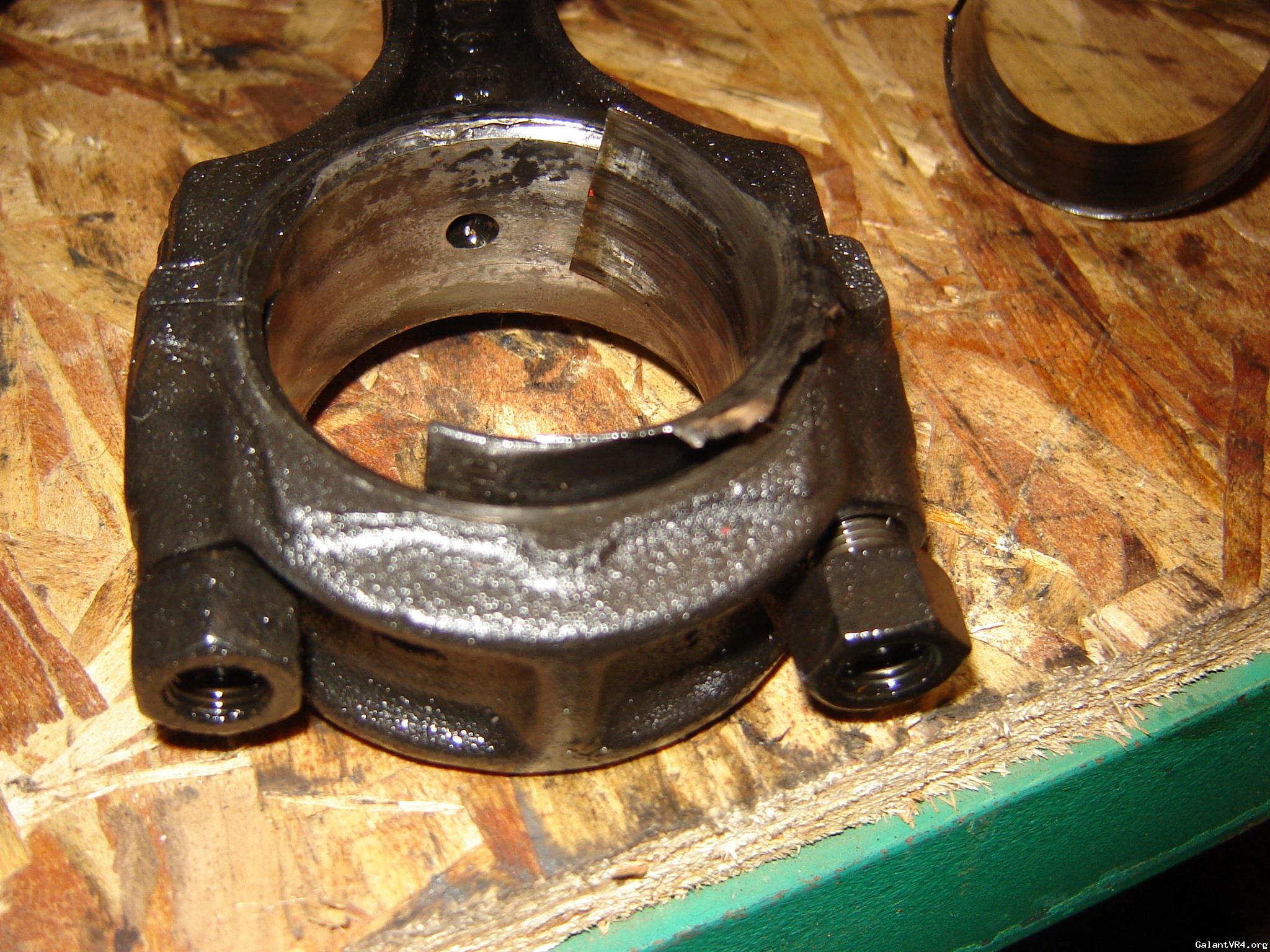

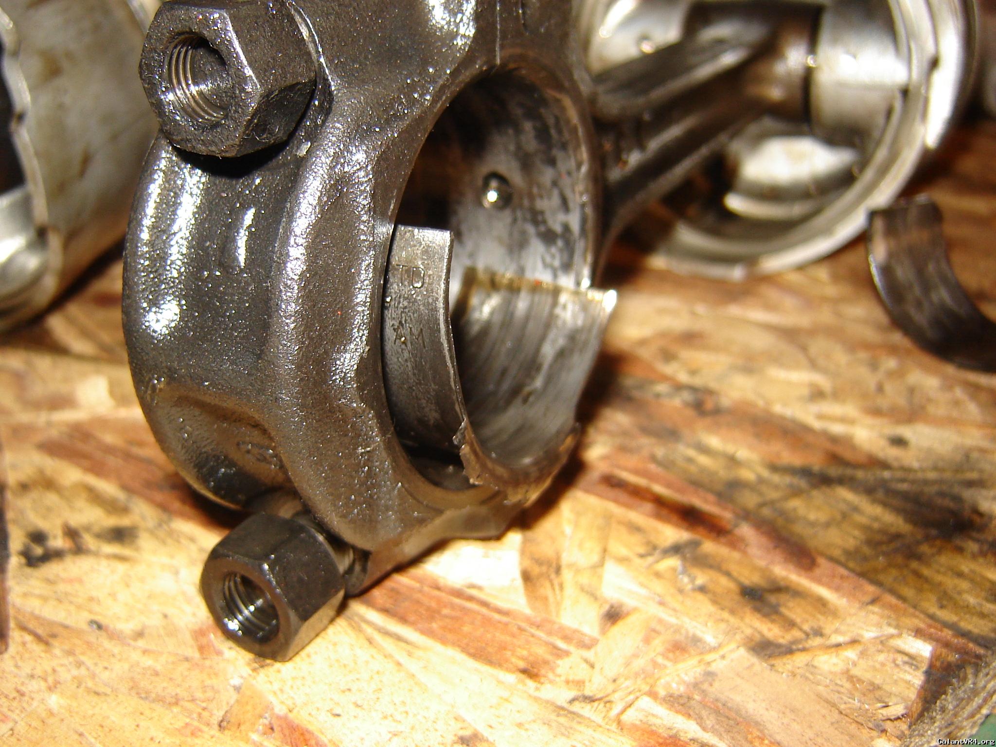

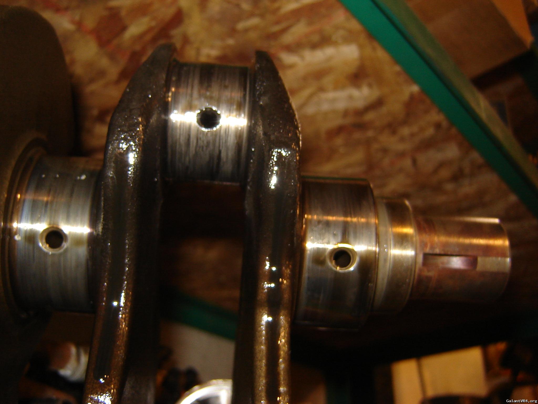

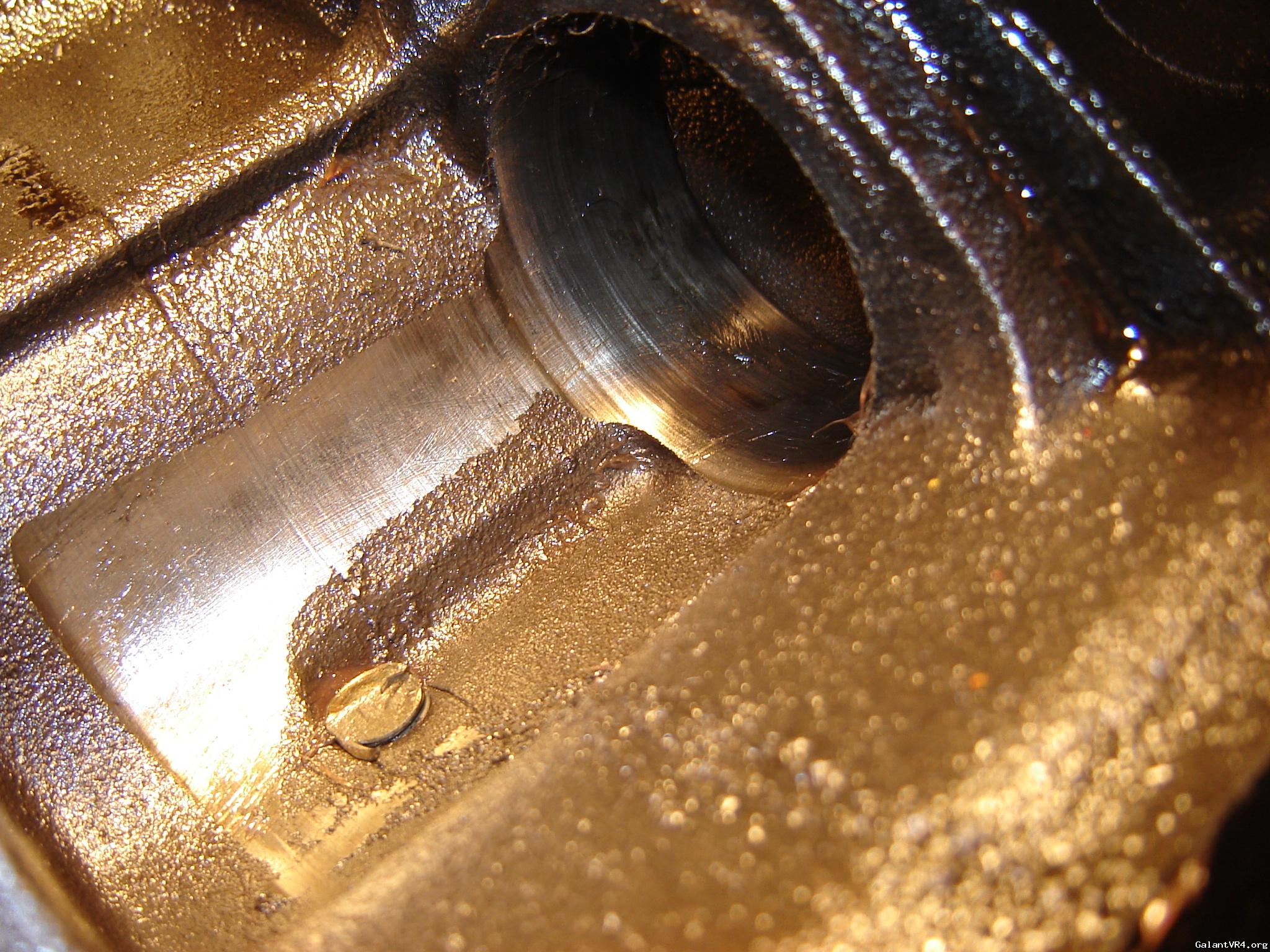

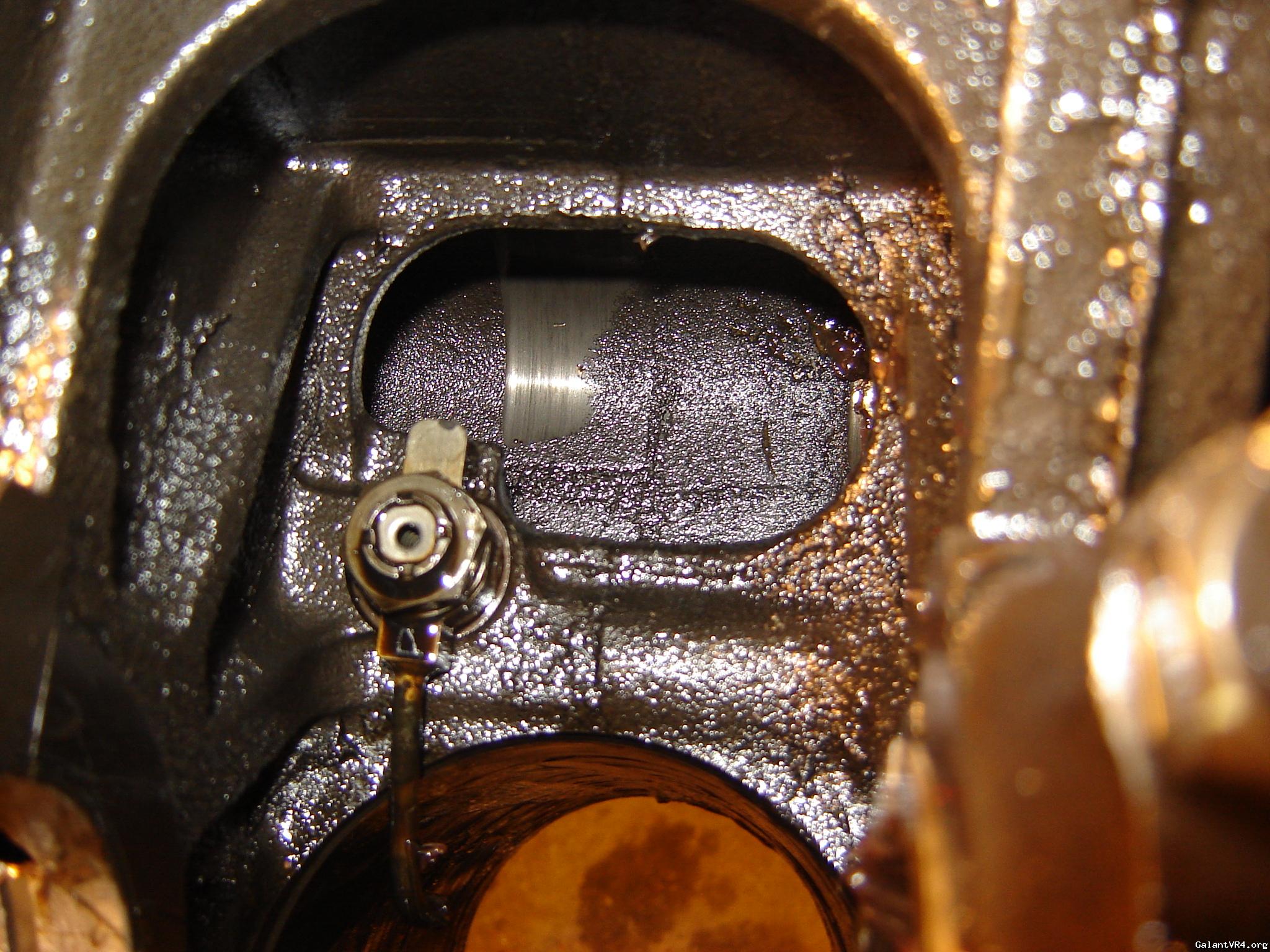

I tore this motor down yesterday and would have to say that it is defenitly one of the worst ones that I have seen. This is definetly the main and best reason to remove balance shafts. Enjoy the carnage.

I've got some pictures like that too, but mine are worse... The bearing was all twisted up in the bottom of the pan, and the lack of oil pressure caused a rod bearing to go. /ubbthreads/images/graemlins/banghead.gif Never had balance shafts in any engine since!
fivestardsm
Sep 8, 2006
1,699
Middle, Michigan

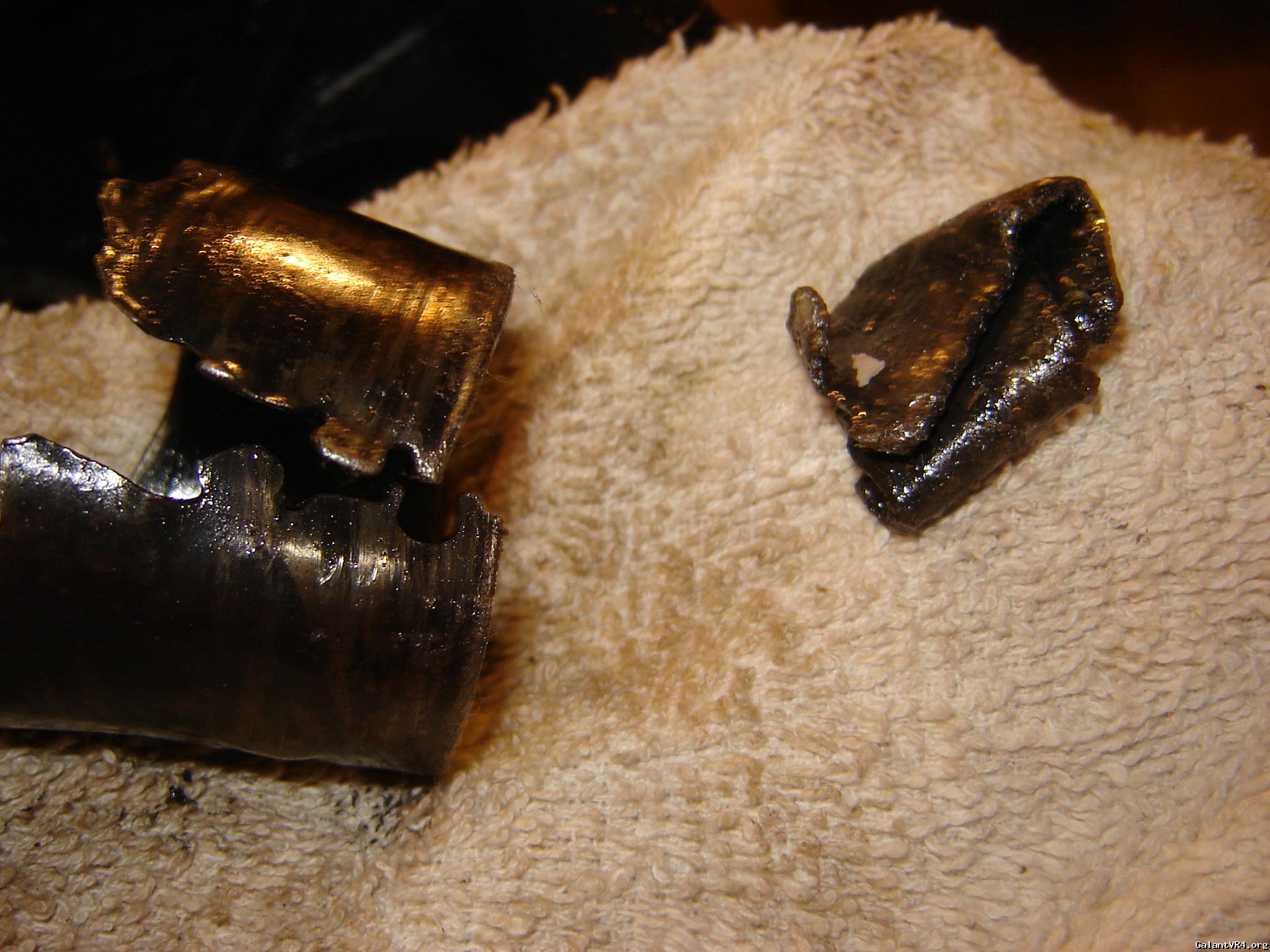

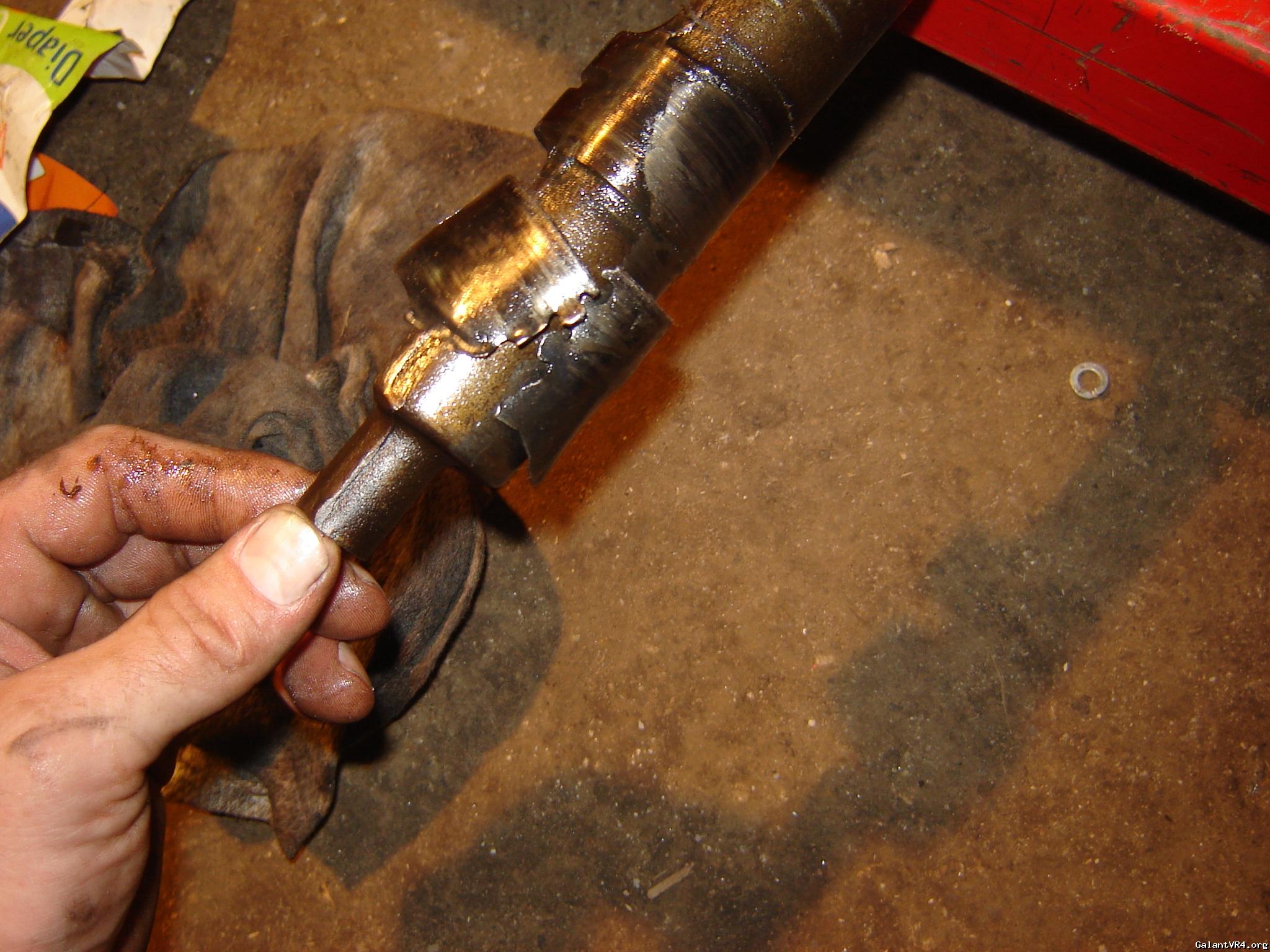

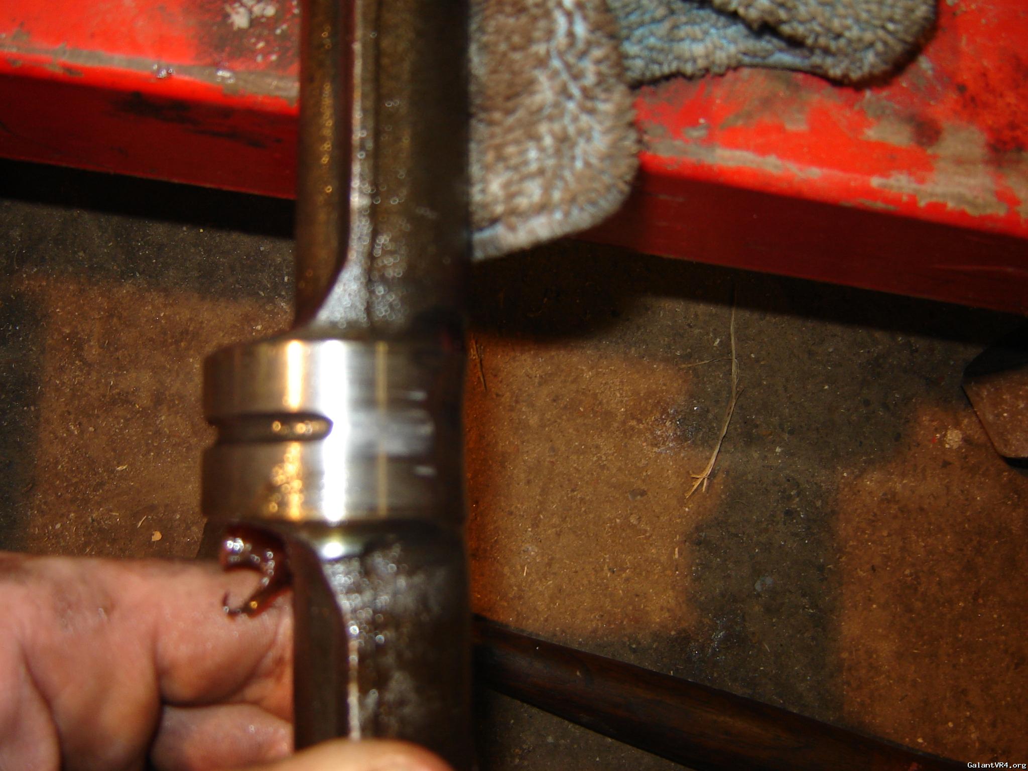

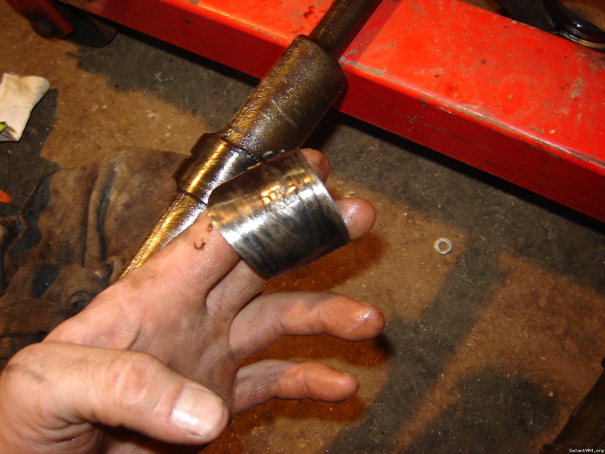

So they looked like these?

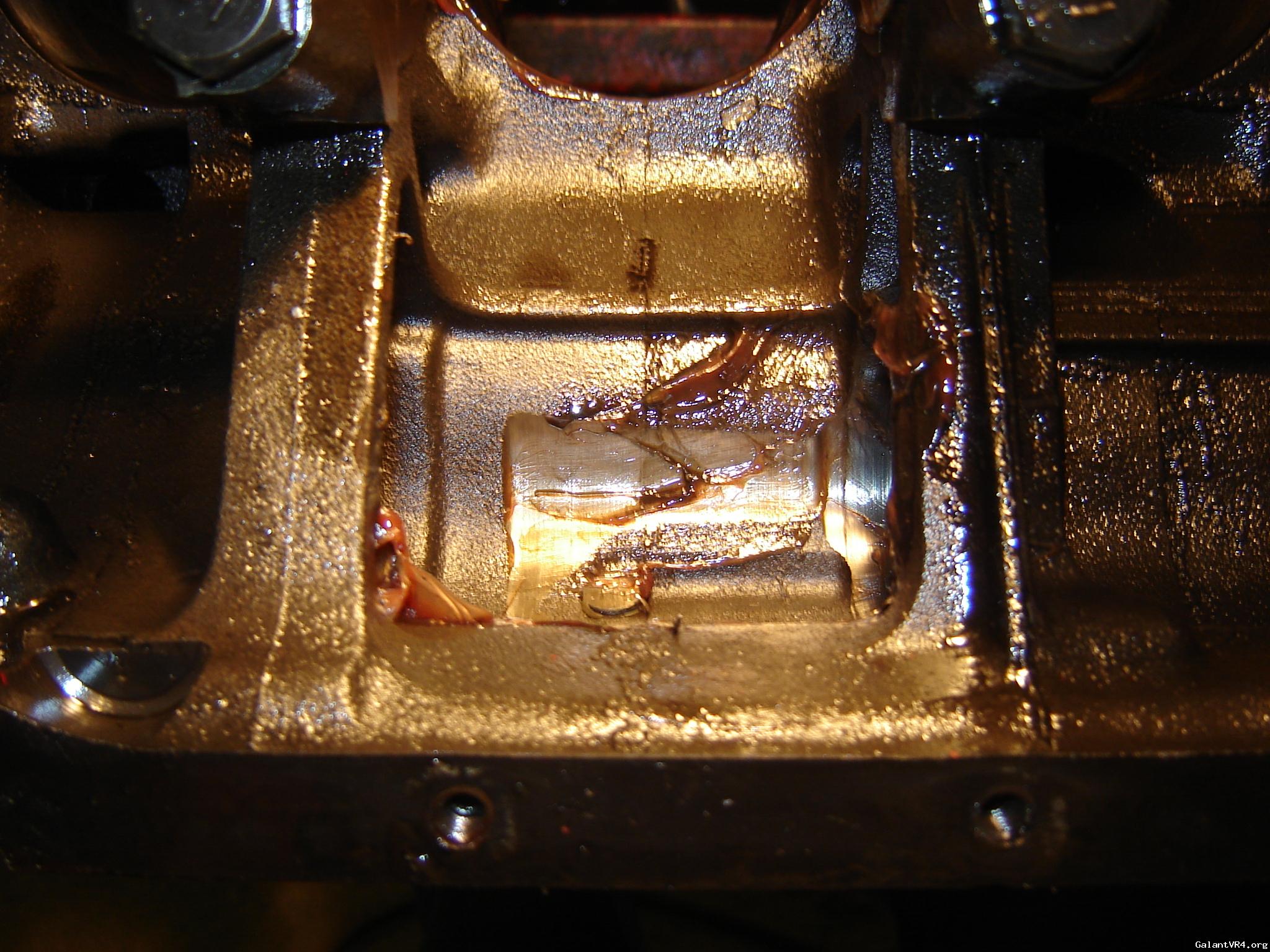

I found the one laying in the bottom of the pan along with one of the bolts that rattled out of the Oil pump. While the other was spinning twirlies on the B.S.

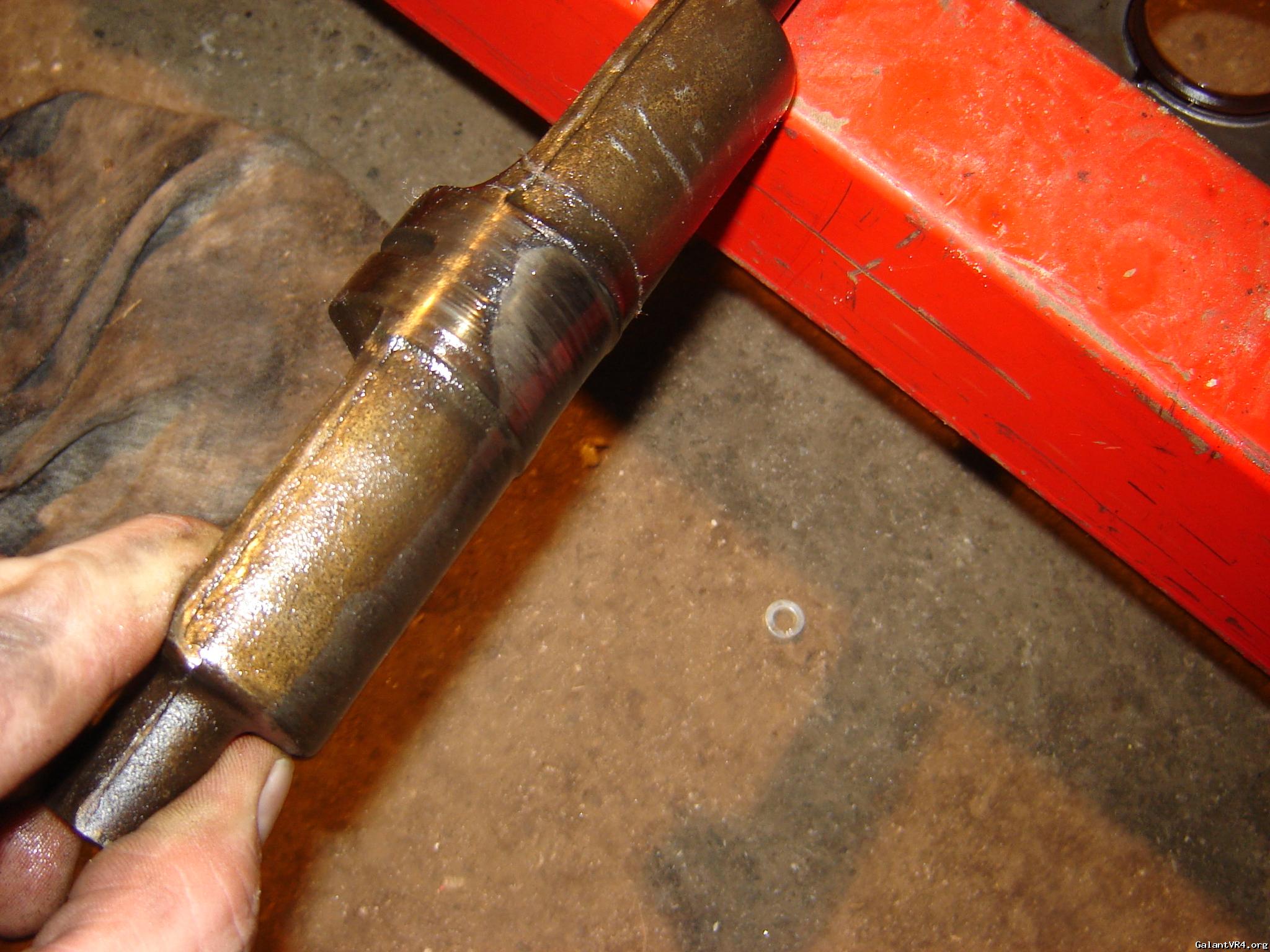

Here is the spun #1 because of the lack of oil since the B.S destroyed the pump.
I have had this same thing happen to me 200 miles after a fresh timing belt
on my old 92 tsi. /ubbthreads/images/graemlins/banghead.gif

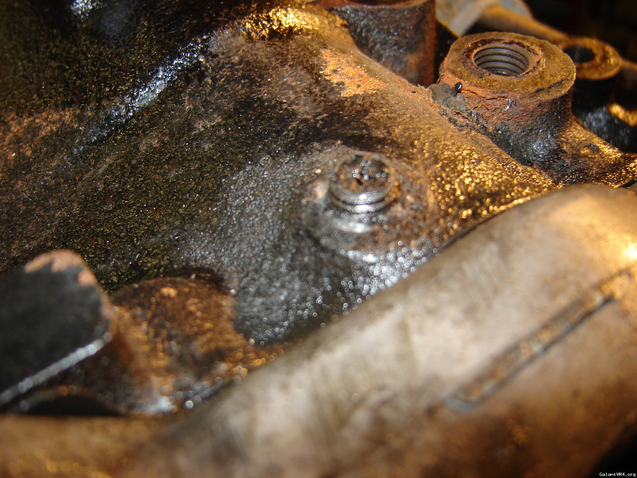

Oh, and coming soon to a forum near you: How to repair a block with destroyed B.S journals.

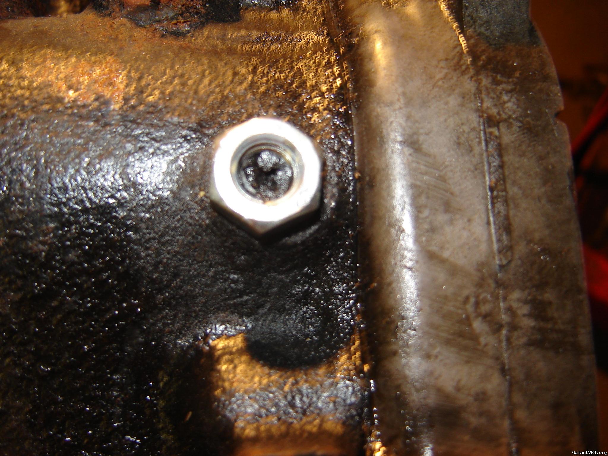

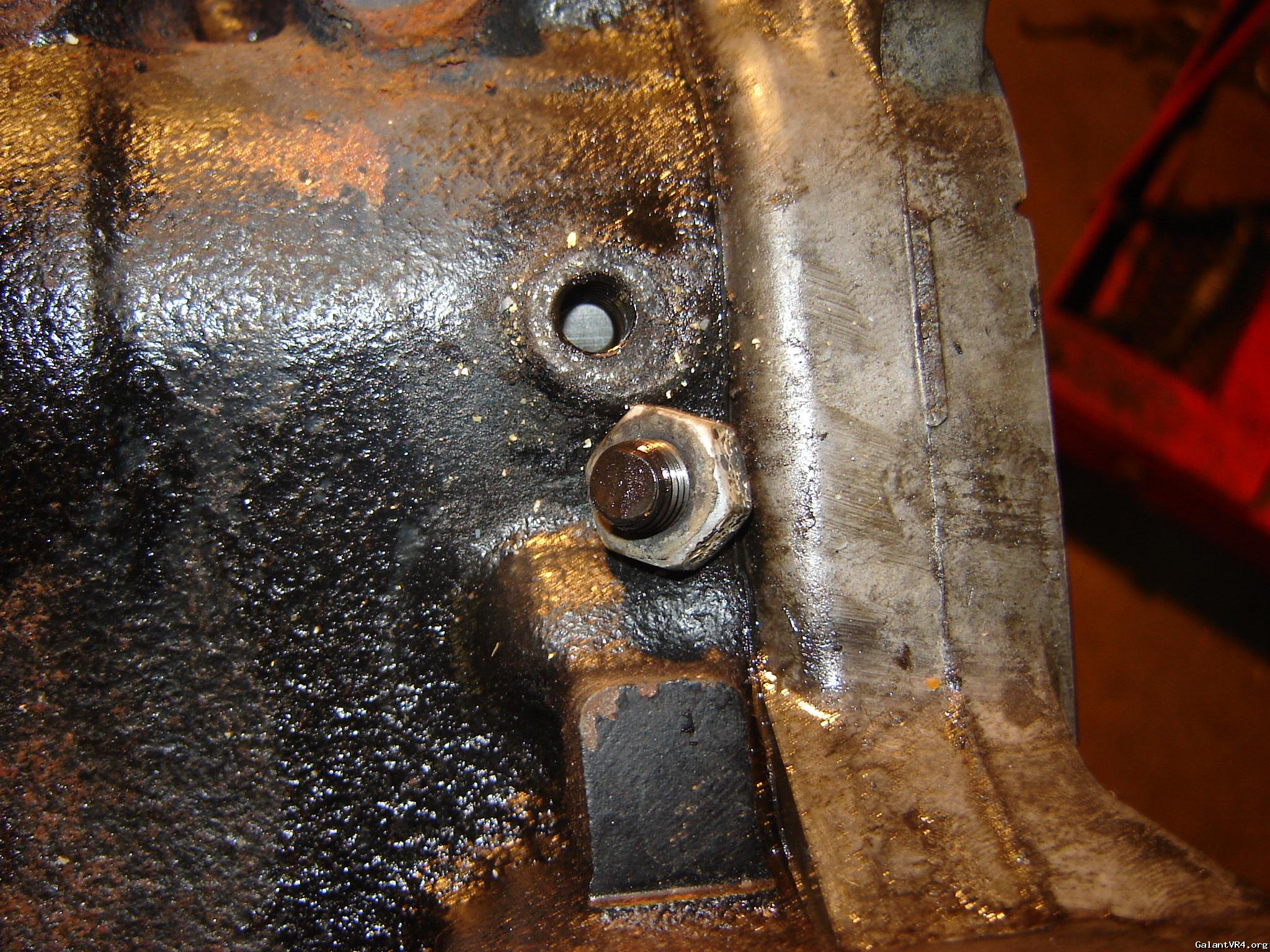

Here is a preview. This is the first step in pluging the oil journals. This step is fairly inportant, but easy. I don't belive that anyone would ever beable to remove the philips head plug with out doing this step.
First, clean the threads with a wire brush:

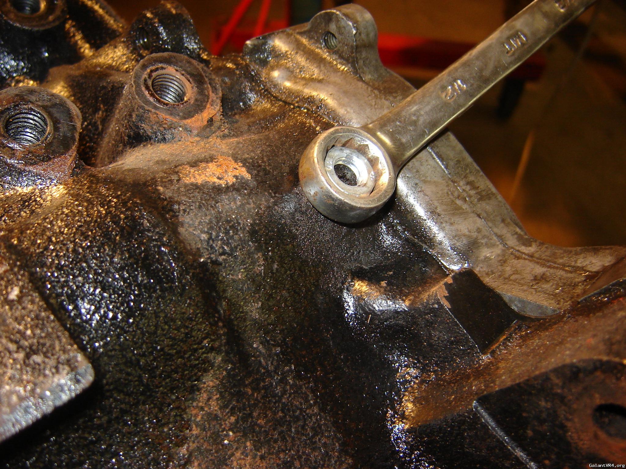

Second, Thread on a 10mm nut (12mm or 13mm size wrench) on to the philips plug:

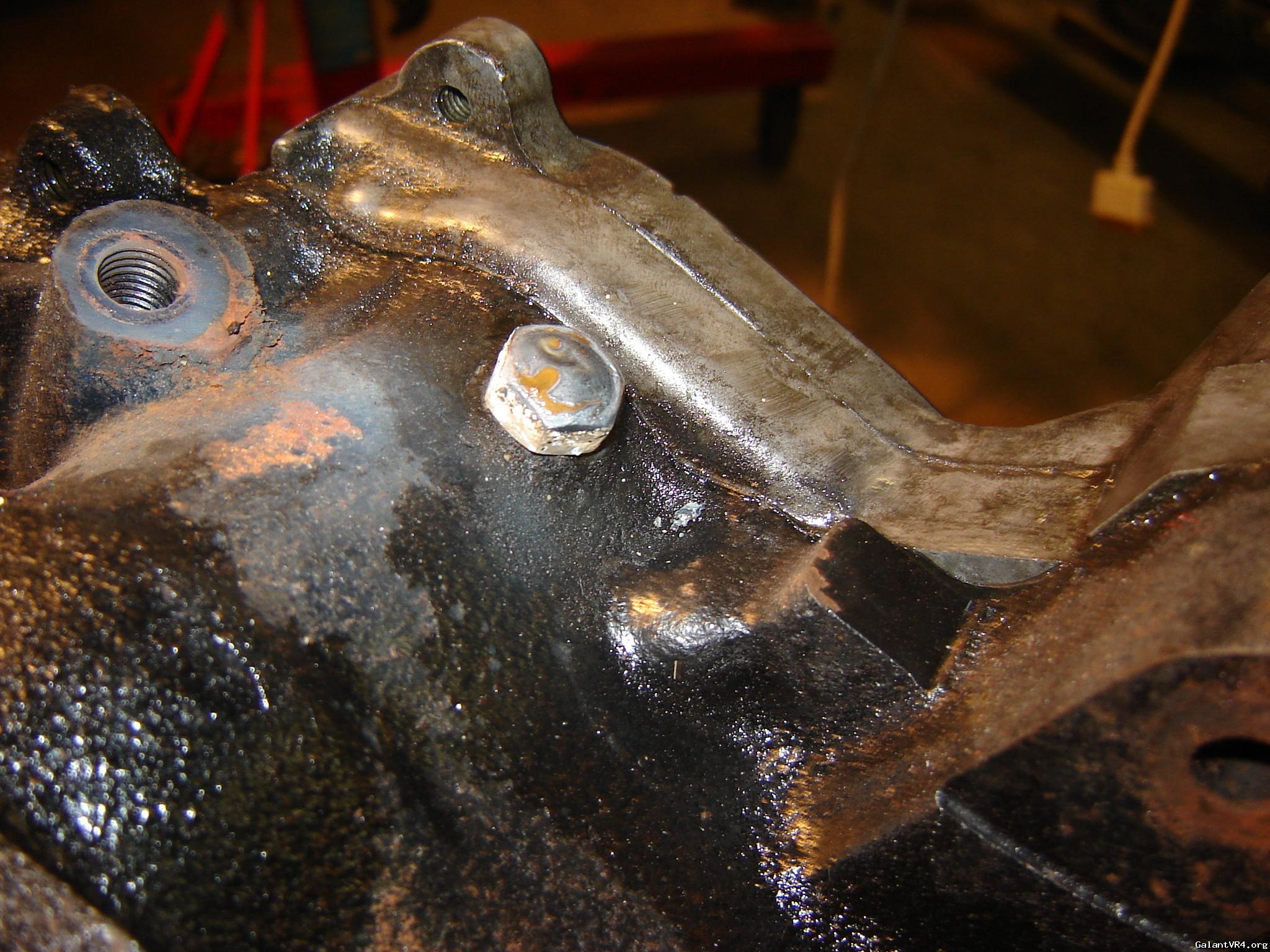

Third, Tighten snug. It will give you roughly half a nut to weld to:
Fourth, Weld the opening in the nut so that the nut and plug are welded together:
Fith, Remove the plug and repeat on the second plug for the inner B.S. bearing:
