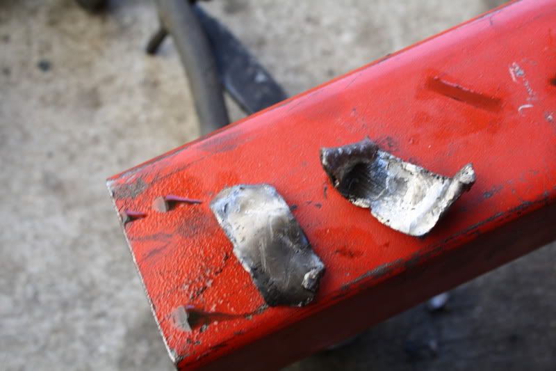

Heres a pic of my b-shaft bearing. Idk what caused it, but this was after a couple runs at the track. Found my balance shaft seized and then snapped the belt.
