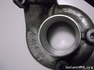

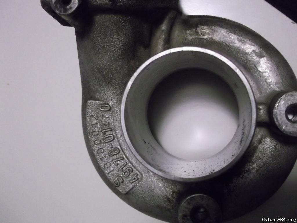

hey guys i was looking at all the ebay 16gs and they dont look like current turbo i would like to if it is a real or fake before i scrap it. my compressor housing looks like this

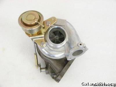

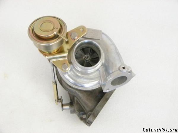

while all the ebays i saw look like this

I will only say this because it's a possibility. The area grinded off looks too big to be TDO5H. You may actually have a Taiwanese turbo called the EVO3 GT. They have the 470 serial number almost directly copied from an MHI unit, but instead of the TDO5H, it has EVO3 GT. That's why they might have ground it off. To fool someone into thinking its an MHI unit. Just food for thought.
