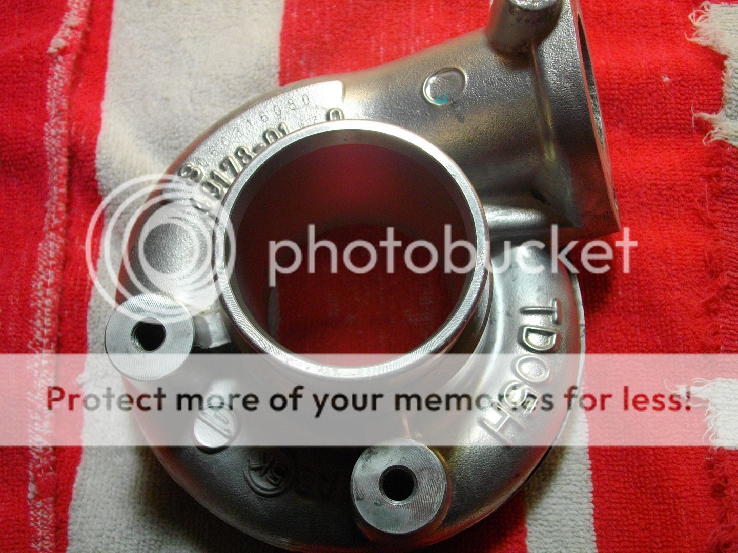

^^ this guy is onto something..
The genuine MHI compressor housings also have other marks between the two wastegate actuator mounts as seen here:
The aftermarket copies don't, as seen here:
