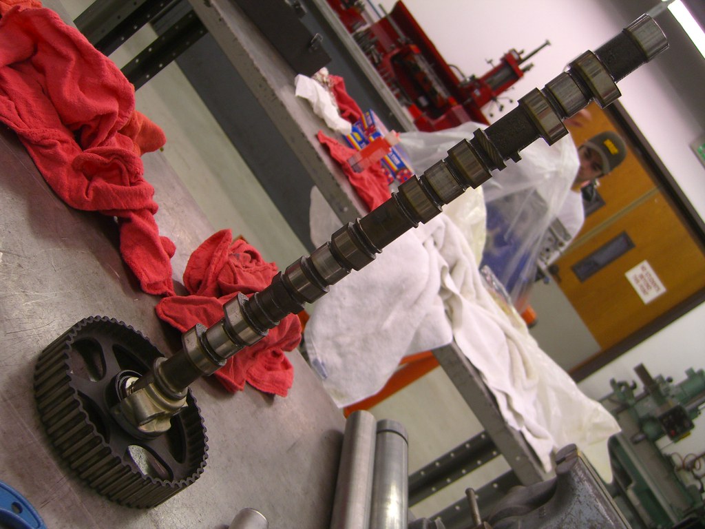

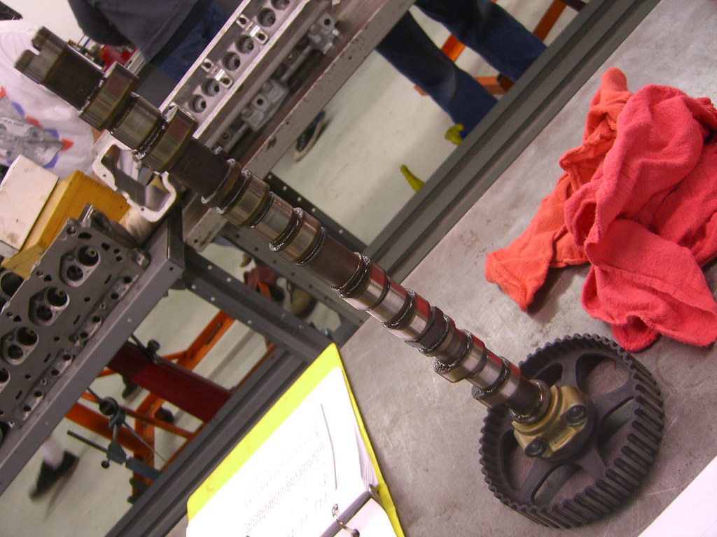

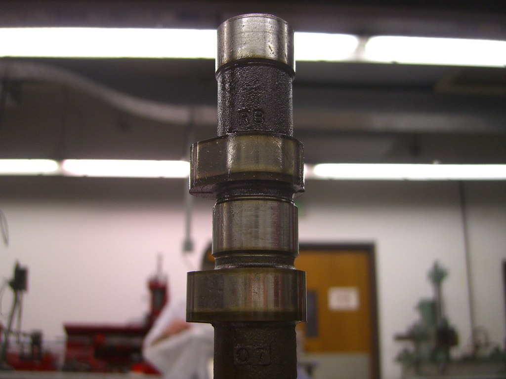

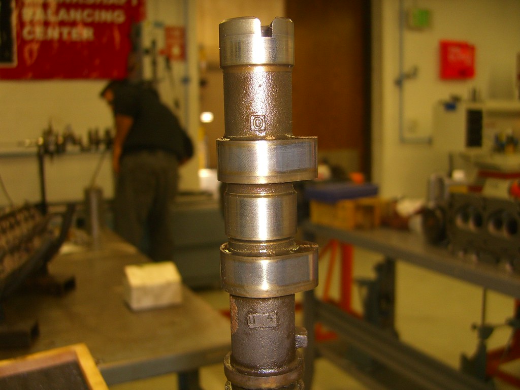

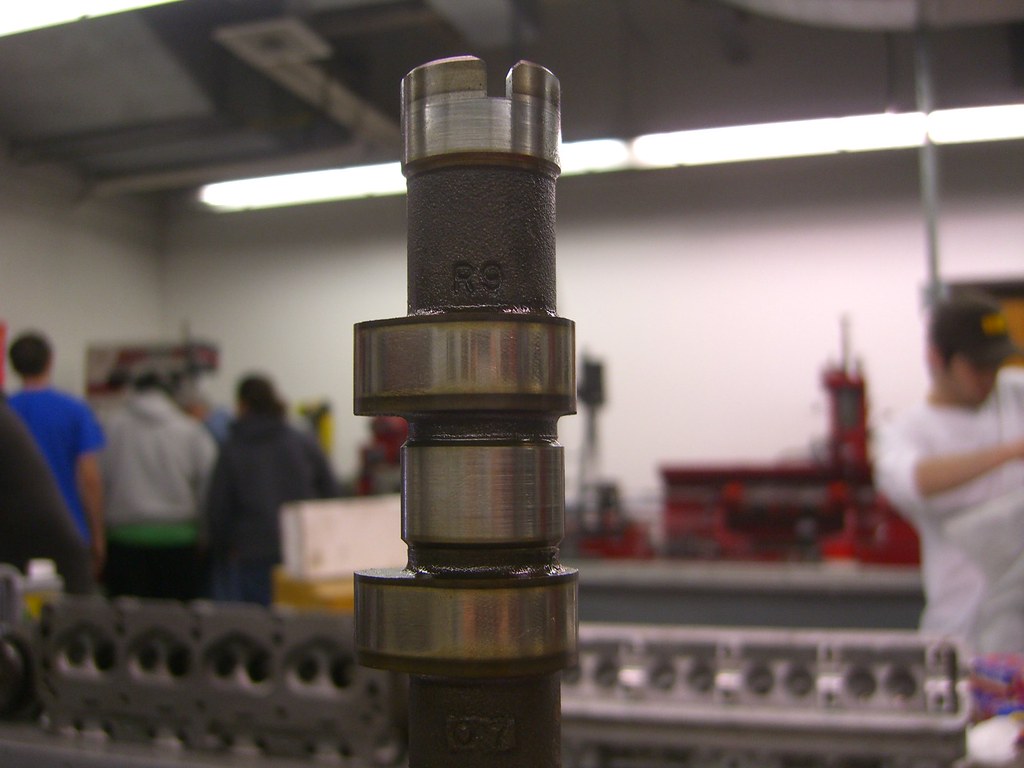

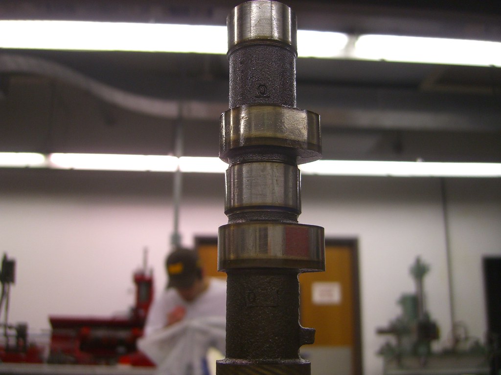

Any idea which cams these are? Not stock...the distance from lobe tip to base circle is way off and the markings don't match any oem cam.
Unless i'm just a complete idiot and there is something i am overlooking. However the measurements still don't make sense. /ubbthreads/images/graemlins/dunno.gif
Intake cam markings
Exhaust cam markings

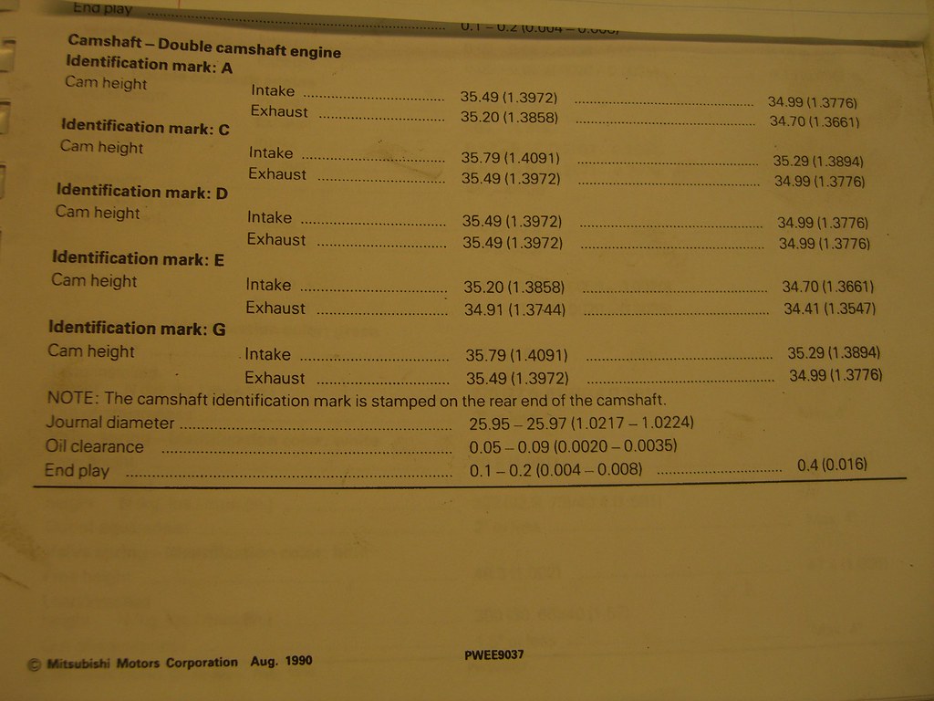

Specs per factory service manual 91-92

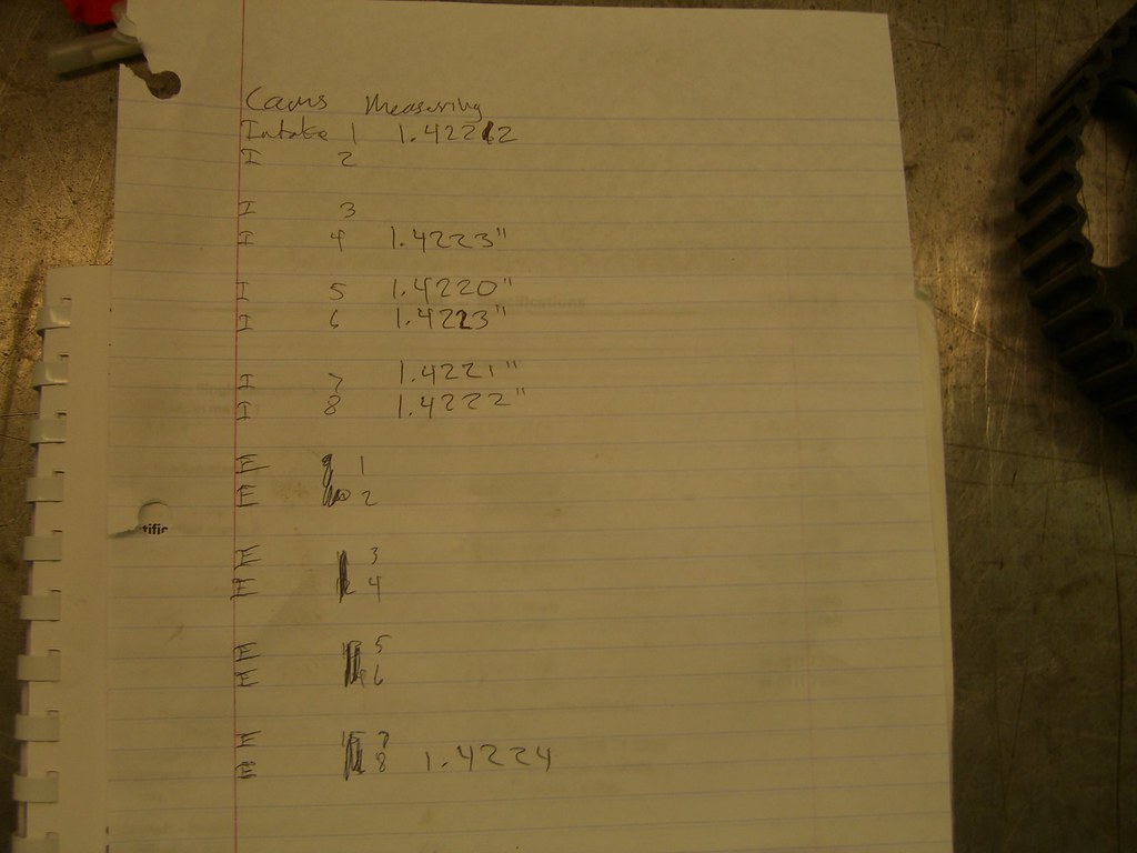

Measurements- Cam height (tip of lobe to base circle). Using a known good micrometer.
Intake
Exhaust

I measured some known cams from a turbo and a non turbo then the ones that came out of my car. The ones out of mine were slightly larger. But that was years ago and the piece of paper I'm sure has long since vanished. Plus I had a dsm valve cover on mine and don't know the history before me of my car except they didn't know how to put in a balance shaft belt or know that caps leak. If anyone here has a set of stock galant vr4 cams measure them up for this guy

I bought the head complete from a member on here. I hit him up a couple weeks ago about this...he was pretty surprised. He said that the head came from a GVR4 that was completely stock when he bought it.
FWIW, everything else in the head is OE as far as i can tell. The valvespring free length and pressure are right on spec. I checked the calibration of the micrometer with a standard before i took the measurements. Everything was at room temperature. /ubbthreads/images/graemlins/dunno.gif

The measurements you took on that intake cam work out to somewhere between .376 and .393 total valve lift, depending on whose "stock" lift measurements you use (published on various sites like BC and Crower cams). The .393" lift would match an HKS 264 intake cam, but the markings don't look much like the stock markings (meaning, probably not regrinds) and they don't look like HKS markings either. More than likely you have either a 264 or 264/272 style knockoff from some aftermarket manufacturer. You might try a google image search to try and find some similar looking cams.
Assuming the car it came from had several prior owners, what probably happened is that the car (or just the engine if it wasn't the original) was mildly modified (bolt-ons), and then was parted out and returned to stock at some point. Either it wasn't worth the effort to remove the cams or they just weren't aware of the cams. There really aren't too many GVR4's left that still have all original stock parts.
