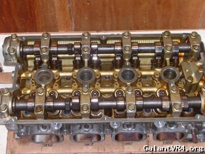

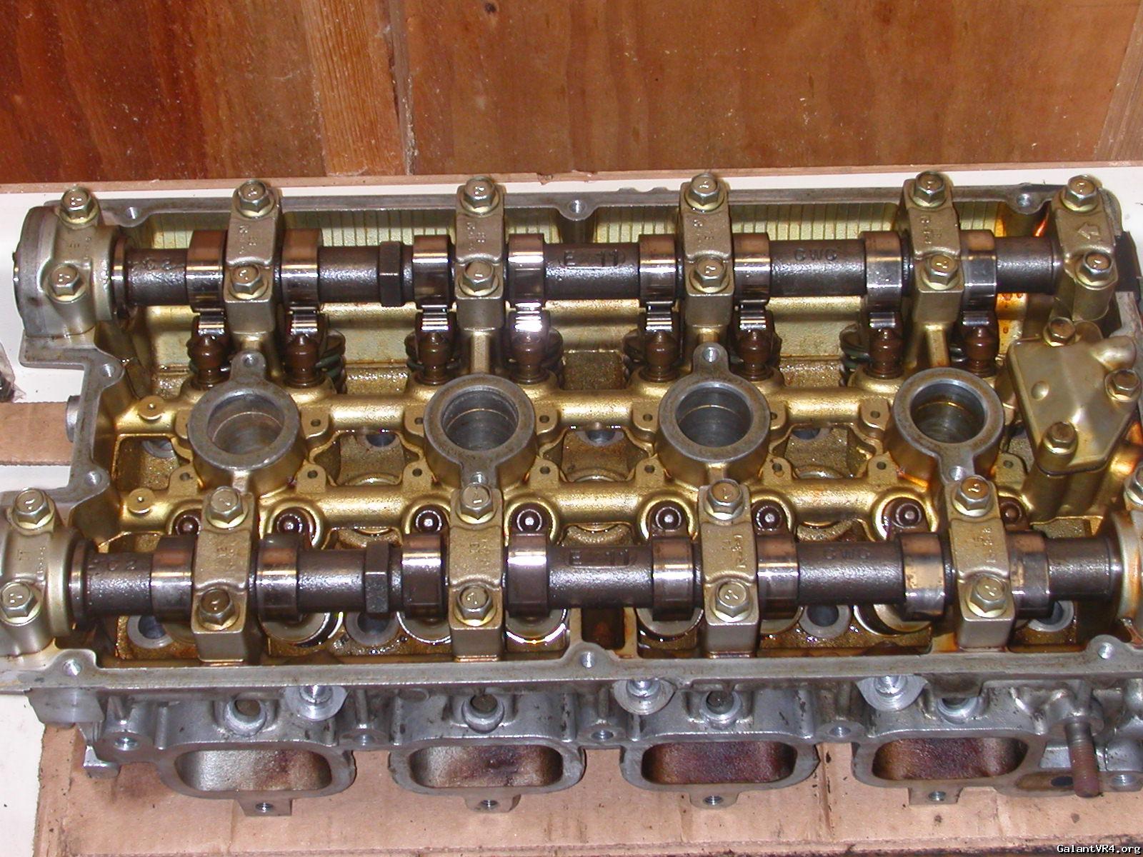

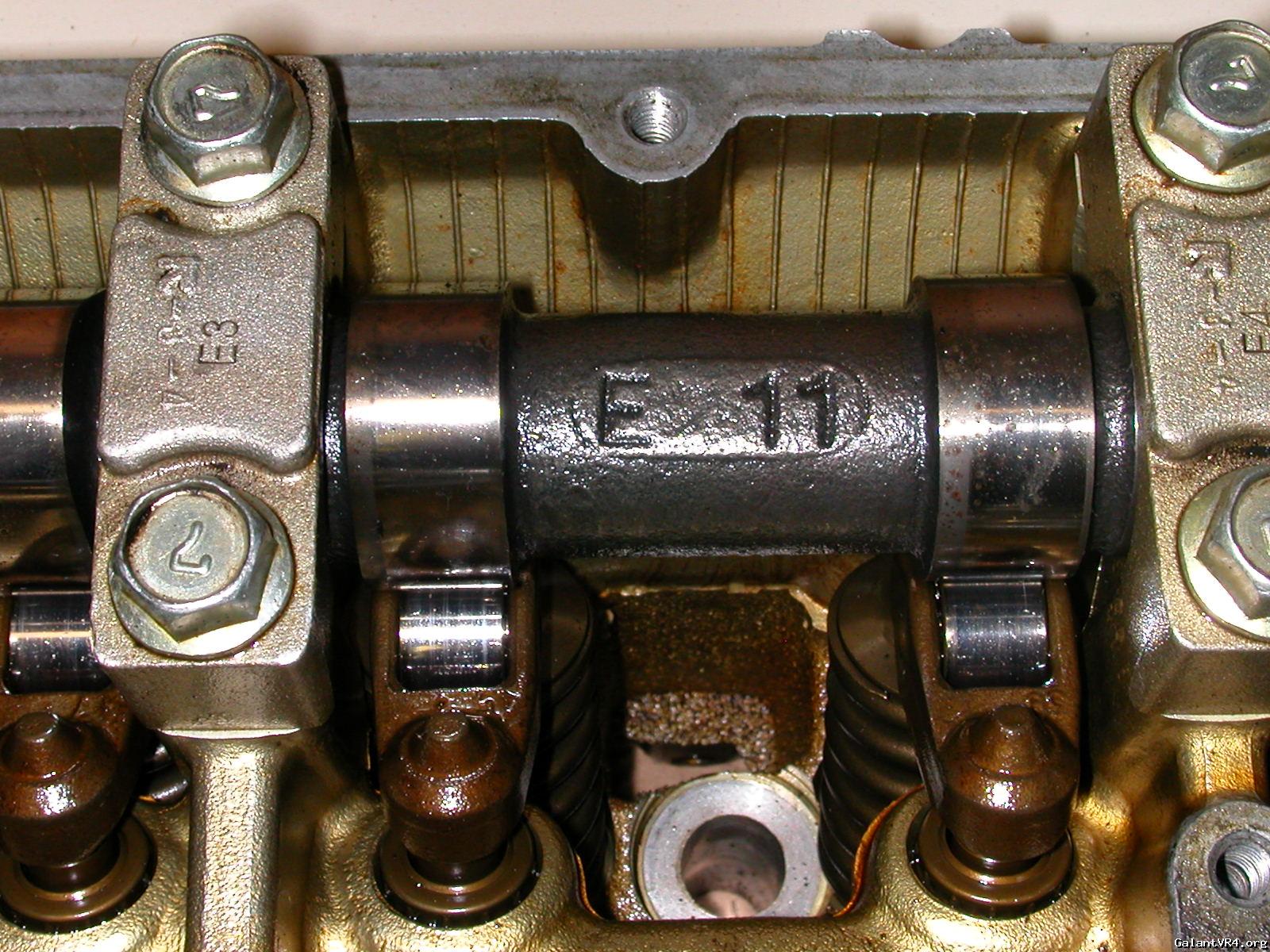

When fixing my engine earlier this summer, I bought a stock (jdm) head with some cams in it. The cams are made by comp and they are their lightest flavor (very top of the list). To start with, I'm not 100% sure these are the cams I have because I figured it out by my superior powers of deduction. I bought the head from autobahntom, who is a really great guy btw, and he said the cams were made by a company called Zex. A quick google search popped up with a company called zex that makes some cams for hondas and some nitrous kits and whatnot. I couldn't find any info on zex cams for mitsu, but at the bottom of their website, they have a comp logo. Zex is a part of the comp performance group, so maybe by Zex cams, Tom really meant Comp cams. I looked through comp's catalog and found mitsu cams, specifically cams with part number 101100. The only number markings on the cams I have is an 11 right in the middle, so based on the information from Tom and the '11' marking (as opposed to 12, 13 or 14), I have concluded that these are Comp's least aggressive cam. spec sheet
Here you can see the cams and their '11'
