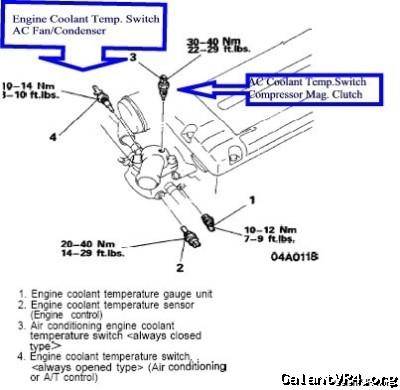

Yes the relay(s) could be bad, so could the sensors on the t-stat housing:
Yes the ac does come on but the fan does not come on. Yes I am referring to the one in front of car on the driver side. Seller assured me fan was in full working order guess I will have to find a way to check the relays and the tstat housing...
So I guess I should start with the sensors. How do I test the relay though and are you
talking about the relay on the fan itself or the relays under hood in the fuse box?

Once you test the switches/sensors, check the Auto Comp Controller, located behind the glovebox. click
Ok thanks so how can I test the switches or do I just change them all out voltmeter????
