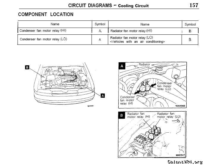

First of all, are you saying that you got a non-turbo harness, and you're trying to use it on a VR4?
In accord with the circuit diagrams contained in the second volume of the factory service manual, the radiator fans on most non-turbo model Galants only have a 4 pin connector, while the turbo models (and non-turbo G-GSX models with automatic transmissions) have a six pin connector. This fan is the one that requires a bit of changing if you are using it.
As far as the A/C Condenser fan, they had the same connectors between the non-turbo and turbo models. The only difference is that some models have the condenser fan mounted behind, alongside the radiator fan (non-turbo FWD and AWD M/T), and some have it mounted in front (non-turbo AWD A/T, and turbo models).
If you've got the radiator fan hooked up, great. For the condenser fan, you need to find the condenser fan relays, and the connector located just below those relays, by looking at this picture:
By the way, here is the thread Brox was referring to: Fan Wiring Thread
