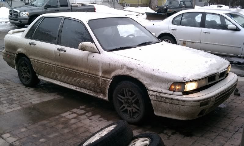

I had a little impulse buy the other day and picked up this 1991 Galant VR-4. The kid that sold me the car told me it's name was Paula because that's the name of the hot mom he bought it from. I decided that "Slutty Paula" was more fitting since just about everybody and their mom has owned this car in the Fargo area.
It's number 708/2000
Like I said, the car has been around the block once or twice, so I'm not 100% sure what's all done to it, but I do know the following:

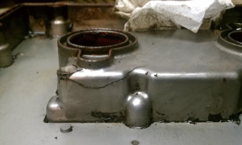

Like all dsms, there's a few things that need attention. First thing I noticed was the oil pooling in the vc well area. I took the vc off thinking that the gaskets just needed to be replaced and found a big crack /ubbthreads/images/graemlins/frown.gif I plan on tig welding it up tonight, shaving the vc, and powdercoating it.

Welcome and good luck! Looks like you've got your work cut out for you. No offense but the Galant looks like it's been through hell and back. /ubbthreads/images/graemlins/bawling.gif
I hope it has found a better home and owner in you.

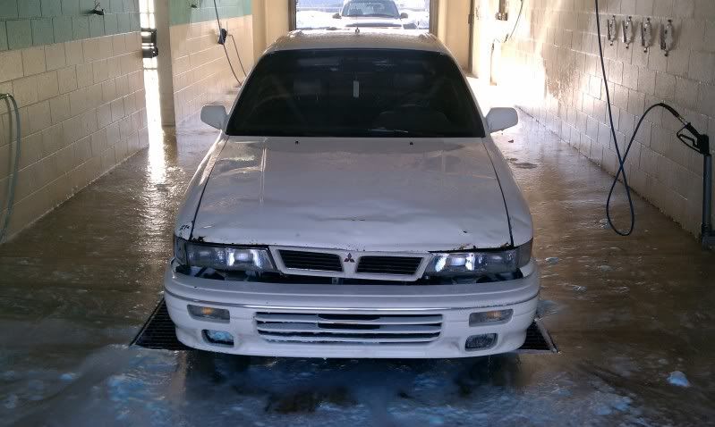

Also, I'd like to find a different front radiator support since mine is all sorts of messed up. The only compatible years are the 91-93 Galants right?
Correct, though you also want to *really* keep your eyes peeled for an AWD model (meaning one of the less than something like 5000 GSX/VR4 models). Take a look at how that front crossmember (the one with the front motor mount on it) bolts up on either side of the car. Those bits are different on the more common FWD models. You could still use the FWD core support, but you might have to fab up something like this.
