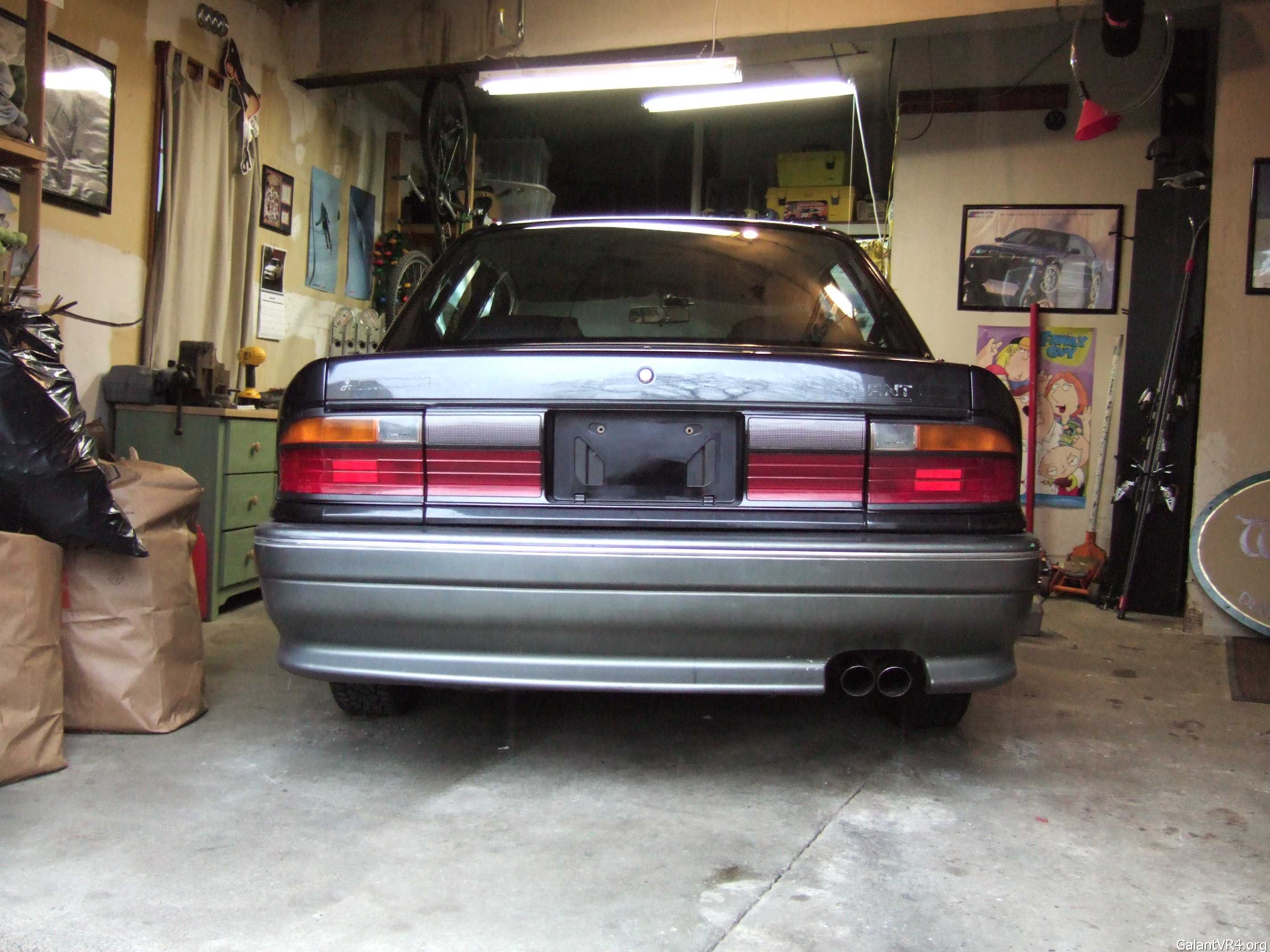

Its in your head. I put 89 tails on my 91 with no problem. i now have 93 taillights in with no problem.
I have A PICTURE of my 91 with 89 tails IN THIS THREAD. This isnt science, they just screw in.

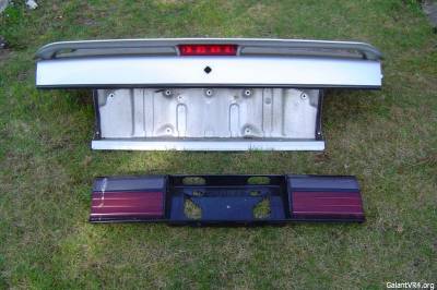

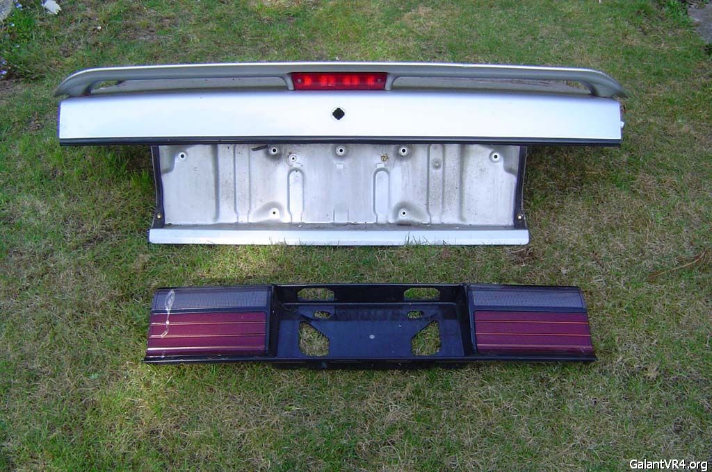

To substantiate-------
89 decklid:
89up decklid:

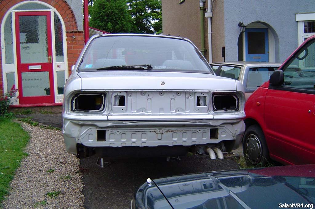

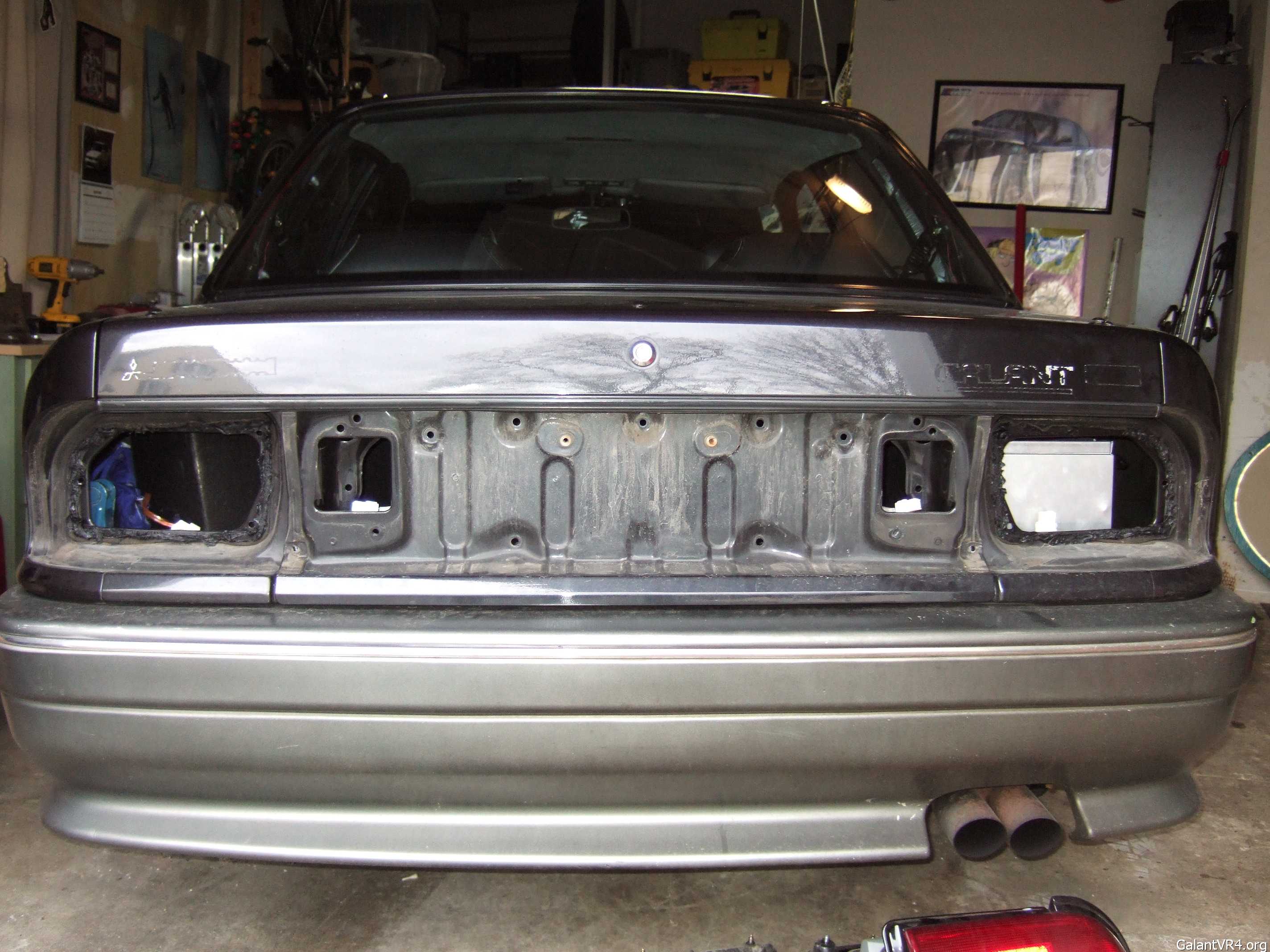

OK riddle me this. He asked do 89 lights fit on a 91/92 your pictures prove they DO. They have holes for lights that aren't there.
What YOU proved is that 91/92 lights wont fit on an 89 trunk without cutting holes for lights.
To put in the 89 tails you simply dont plug in the lights. I said the lids werent different because if you have a 91 and up WHICH HE DOES, you can put in any taillight you want.
In this thread are pictures of my car with 89, 91, and 93 lights with no modification as well.

I simply stated that you may have to do some cutting to make them fit flush. You are insisting that it is not necessary to do anything but bolt them in. That is NOT true. The large holes present in the newer trunk have NOTHING to do with the fitment of 1989 tails. The reason cutting is needed is that there are two bulges where the holes are on the 1991 trunk and those bulges are flat on the earlier trunks. I'm not sure why you're so steadfast against it being a possibility that some trunks might need to be "massaged" a little to make the 1989 center fit properly. I was under the impression that it was a simple swap when I did mine and then I found out the hard way that the 10 minute job was a bit more involved since some cutting was required.

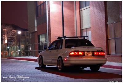

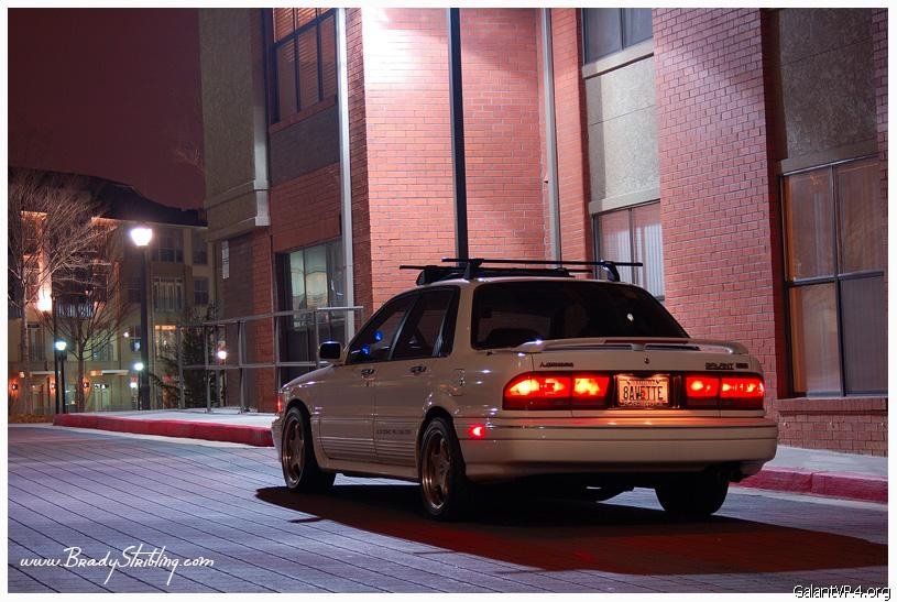

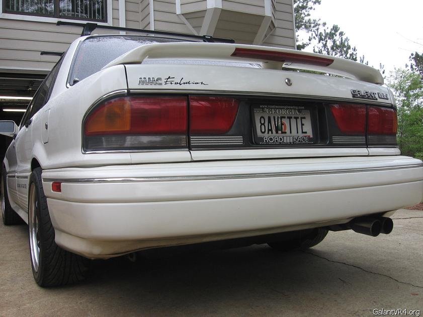

Well, this thread made up my mind. I installed the lights on my own car. Thanks for starting the thread!

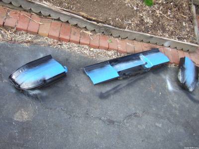

Removing the stock lights:
I painted the chrome trim around the lights black, but upon looking at my stock lights, I think the black trim from those can be unscrewed and used with the 89 taillights.
The fit isn't perfect (small gap above tails and trunklid), but I didn't have to cut or tweak anything. The blinkers are MUCH more visible than the stock ones, which is great. I've only got brake blubs in the outer part, as one of them was super dim and I didn't feel like messing with the wiring to track it down.
CP
Aug 30, 2004
8,940
West Simsbury, CT
Just do it. It can't be much easier. I'd do it again just for the added visibility of the turn signals, and to be different /ubbthreads/images/graemlins/grin.gif
OMG and those are my taillights on CPs car!

Looks awesome on the wingless car Cy. Glad you are putting some use on them.

I don't see where you guys were talking about hacking anything. The center section fit just fine, albeit with a little twisting and banging to get the studs through all the bolt holes in my stock trunk.
I sealed the lights to the car with black silicone caulk from Home Depot Racing, as well as the top lip of the center section where it meets that rubber strip attached to the trunk.
I thought the tails were bunk until I opened them up and discovered you jacked all the bulbs before sending them to me /ubbthreads/images/graemlins/tongue.gif The left inner brake bulb connection is messed up, so I just left the inner sockets empty. I had disabled my stock inner lights too in the other center section, so it's no big deal. Thanks for PMing me so fast with the taillights!
Like I said, the blinkers are much more visible than the stock ones are, which is a great asset here in the Boston area, where the roads are filled with crazed Massholes always trying to run you down.

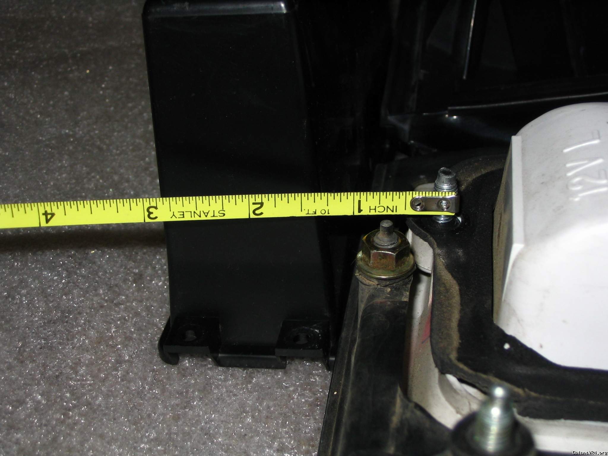

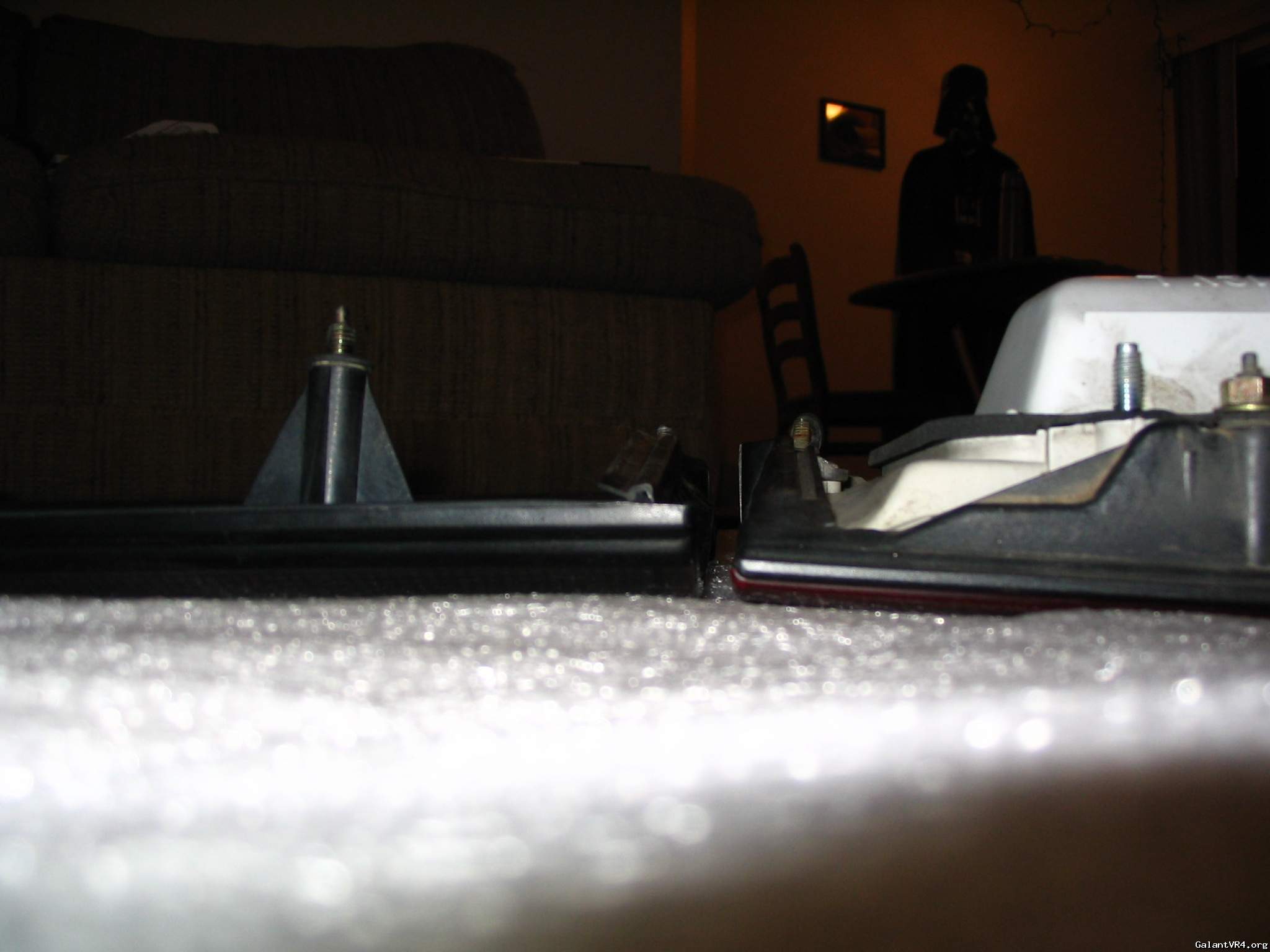

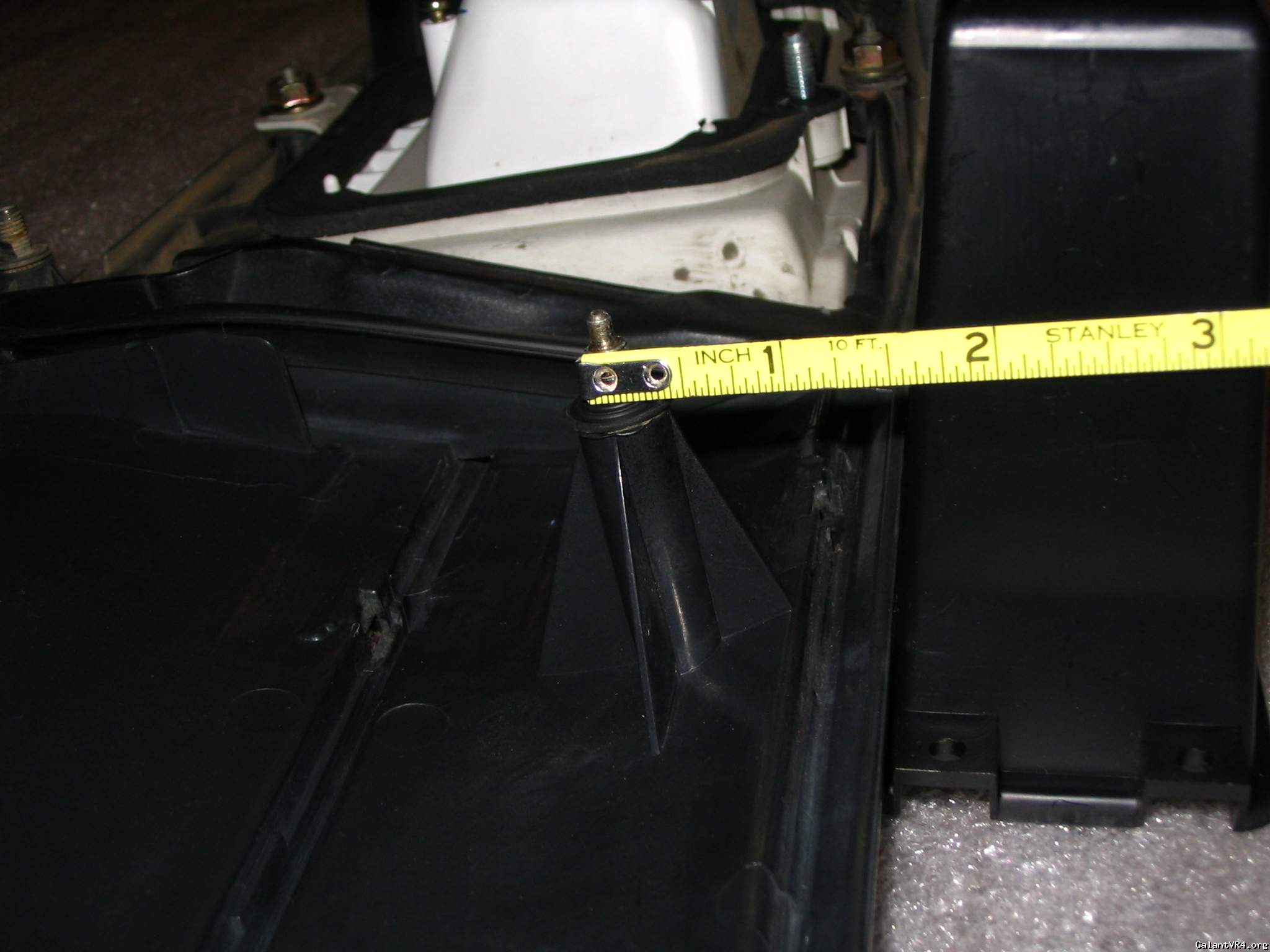

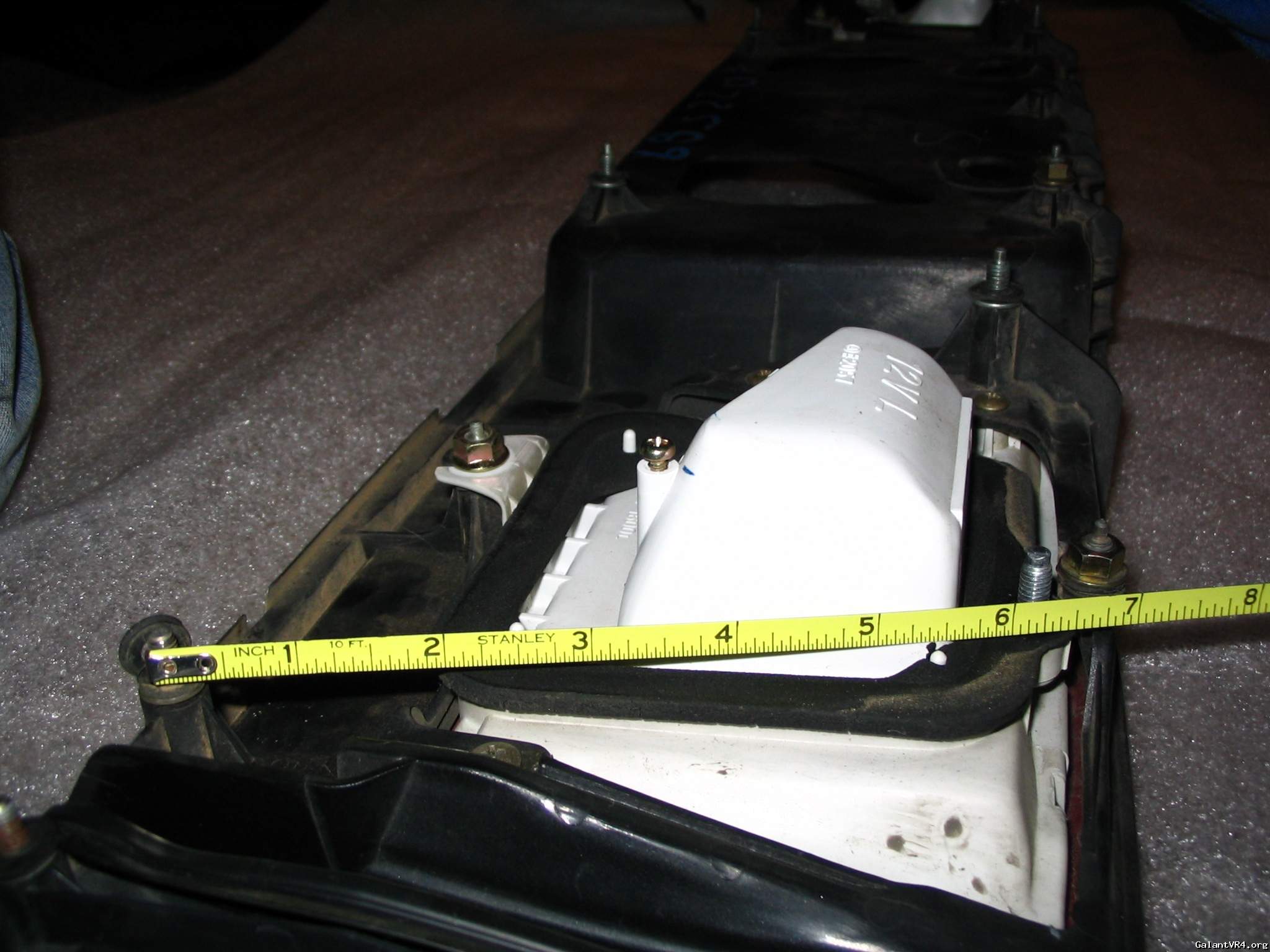

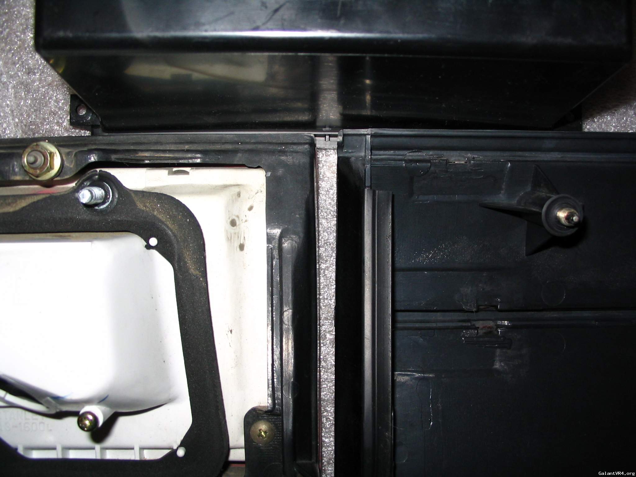

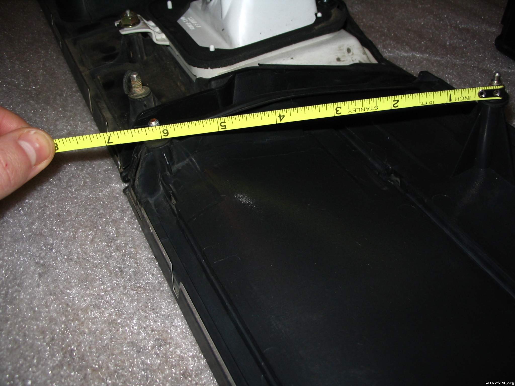

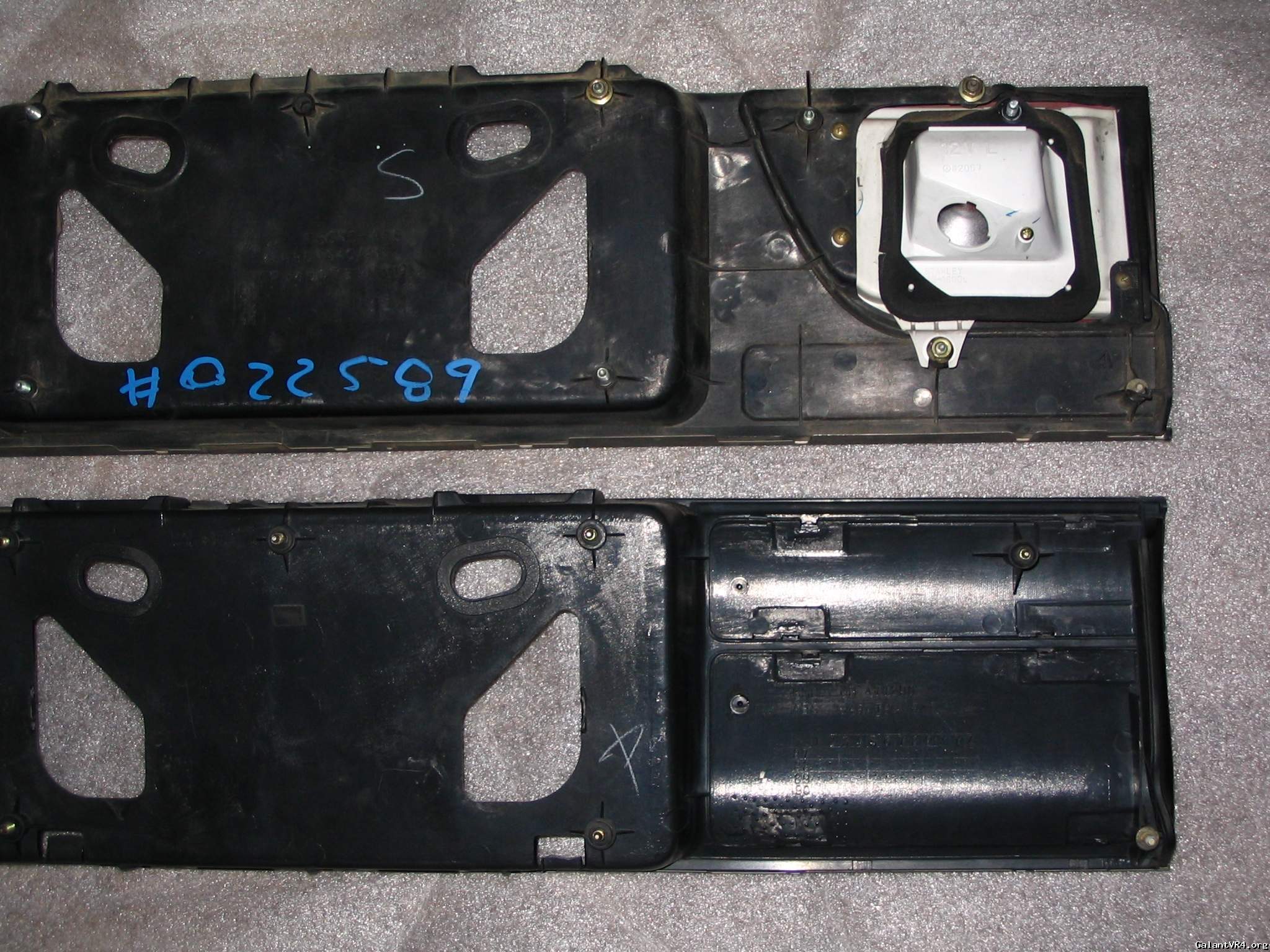

I recently got a set of '89 tails and after running into some difficulty installing them, found this thread while searching. I can't speak to other people's experience but my '89 center section did NOT just bolt onto my '92 trunk; the tails bolted in perfectly. I couldn't even get the center section in no matter how much bending or tweaking I did, and after some really loud gut wrenching cracking noises I gave up for the night. Today I put the two center sections next to each other and did some measuring, and without a doubt the mounting points changed between the years. I think the pics are fairly self explanatory, but I'll try to answer any questions if there's any confusion regarding my less than scientific techniques. After I finish modding the trunk lid I'll post pics of that too.
In a nutshell, one of the mounting studs on the '92 center section is on the bulb housing, and is located slightly closer to the top of the center panel. I tried to show this both in relation to a 3rd point of reference (stereo pocket) and in relation to the lower mounting stud. Closer inspection revealed an even bigger difference, that being the depth of the mounting stud, which is shown in the bottom pic.
