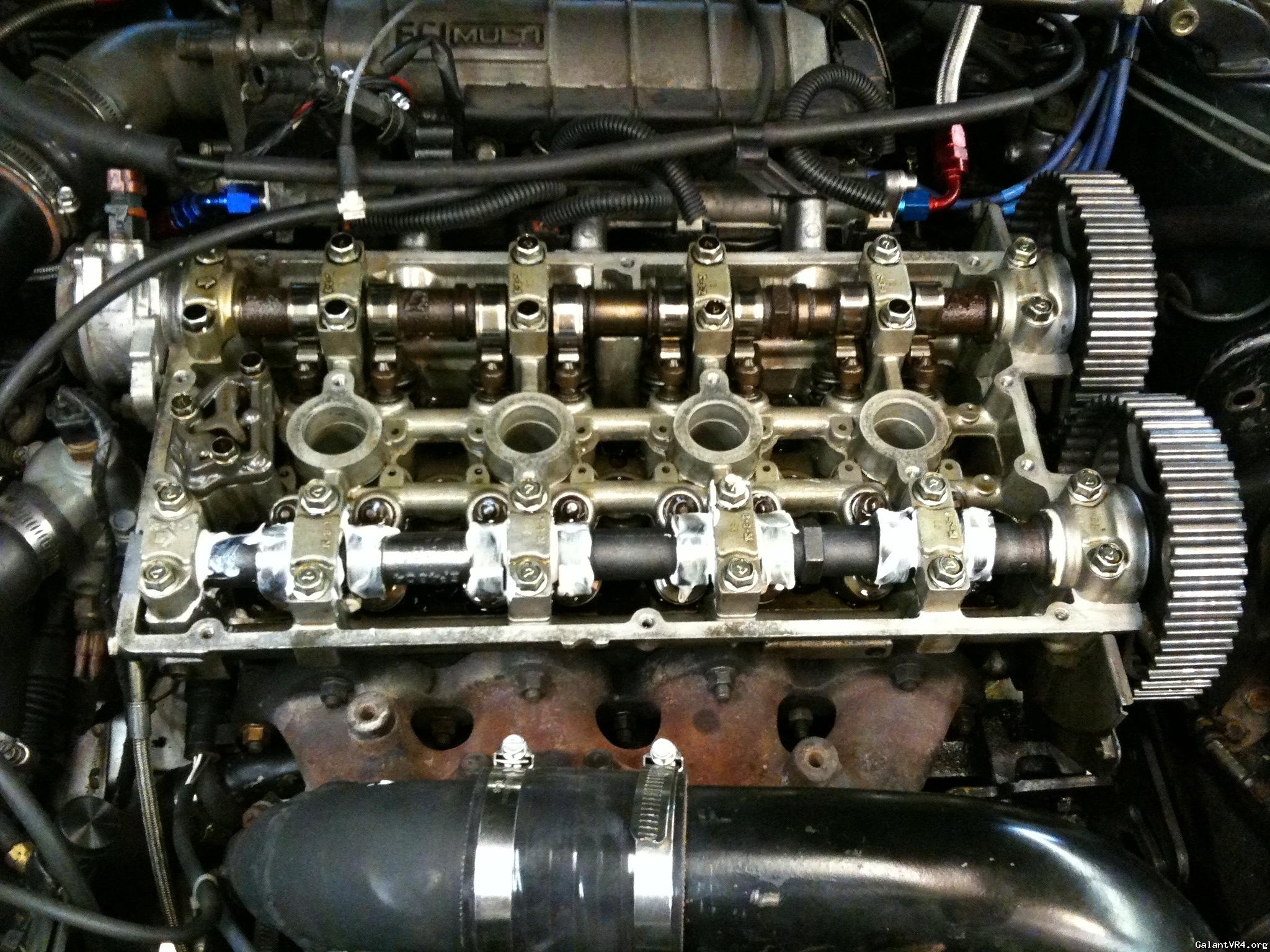

Installed a FP1 cam last night as well as a new timing belt to replace the oil soaked one that was on the car. I never checked the oil galley plugs during assembly of the motor. The machine shop must have taken them out to flush the head after machining. That's a good thing, but my mistake of not checking wasn't. Luckily I figured it out before anything bad happened.
Cam improved low end throttle response and helped it rev more freely in the higher revs. All in all I'm glad I did the swap and am satisfied with how it drives.
